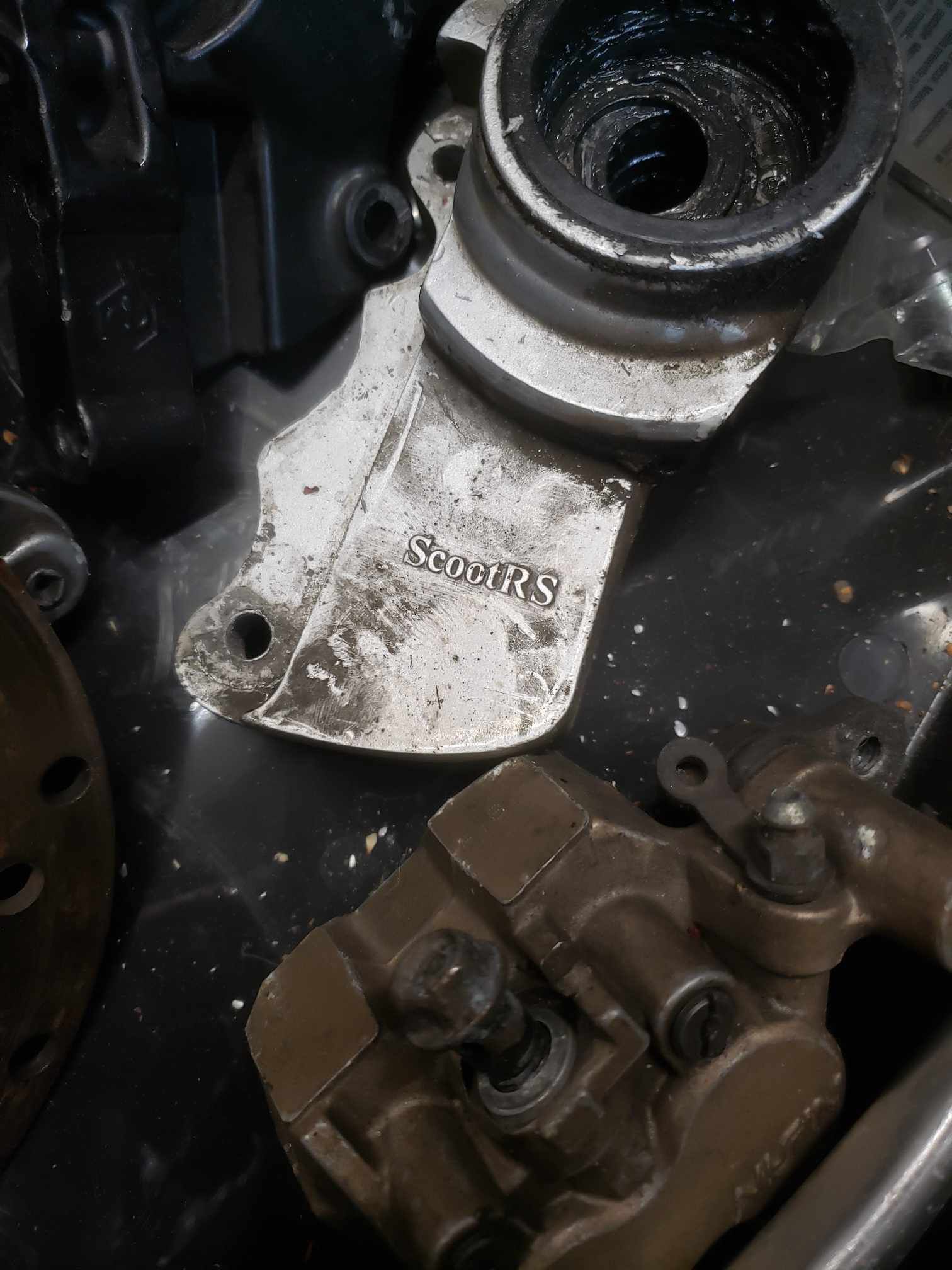

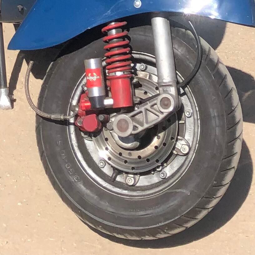

Hello, folks.
I have a disc brake kit on my 150 Super (with PX fork). The rotor is now becoming worn. It is the kit from a vietnamese company that no longer exists, that sounds a lot like scooters (without the e).
Does anyone know if it is a custom made rotor? Or can I use the one from another bike/model?
Thanks

Yes it's a
S c o o t R S
disc. The nice thing about them was that the hub looked exactly like the drum from the other side. Worked well too.
I hang on to a lot of stuff and sometimes get to use it. I have one that is also worn, but probably could be cleaned up ok. How bad is yours?
Might also be worth getting a price on having one made, it's a simple shape unlike the Piaggio ones.

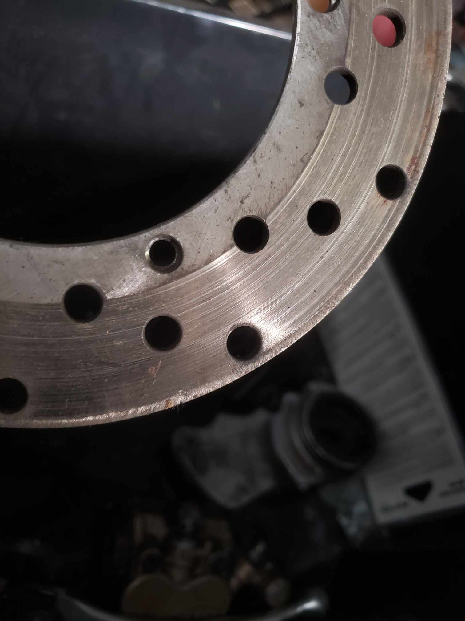

I've ridden about 30000 km on it since 2010. I bought it for the looks, like the performance and haven't got any problem.
Maybe it is worn for about 1-2mm I suppose. It's worse than yours. It's still usable, but for safety may be better to change it because I haven't got a clue of how long should it last.

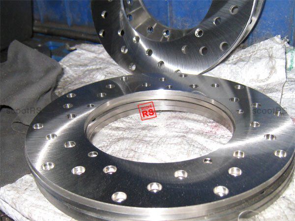

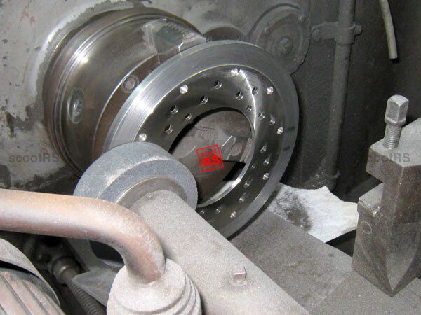

Piaggio says if thickness is below 3.5mm, replace it (for their own). Found some pics on the R S old FB page, unfortunately seems that the rotors were made in house...

Nice find Safis! It's a pity they went under as they actually did a few interesting things. I know he certainly had a bad reputation personally on here and the old BBS, hence the redacted thing.
This disc of mine is 180mm diameter and (originally) 4mm thick. It measures around 3.7 - 8 ish now so with a cleanup you probably could count on 3.5.
