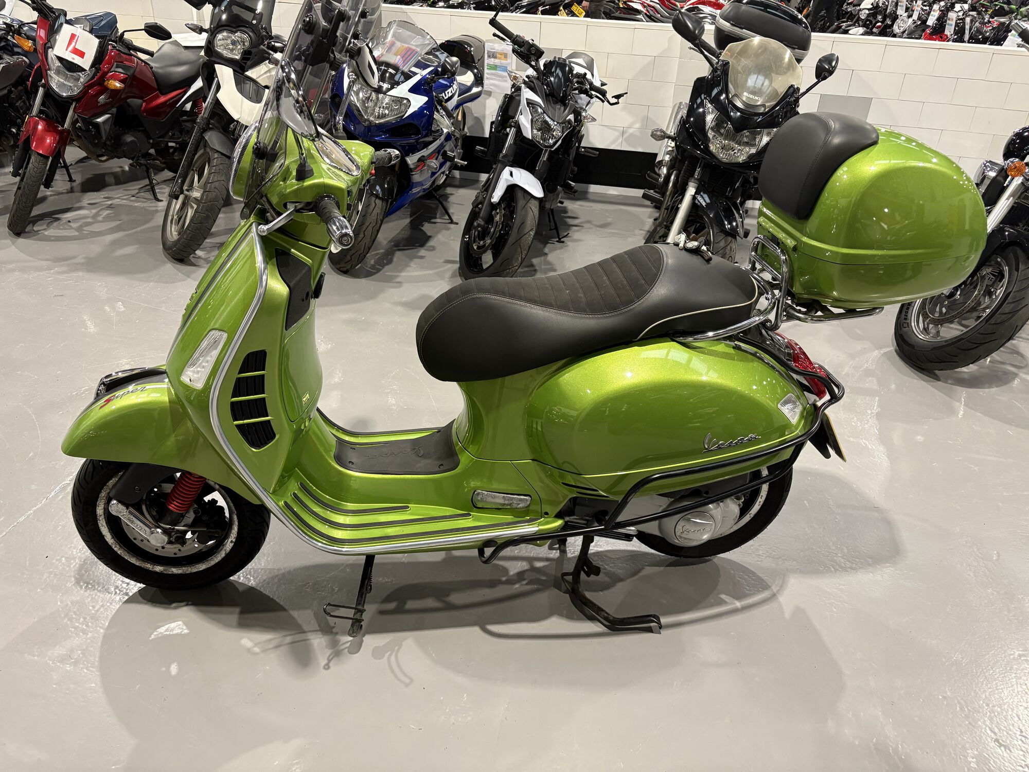

I have a green 2017 which I am going to convert to mp3 13inch rims I am going to run city grip 130 60font and 140 60 rear. I believe I need to buy the sip hub or can I just swap wheels I know I need abs kit and exhaust gasket can anyone think of anything else in need thanks

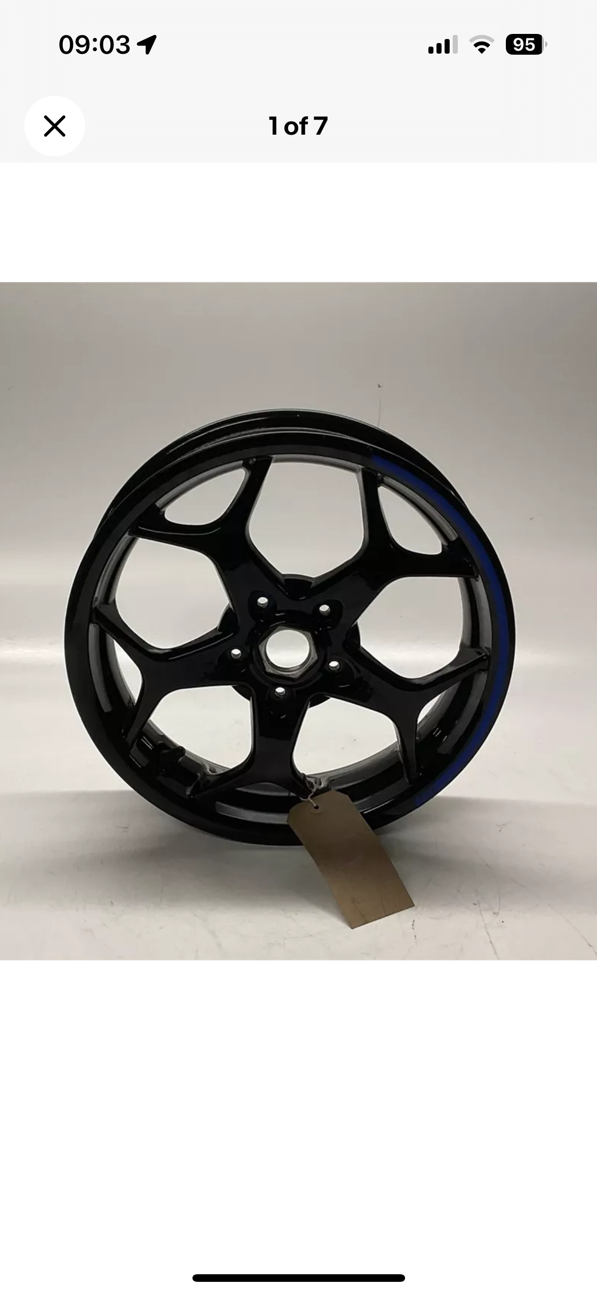

They are second hand and I am into £50 instead of £280 for the sip ones leaving room to buy a hub if I have to

They are from a mp3 so need modifying then which I believe grind one ring off near the centre cap

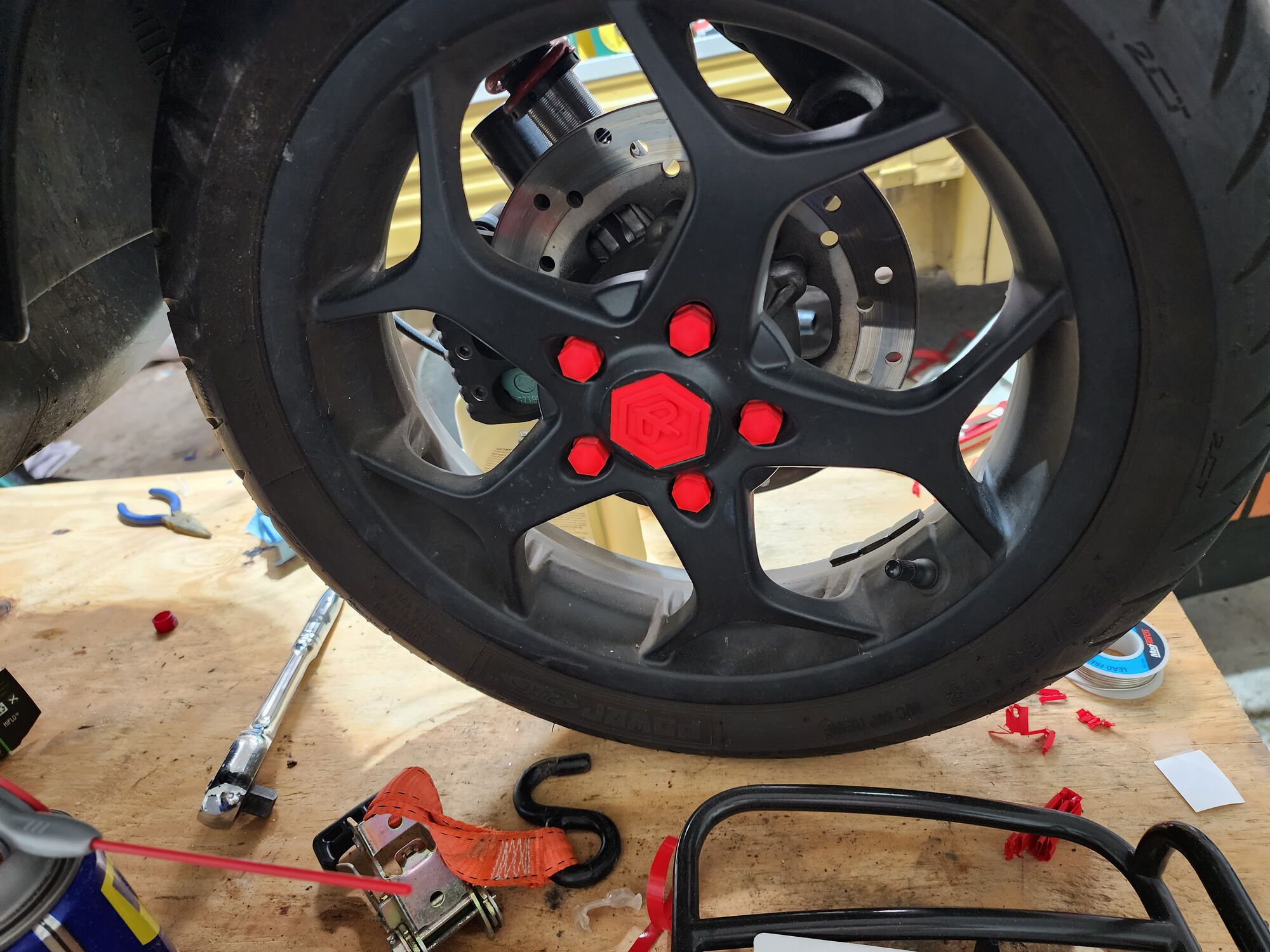

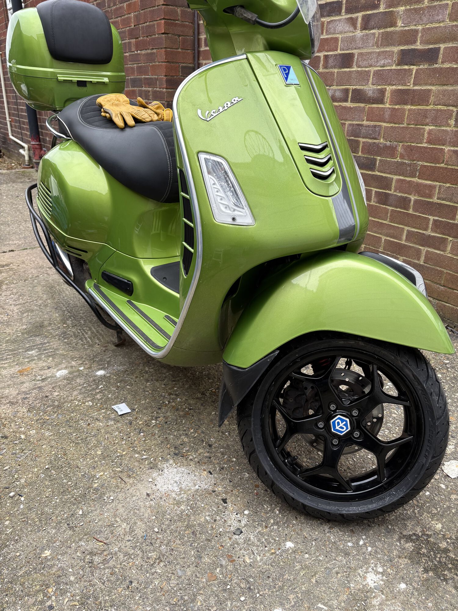

Laughing emoticon So I got my day off 😀. All parts where here so I made the swap front is a dream to do. Rear was a little effort. I rebuilt it abs light was on I didn't realise with the mp3 wheels I needed the spacers from the gts on the bolts to get the correct spacing (for me )

Looking good. Now just need to black out the rest of the trim.

The next job will be the leg shield trim. I will paint what I have. But yes keep going till all black
