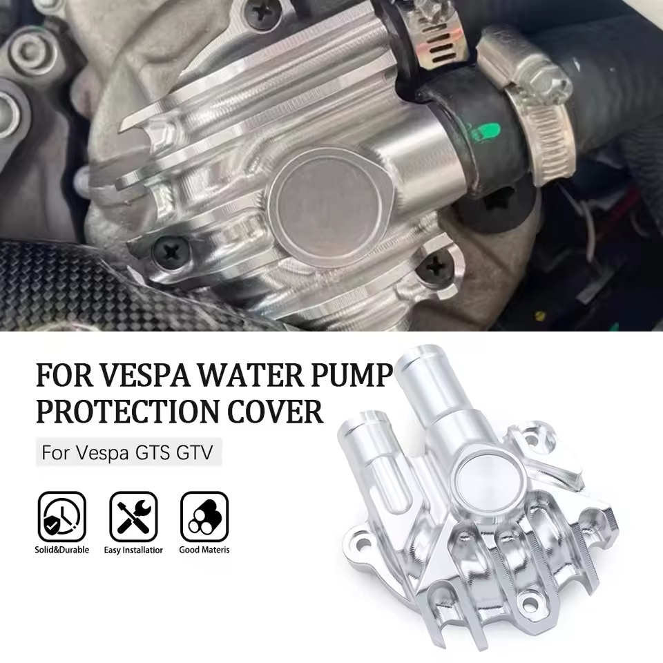

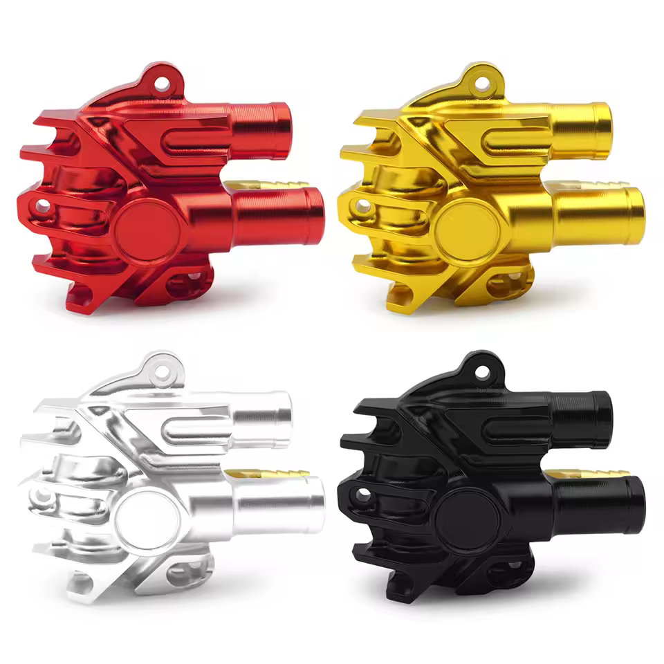

I occasionally consider getting ones of these. Not for the bling, instead for the cooling fins.
about AU$60

You must mean for the bling of the fins, as they'll do eff-all in comparison with the radiators

when riding - sure, I agree.
my pondering stems from once the bike is heat soaked both in the engine bay and the whole front, then when idling or rolling slowishly on 4wd tracks there isn't enough air through the radiators or coolant flow towards the front (due to low rpm) resulting in the coolant temp rising high enough that the fan comes on.
but I don't really think the above pump cover would solve this.
so I just keep pondering

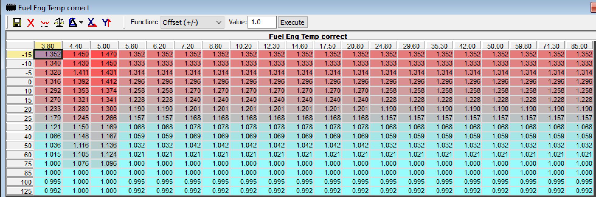

I wouldn't try and mess with lowering the Eng Temp below what the ECU wants.
One of the reasons is the different metals expand different amounts and it's designed to run in a certain range. eg the cylinder and head are very different metals ...
Bonus: here's TPS(deg) vs EngTemp(C) correction map for a GTS 300 pre-HPE.

the performance of those cooling fins will enhance your status among vespa owners world wide. and everyone will be awe.
are those from alibaba or tenmu?

Scooter-Centre.com sell the BGM branded ones. Even SIP has a SIP branded one.
PS you don't have to be like that

but what are the ones YOU posted?
