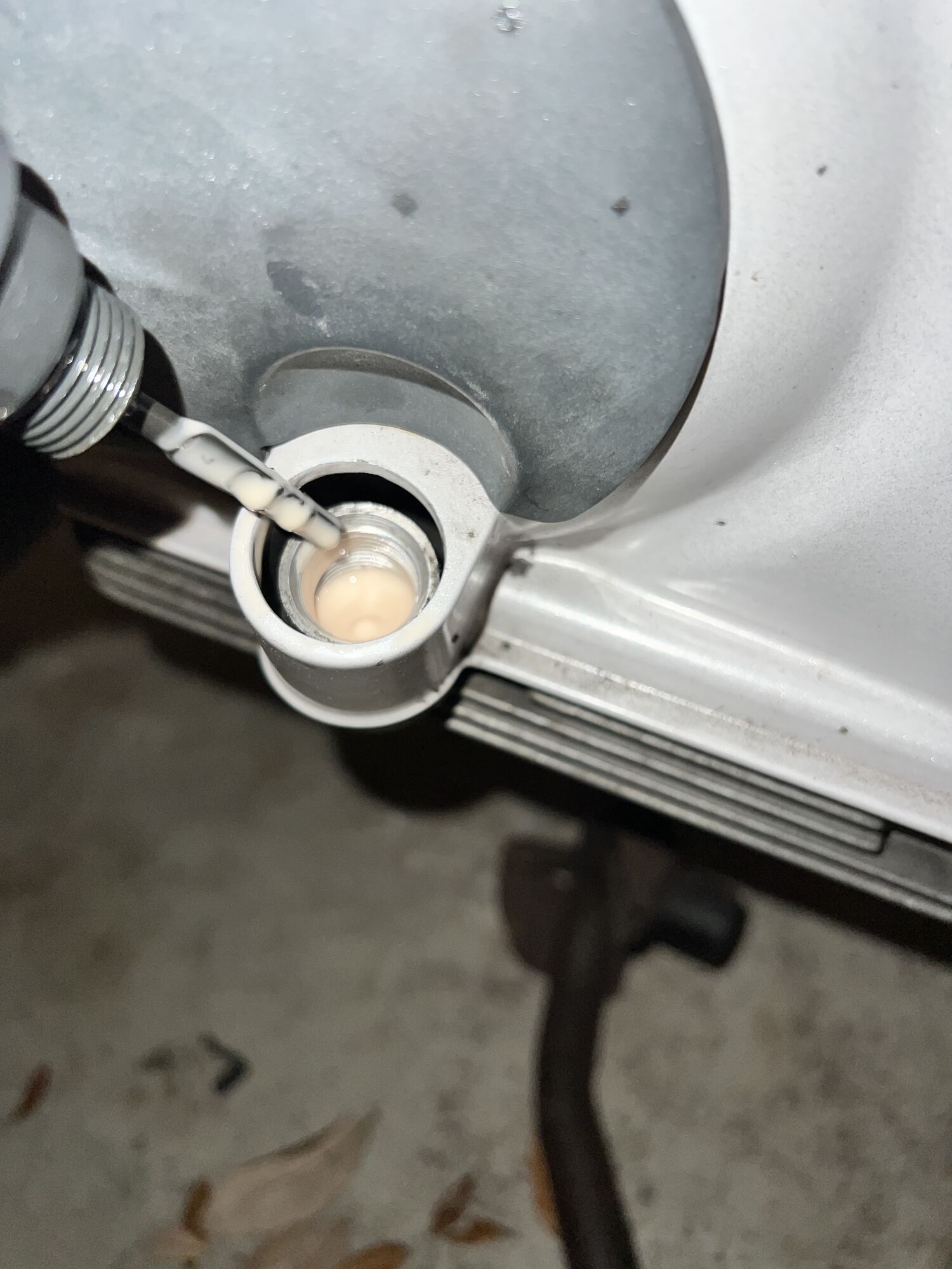

Just bought this one today. I checked the oil because I was going to change it anyway, but looks milky and overfilled. Anyone knows what the problem could be?
Milky oil
Milky oil
Posts: 8030
Posts: 8030
Milky -> 😱
She no good.
Milly oil means it has mixed with coolant. Blown gasket or seal etc.

bought then checked oil?
should have check that before buying as big RED flag.
your looking at a minimum top end gaskets

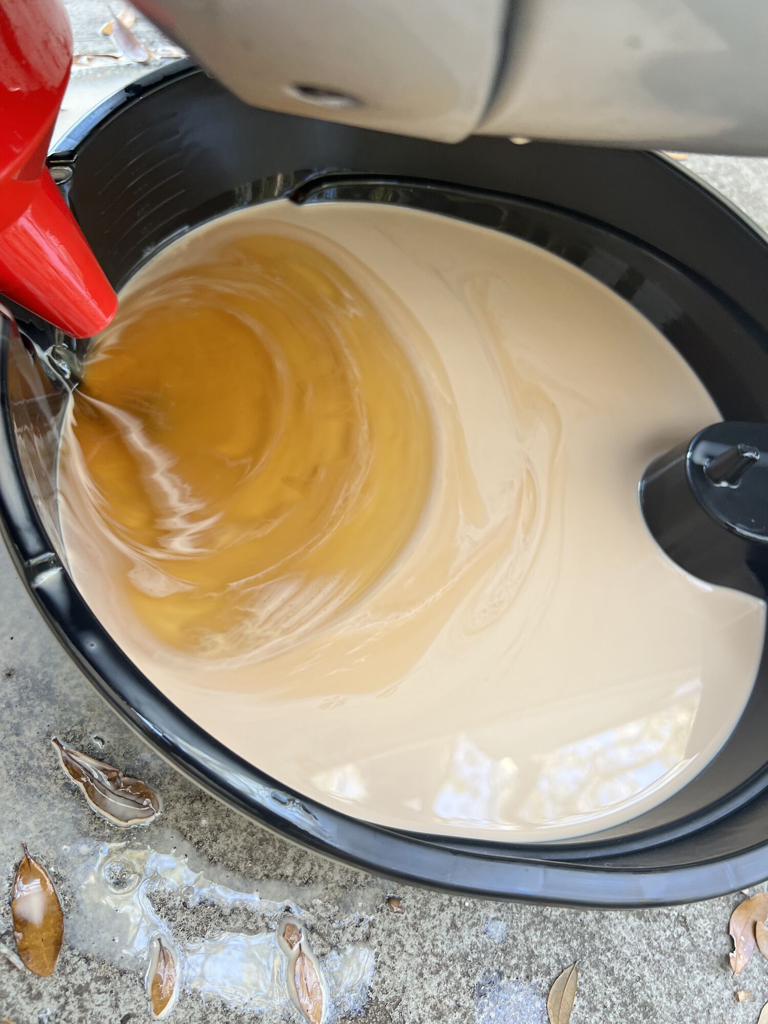

Cappuccino anyone?!?

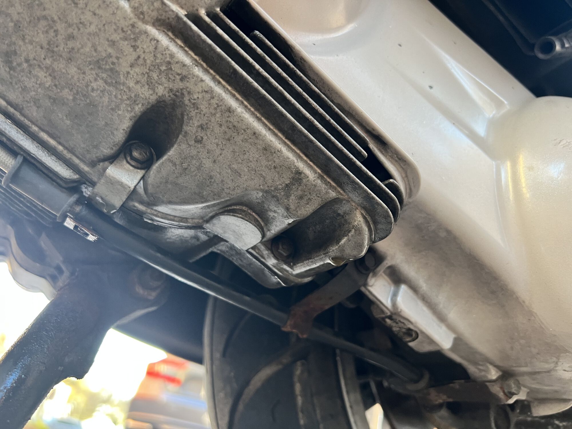

Flushed the milky oil and changed the filter. Started right away for about 20 min. Then I turned off to check the level, and had rough idle after. Just rechecked oil and it's a bit milky again. Also saw an oil leak. So next probably checking gaskets
2006 GTS 250 ie
Posts: 7
Location: Florida
2006 GTS 250 ie
Posts: 7
Location: Florida
Oil leak spot.
What do you guys suggest?

A fast way is check the amount of coolant in your system, if the coolant is going to the oil, you are losing coolant (level reduce) and this explain why the oil level is a lot over the max.
And I agree with others, that can be a gasket only (finger crossed) or a mayor problem between the oil and coolant passages Crying or Very sad emoticon Cappuccino oil is never good symptom

Have you installed Dr Pulley sliders, or an extra washer on the variator bushing? If so you will almost certainly torn open the oil sump gasket - and you might have done anyway, regardless of 'mods'. When reinstalling said gasket remember to trim off any excess that sticks put. It can be easier to trim it with scissors before installing.

oil leak is nothing compare to the water/coolant in the oil.
you gotta pull the engine for that anyway to pull the top end off. At that point then investigate other seals gaskets that might need replacing. They make a complete gasket kit just saying
I use a new razor knife blade after installed. super easy this way to get it really clean and even cut exactly case height.

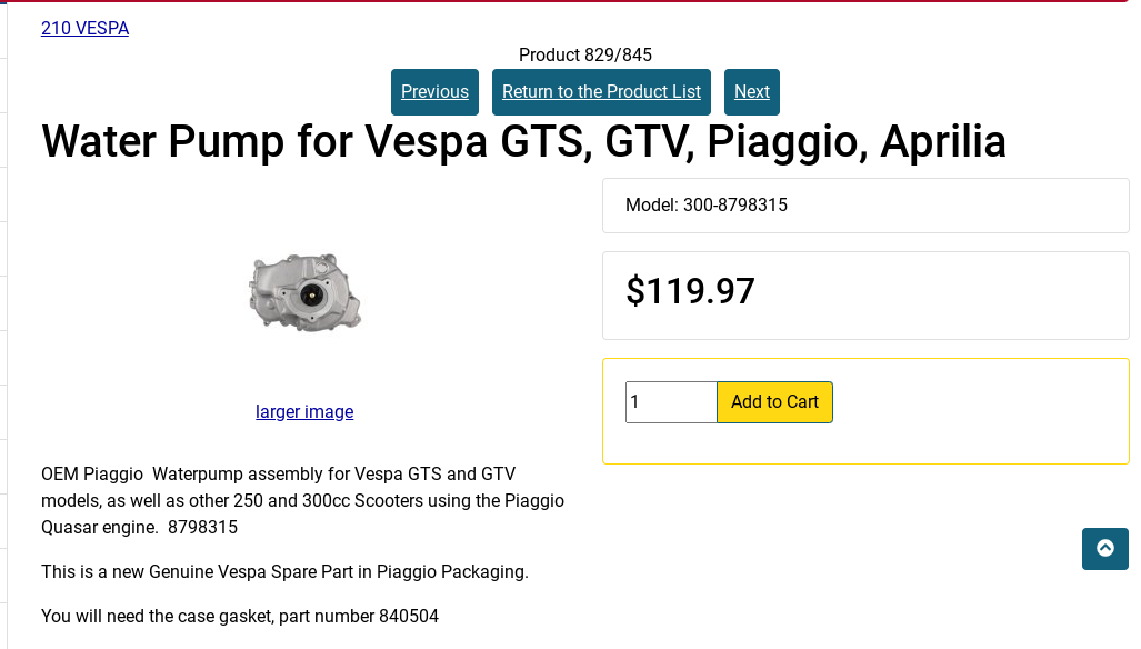

Update, brought to a mechanic because I don't have enough tools and space to do the work myself.
Mechanic said it was indeed the water pump, so he ordered a new part from Germany which doesn't fit. So next, I was going to send the old water pump to scooter west (I think San Diego) so they can rebuild it.
Rebuilding the pump doesn't seem east, however replacing the whole assembly doesn't seem hard I wish I had a way to do it myself.

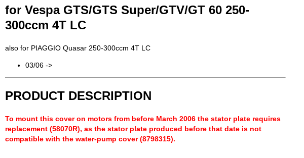

Well that is exactly the same parts they shipped and doesn't fit apparently.
@abner_bjorn avatar
Posts: 1438
Location: Denver
@abner_bjorn avatar
Posts: 1438
Location: Denver
See if he is aware of this:

There is a difference in water pumps for a 2006 GTS 250, depending on when it was manufactured. I ran into this with my 2006 GTS 250.
You may have the same issue. Here is a link to my postings:
Mag pickup damaged in water pump UPDATE
I ended up sending it to Scooterwest to be rebuilt.
