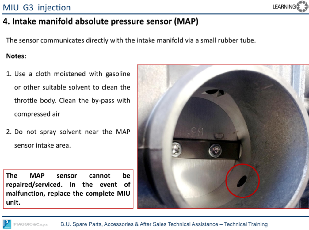

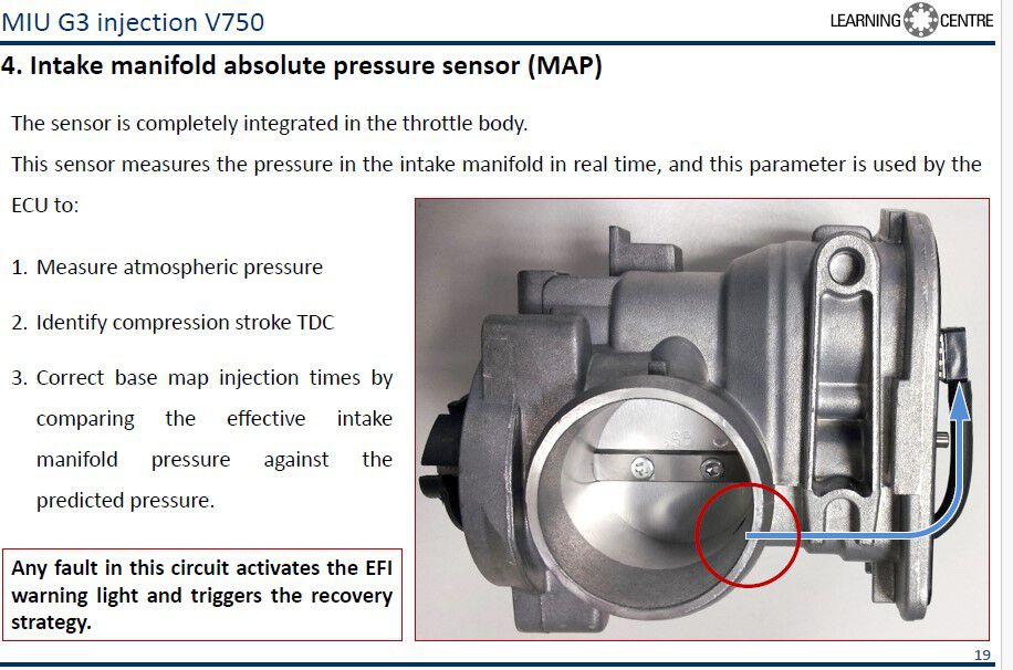

carlssonlove wrote:
Looking in the service manual i see this scooter doesn't have a MAP sensor?
I'm not certain which ecu + tb you have but i think yours does have one.
below is a ecu+tb that piaggio uses from around 2013. I think some of the previous version of these ecus also has one
⚠️ Last edited by SteelBytes on UTC; edited 2 times
Posts: 45826
Posts: 45826
This is a Gilera Fuoco 2010.
Posts: 8298
Posts: 8298
yes, but what is the ecu/tb? I know it's not a miug3 but is it a miu1? or what? I only showed the 3 photo because it was a handy photo to show the MAP. Both the 1* and 3 have a MAP
* couldn't find a photo but it is in the miu1 code

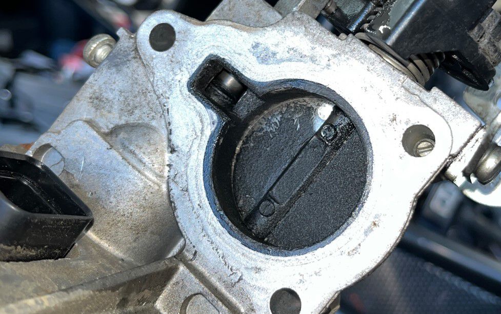

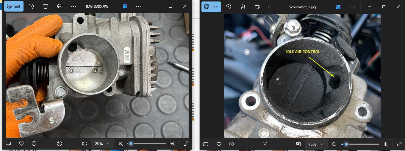

i'll attach pictures below, for developing the subject since we are on it. The ones you posted have an internal map sensor indeed, there is a tube that goes to the sensor, but if it's on the PCB not worth repairing also
This is before and after i opened it to clean it, because if i didn't opened it from the stepper motor and TPS cleaning solutions could get inside and damage the PCB
⚠️ Last edited by carlssonlove on UTC; edited 1 time

and this is the one with the MAP sensor onboard.
i was thinking that this variant of FUOCO 500 may have an external map sensor the there's no vacuum hose anywhere on the intake manifold, air box or other place.
