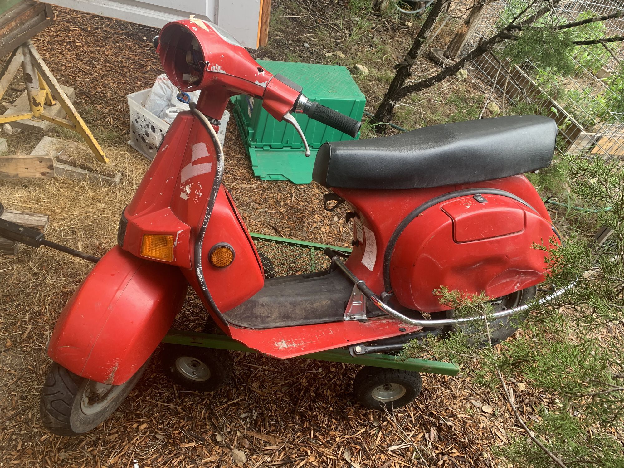

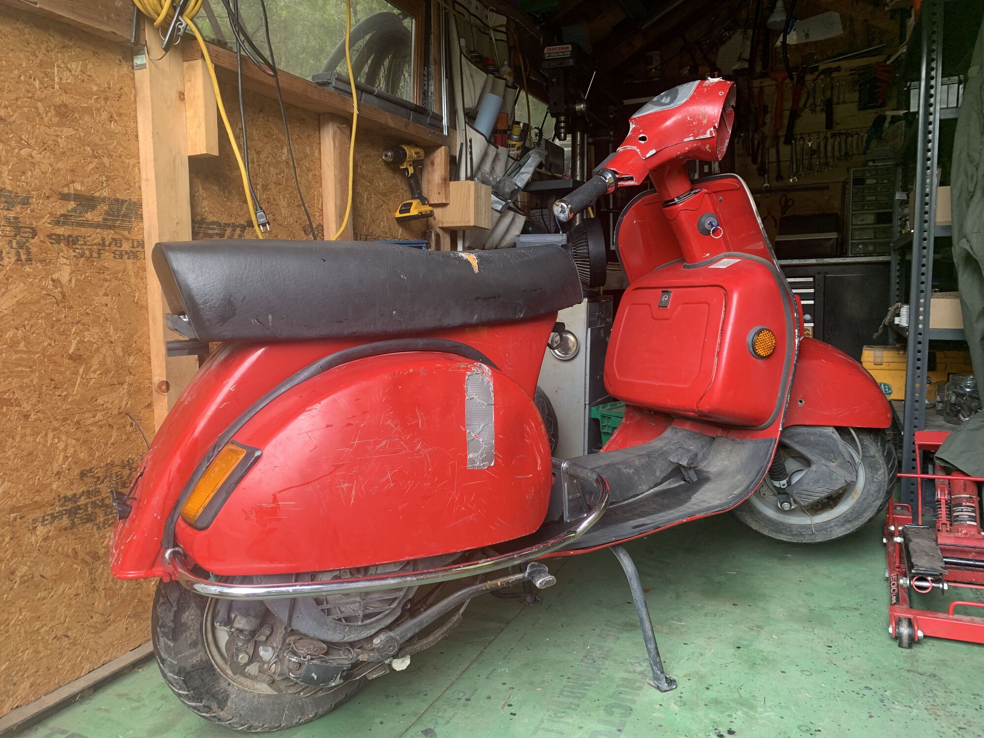

I'm doing a rebuild and EV conversion of a beaten-down 2004 Bajaj Chetak 4S. $200 Will be a mechanical rebuild only, the 'patina' will remain mostly as-is. Done a few EV conversions before so that side I have under control. This is my first 'vespa' so that's a new adventure. Done a bit of research and found that parts interchangeability between Chetak and other Vespas is hit-or-miss, so I may need to draw on the hive mind here from time to time. So I thought I'd just post up and say hello!
Here's the beauty:

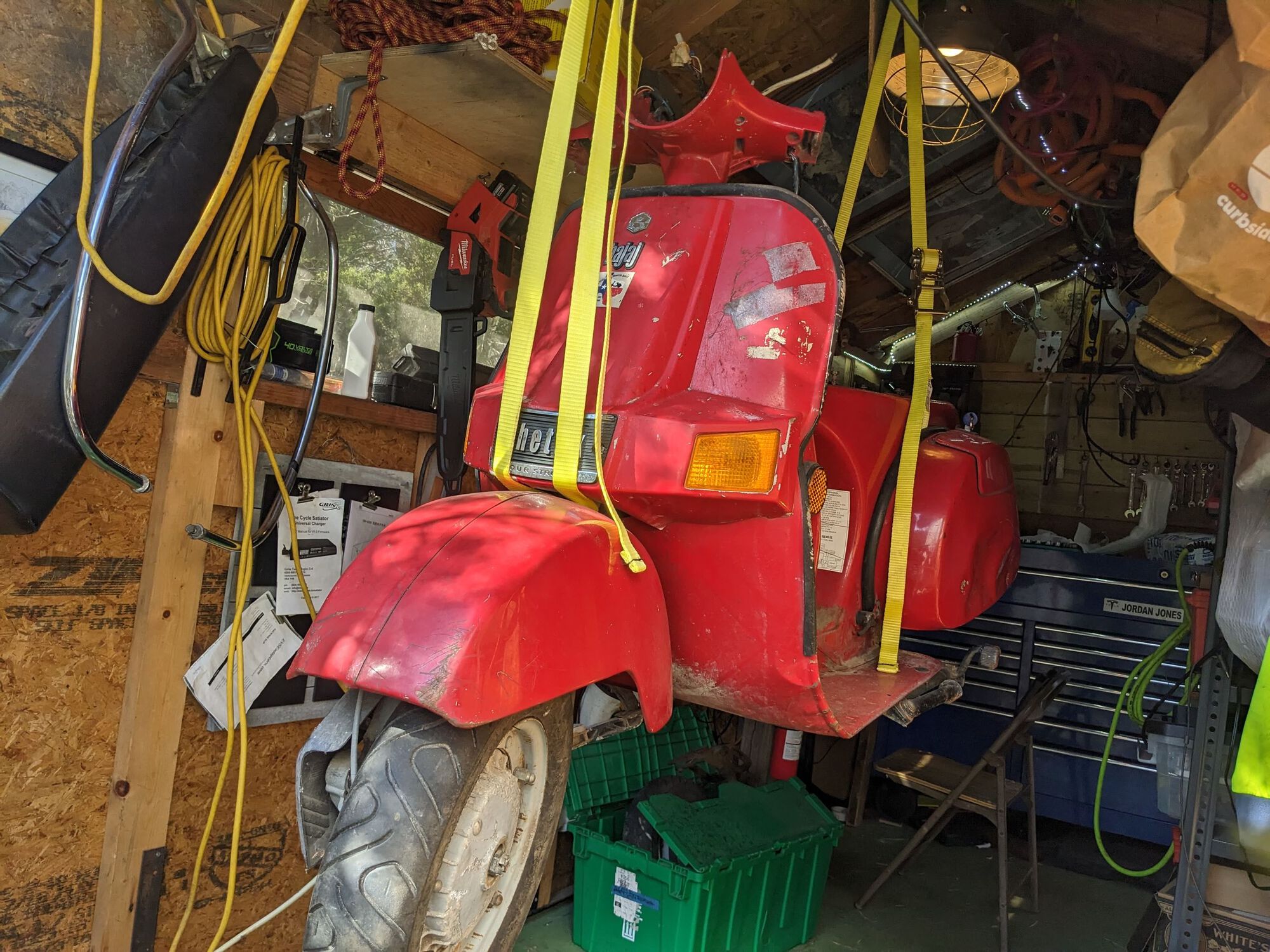

Lifted from the ceiling

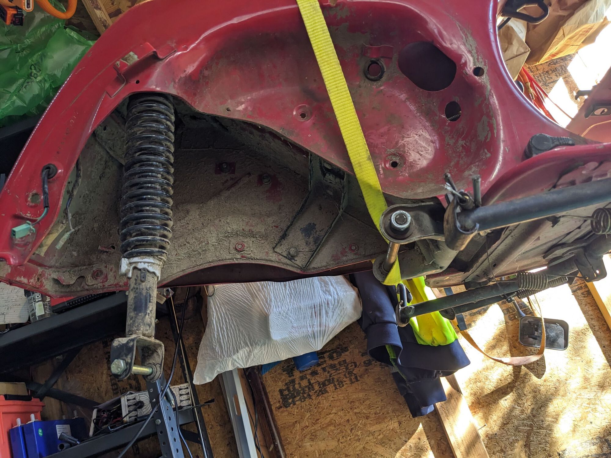

Pulled engine
Pulled engine

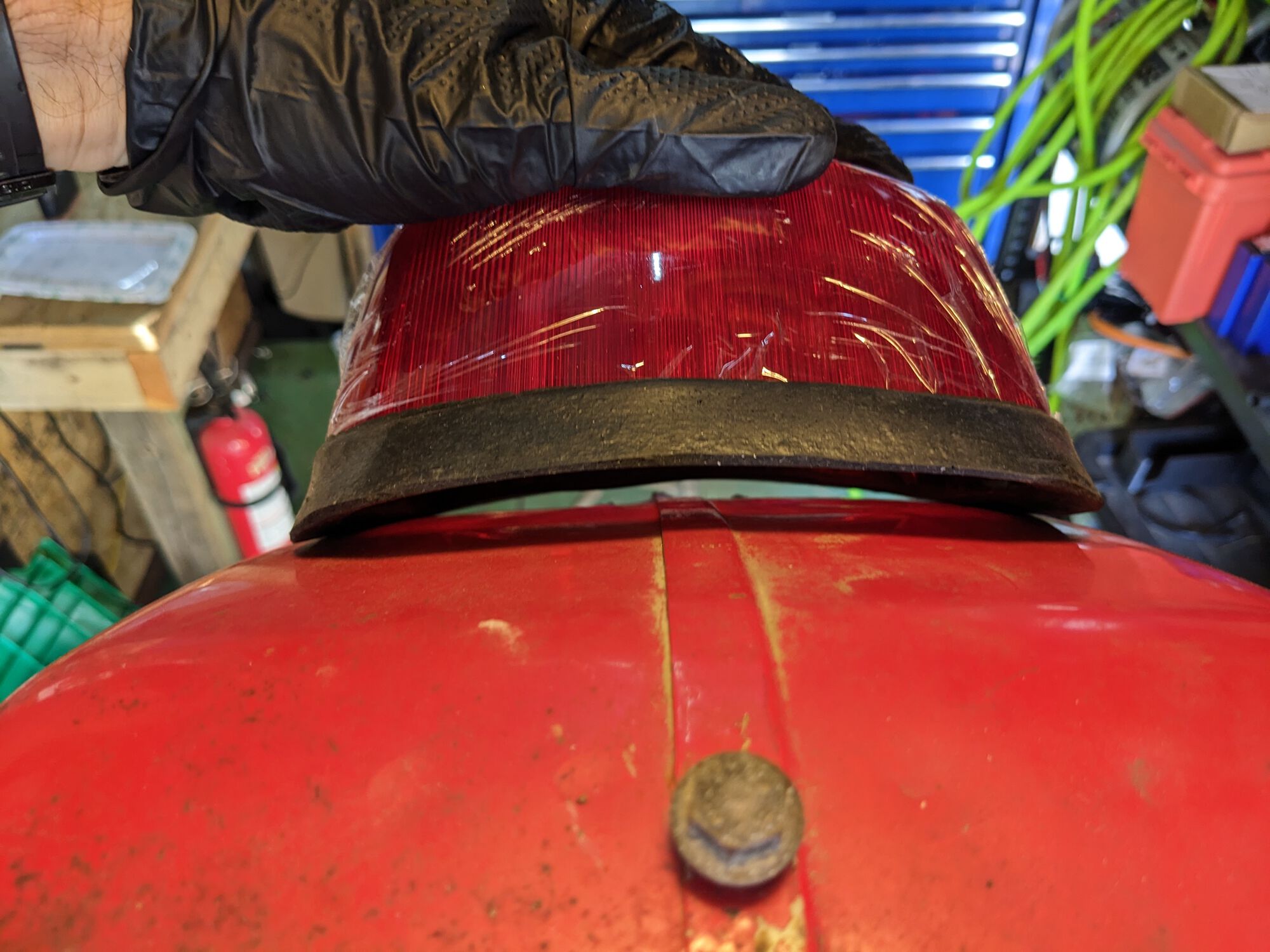

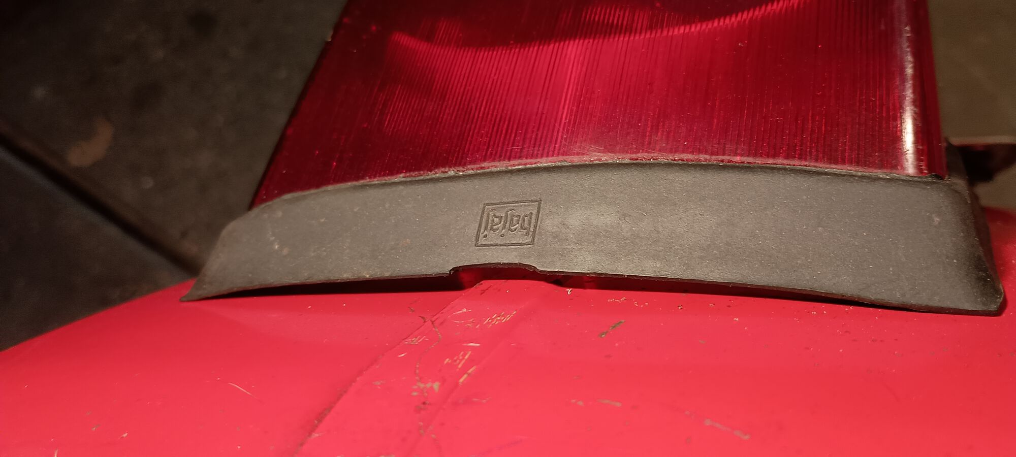

First part has arrived. It was actually one of the few parts I found that seemed pretty straight-forward, as it's commonly available and lists as a direct fit the Bajaj Chetak 4 Stroke.
Surprise surprise, doesn't fit. Too curved for this flat rear fender.
Per this old website a Stella one may fit with some modification:
https://orphanbajajusa.weebly.com/parts/taillight-replacement-with-stella-taillight
It does appear much flatter...
I've sourced one from India. Hopefully it fits.

The Bajaj is a strange beast. They are around - there seems to always be one up for sale on the Marketplace. I never owned one because of the uniqueness of the scooter and the problems thereof, specifically finding parts. Something like the Stella 4T - probably not a bad ride, but tough to get parts for. It also seems that any rubber bits disintegrate rather quickly. This ranges through all Indian made scoots, be it Bajaj, Stella, Royal Enfield, etc.... Good luck with the scoot, sorry I could not help any.

I'll be following along and rooting for you! My latest project (Bajaj LML 🇮🇳 hybrid w/ autolube & electric start) was also repowering a Bajaj 4T, but I used a Stella 2T motor. And small world, here you are using a Stella tail light and I had similar issues using a random Bajaj tail light on my Bajaj. The curve didn't match but not as bad as yours, so I settled for good enough and am just pretending it's 'proper'.

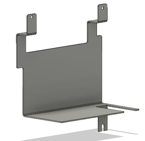

HV Battery fitment will be tricky, but I think I'll be able to fit it with a little massaging. 88V40ah pack. Threw together a rough battery tray mockup today, it's 3D printing currently and I'll be able to see how close I am. Shouldn't have to drill any holes... not in the pursuit of originality really, just out of laziness.

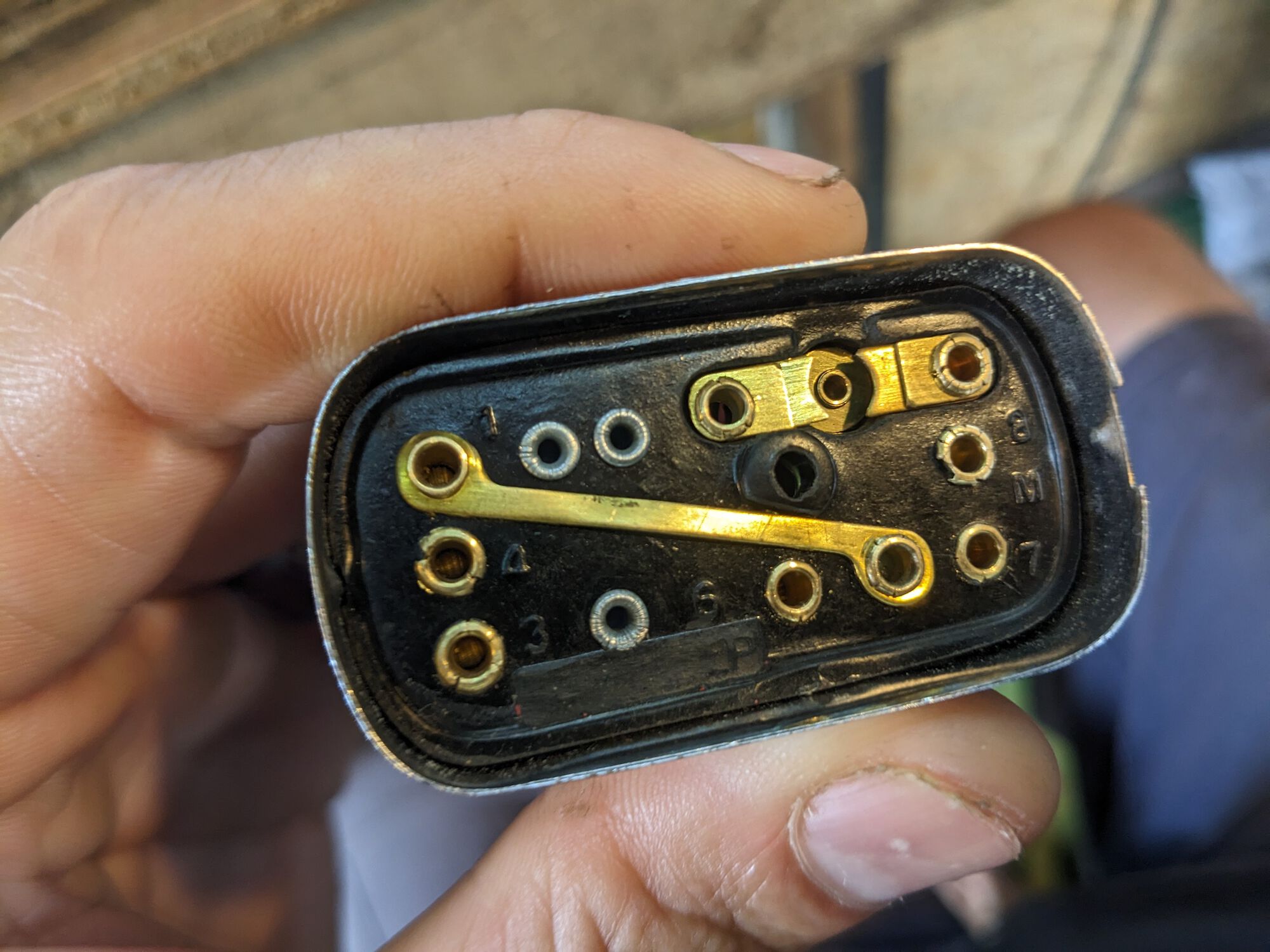

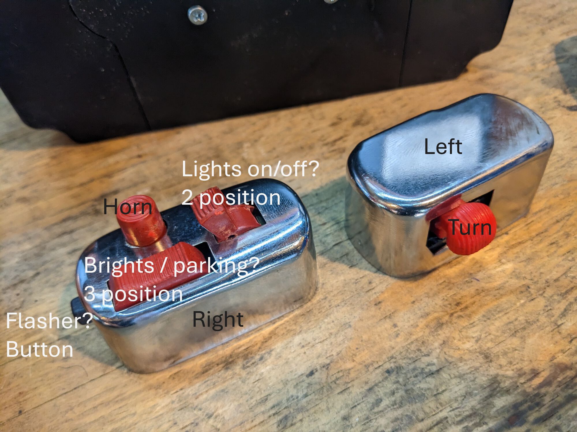

First: I can't figure out the RH handlebar switch. It has a 2 position toggle, I assume that's headlights on/off. There's a button on the side, I assume that's flash. But then there's a 3 position toggle... is that for brights/parking? The old sprint user manual doesn't say what the buttons do, and I'd like to retain the stock functionality.
Second, how does the OEM wiring connect to the back of the switches? Is it a male bullet connector, or soldered on? Is this what I'd need?

Looks correct in the switch pictures except the toggle is off/pilot and tail light on/ everything on, and the rocker switch is high and low beam. The button on the side is the kill button. The wires go in those holes and have screws on the flip side to secure them. Make sure the tips are tinned so you get a good connection.

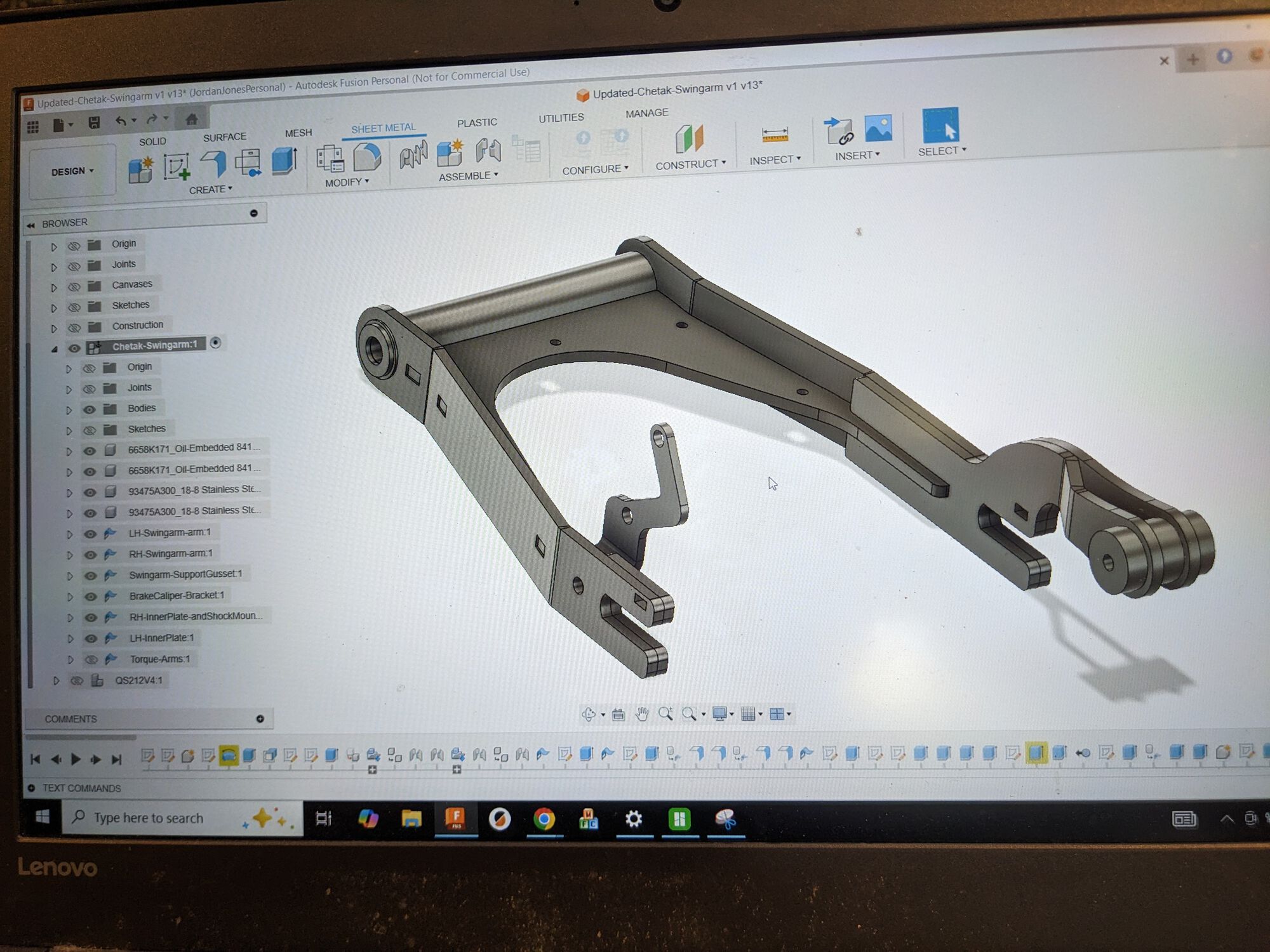

All goes well I'll just hand those 8 laser-cut pieces to my local tig welder, it all slots together and he'll hand me back a finished swingarm. In theory anyway...
Swingarm-CAD
Swingarm-CAD
