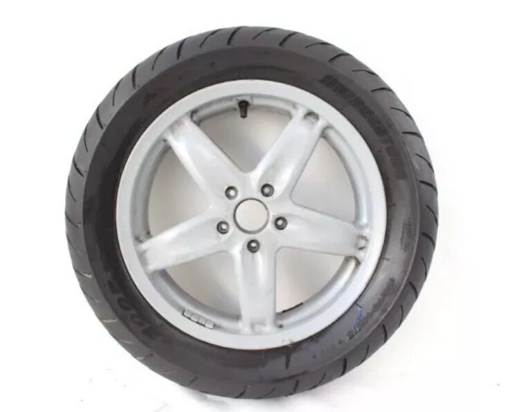

On the X9500SL the rare wheel does not have a wheel bearing, the wheel sits on a toothed spine that is then bolted on with 4 bolts, that then has the swingarm bolted it....that has a bearing on it that thr shaft and wheel rotate on, is it this you mean ?
If so I'll check the swingarm bearing the wheel sits on, I did feel it when last off when doing servicing and it felt smooth to turn ?
I'm definitely going to take it off take another look though as you have a good point, its one bearing that's never been changed.
