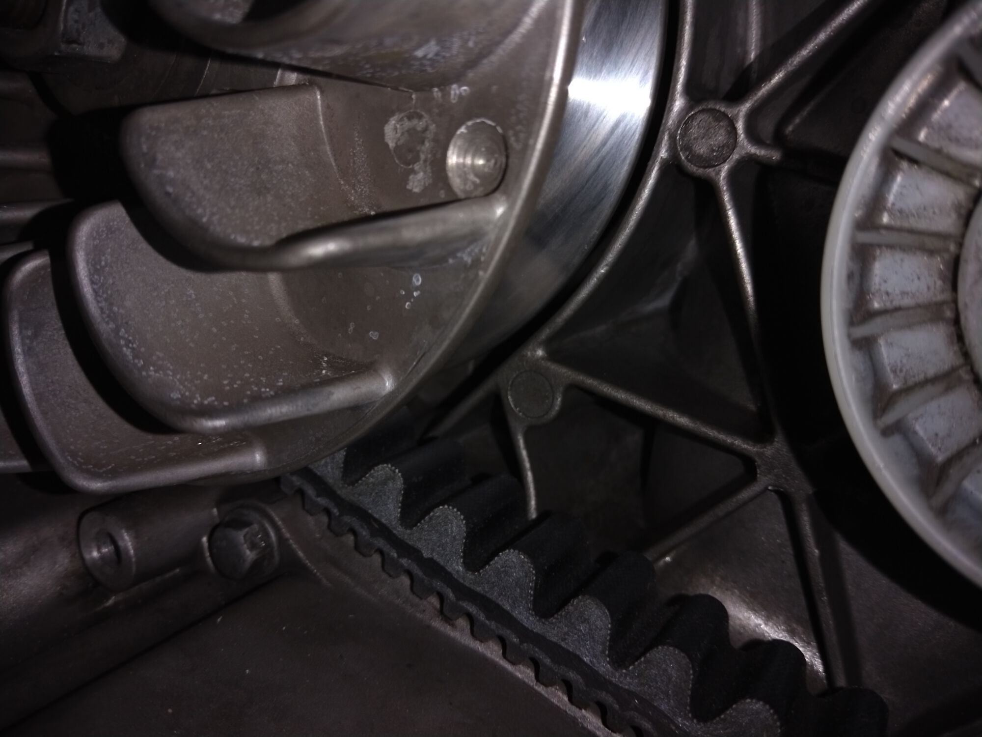

A small oil leak in the crankcase behind the Vario, i wonder why?
Oeps 🤣
Oeps 🤣

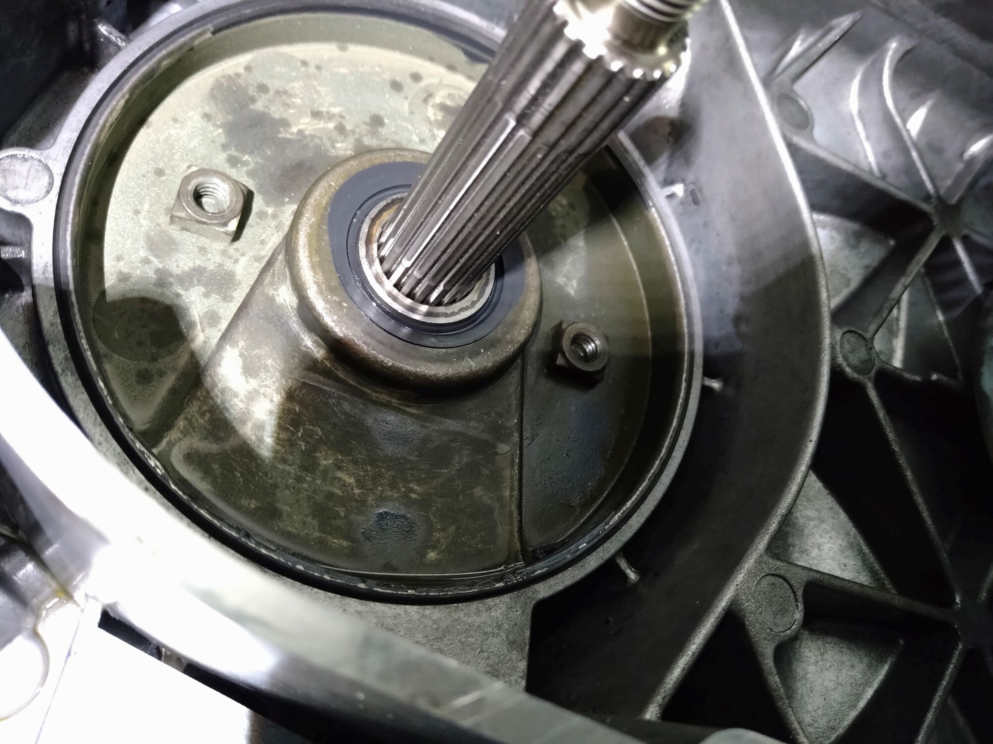

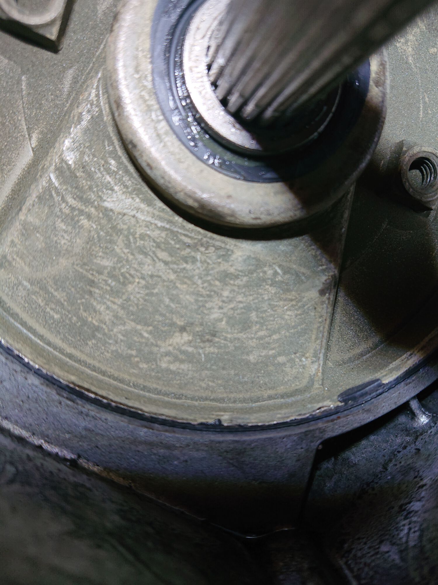

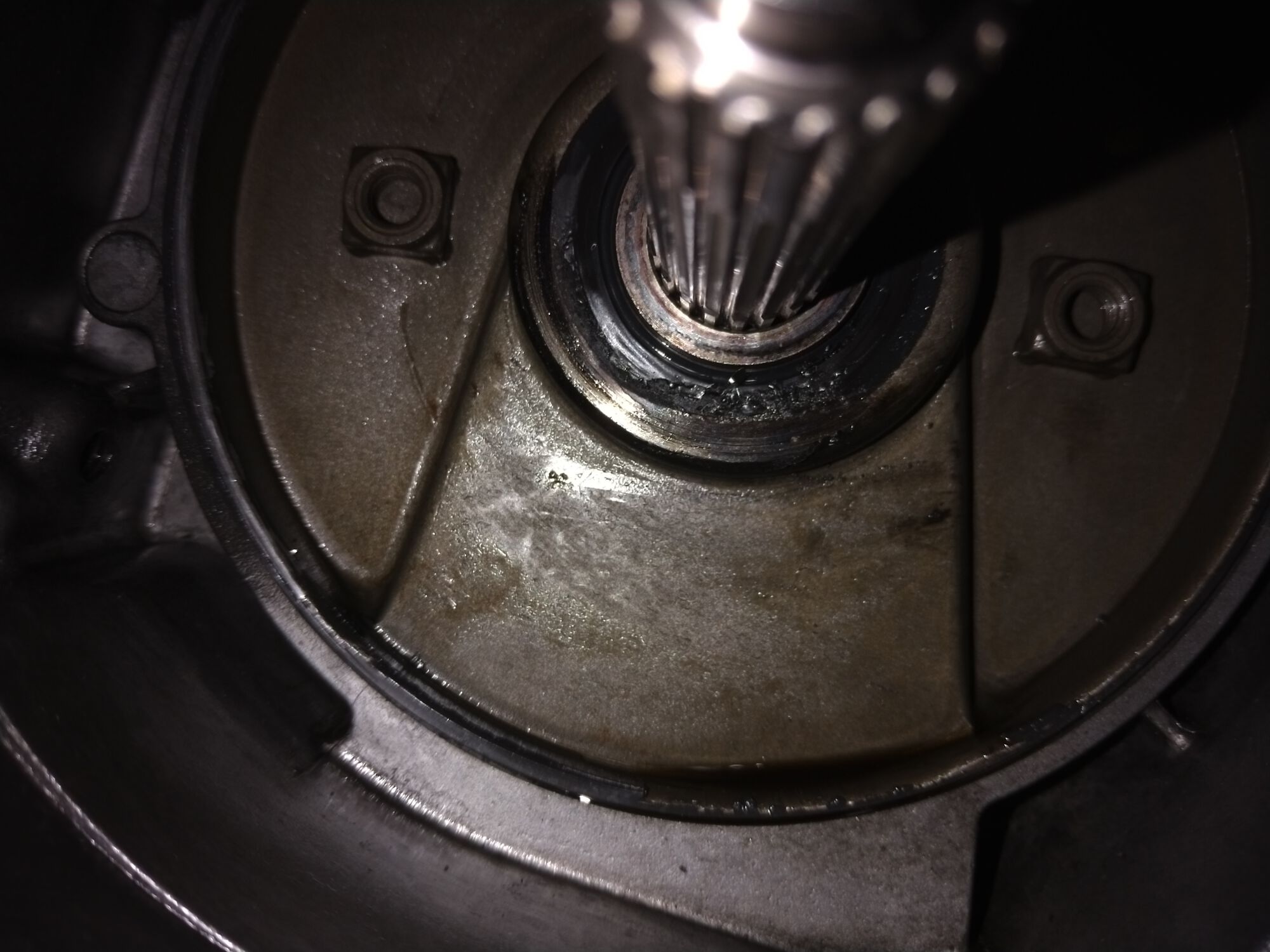

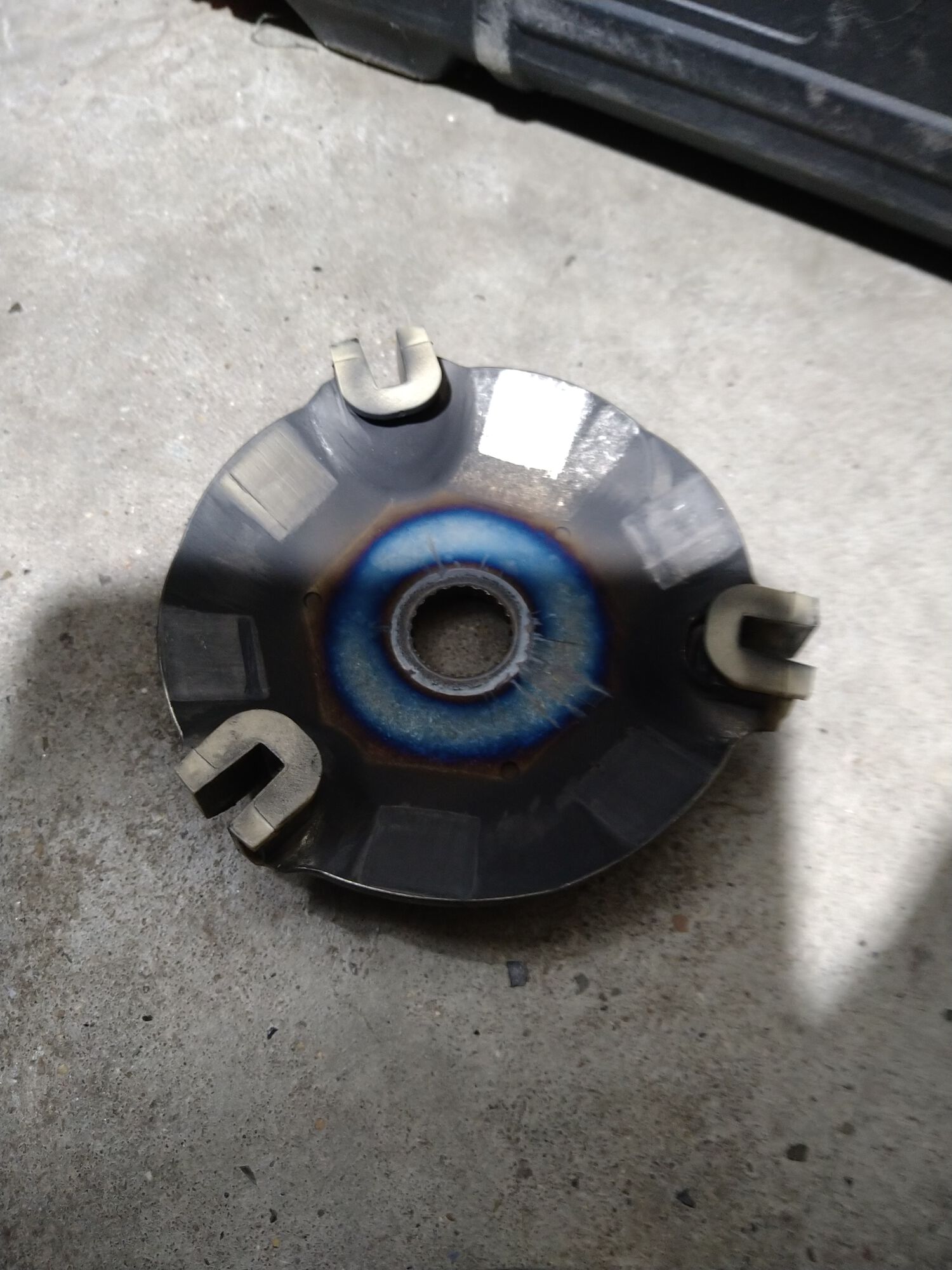

I have no clue what caused the scratches in the ram plate,....do you?

Looks at that back plate and oil seal.
It will need to be replaced.

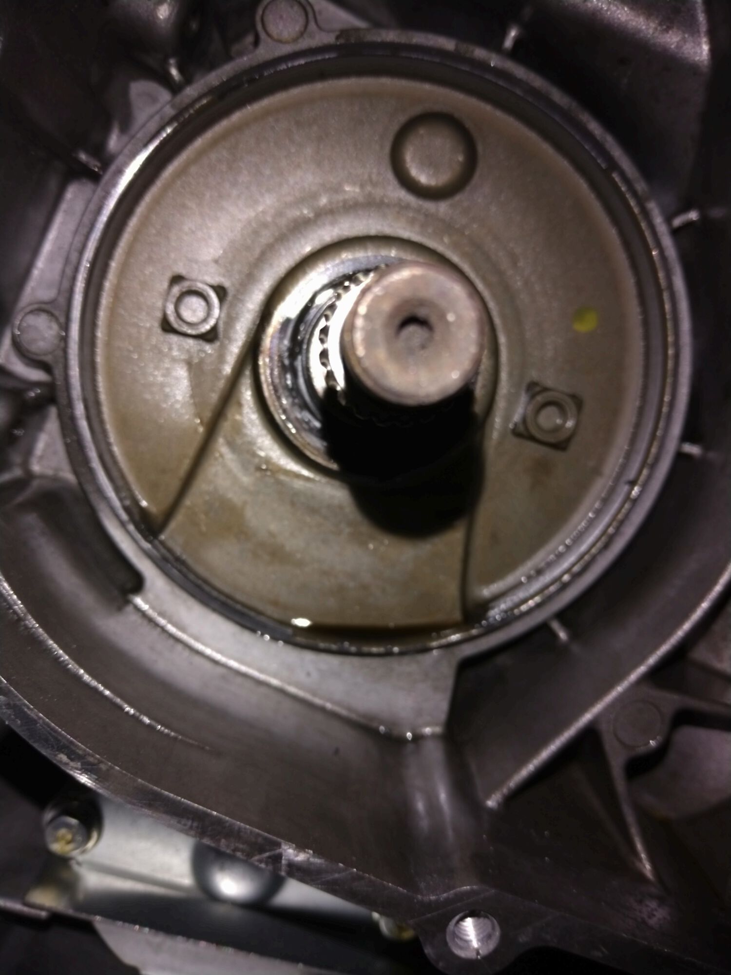

A better view.
@safis avatar
Posts: 5068
@safis avatar
Posts: 5068
Probably not torqued to spec, pump cog was spinning like crazy on the pulley plate, friction did the rest...

all original, never opend up..6500 km... makes you think.
Posts: 45711
Posts: 45711
And just out of warranty I suppose.

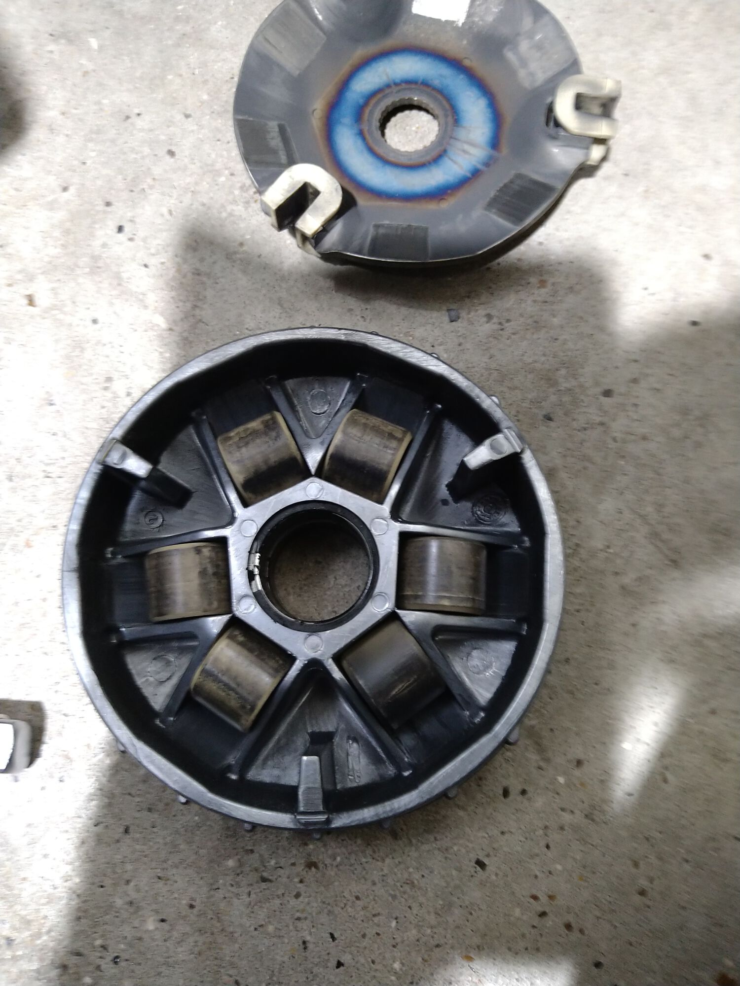

Hopefully a new Malossi multivar with 14 gram rollers will do the trick.
thank you for your support.
Posts: 45711
Posts: 45711
Once that seal's been replaced.

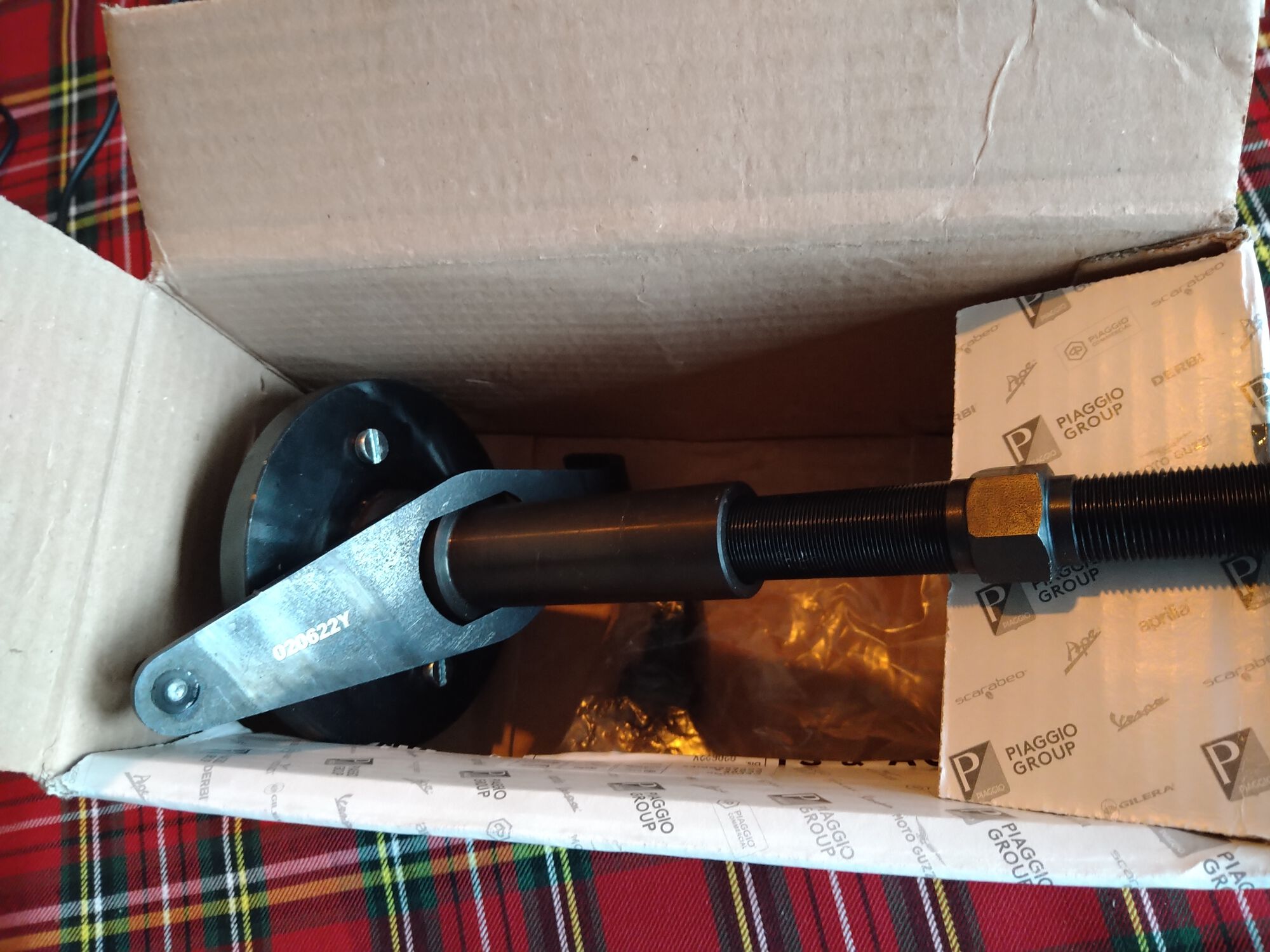

Piaggio Group....really?
A bolt is a bolt, not a washer in sight, torque with a screwdriver, you can do better than this.
A flimsy thread, just like mine 🤣

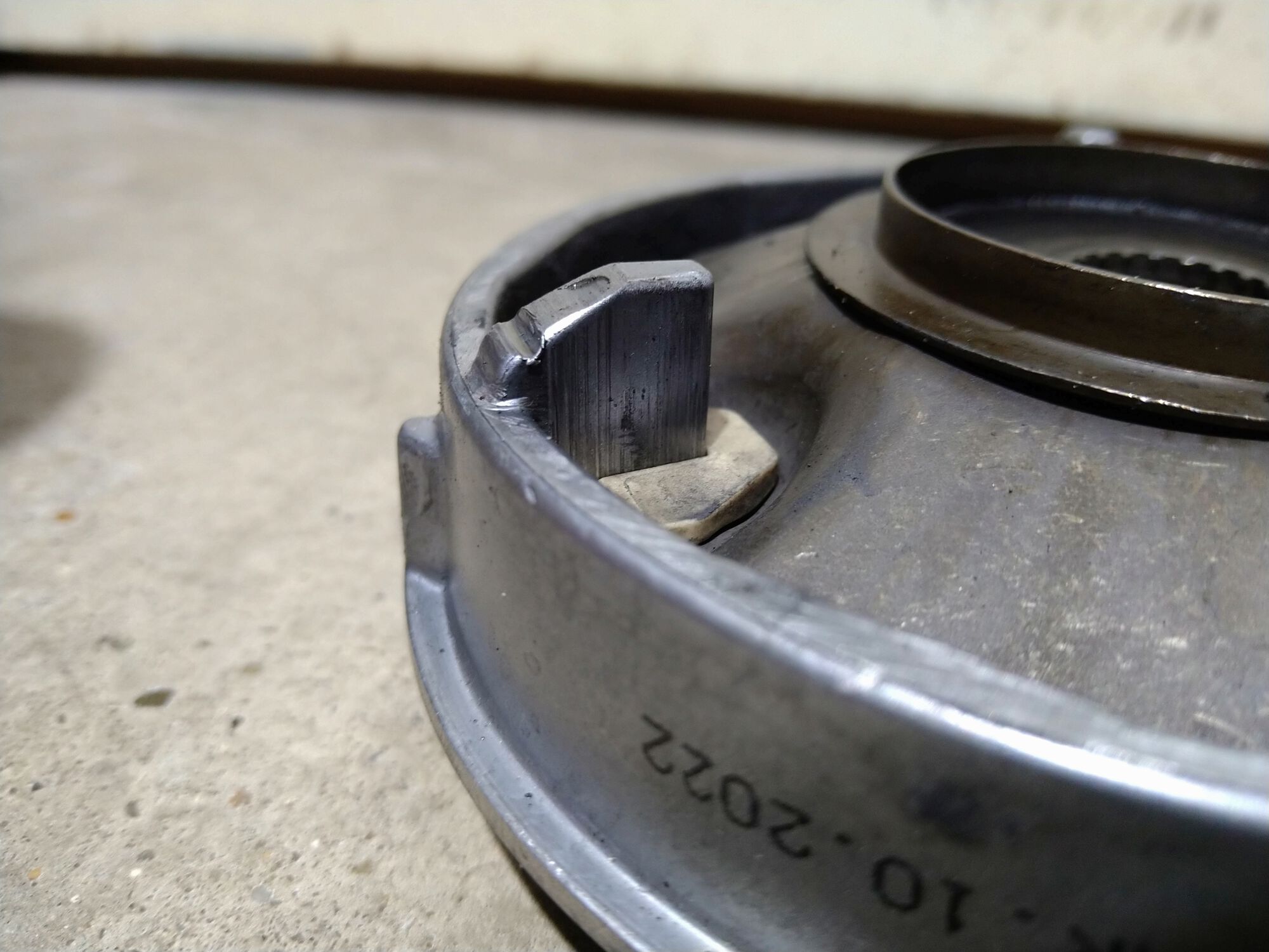

Is it normal wear and tear or very strange and unusual?
Weird stuff.
Weird stuff.

Dutchdiver wrote:
New cover and seal in place.
It looks like the gear of the oil pump is worn.it should come out 2 mm out of the seal

XRISTOS,thank you, you are absolutely right about the wear on the gear of the oil pump, and scary enough it is driven by friction/torque and not by the splines on the crankshaft, a risky design,in my humble opinion.
I've ordered a new oil pump gear and will change it asap.
