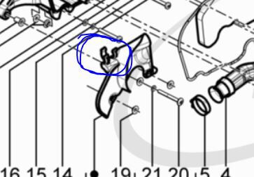

I had a simliar issue with my yourban. issue cold starting.
check the pipe that goes from the airfilter to the top of the engine. As mine had split.
See the attached image its only a small pipe that is attached to the clip in the image
Apparently this pipe helps with starting well when I replaced mine the mp3 started fine afterwards.
Worth a look

Have a nice day everyone. This is the crankcase ventilation tube, it goes to the filter. (sorry for my English, I'm writing from a Google translator).
