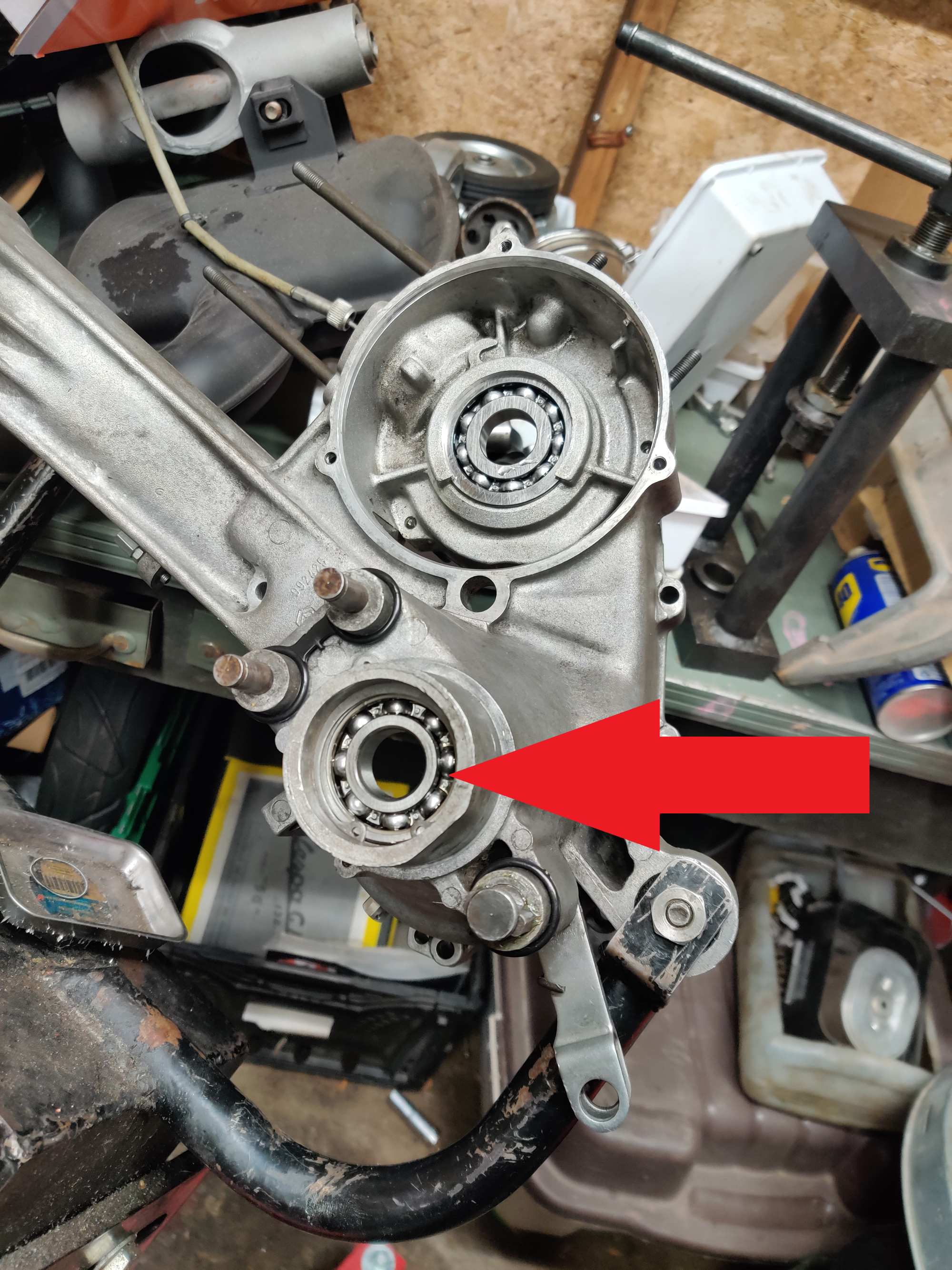

Thank you for your response FINYoshi. Unfortunately out of the many pictures I took during disassembly I did not take a good one of this setup. Here is the closest thing I have. The link you sent me that part does not look familiar.

Isn't that the front wheel shaft? What The? emoticon
You seem to have your driveshaft out of the engine. Take a picture of that and also
one of your driveshaft bearing from the other side.

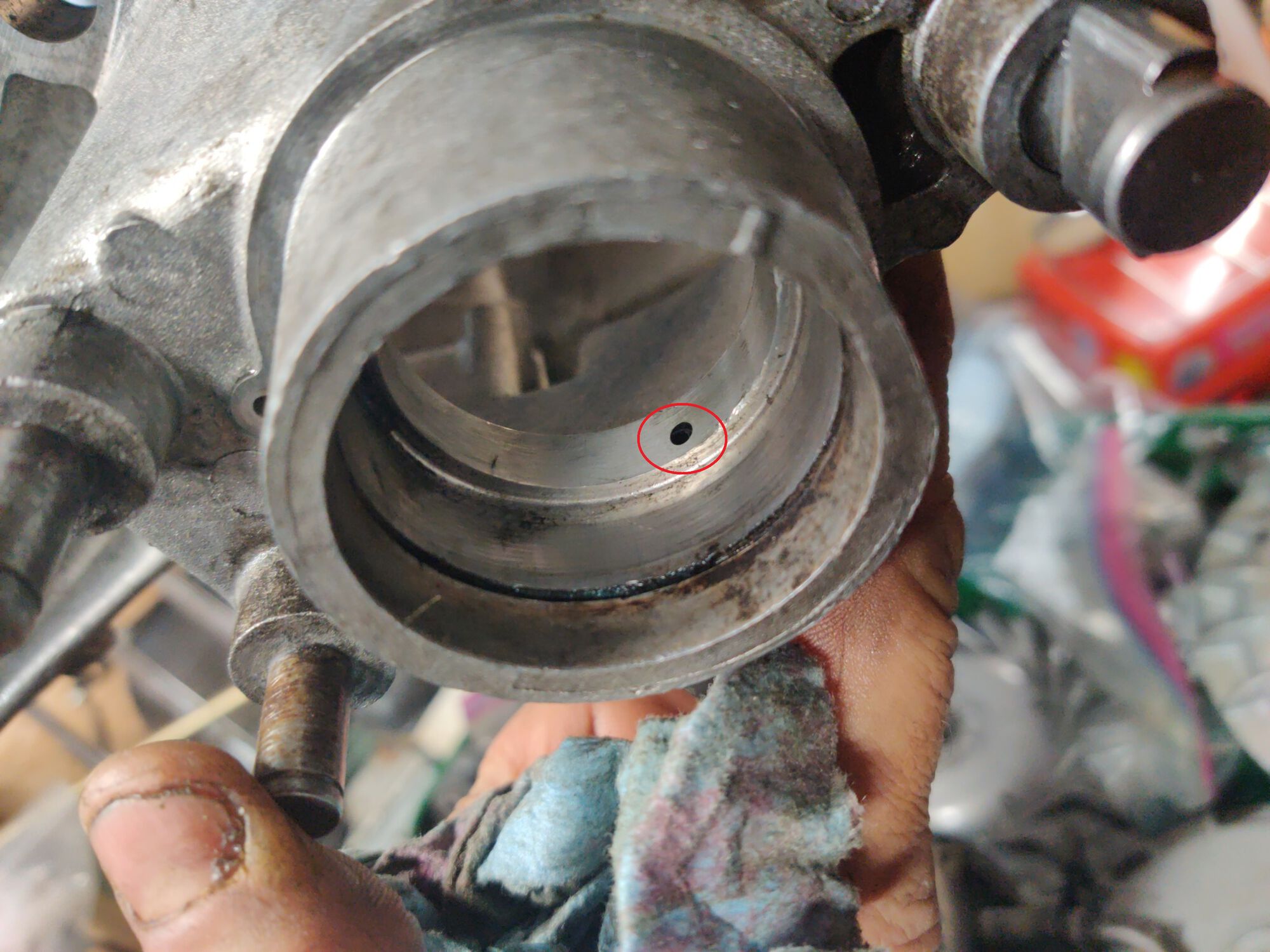

Also have a look if you have this hole in your engine case.
Drive shaft seal leaking (Post 2669920)

Very very good eye regarding the front!
I am away from my engine at the moment and I am trying to do my best to find pictures that can help.
I did find the following picture that I hope can be of help. It does show a hole and I do believe it is the rear.

Vespa T5
Posts: 9
Location: Kingston Ontario Canada
Vespa T5
Posts: 9
You are a god sent! Thank you so much!
