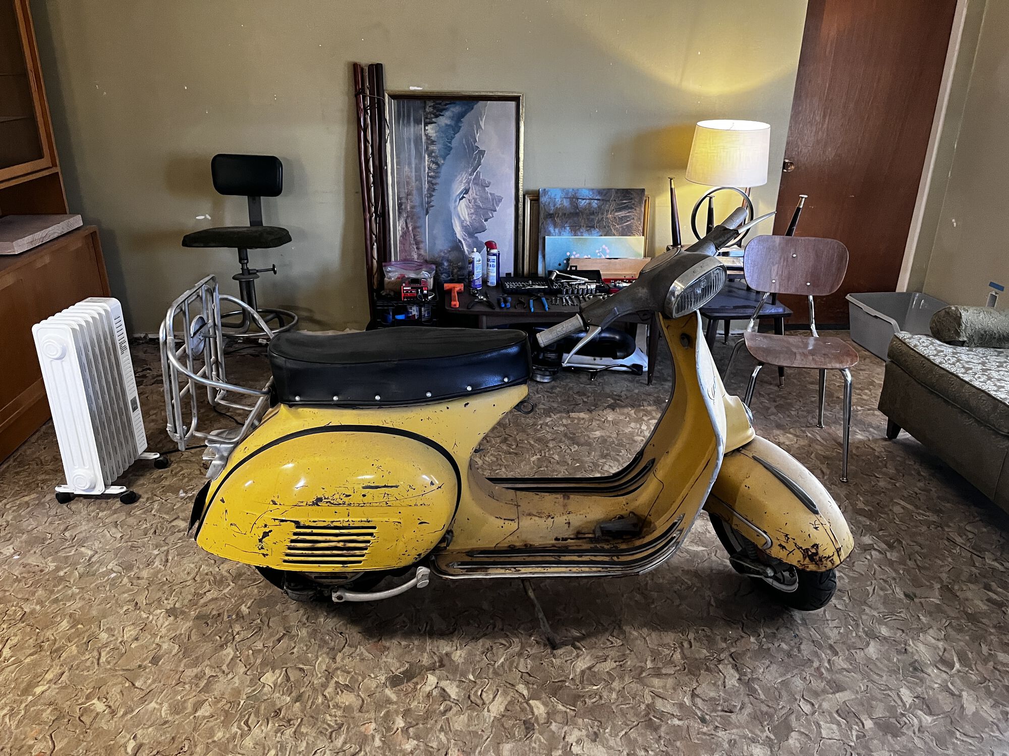

The soon-to-be end of winter is a great time to start a new Vespa project. So I've started a new side project thats been waiting in the shop for some time, a 1964 Vespa GL 150.
I acquired this Vespa in Oregon a few years ago, and have somehow resisted the strong urge to tear into it immediately. This GL is mostly original and complete, although it has been repainted "Golden" Yellow at some point early in its life. It has been off the road since '78, based on the last registration sticker.
The plan all along has been to build this together with my daughter, for her first Vespa project. We finally both made the time, mental space, and focus to take the first steps. We had a great time tearing it down and getting our hands dirty together. That was the easy part, now the real fun begins.
The body and panels are in good straight condition. Only some minor massaging needed, and no major rust or cancer is present. It does have its fair share of love scratches, so i was definitely well enjoyed. It has character to put it another way.
The Golden Yellow GL inside, where its warm and toasty

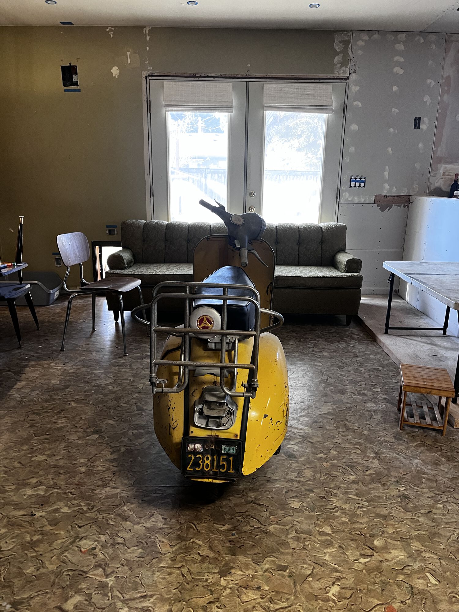

Nice rear view, and view of the outdoors. Ignore the in progress room remodel lol

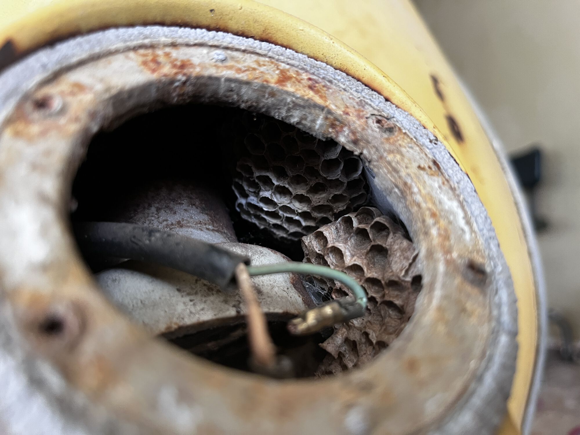

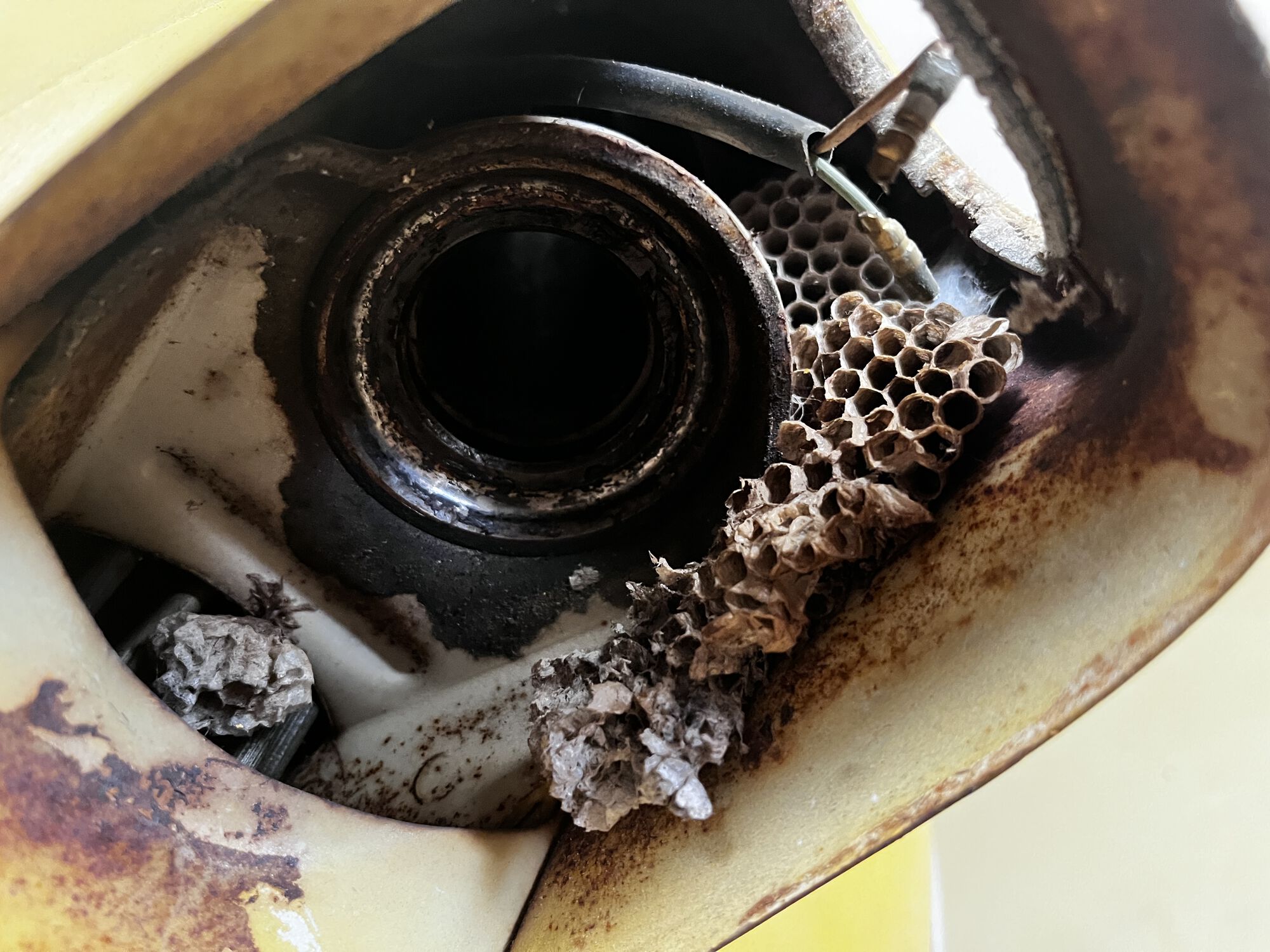

Lots of wasps nests in this wasp
More wasps in the wasp

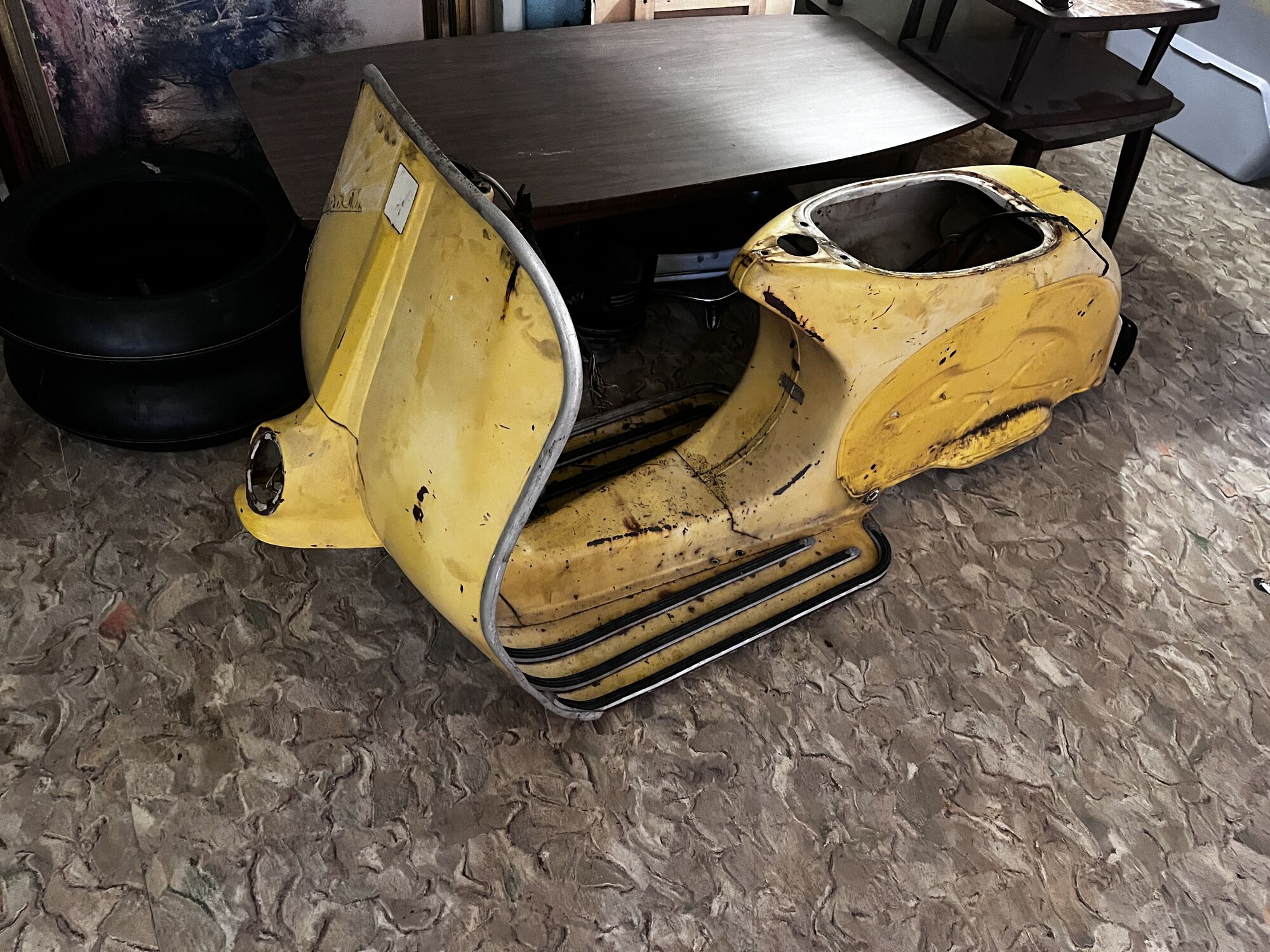

After a bit of work, we are down to a bare frame; ready to build back up clean and fresh
Nice tidy pile of bits to refresh

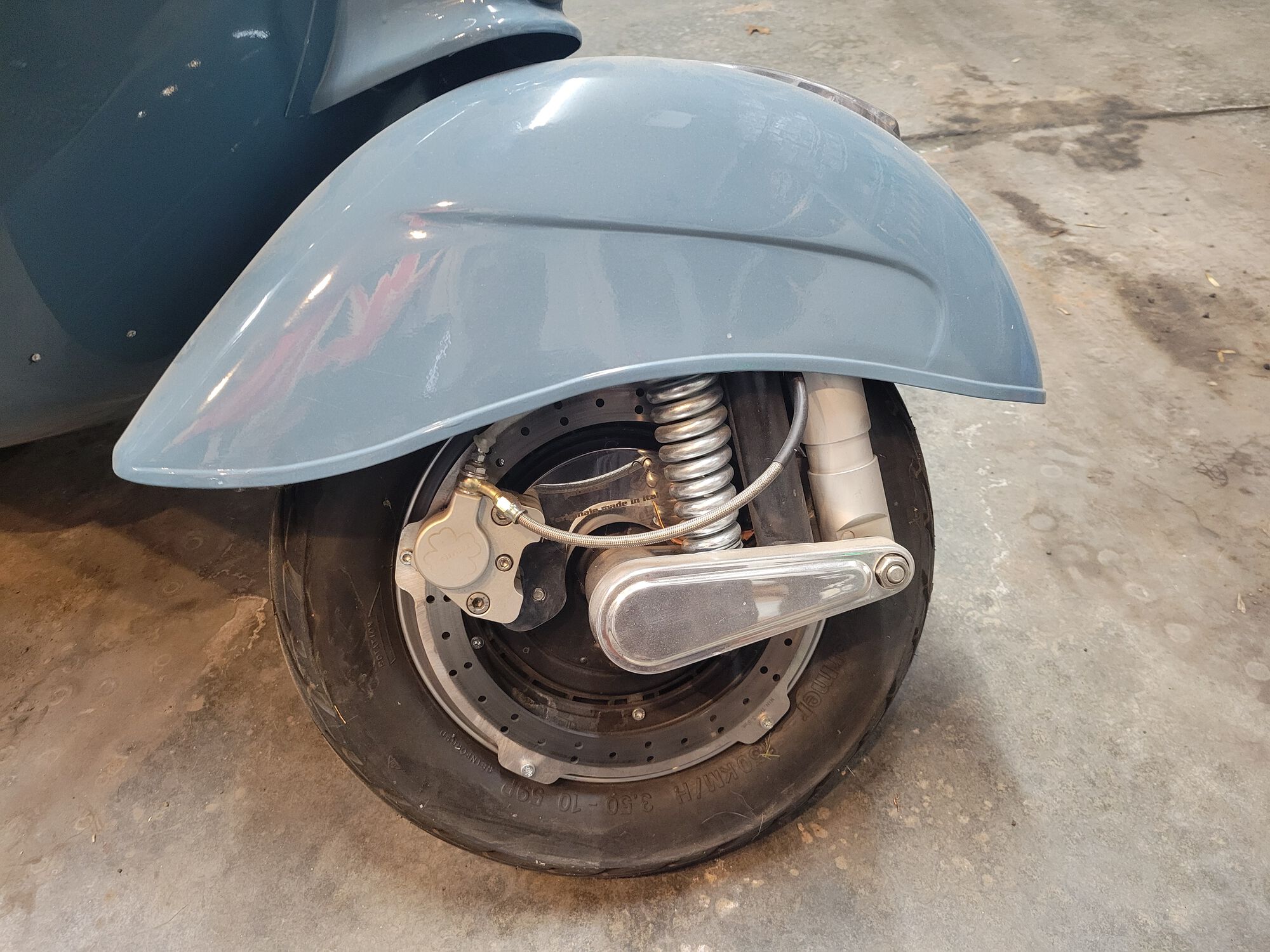

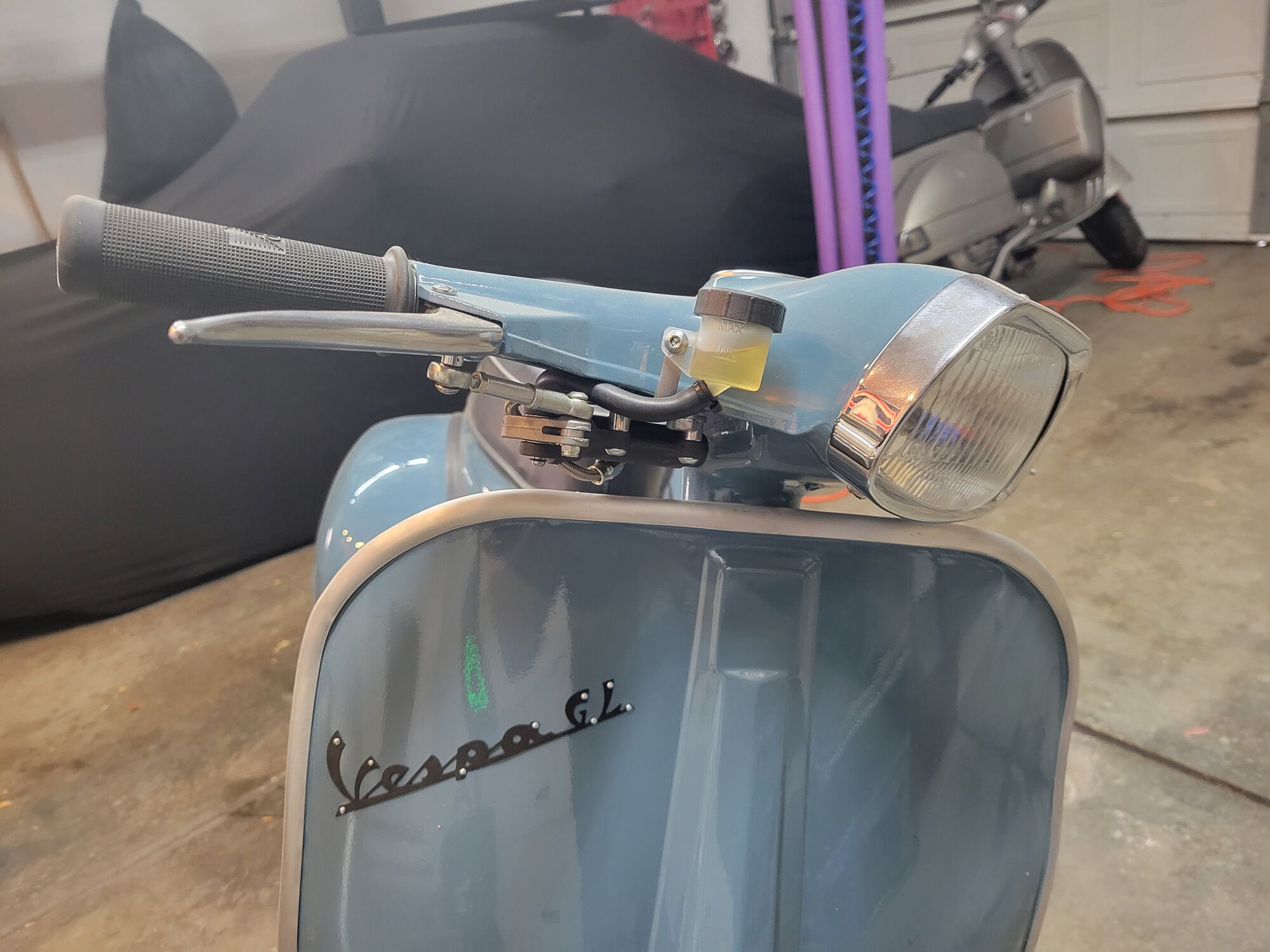

Here are a couple of pics om my gl with the crimaz disc . There is one available without the fluid reservoir.

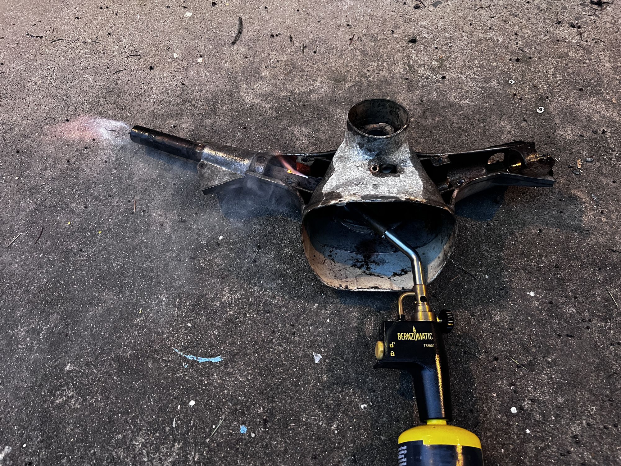

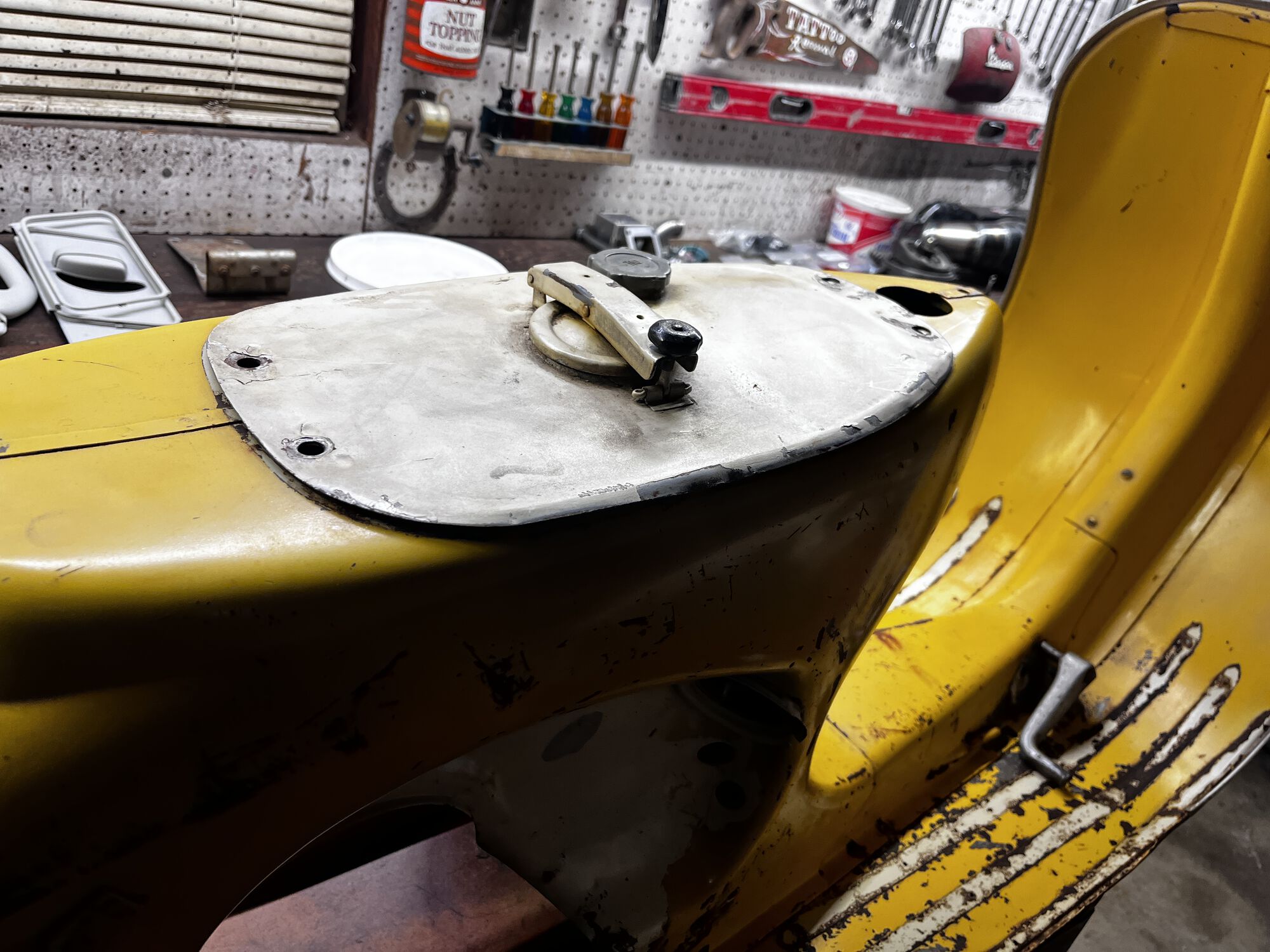

A bit of progress finishing up the breakdown of this GL.

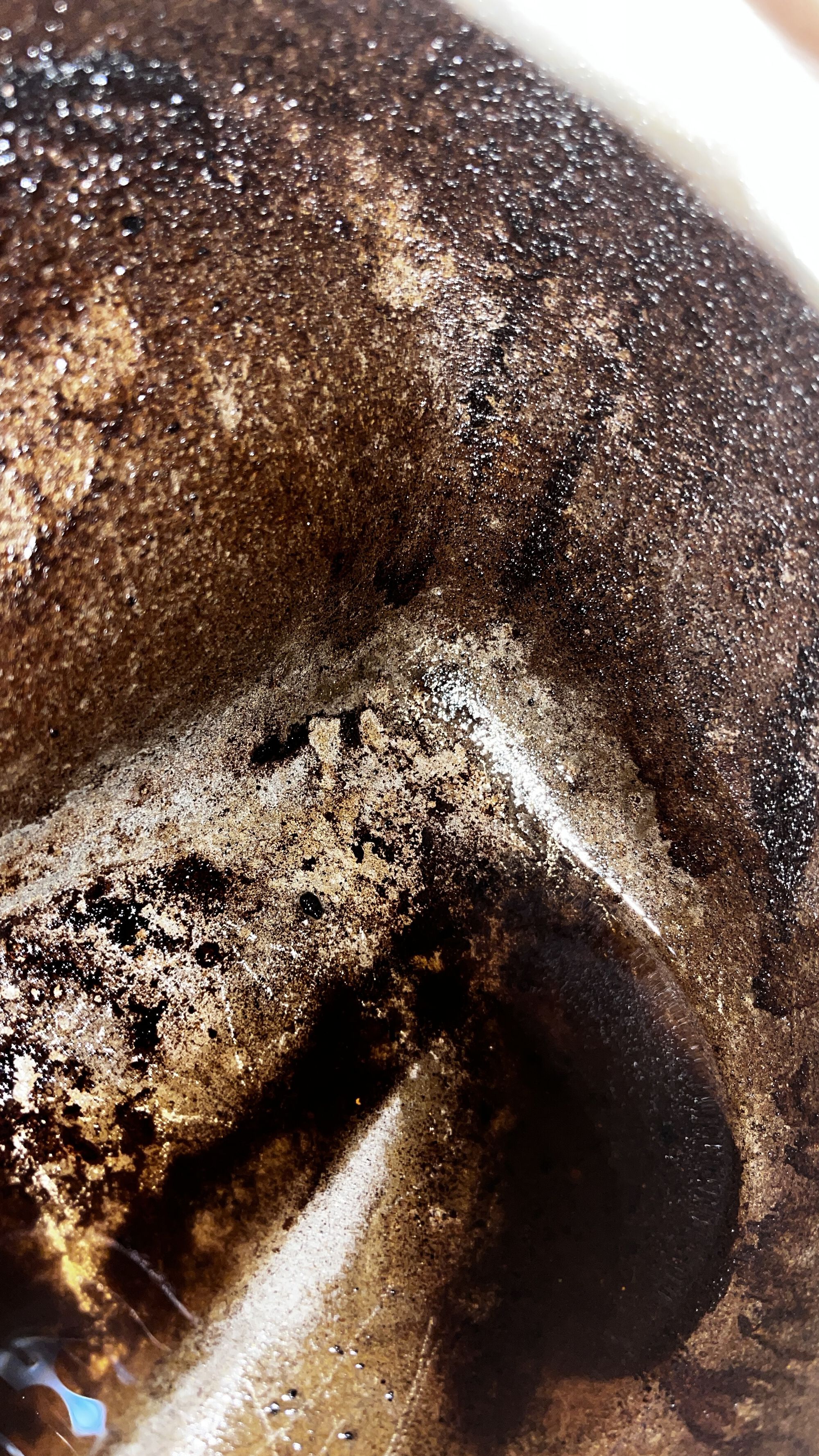

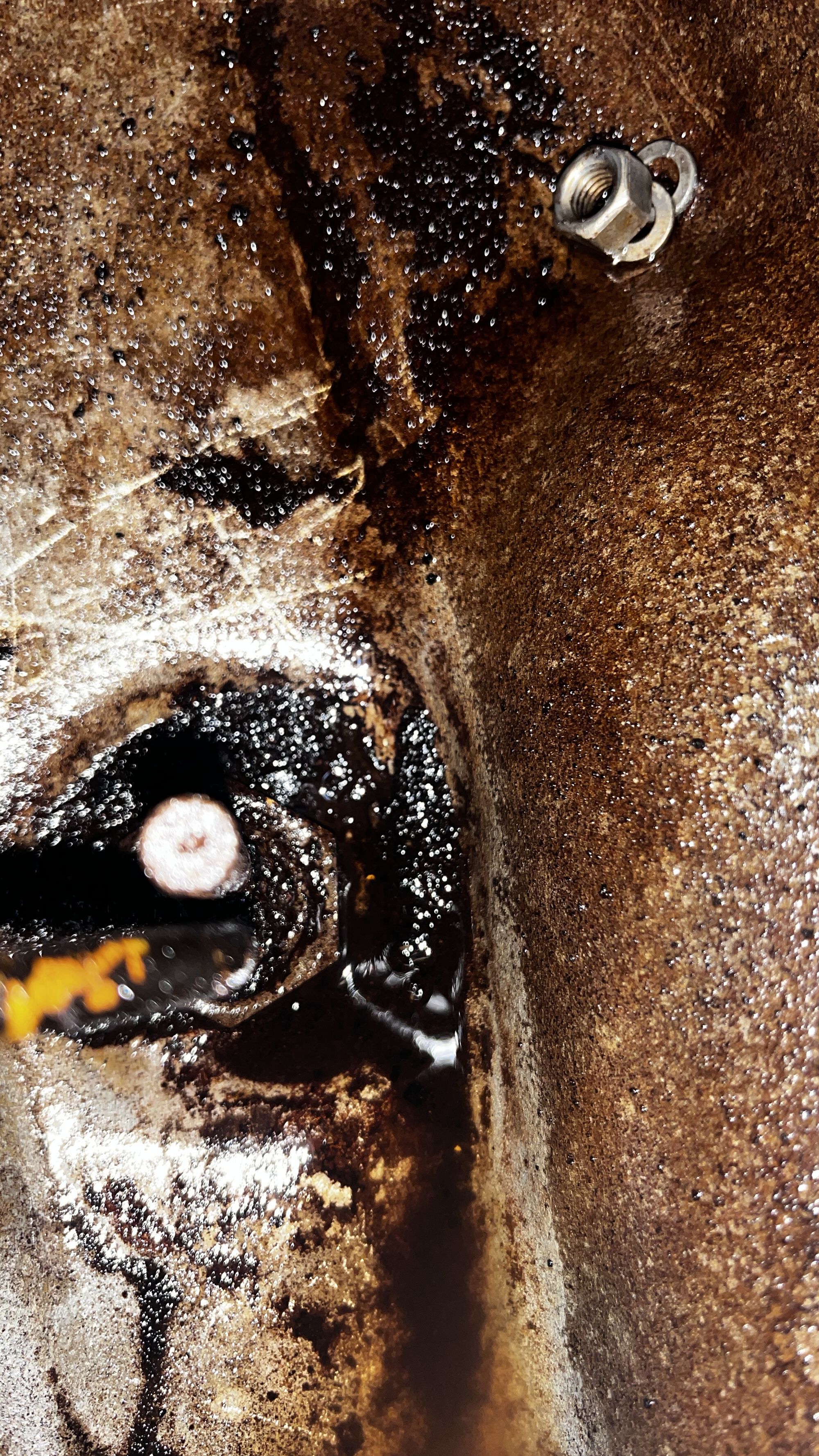

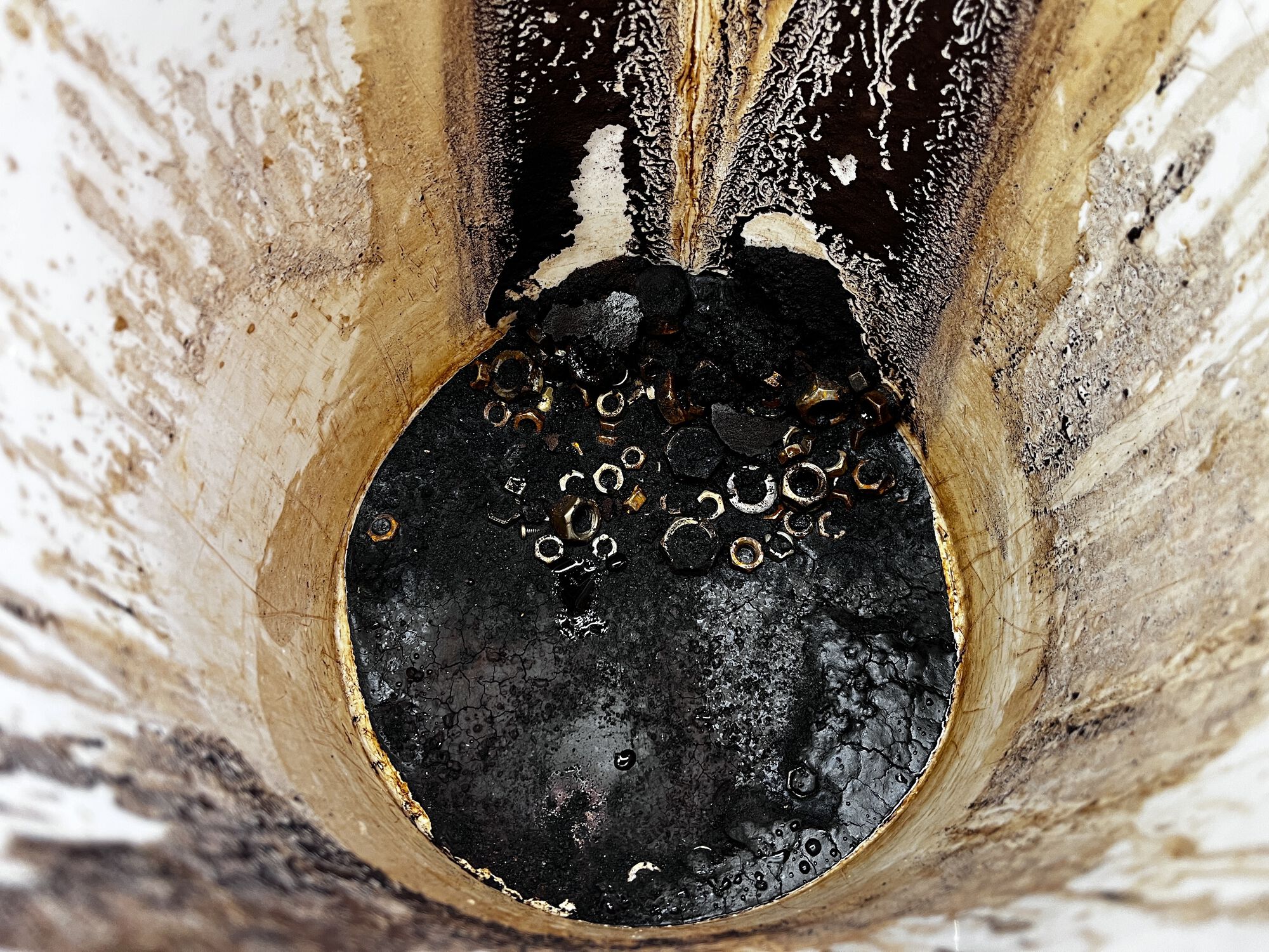

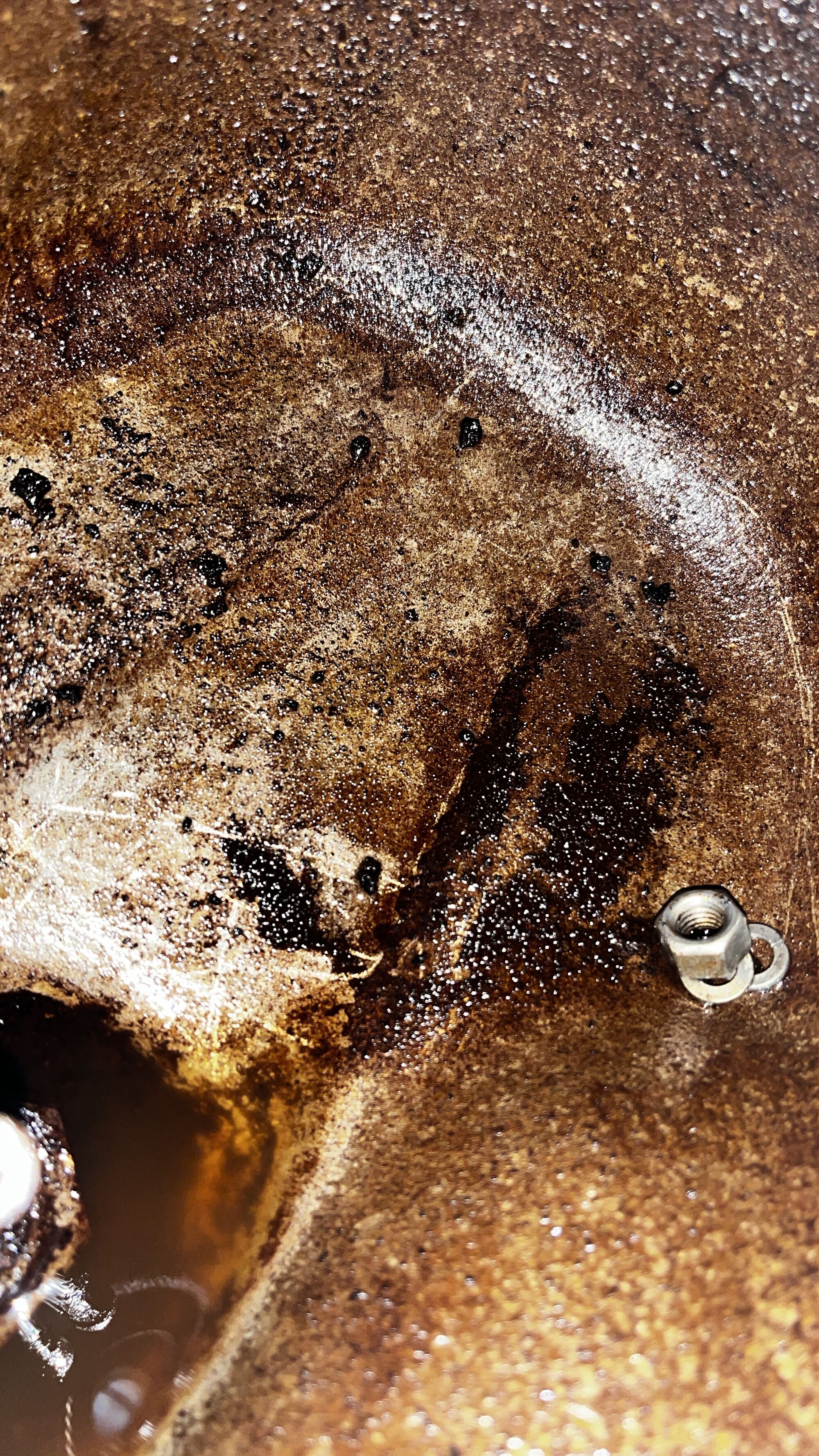

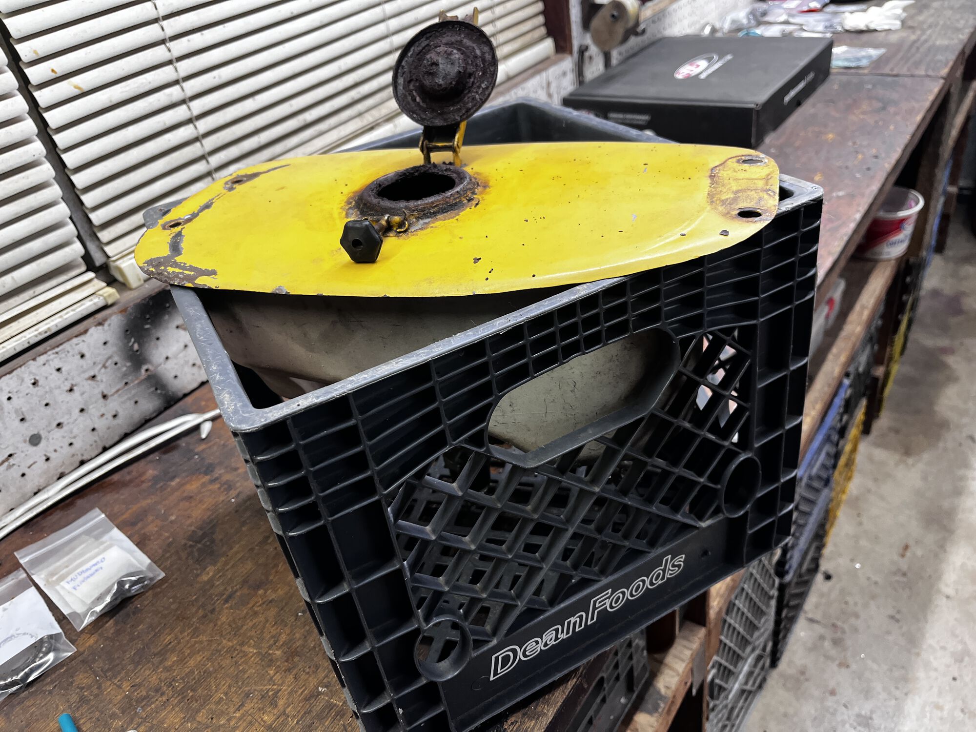

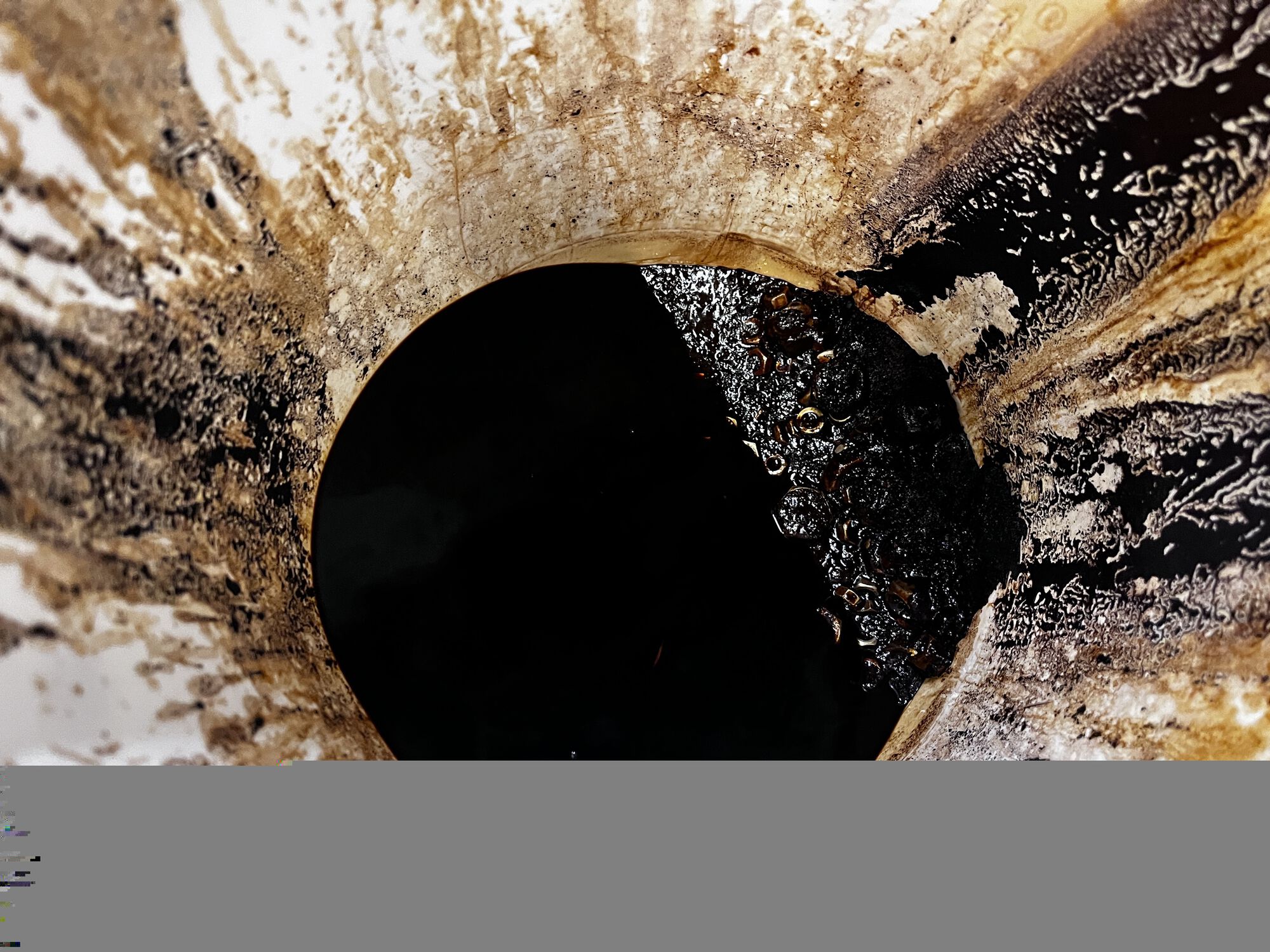

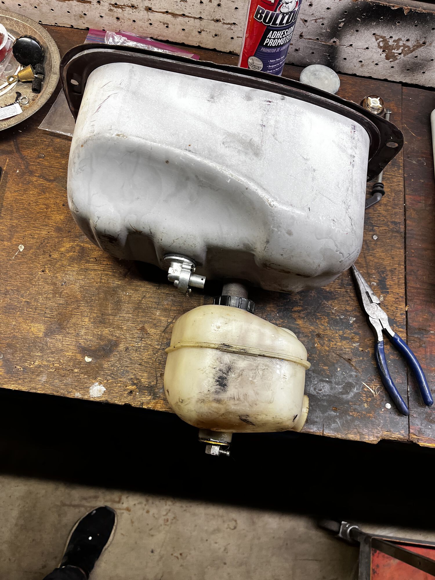

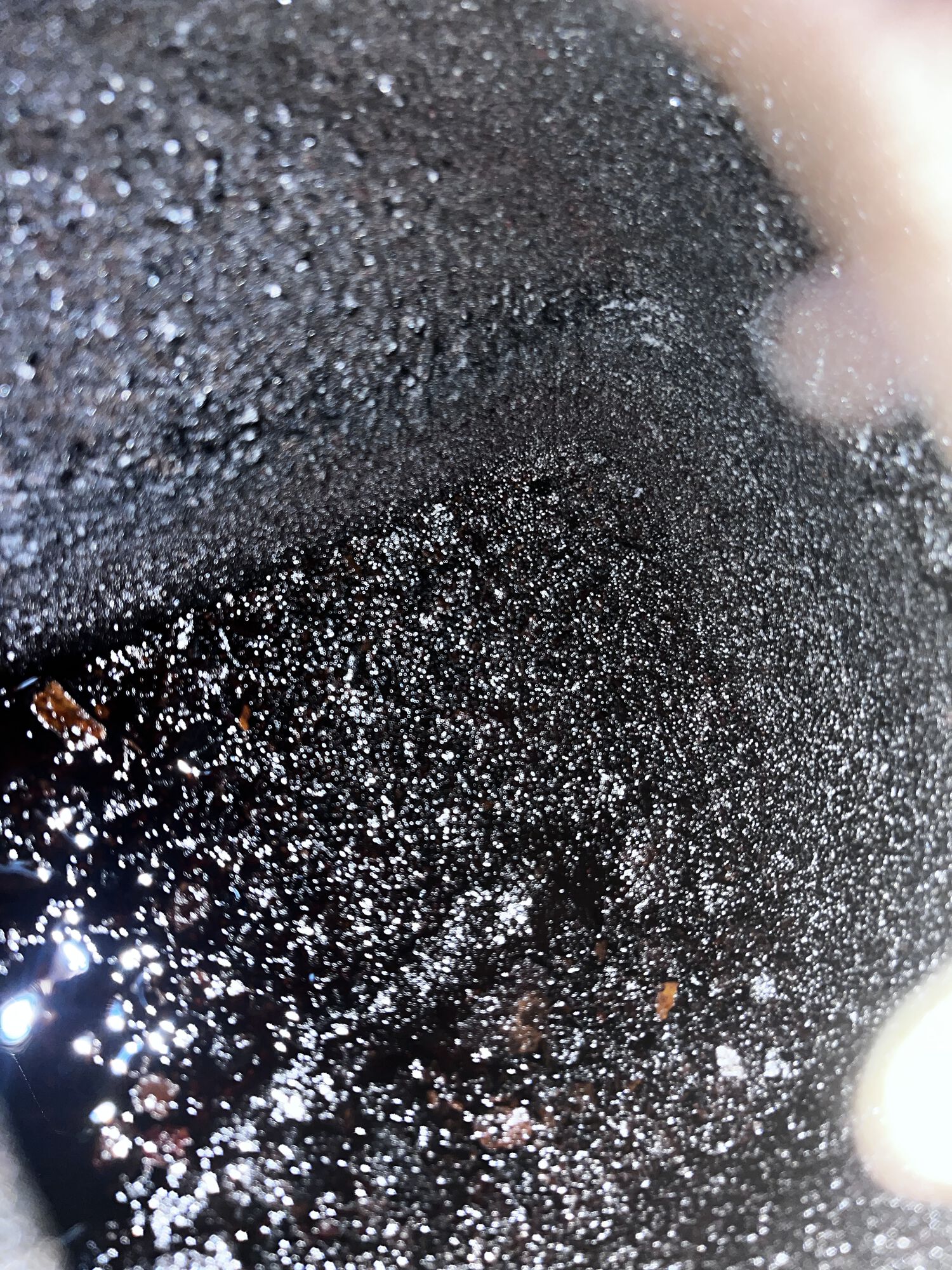

Started to clean inside of fuel tank. It is absolutley CAKED with gunk. A thick chunky layer of dried up fuel, oil, and some rust. I poured in some acetone to help loosen things up, then after a bit got in there with a scraping tool to break up the worst of it. Lots more soaking and abrasion needed before its anywhere near clean inside.

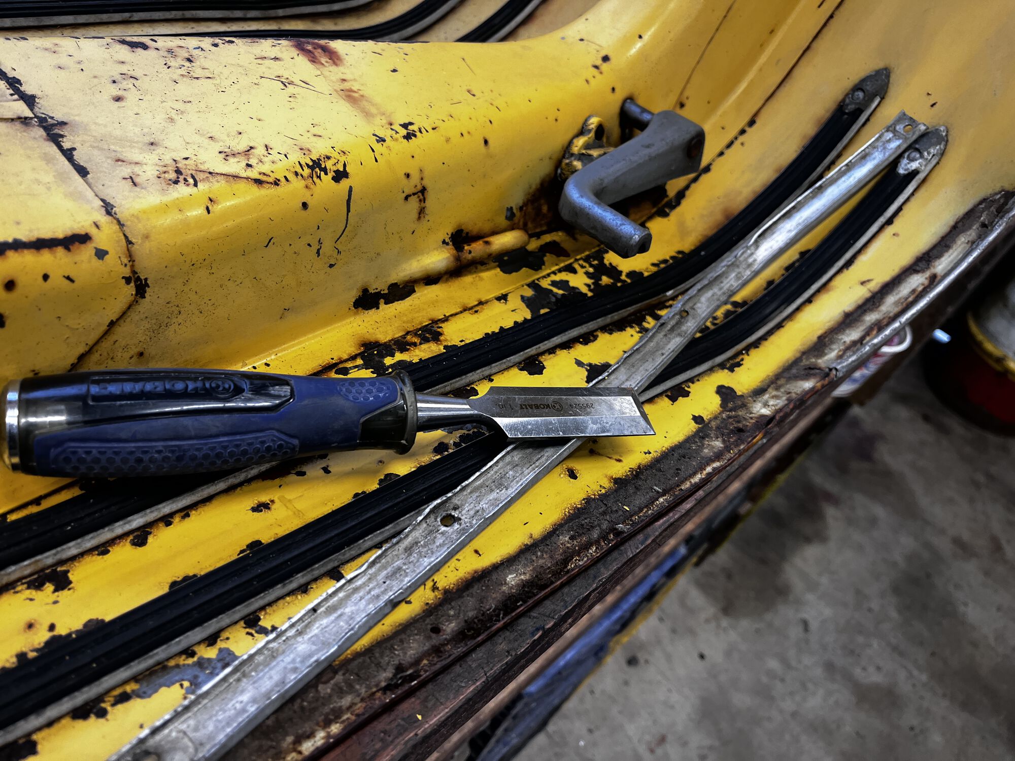

Removed the floor rails. 3 of the 6 had loose rivets, so I decided to go whole hog and remove them all. These will be cleaned up and refit with fresh rubber & rivets, after dealing with the floor board rust.
Loosened up the rear brake pedal. It was frozen on the shaft, so I hit it with a torch to break it free, which worked great! Now I need to deal with the stuck pin....

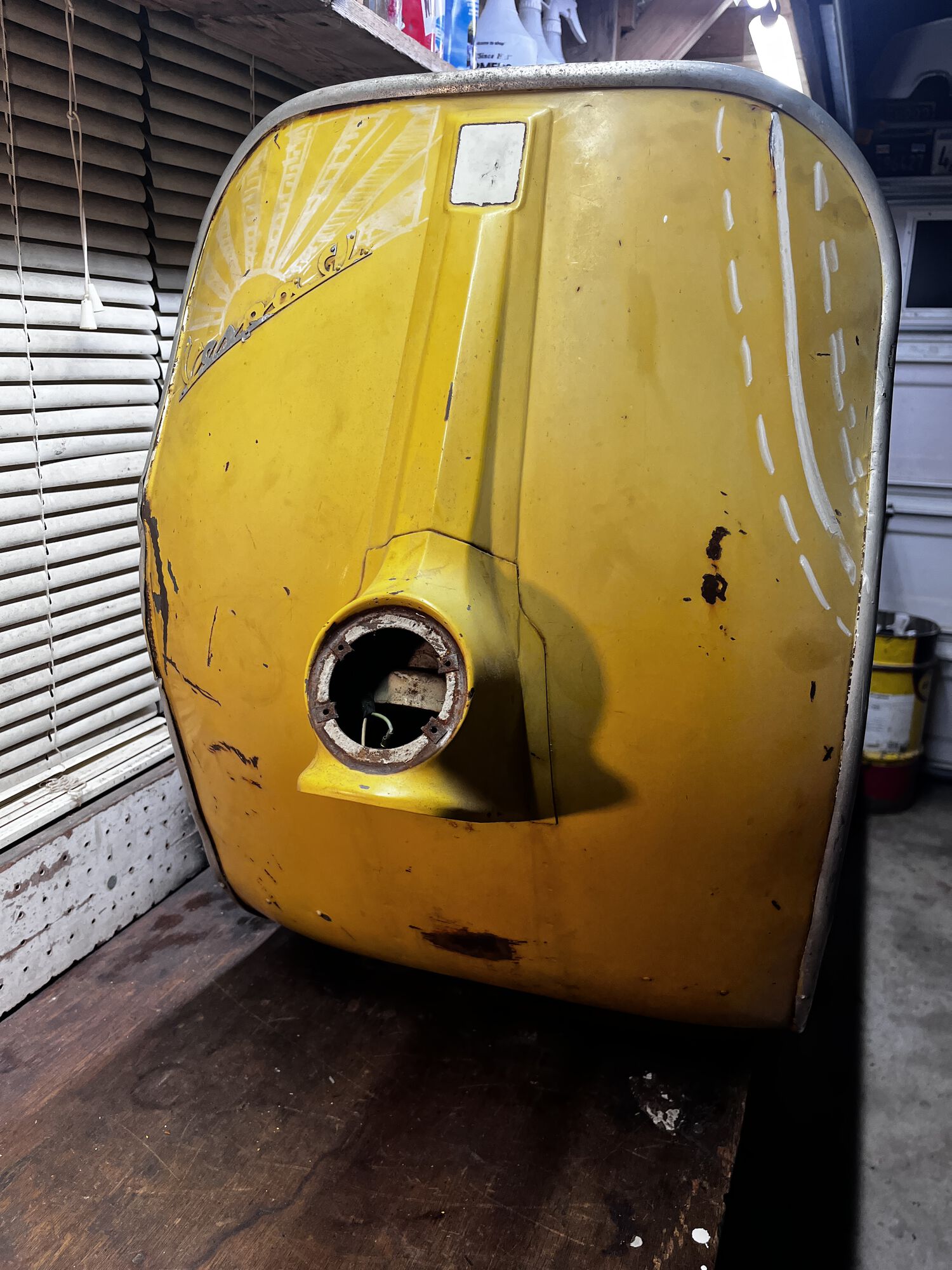

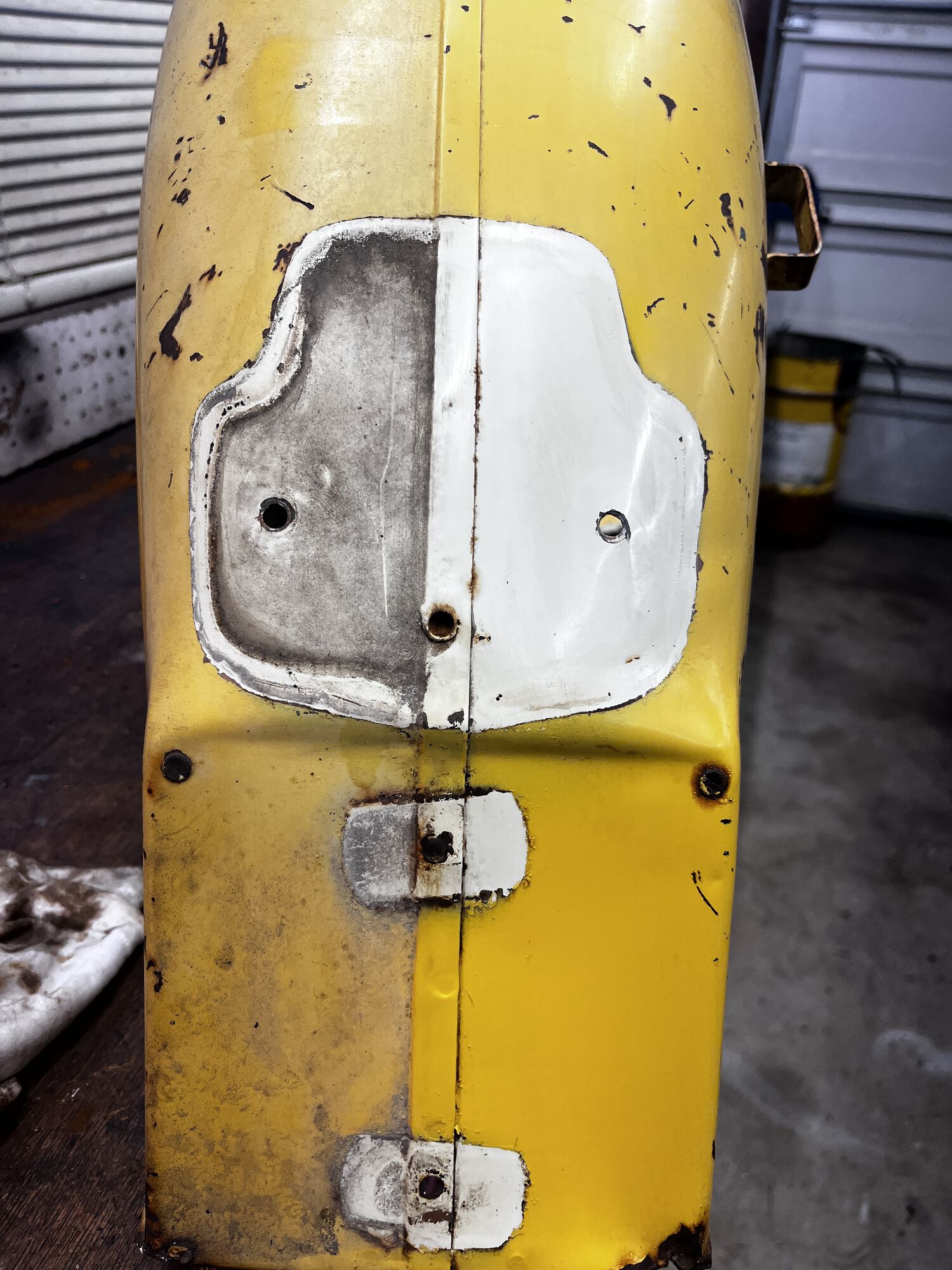

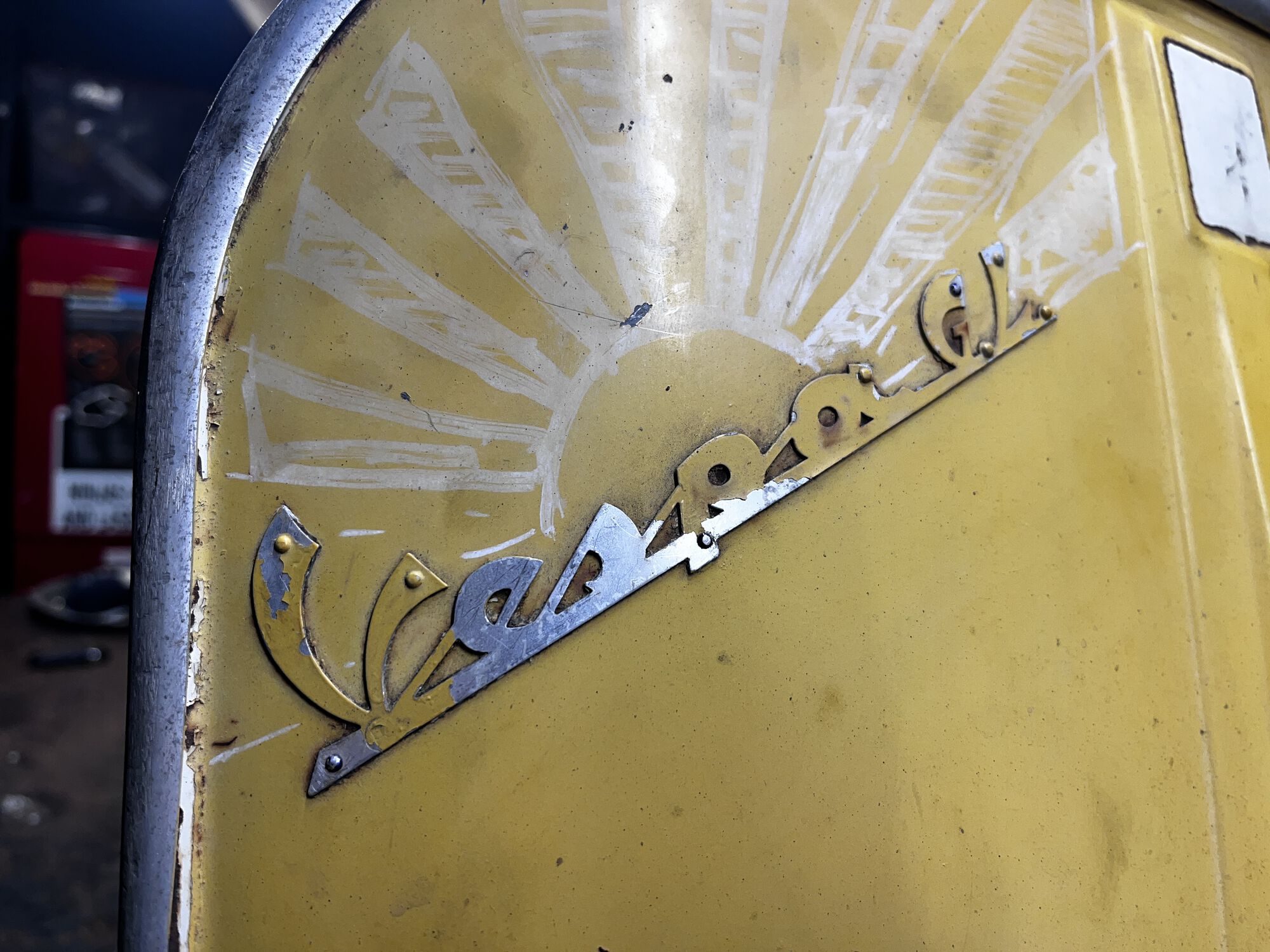

Cleaned the yellow overspray paint from the front badge. Some careful picking & scraping, and a touch of scotch brite. Now it looks much cleaner.

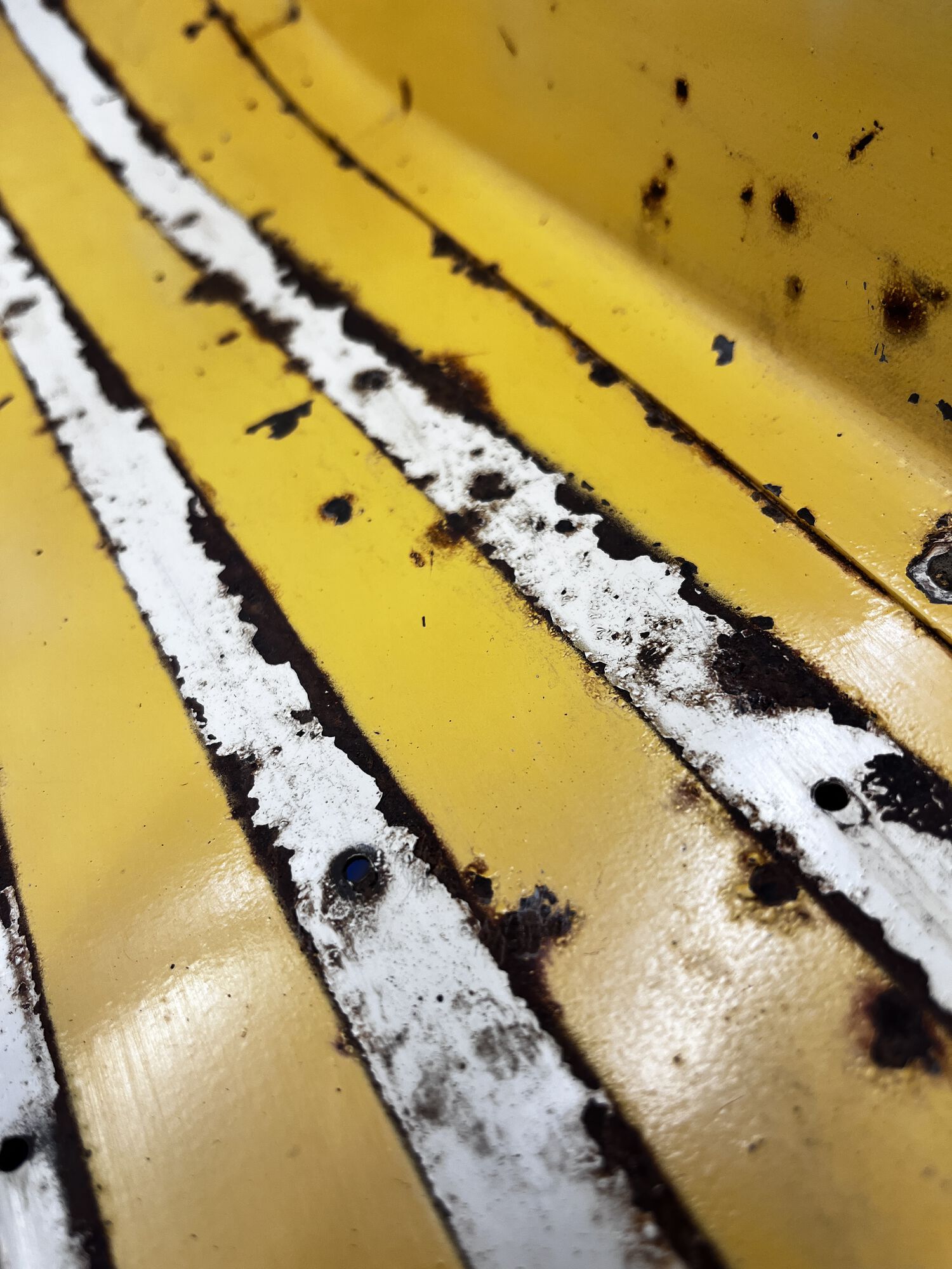

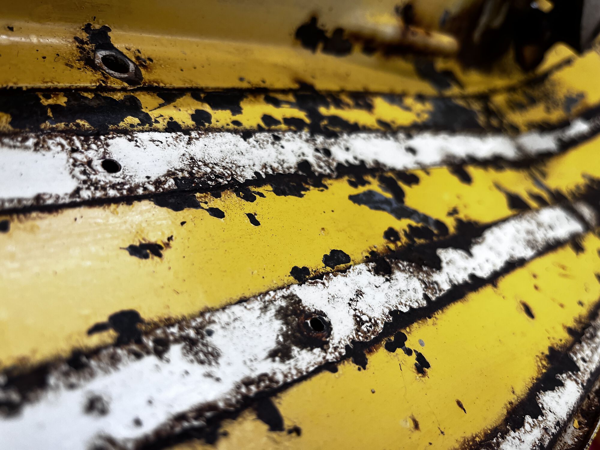

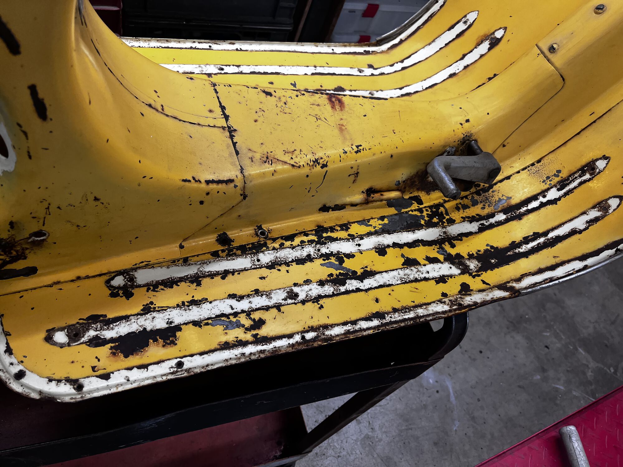

Started progress on dealing with the top floorboard rust. I used a pick/scratch awl to pick away at any of the scaly-bubbling rust spots that have formed along the rails and seams. Nothing too bad, but we are aiming to prevent the spread and preserve it as is as much as possible. As we all know the floorboards and rails are a potential problem area, so we are debating repainting the floorboard top and/or simply preserving it with clear coat or Owatrol or similar.

View of the front. Chalk marker used to highlight the biggest dented/creased area on left side. And for doodling!

Paint overspray on the front legshield badge.
Front legshield badge after some careful cleanup
Fuel tank fits perfectly in a milk crate for the big soak.
Black hard sludge inside the tank
The Black Death
The Black Death
Rear brake pedal heating up. Grabbed some putty knifes for a makeshift heat shield. Worked pretty well!

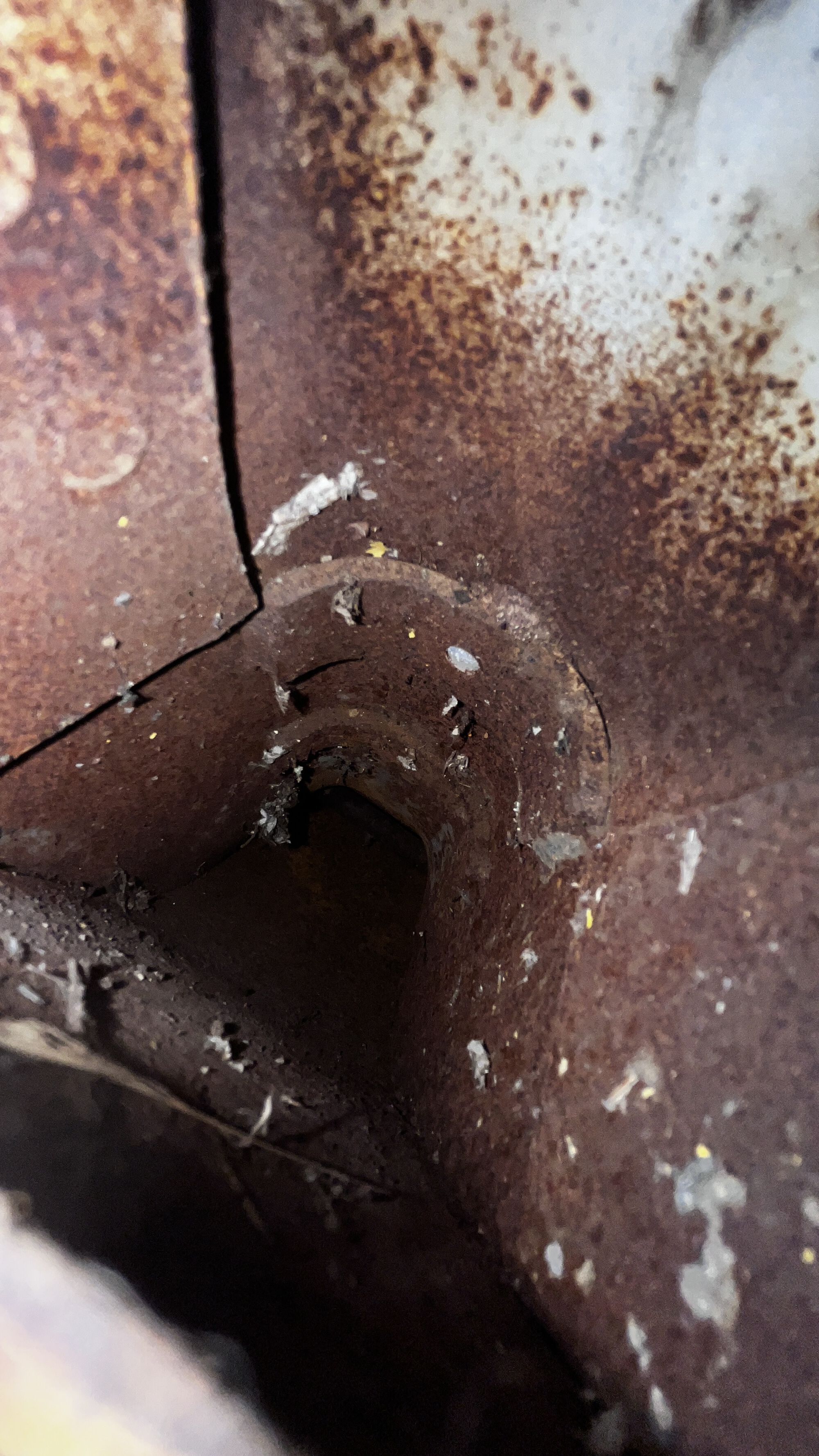

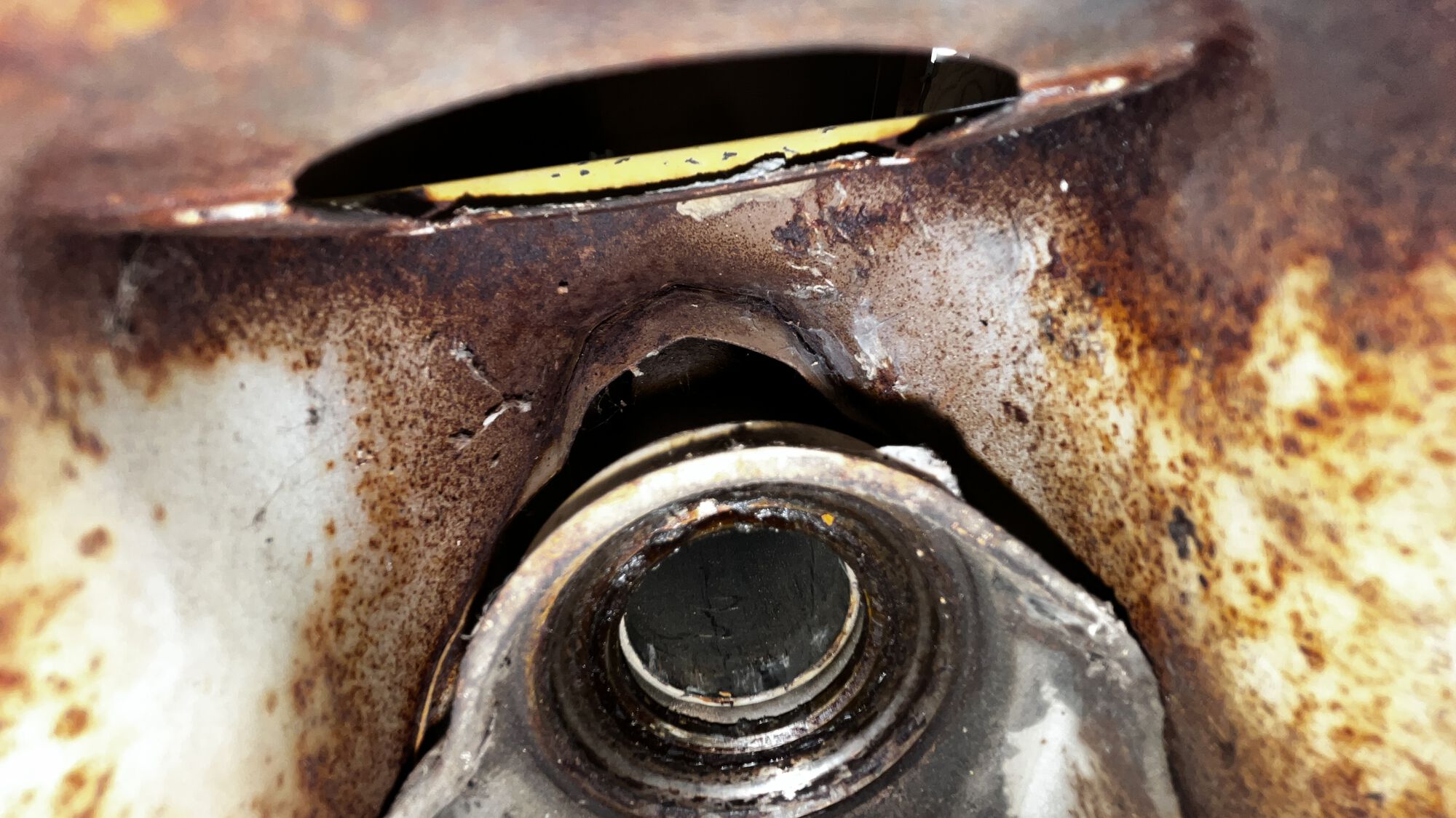

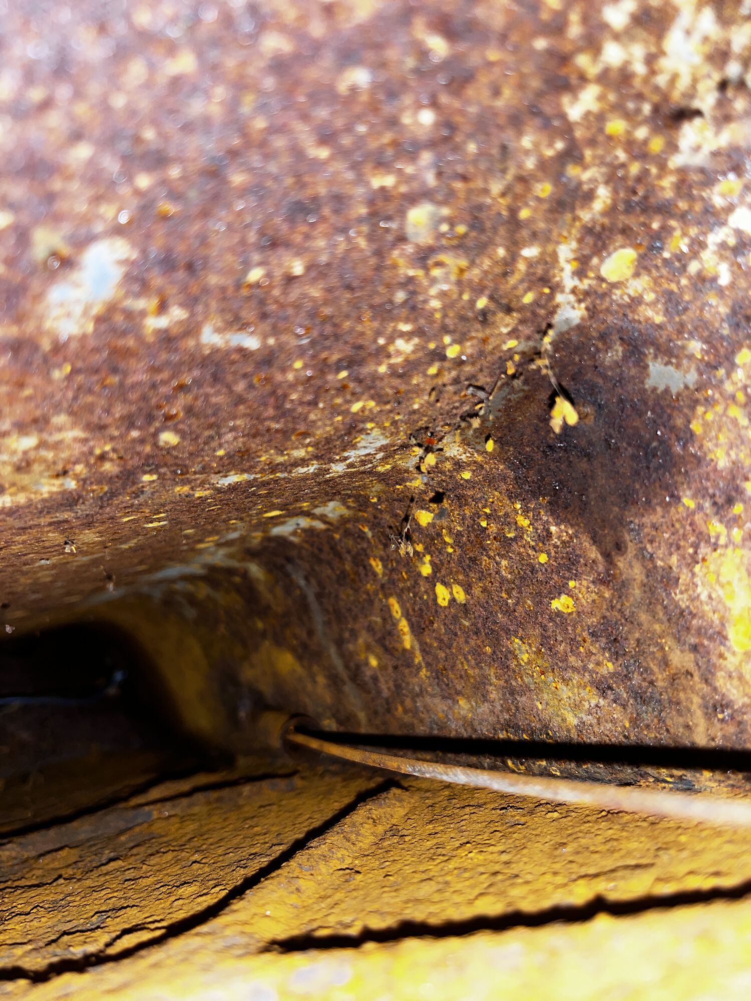

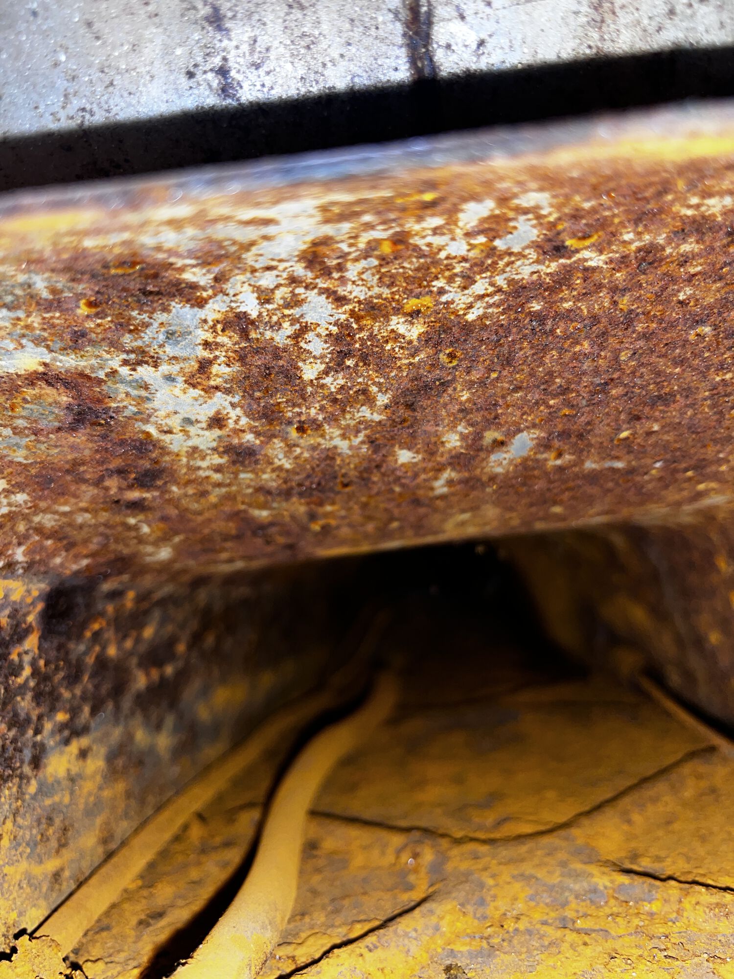

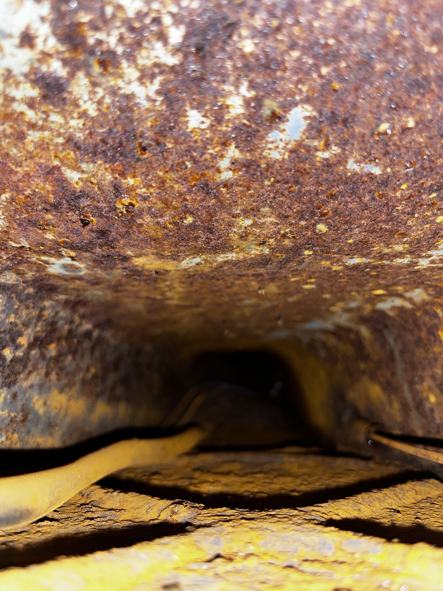

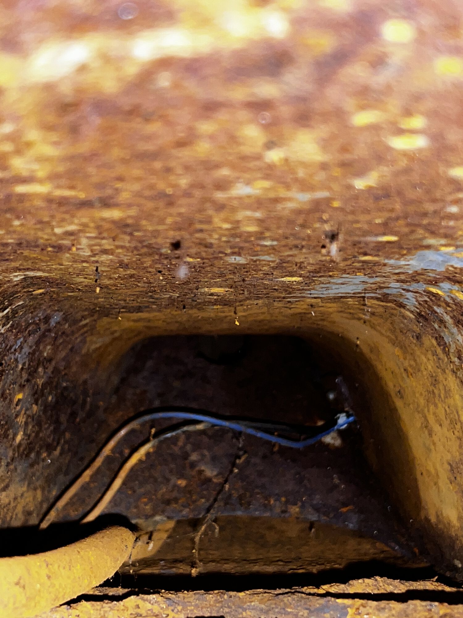

More pics
View inside the tunnel, from back to front
Tunnel view, showing the top portion better
More tunnel view, brake pedal side
Tunnel view, looking at the front tunnel lower brace, nearest the fork
Floor rails being removed. I cut the bottom of the rivets off with the chisel, then they pop right off.
Floor rails removed. right side
Up close view of floorboard on right side.
Floor rails removed. left side
Up close view of floorboard on left side.

You have my sympathies regarding the skanky tank.

I'm glad you pulled the floor rails to clean up the floorboards. And a respray of the floorboards is a great idea, and possibly the rims while you're doing it. I don't think it'll take away from the overall used look of the scooter.
And some ospho for the tunnel eh?

Of course it's waaaay easier during the hot summertime heat, but i would douse the inside of the tunnel first with purple power, then blast the ever loving heck out of the tunnel with the biggest pressure washer you can get your hands on (coin-op pressure washer i would consider too weak). Let all the water dry 100%, then repeat that same exact process. One it dries out again, then i would coat the entire tunnel with Ospho. Let it dry for a few day, then apply a second coat of ospho. Follow up with your favorite primer (cheap as chips rustoleum "rusty metal primer" is my go to). It won't eradicate the rust, so it will eventually creep back, but it will keep it at bay for quite a while. Ideally it would be 80~90 degrees outside to perform that whole process…which it a good 6 months away from Roseburg.

qascooter wrote:
Looking good man!
Thanks for the pictures!
Yeah, ospho the tunnel and repaint the floorboards, wheels, hubs, and a few bits; for looks and longevity.

That rust inside the tunnel looks like it's mostly surface rust, so that's good.
And while you can see where the bike sat with half an inch or so of water in it on the electrical wire in there, I don't think that's an issue.
My GL's tunnel looked worse than that when I got it--honestly, I probably should have replaced some of the sheet metal under there, but didn't have the skillz yet, so I just did the best I could, which was basically the same plan you're following.
It's been almost five years now for me and I see no evidence of additional rust or deformation, so I think you'll be good.
I agree the inside rust doesn't look too bad. Pretty much just all over surface rust. I did the poke test all over the underside floorboard and found no weak spots, or break through; so at this point I'm calling it golden!

I had a bit of time to spend on the GL, so I worked on cleaning the fuel tank and a few other small things.
I drained out the first round of sludge, after letting the acetone soak for a few days. I also dumped in a bunch of nuts and shook it around a few times a day to help loosen everything up. I got in there again with a long scraper to get as much of the thick sludge off the surface; then drained it all out. First round was a golden success! Atleaset I can actually see metal, rather than the black death. I gave it a rinse & drain, then filled the whole thing up with Simple Green, for another full soak to get the last of the oily residue.
Fuel tank inside after draining and a bit of scrubbing.
Fuel tank back view
Fuel tank back view
Fuel tank front view
Black Liquid Death from the tank
Mmmm delicious and nutty

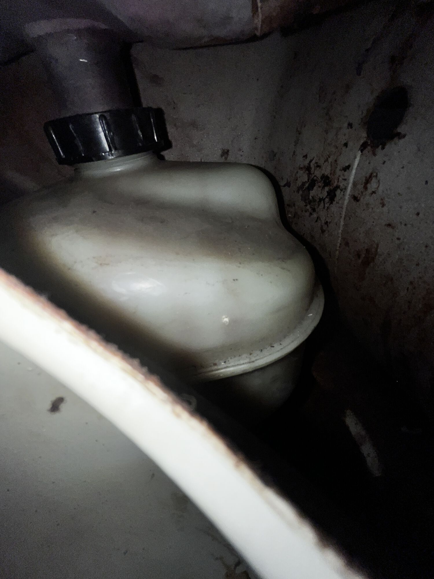

With progress being made on the tank, I decided to abandon that and use a completely different tank.
Not so much as abandon, but more of a pivot. I'll still finish cleaning the original tank, as it needs it; even if it's shelved.
We're going with a P2 engine, and want to keep the auto lube; so I dug into the stash and pulled out a P-series fuel tank with oil tank. Quick test fit looks good, for both fuel and oil tank. We'll block off the sight glass, so no big hole drilling; then make a dip stick for checking the oil level.
P-series fuel tank, with oil tank; in the GL.
P-series fuel tank, pulled from the lions hoard. Sight glass removed for easy fitting in the GL
Oil tank fitting in the frame, looking through from engine side. Fit looks good! Excuse the poor pic.

Just a few more pics inside the tunnel
Surface rust inside tunnel, under the horncast. Nothing terrible at all.
Surface rust inside frame, looking down from horncast toward floor. You can see the back side of the 2 aluminum screws.

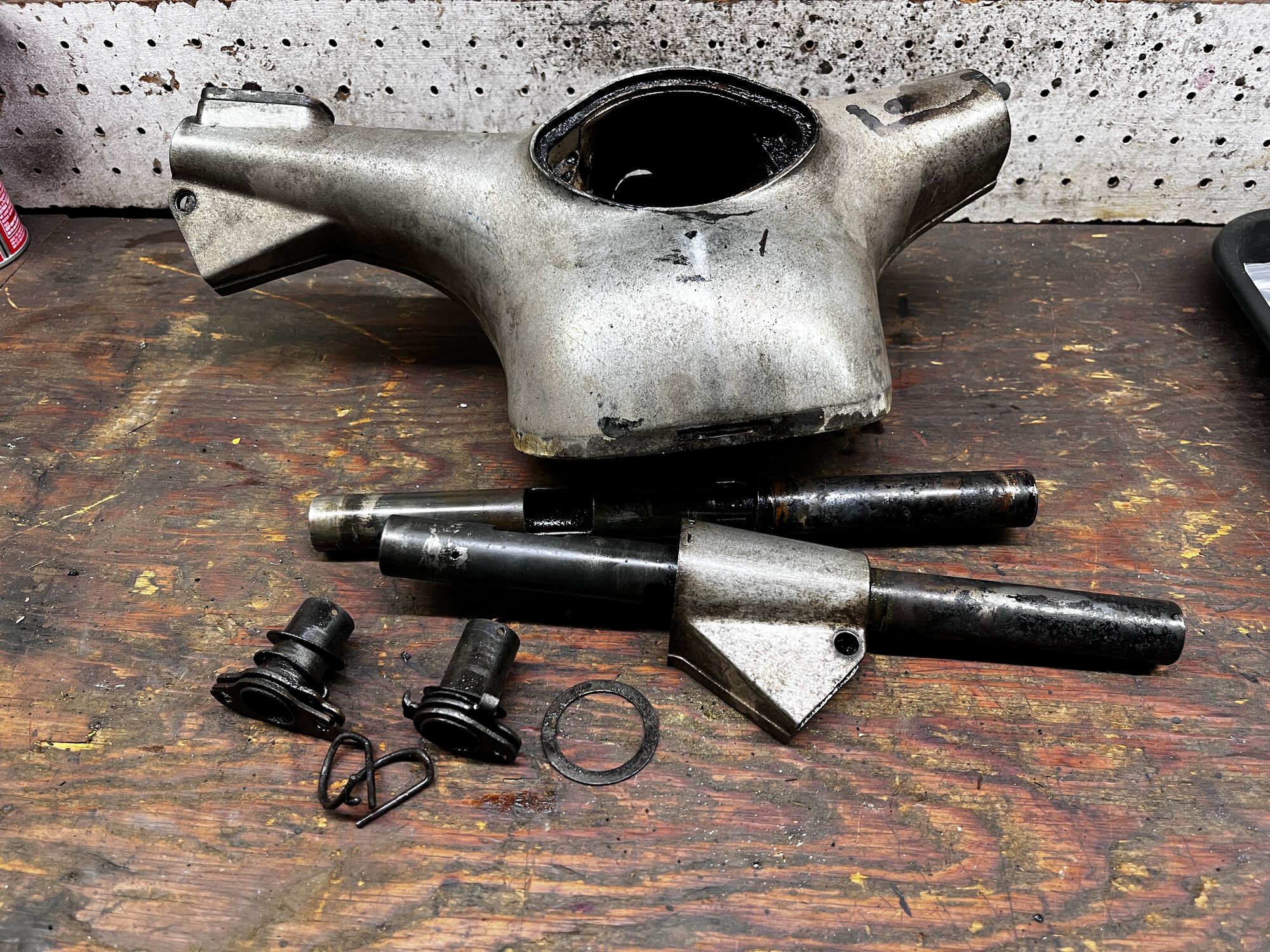

Big thrills for small victories. Today we worked on freeing up the stuck headset tubes. They were both rusted solid in place. We tried soaking in penetrant with no success. So we busted out the small torch to make those tubes cherry. A few minutes on each side, heating up the steel tube from inside, focusing heat near the bearing surface areas, then a fresh dose of penetrant, let it cool and we have freedum! Both tubes pulled out by hand with ease, and should clean up nicely. FIRE FTW!
FIRE! FIRE!!
FIRE! FIRE!!
We have tube separation success
parallelogramerist
Posts: 6076
parallelogramerist
Posts: 6076
Nice work on the tube extractions. They can be real buggers. To get the tubes to have a super smooth action inside the headset, i'll take a wire wheel to the corroded tubes. After i get them super clean, i then will sometimes use a scotch bright pad and Ospho on the just the steel portions (keeping it off the aluminum). I'll scrub it for about five minutes (until the metal gets bright), then wash it off. Once dry, then i'll smear valve grinding compound on the tubes and insert them into the headset. Spin the tubes round and round a whole bunch of times until they spin very smoothly. Then wash everything off with Purple Power. It makes the tubes rotate better than new.

Good thorough process Whodats! I usually do the wire wheel & scotchbrite on the tubes, then a small scotchbrite on the dremel for the headset. Good thinking with the Ospho & valve grinding paste! These tubes are good overall, but do have the surface rust, so may benefit from the full treatment.
Next up we need to decide how to finish the headset. Paint yellow, leave it raw, buff it, or shine it up!
@chandlerman avatar
Innovator
Posts: 12312
Location: Nashville
104 Days Since Last Explosion
Innovator
@chandlerman avatar
Posts: 12312
Location: Nashville
Victory!
It always feels so good when you're trying to free stuff up like that and it Just Works.
I don't go as far as whodat, but I wire wheel off the tubes and then hit both the tube and the headset with progressively finer wet-dry paper until it's nice n' smooth.
I'll have to try the valve paste, though, because getting inside the headset with wet-dry can be a real PITA.
