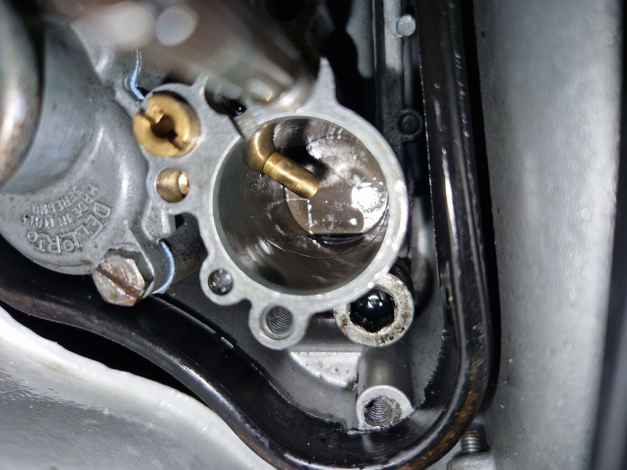

Min idle is at 2.5 turns from slide starting to move, also pictured.
Mixture screw best at 1/2 turn, doesn't cut out if fully in. Tip is clean and identical to the other one I have.
There is some slack on the choke cable, pressing on the end of the plunger to ensure fully in makes no difference, rubber tip is hard so it could leak a little.

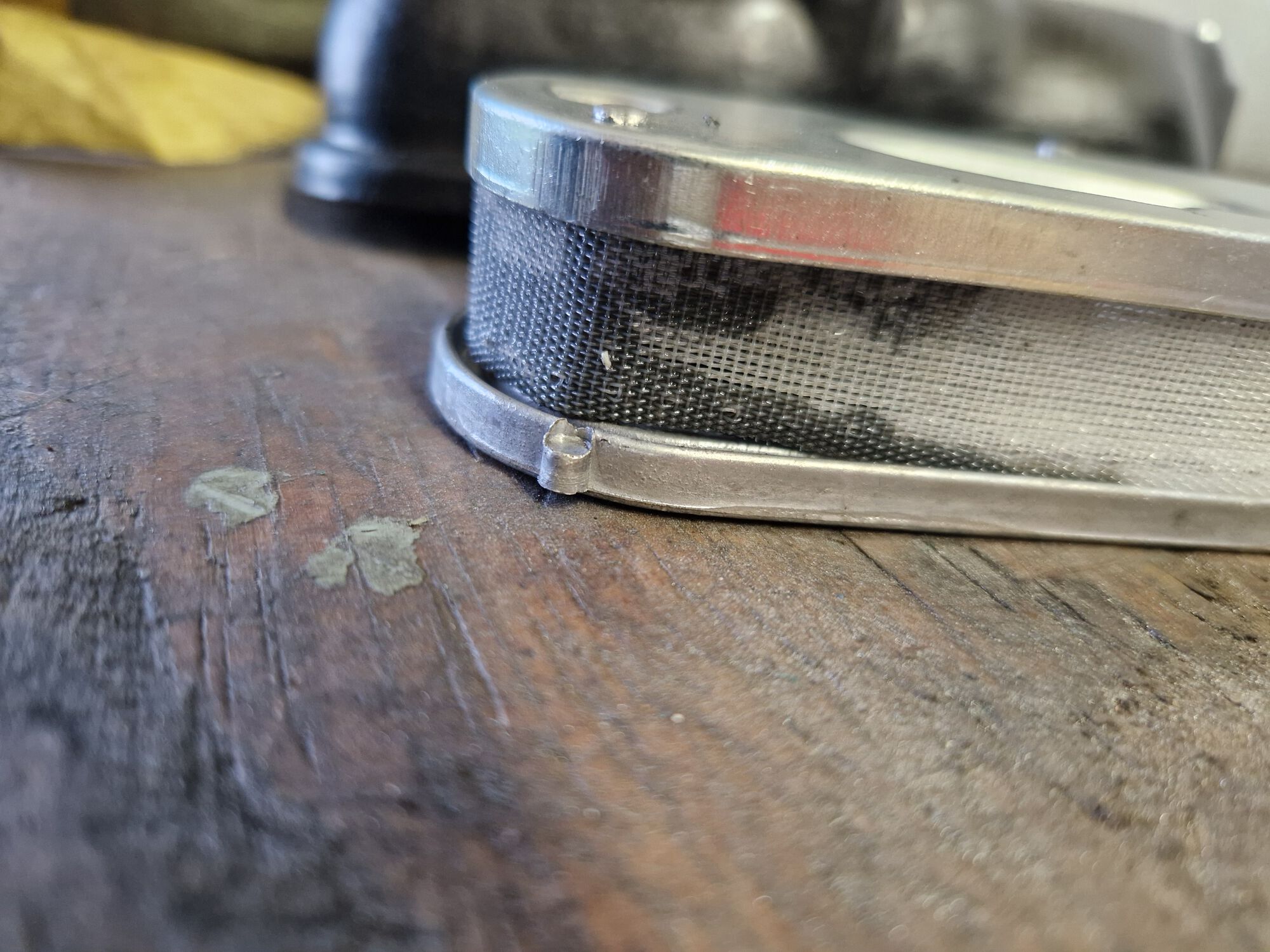

Blow back misting seems excessive, airfilter is wet at one end (pictured), sprays onto seat with a throttle blip.
Questions
Is the adjusters behaviour normal, perhaps indicating that I need a leaner idle jet, or are the forum posts that I've read correct when they say the motor shouldn't run at all with the screw all of the way in?
Do they normally have quite a bit of blow back? I haven't worked on a rotary valve 2 stroke before.

Is the idle jet missing? Is that not the 55/160 thing recessed down into the hole next to the main jet stack?
Timing should be at least close according to the vape instructions and degree wheel, but I'm not trusting it to be right until I double check it with a strobe.
It does bog down if the adjuster screw is wound out a few turns, I'll need to go back out and count the number of turns but it'll be around 4. It's subtle but fastest idle is around 1/2 a turn from fully in.

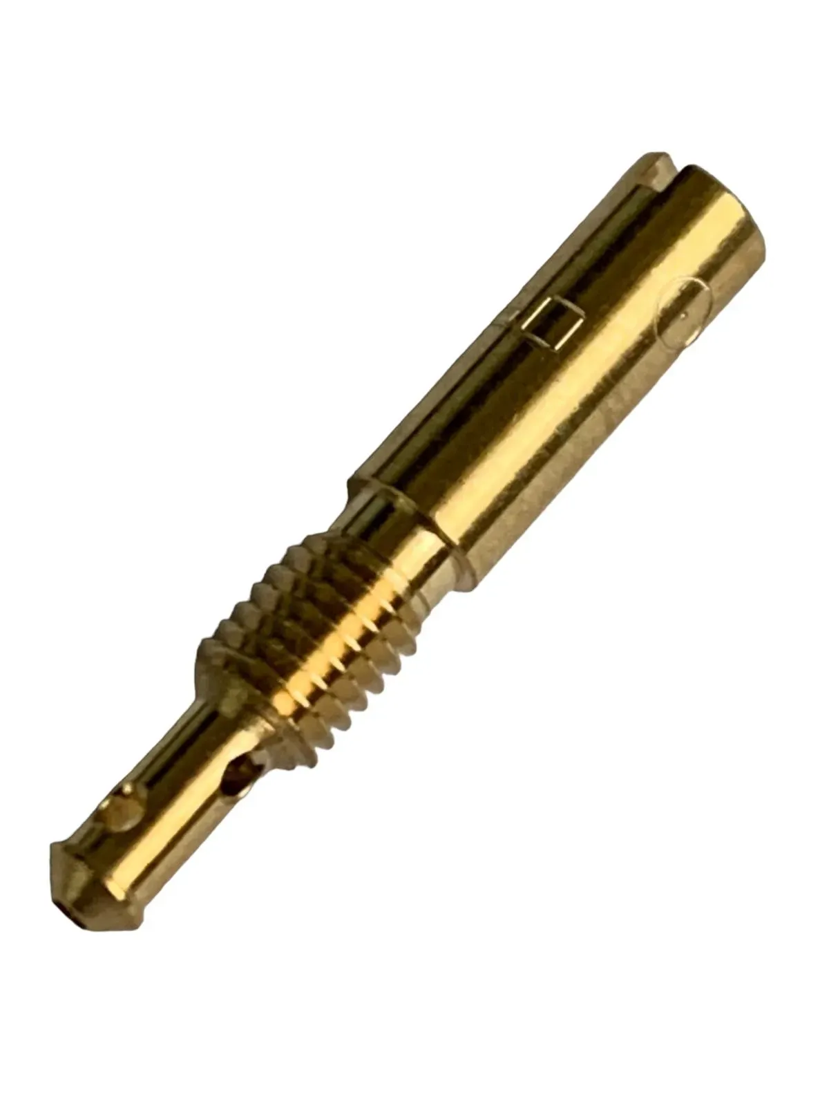

Pilot jets for that carb look like this.

To verify we are on the same page, the idle adjust screw comes out the top of air box cover and holds the throttle slide open a small adjustable amount.
The mixture screw is accessed at the rear of the air box behind a rubber plug. The number of turns recommended depends on if you have original old Del Orto (coarse thread) or newer Spaco (fine thread). More here
Mixture screw adjustment, got a good link?

Yes on the same page idle adjuster screw that pokes out the top of the cover, wound inn until it contacts the slide then a further 2.5 turns.
Mixture screw at rear pretty sure it's a Del Orto (coarse thread), 0.5 turns out from fully seated seems best. Fully seating it drops revs slightly.
From memory the idle jet looks like the one pictured but I'll remove it to check, I also have a 24G T5 carb so there's a chance that a T5 jet could be in this carb and I think the plain bit at the top of those jets is shorter.
Yep.
But that won't cause excessive blowback, though you'll have to remove it with a toothpick or idk.

What carb is yours? And what box/filter/autolube?
Looking back up the thread What's that T5 pilot jet doing in there.

Genuine drilled filter should arrive on Friday, an undrilled lml with blue layer removed is currently fitted
T5 pilot jet is because I bought the wrong one, if it makes a difference I'll add the right one to this jet order

I think we're closing in on your problem. It appears a T5 uses a 50/100 idle jet. If, as you said, BGM calls for a 55/160 for this kit, a 50/100 would be way too rich. Definitely add a 55/160 to your order and let us know how that works out.

I think Kowalski is right about the pilot jet. Probably a stock T5 one. I would still go richer on the AC to start with. If the AC is too big, it can lean out in mid range, even while being rich low down, feels great but rapidly increases piston wear.
AC120/BE3/125 52/120 would be where I would start on your carb and cylinder.

The idle jet is a 55/160, it's just T5 length.

I have seen there is a firm in the UK selling T5 length idle jets in various sizes for people who want to use a 24.24G on something other than a T5. You also could cut a normal one down yourself. Either way, fluid dynamics is complicated and there is more to it than the size of your orifice. I don't know for sure but, in this case, I suspect a short tube 55/160 flows less air than a long tube 55/160, effectively making the short version richer. If it was me, I would still want to get my hands on one of the BGM recommended standard 55/160s.
AC120 and 52/120 ordered, I've already got a 125 main.
125 is likely the biggest the MJ will be. If you had all the jets from 115 to 125, you'd have it covered.
As said T5 jet in an E carb is going to give weird results. Stick to the correct jets.
KMT do a set of 120 air pilots. Expensive for needing just one.
https://www.sip-scootershop.com/en/product/idle-jet-set-set-kmt-120-38-52_KM120400
