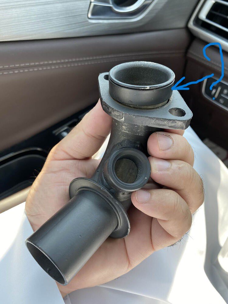

I took this photo of the exhaust manifold from another post, so not my bike. This looks like a seal of some sort. Any idea what it is made of? Just curious really.
Exhaust manifold.
Exhaust manifold.
@bajarob avatar
Posts: 1985
Location: Ventura, CA
@bajarob avatar
Posts: 1985
I believe that's just a spacer that the flange presses against when tightened down on the cylinder head. Should just be made out of steel.
^ This.

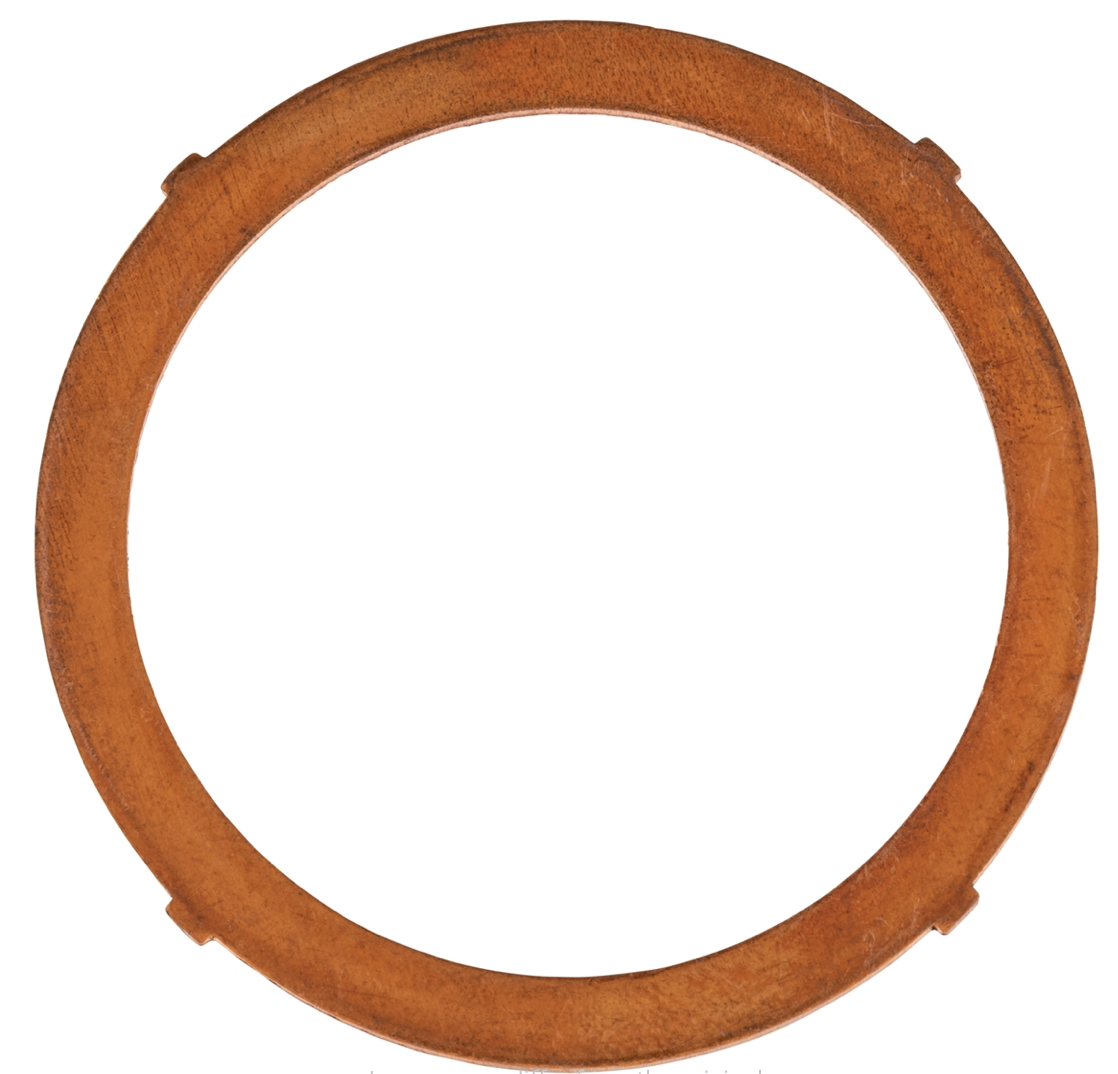

Thanks. So, there is no seal between the cylinder head and the exhaust manifold?
Posts: 39564
Posts: 39564
There is, but it is rarely seen. There is a copper crush gasket that goes between the exhaust manifold and the cylinder head -- generally, it will be stuck up inside the cylinder head hole until skillfully removed with a sharp pick.
This one is for the BV350, but it is similar:
https://www.scooterwest.com/copper-exhaust-muffler-gasket-manifold-to-head-bv350-only-all-years.html
