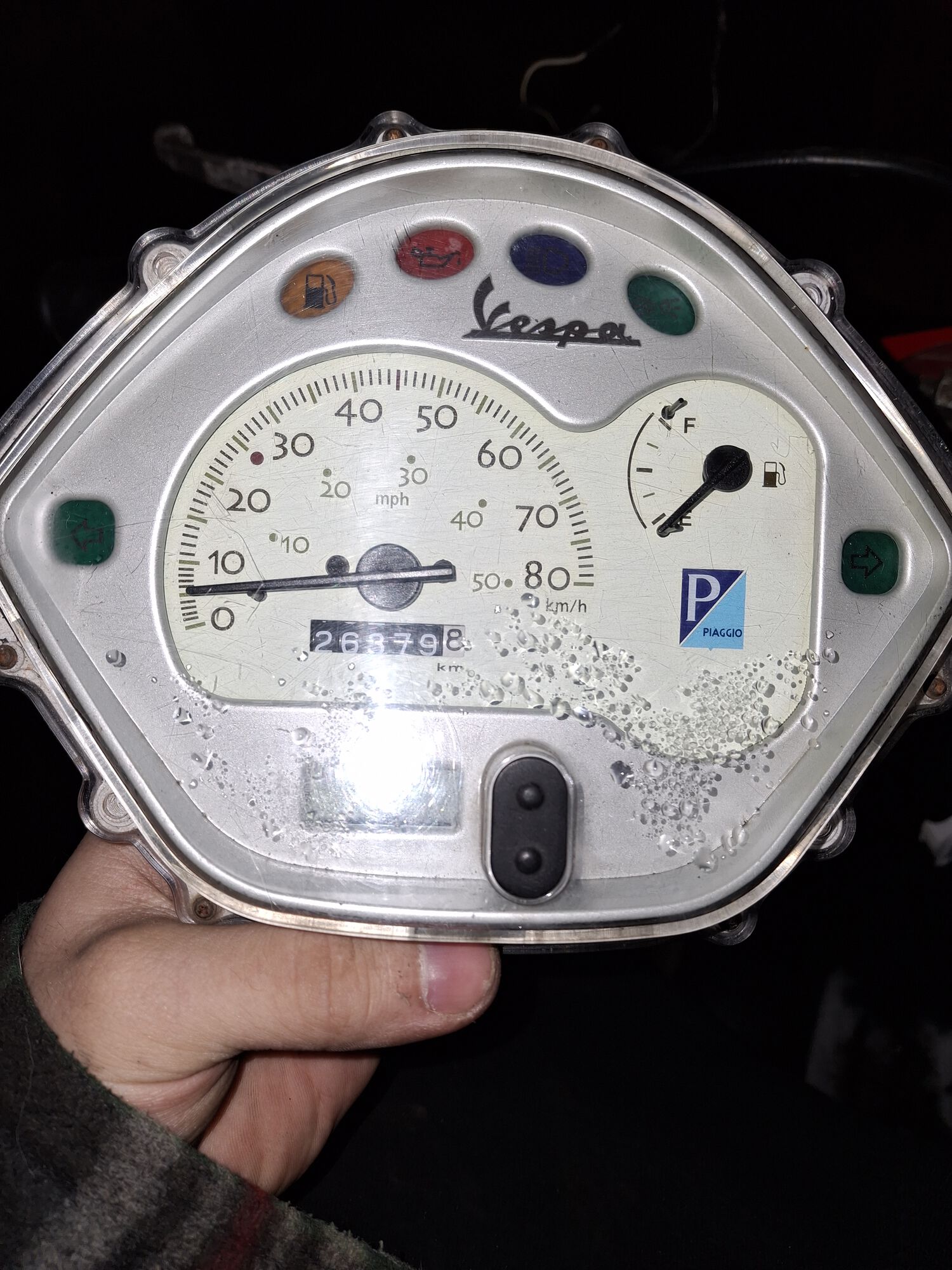

Here is the dash

Kristaps wrote:
the dash is not working correctly
what do you mean?
what connector is that? and why the photo?
lastly I suggest posting in General instead of Projects

Turn signal is left oil and right far headlight the fuel show empty when its fuel and connectors is for the speedometer i can't find any wiring diagrams that fit

That looks like an ET2 dash, the 125 would have higher top speed on the speedo.
Might be able to make it work by swapping wires in the connector if you have both wiring diagrams. Might find what you need here:

Strange.....
strange..... in the photo the speedometer is not Et but LX, not 125 but 50 ....

Because it was originally et 2 50cc but been swapped for 125

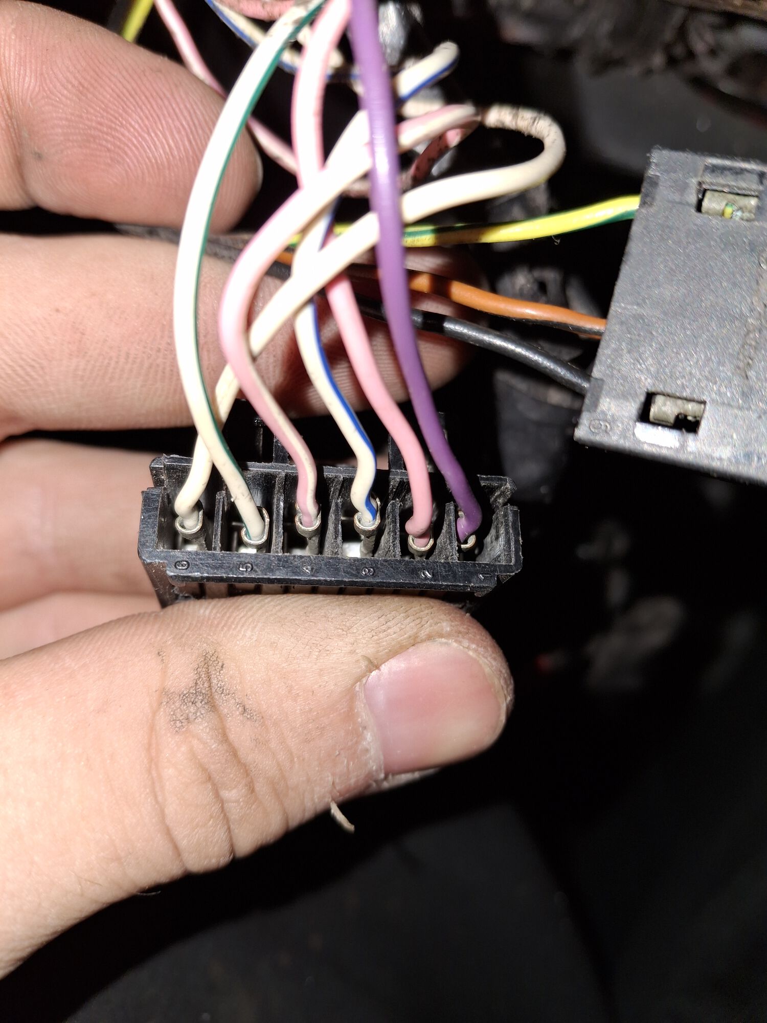

https://manuals.wotmeworry.org.uk/Vespa/
Got the turn signal working and blue far headlight to turn on but can't get the fuel gauge to work its a 50cc dash but it has a 125 in it and thank you for the diagrams spent 2 days figuring it out

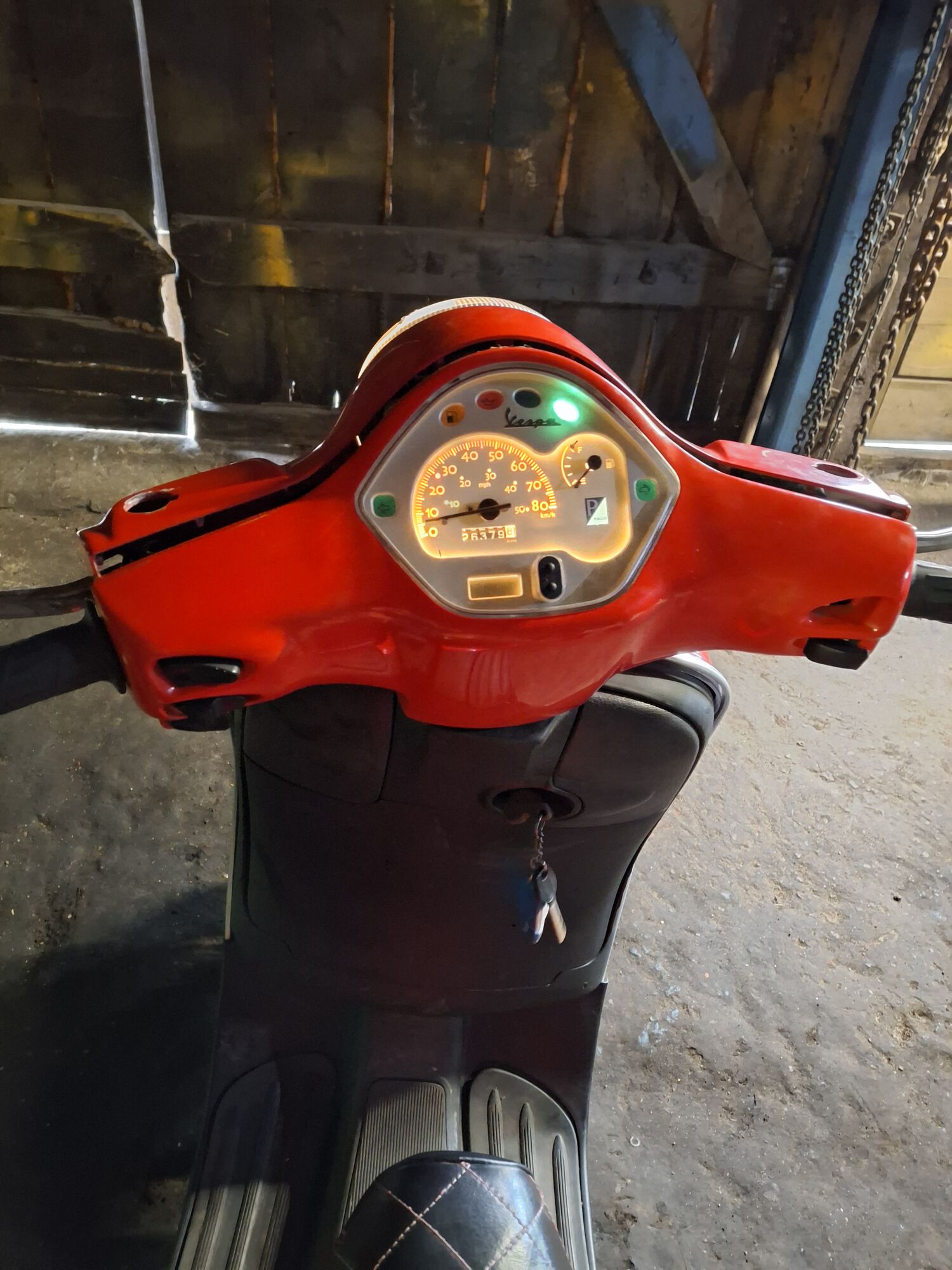

I figured something out and Wil try but the fuel gauge did work just not without far headlight off
I will post pic

bluecloud wrote:
Maybe you just need a LX50 sending unit to work with the LX50 dash?
Maybe but got it working some time ago but lost dash light will post pic
Pic 2
