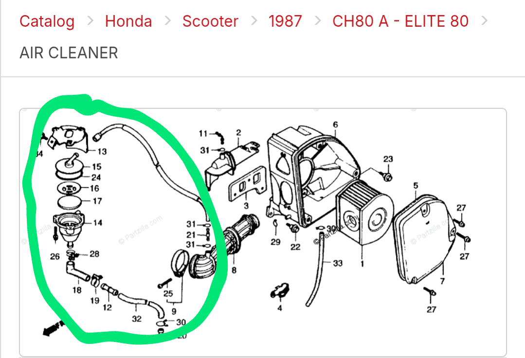

A setup like this might help. Pressure pulse enters on the side, oily mix is separated. Pressure leaves out the top, residual oil drains to tube. Just pull the plug in the bottom occasionally and drain the residual oil.
I thought of the Elite because it's a pretty compact part.
Catch can assembly from a Honda.

Hmm, just musing that pcv valves are probably made for different size engines, ie different pressure vs flow rate. So not confident in selecting one

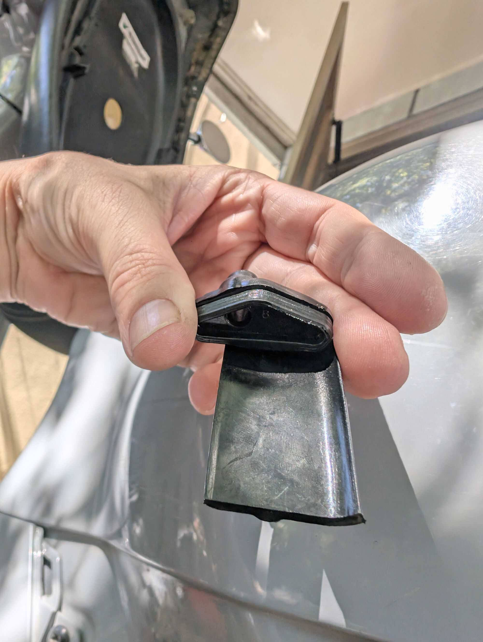

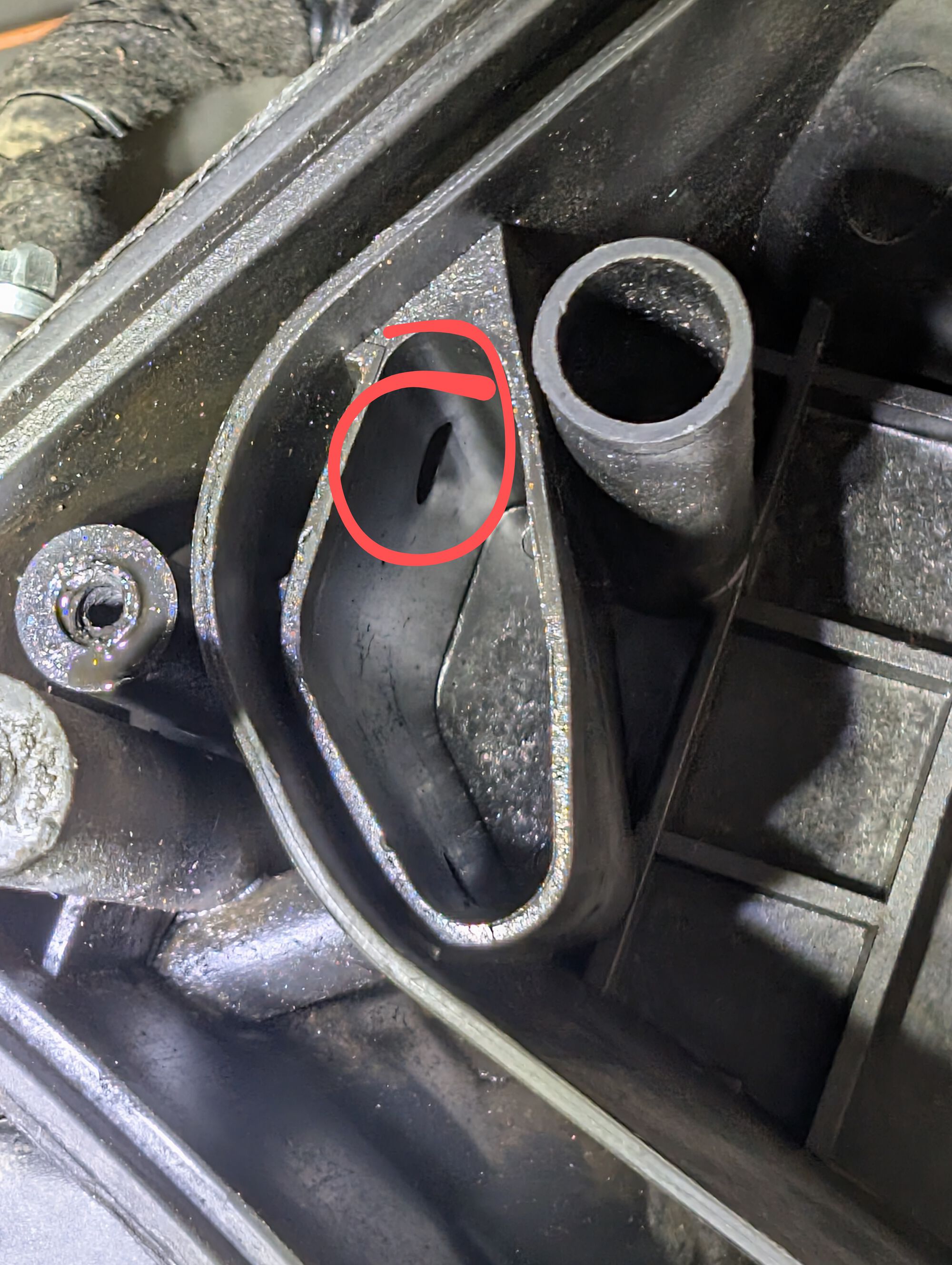

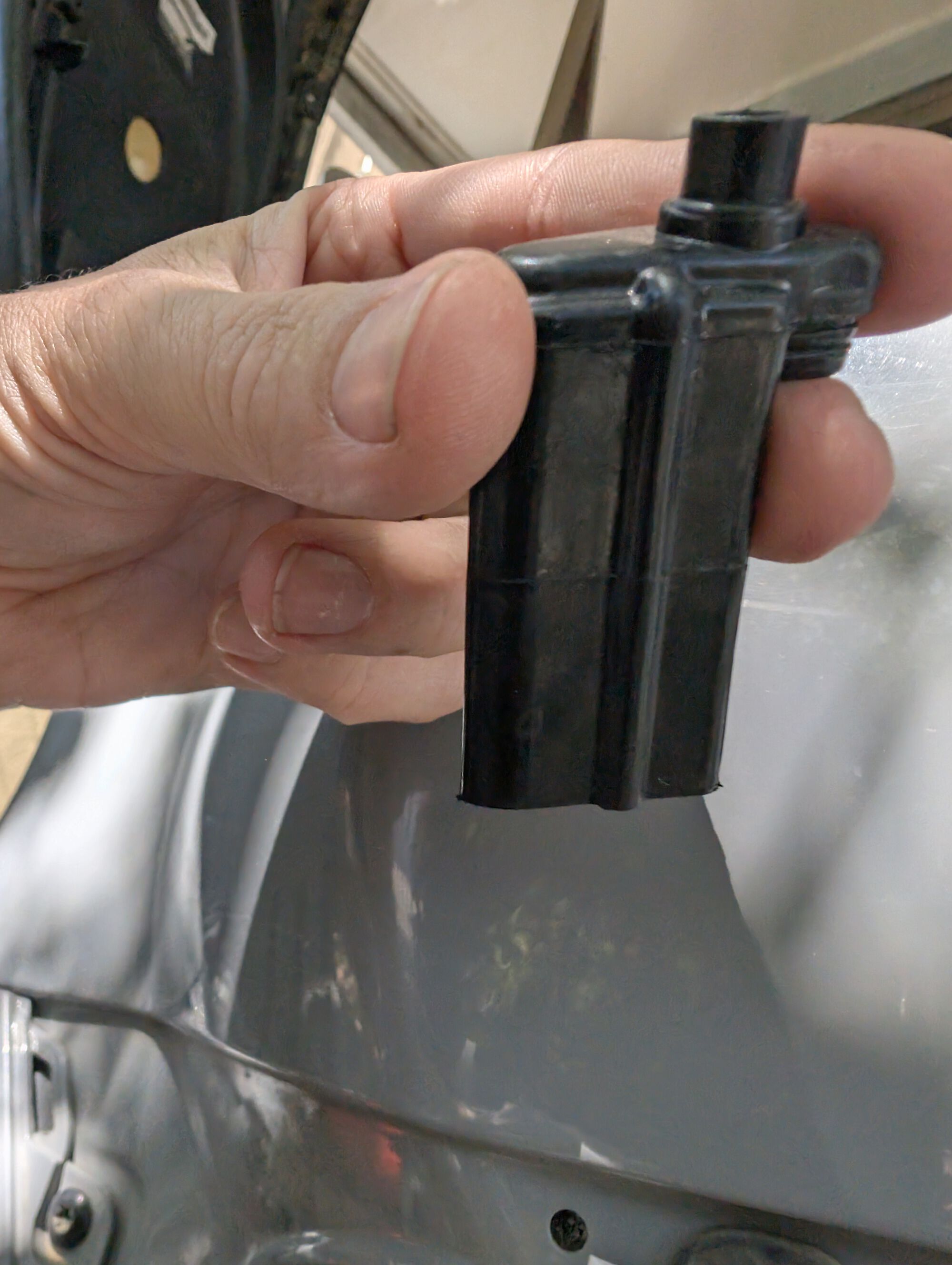

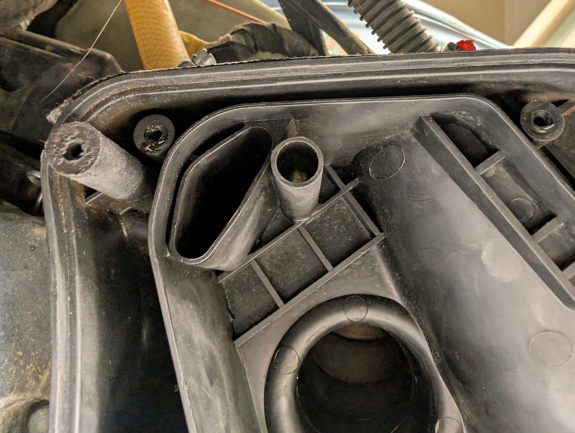

I was just thinking this morning that the exit of the breather into the box is right next to the cardboard and will get a lot of suck (see third arrow). maybe should stick a short hose on this that dangles down into the bottom of the box.
2019 GTS 300 HPE w Malossi cylinder kit etc
Posts: 8134
Posts: 8134
related photos, wish MV would let me reorder. (only 15km so clean filter)
the breather goes into the triangular thing.
part 30 (see prev) blocks off the long tube beside the triangle.
