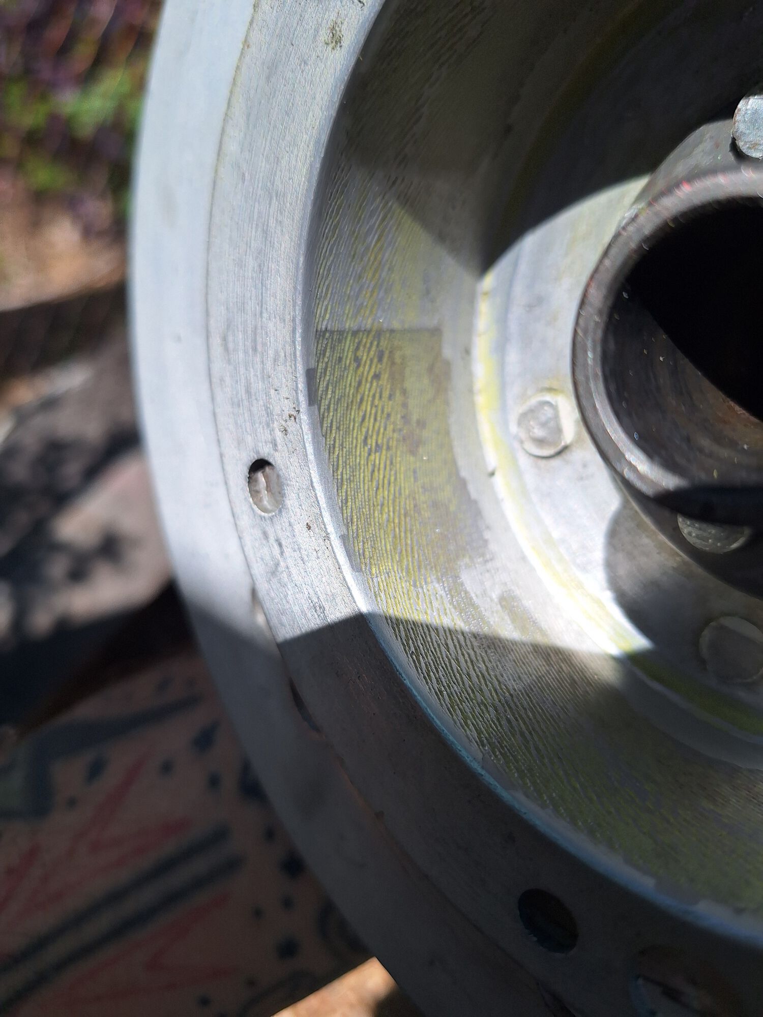

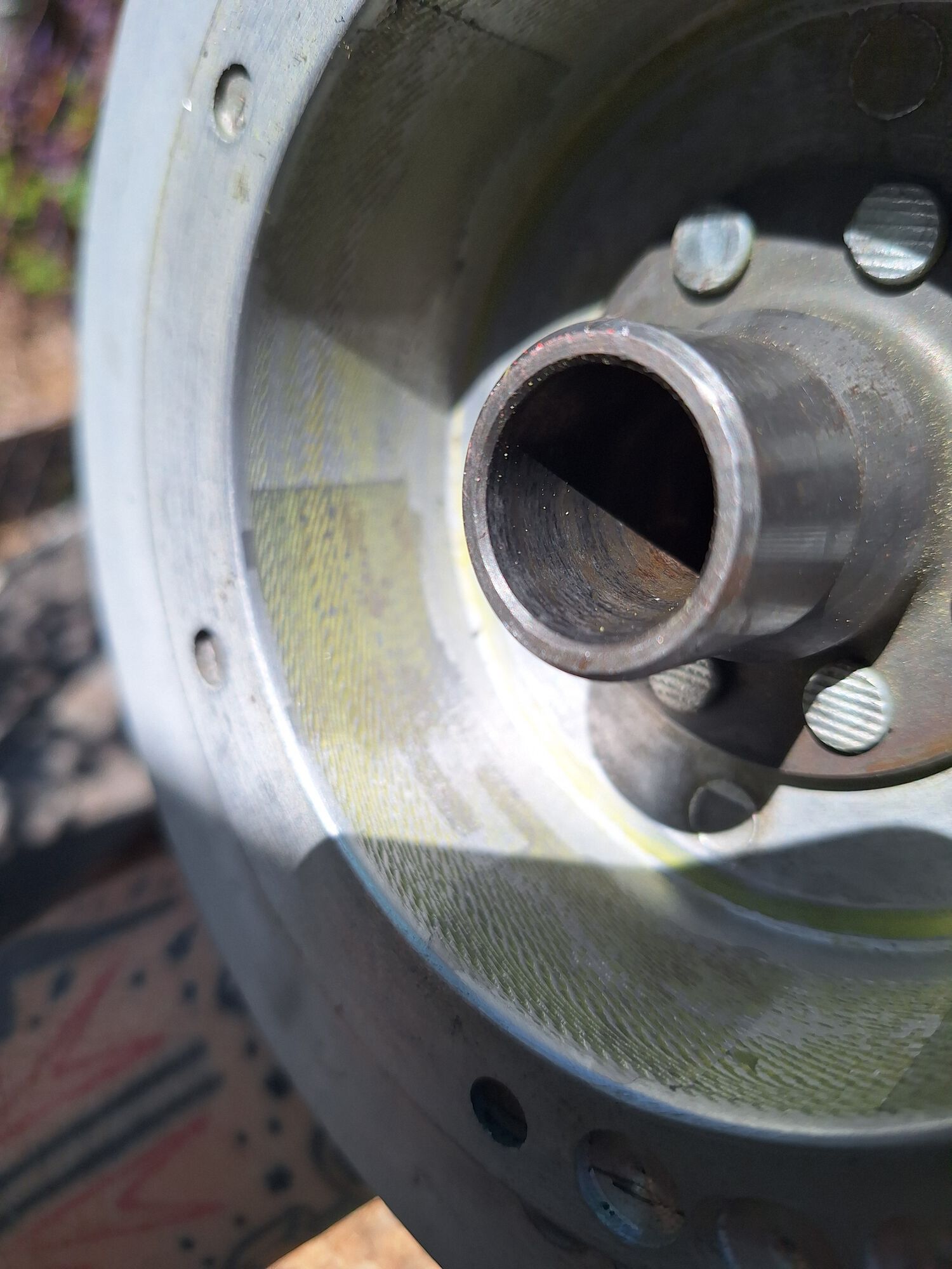

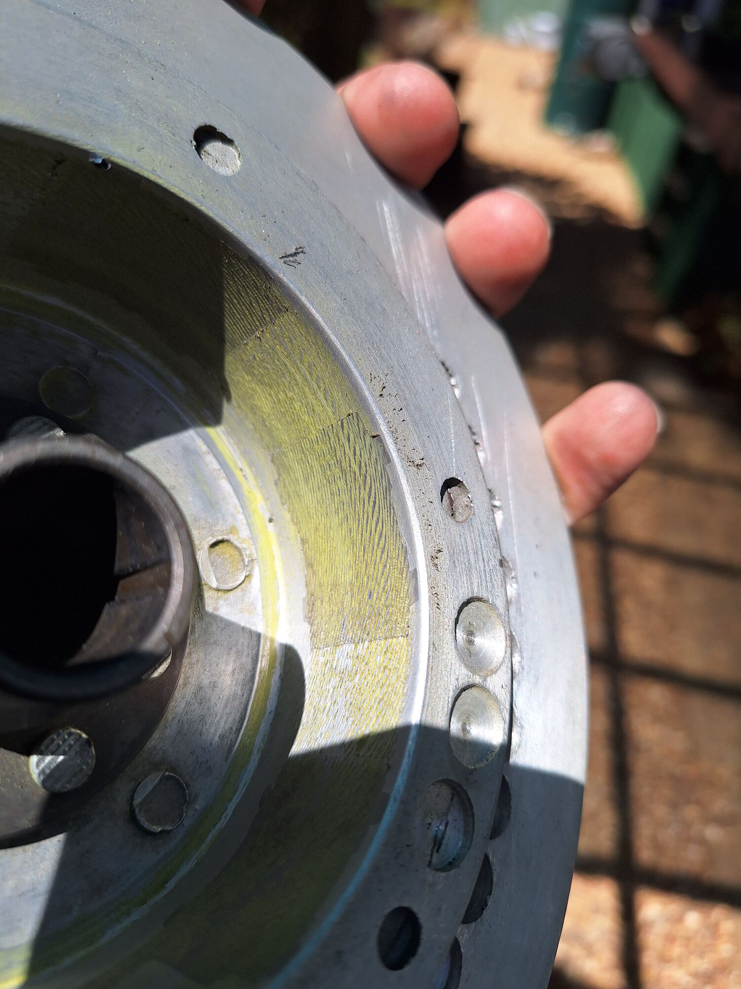

Okay, so Jack put a seed in my mind to try the factory flywheel. I had replaced it with a SIP touren version before I ran the scooter on the road. Here's a link...
https://youtube.com/shorts/mxuDX_IJxAE?si=qk1ytRmJAn0JA0pL
It's still a little fluffy up top but I put that down to jetting.
Attached are a few picts of the touren flywheel.. yellow coating on the inside which I don't know if that would affect it, also the finish of it is not so smooth.
I wonder if I can get it machined to a smooth finish, but just thinking is there a certain tolerance between the pick up and the flywheel that needs to be maintained?
Jet Eye Master
Posts: 5251
Location: London UK
Jet Eye Master
Posts: 5251
Location: London UK
Great, last thing tried was the issue. The touren flywheel is normally no issue. The problem will be what Hec posted. The height of the pick up will need adjusting.
Yeah, that sounds about right, thanks Jack, thanks Hec. Same though, never normally had an issue with the touren FWs.
