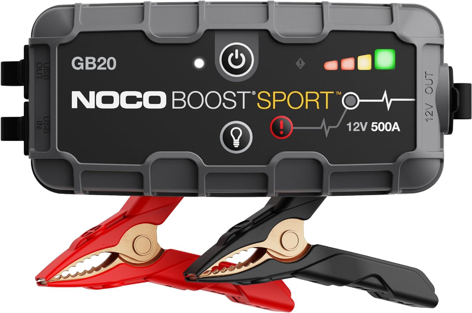

Yes! Really like their stuff. I have the 5A smart charger as well, and it has resuscitated and de-sulfated the truck battery on numerous occasions.
az_slynch wrote:
I have a GB40 on an Amazon case that fits nicely in my Kymco and my Majesty. That's part of the "touring" kit because I expect other people's scoots to have problems.
I have the GB20 in a NOCO case that is sized for it. Which makes the whole package a bit bigger than it really needs to be. But it will still fit under the seat nicely.

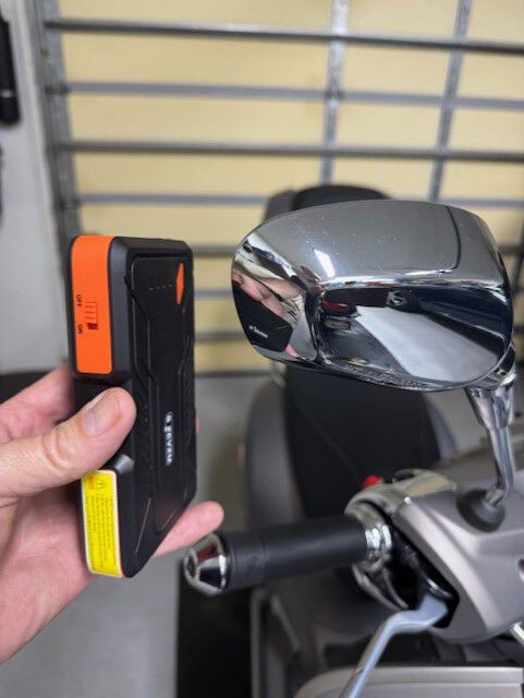

Mine is the size a iPhone 16Pro and twice as thick I got the smaller one to keep on the Vespa. here are the links and a picture to try to give perspective.
Charger
https://www.amazon.com/dp/B0BNVLL6MJ?
Cable this one is a 2 pack I have 2 Vespas
https://www.amazon.com/dp/B09QGGYXF1?

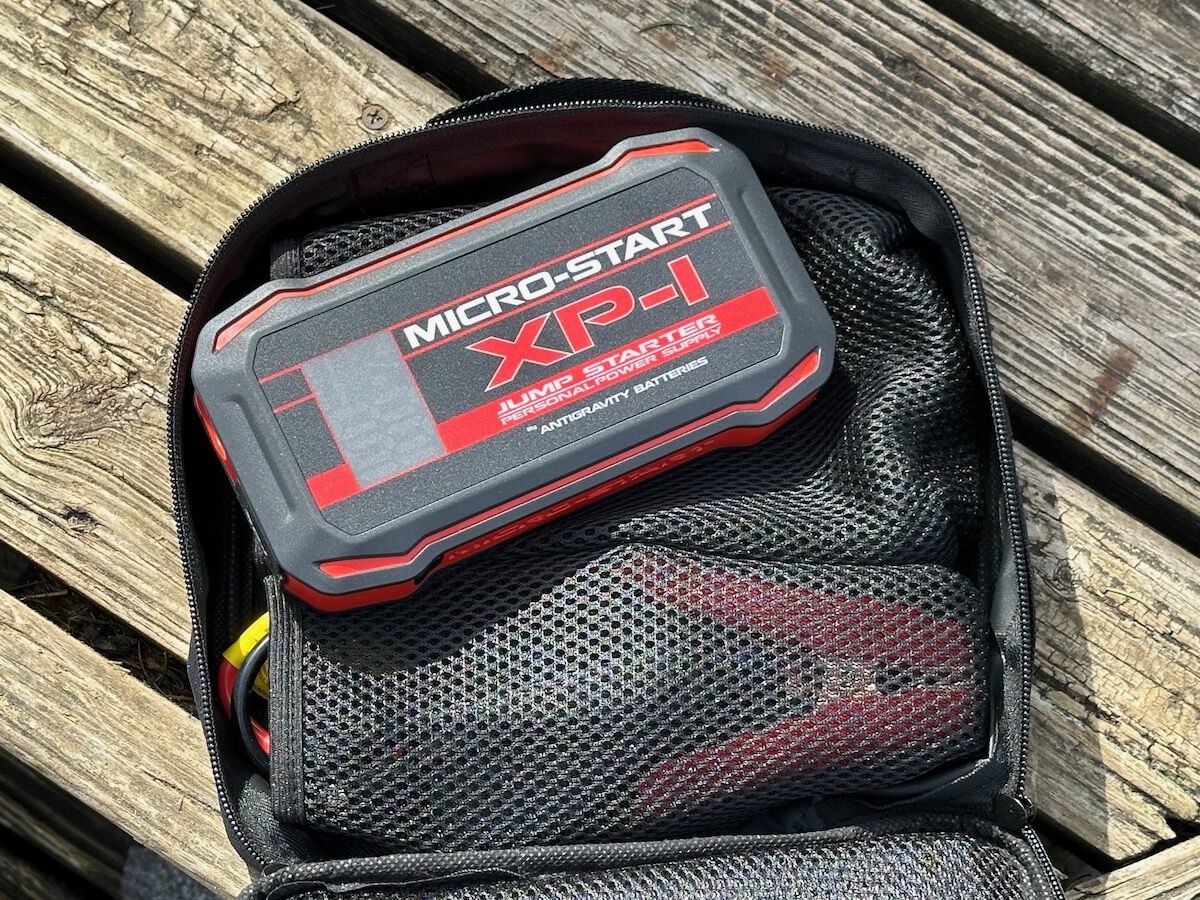

I've been carrying an ANTI GRAVITY battery for almost 15 years. During that time I have needed it three times. A small price for peace of mind when riding places with no cell coverage and little change of seeing anyone for a long time.
I just recently replaced my old one with a new ANTI GRAVITY XP-1 Micro Start battery. In addition to jumping my scooters and motorcycles it will recharge my phone, cameras, and other devices.

jess wrote:
Yes. Fusing is always good.
I notice on that Noco Boost Sport it says "12V - 500A". You cannot fuse that.
I think you can only use it with jumping cables directly connected to the battery poles.
Posts: 39576
Posts: 39576
Correct. But OP is talking about using the battery bank as a trickle charger, and using some fairly light-gauge wiring in between. In that case, I think fusing is mandatory to prevent a very low battery from drawing enough current to melt the wires -- in other words, to keep it from actually acting as a jump-start.
@petercc avatar
Piaggio Beverly 300 ie - 2012
Posts: 1574
@petercc avatar
Posts: 1574
Is there a setting on the battery bank for usage as a trickle charger?
If not, how can the bank make the difference?
Posts: 45711
Posts: 45711
jess wrote:
Correct. But OP is talking about using the battery bank as a trickle charger, and using some fairly light-gauge wiring in between. In that case, I think fusing is mandatory to prevent a very low battery from drawing enough current to melt the wires.
I've never seen a battery go dead short in normal use, at the most you might have two shorted cells causing a problem - and 10awg wires will be fine to boost the remaining four to a high enough voltage to get the starter to turn. The current won't exceed 50A (probably nowhere that) and a short length of 10awg can carry that just fine for quite some time.
However, perhaps I shouldn't say these things - if you don't know your basic electrics, battery characteristics or have to ask - just stick to the device's instructions. Especially with a fully discharged battery, when a different approach entirely is called for.
@jeffsvisor avatar
2023 and 2024 Vespa GTS300 SuperTech
Posts: 151
Location: Harrisburg, PA
@jeffsvisor avatar
Posts: 151
If you mean me let me clarify...I have a plug-in electric trickle charger separate that I use. The one I was using I discovered stopped working. That is why my battery died. I recently purchased a replacement electric trickle charger that works.
I bought this portable charger to keep in the Vespa and to use that plug cord (not the jumper clamps) to jump start the Vespa if out on a ride and the battery dies. I don't plan to use the portable charger as a trickle charger.
Posts: 39576
Posts: 39576
Okay, but... I am still skeptical that those wires are sufficient gauge for that usage. Maybe I am just being overly cautious. Anyway, I continue to believe that it should be fused to prevent disaster.
Posts: 45711
Posts: 45711
How much current do you think the starter takes once it's turning over quick enough to start the engine? Don't worry about inrush currents etc, they last for such a short time that they're immaterial.
And how long do you think this would go on for until the engine starts? Knowing that an engine that was running only a short while before should start within two turns, maybe a couple more for luck...
One reference point - I can run ~80A continuously for up to twenty minutes from the LFP battery in our van into an inverter when cooking. This is using about two foot of 8awg wire - which has twice the current capability (by definition) than 10awg.
30 to 40A through a couple of feet of 10awg for 5 or 6 seconds would be no problem at all.
Posts: 39576
Posts: 39576
My paranoia stems largely from an incident where I was installing a new stereo into jaded's jeep, parked in her garage in San Francisco. In the process of pulling on various bits of the wiring harness, I snagged a wire on something sharp. The wire was actually for the blinking LED of an aftermarket alarm (that I had nothing to do with) and in fact the alarm was off, so it wasn't even blinking. But there was still 5v (at some unknown current) running through the wire, because the alarm system used (I later found out) a ground-switched circuit to blink the LED -- so it was always hot. And apparently unfused as well.
That @#$$%% wire promptly caught fire, setting much of the interior wiring harness of the jeep on fire as well. And since the jeep was parked in her garage in SF, the house was above. Had I not managed to put out the fire, the house (and everything she owned) would have gone up in smoke.
I did manage to get the battery disconnected. And honestly, I should have disconnected it prior to doing anything -- which is the first lesson I learned from this incident.
The second lesson I learned from this incident is always fuse anything hot!
OP can do whatever he wants. But it is my opinion that those lines should be fused and I am standing by that.
