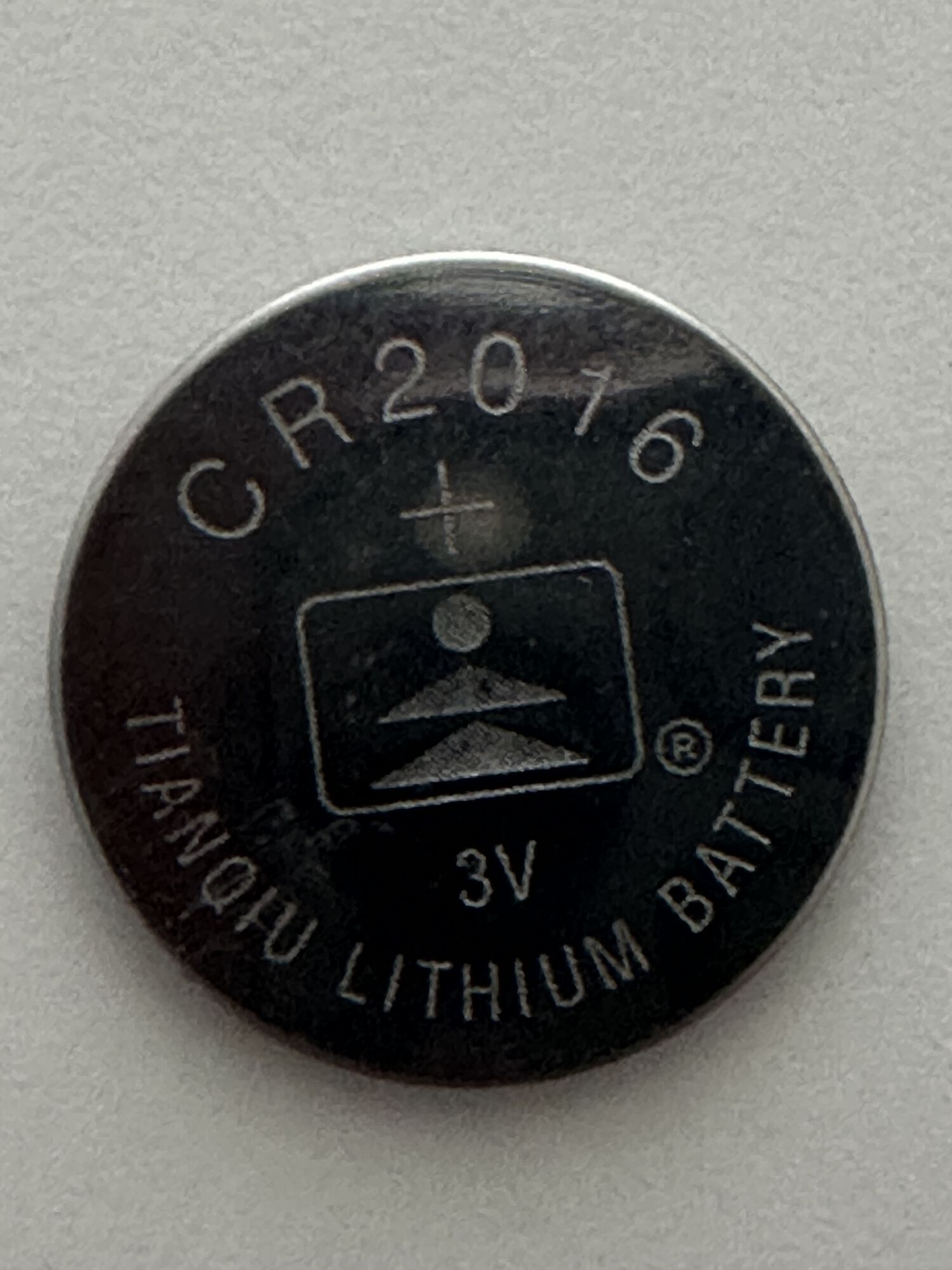

I don't think it's down to the battery manufacturer. Nevertheless, I have opened my remote control for you. The battery pictured is definitely the original one from the first delivery by Vespa.

That is very kind of you to take a look at your battery - much appreciated.
Having looked up the same battery I have ordered some off eBay - they are significantly cheaper than the ones I've used as a replacement so it doesn't really make sense that they will be better quality, but I'm happy to give it a try for £3!
