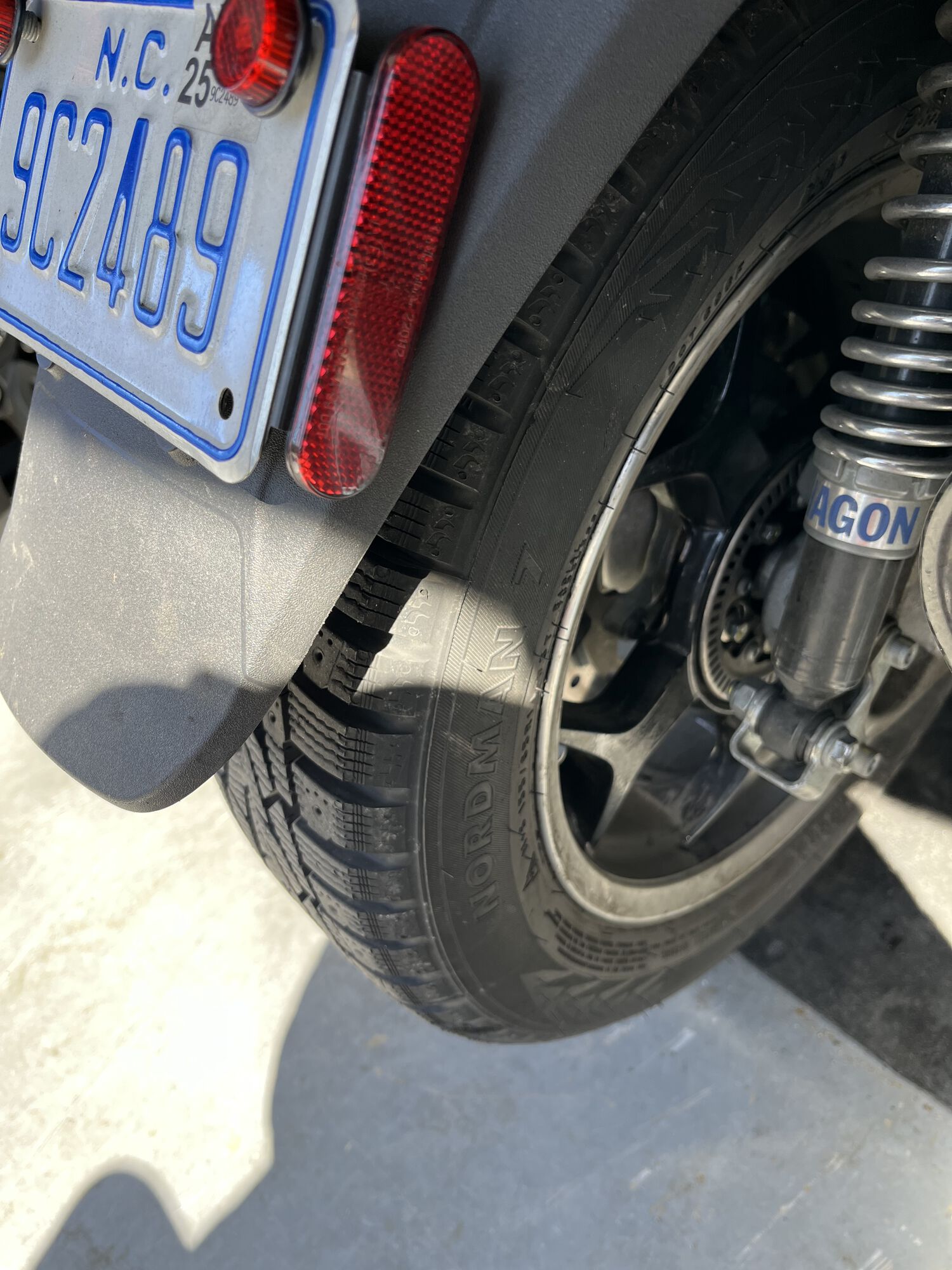

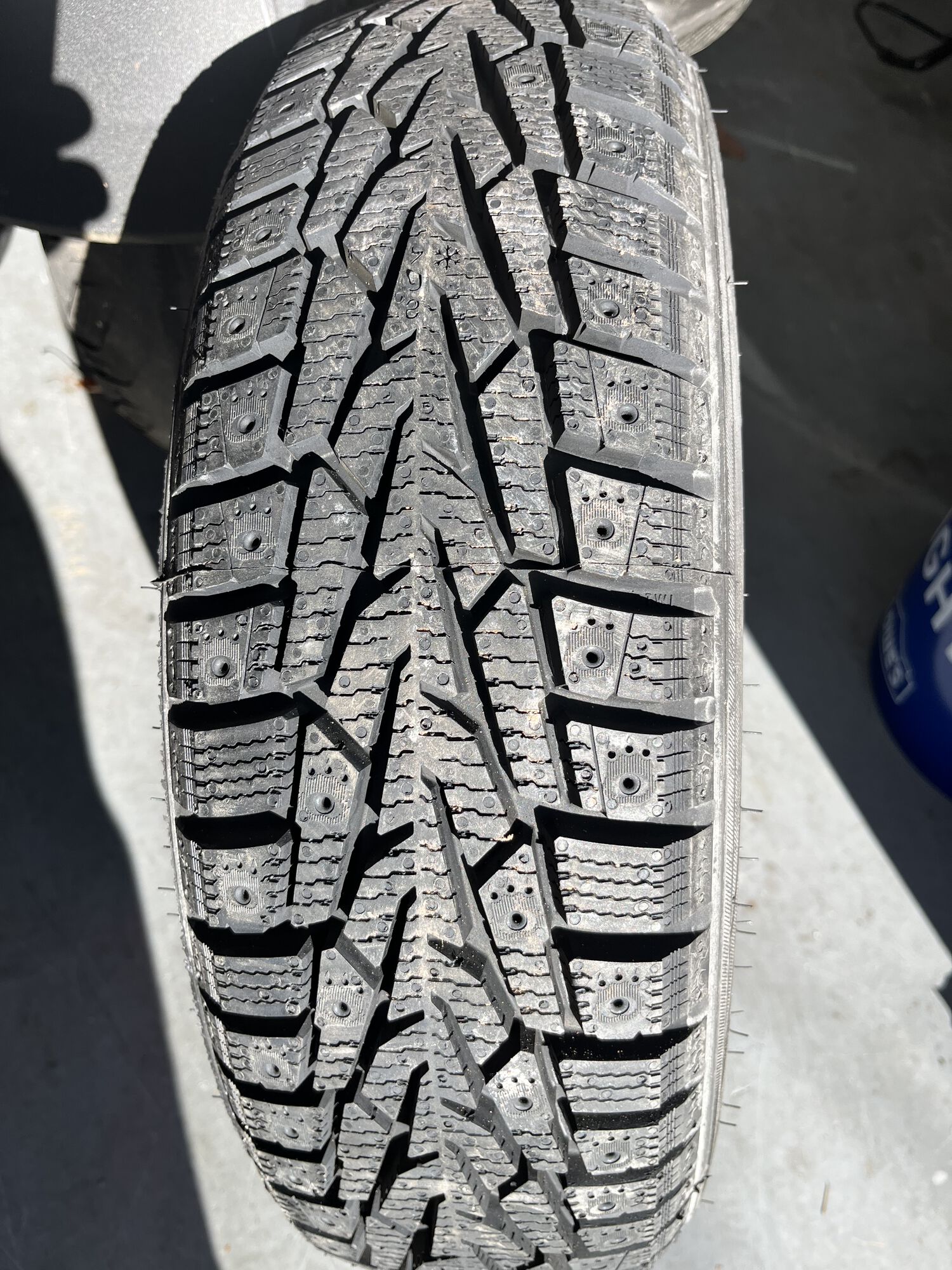

The last thing done was the move to the darkside rear tire. On an earlier post I showed to condition of a new 150 city grip2 after about 3500 miles. Pathetic and pityful. Allegedly in western N.C. they put a lot of granite in the road surfaces but between the pain of removal and installation and the price of good tires I felt compelled to try darksiding. Installation wasn't the easiest and it took a good lubing and 90 lbs to get the tire to seat with a nice pop/pop. I balanced with 11 oz. Of rideon liquid and went for a test ride. I had been very conscious about tire selection and looked for a tire with a nice shoulder, softish compound and deep tread. I can honestly say that after a blast through one of my favorite mountain twisties course I felt zero issues with the handling, initiating tip in, etc. Ran great and felt great and considerably more comfortable at 33 psi. Than the Michelin city grip 2's. In fact I'd say there was less of a pronounced difference to the ride than when I go from a well worn scooter tire to a new scooter tire. If someone just hopped on and went for a spin I don't think they'd ever know…but I'm hoping for 15-20k instead of 3k and that will be a huge deal…a big savings in time, effort and $$$.
Here's some pics of the city grip 2 after 3500 miles and a couple pics of the new tire.[/img]

That was done at the last oil change at 6500. Drive belt plus 21 g Dr. pulley sliders. That's when I put 3 new upsized Michelin city grips on as well including the pityful rear in the pics. The fronts are fine…and easy…but it will be a blessing for me or whoever to not have to deal with frequent tire changing.
