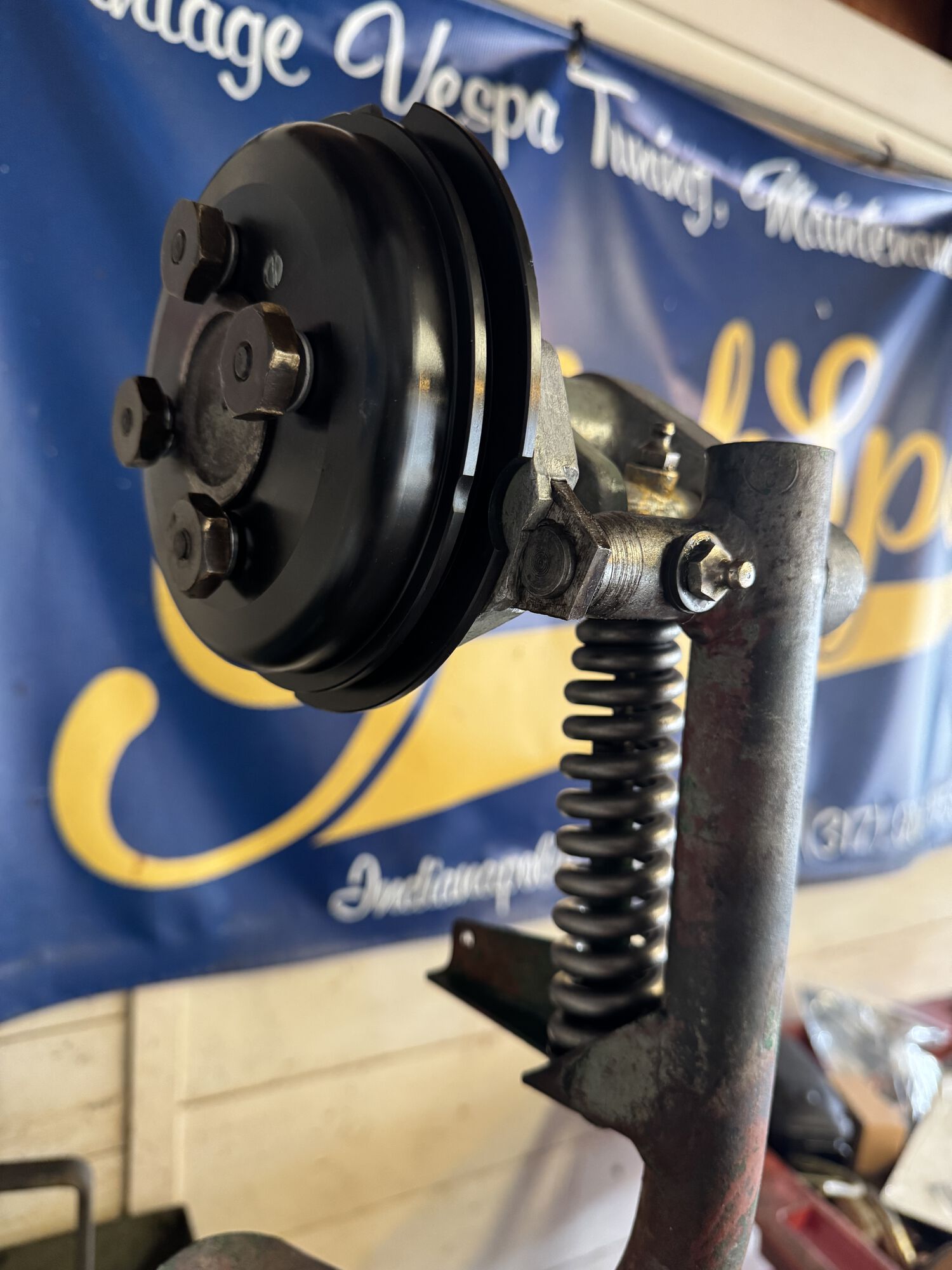

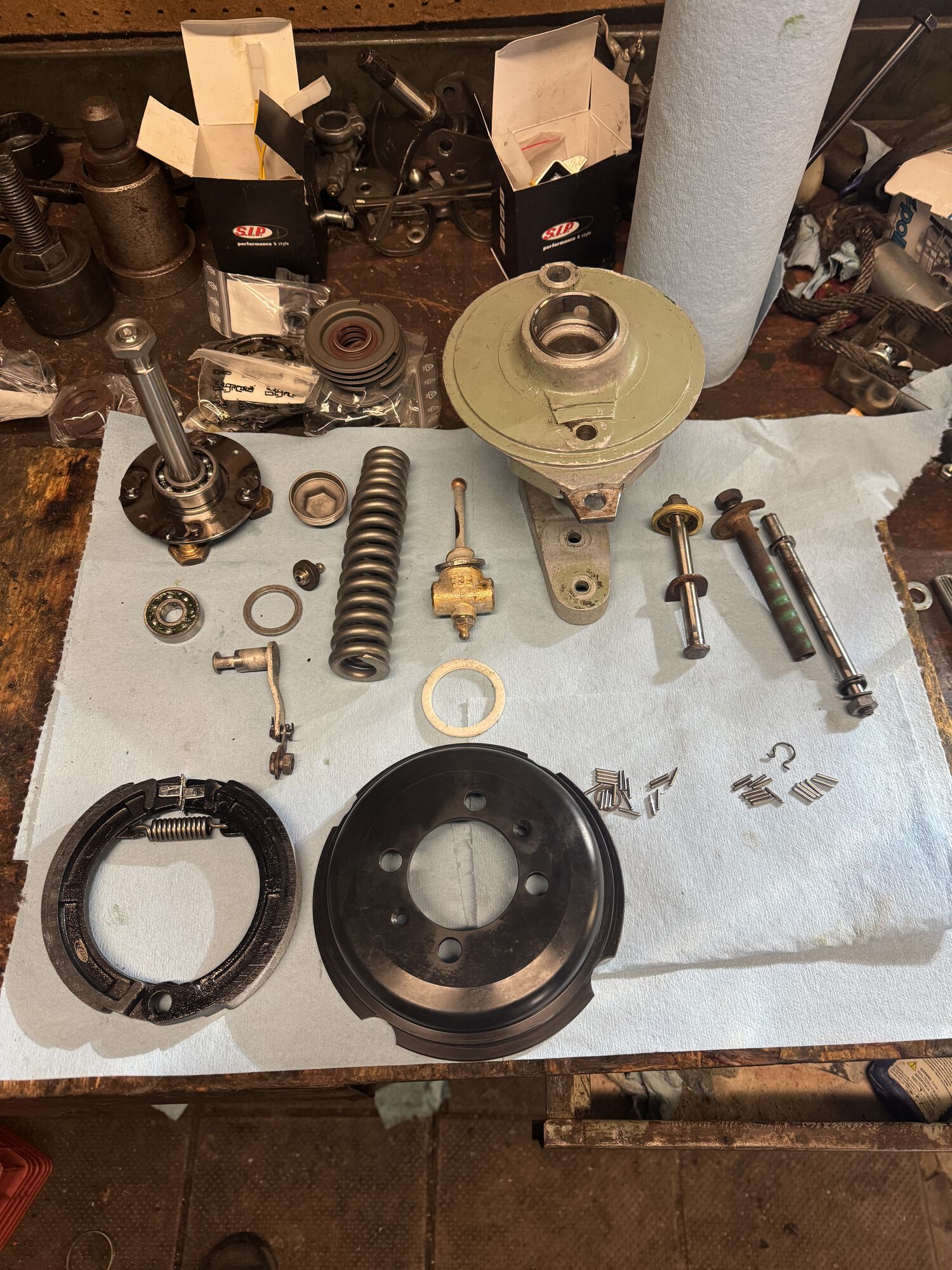

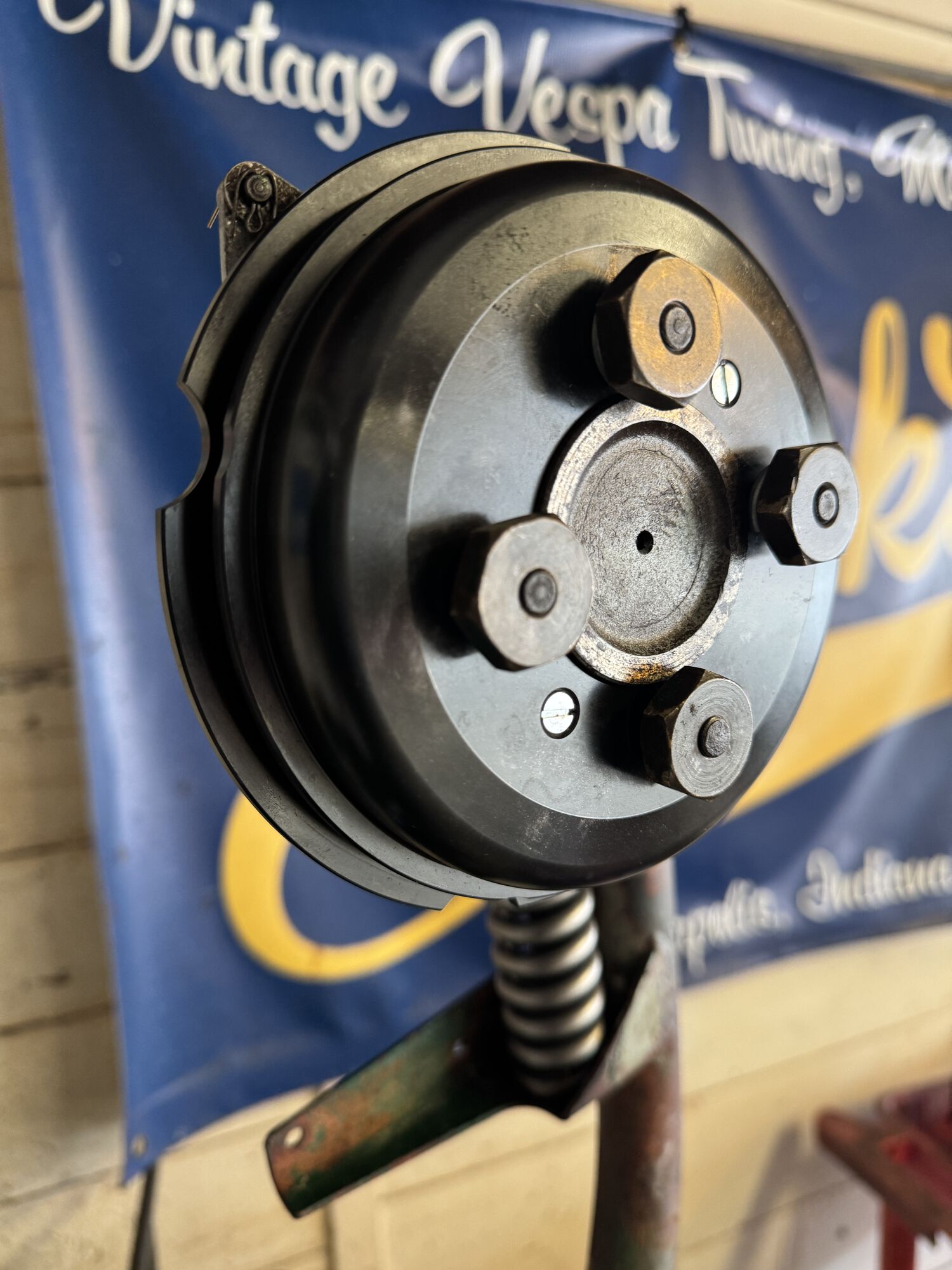

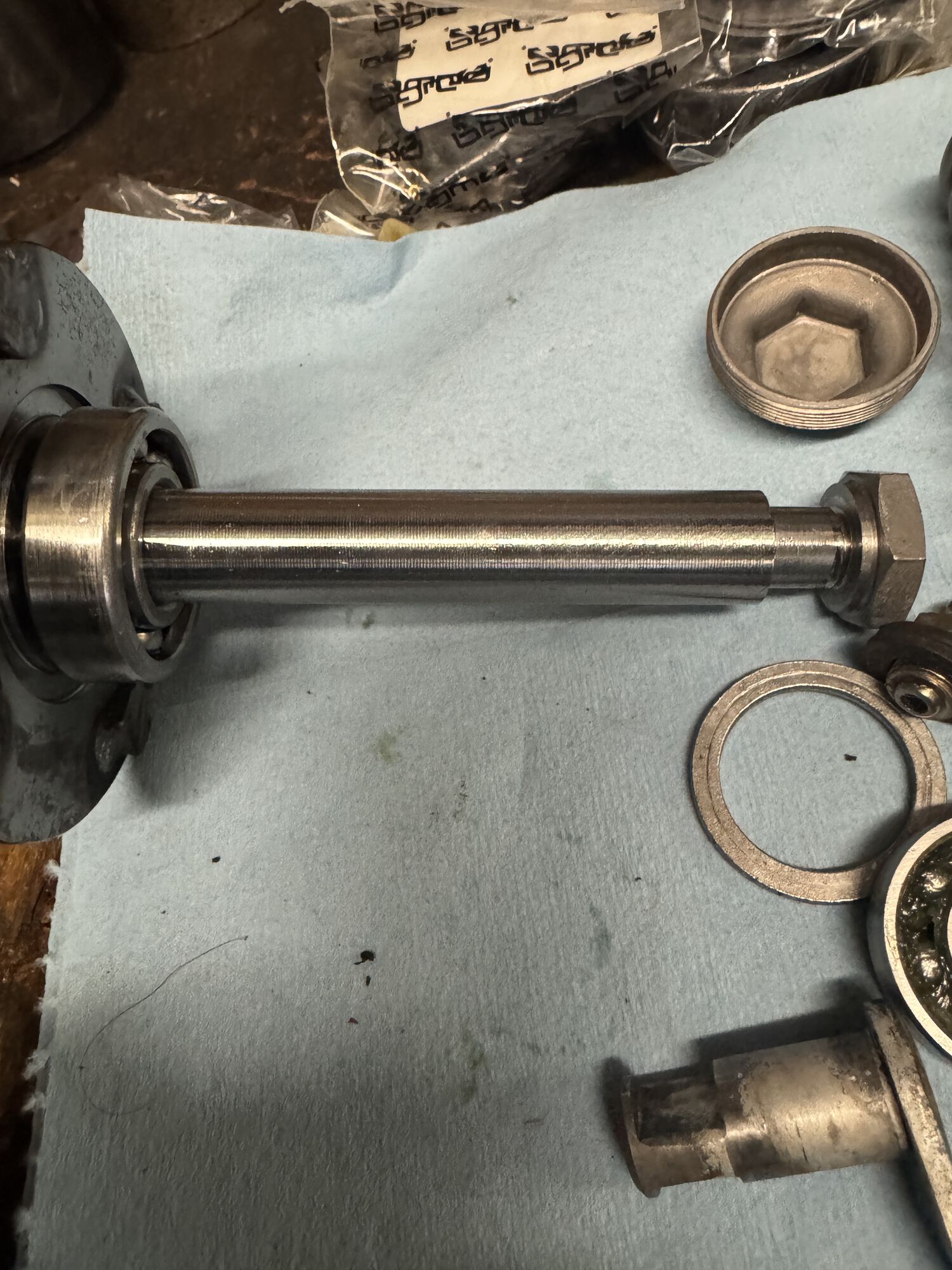

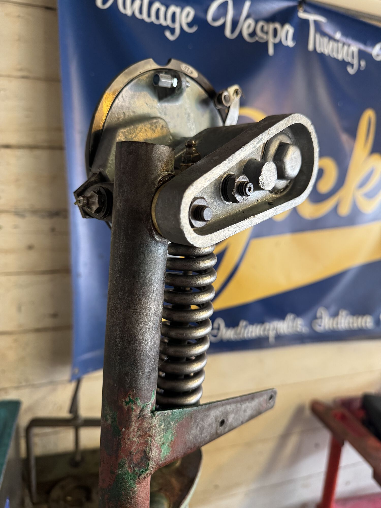

This would also cover early Vespa; 1950-1954.
These have to be my favorite front ends to build. The Allstate 100 and 101 come with a button zerk fitting as well. I figured I would share as very few people see these in the USA let alone on this site. Enjoy!
This one is from a Sears Allstate 102, roughly 1952-1953.
Early differences-

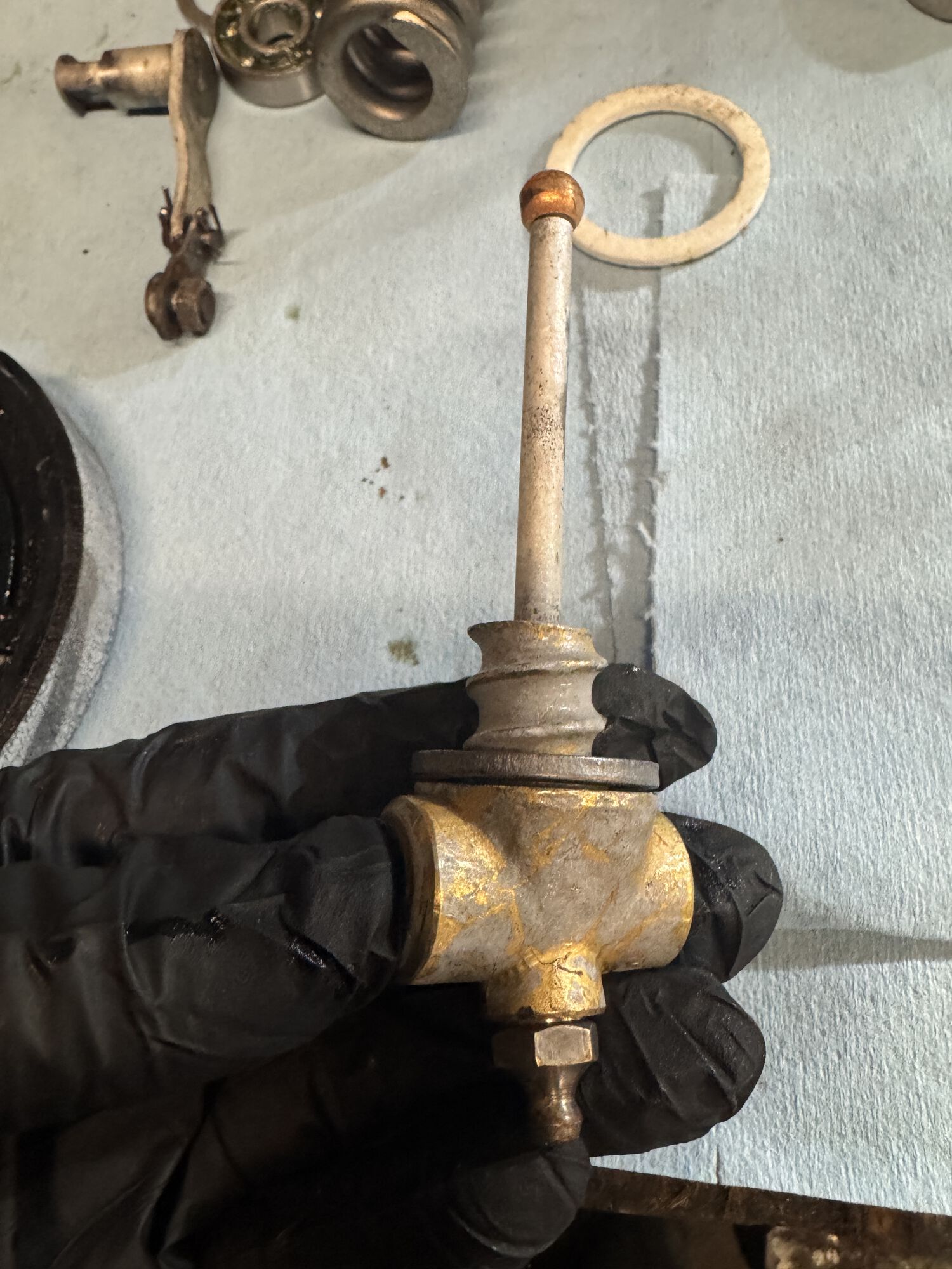

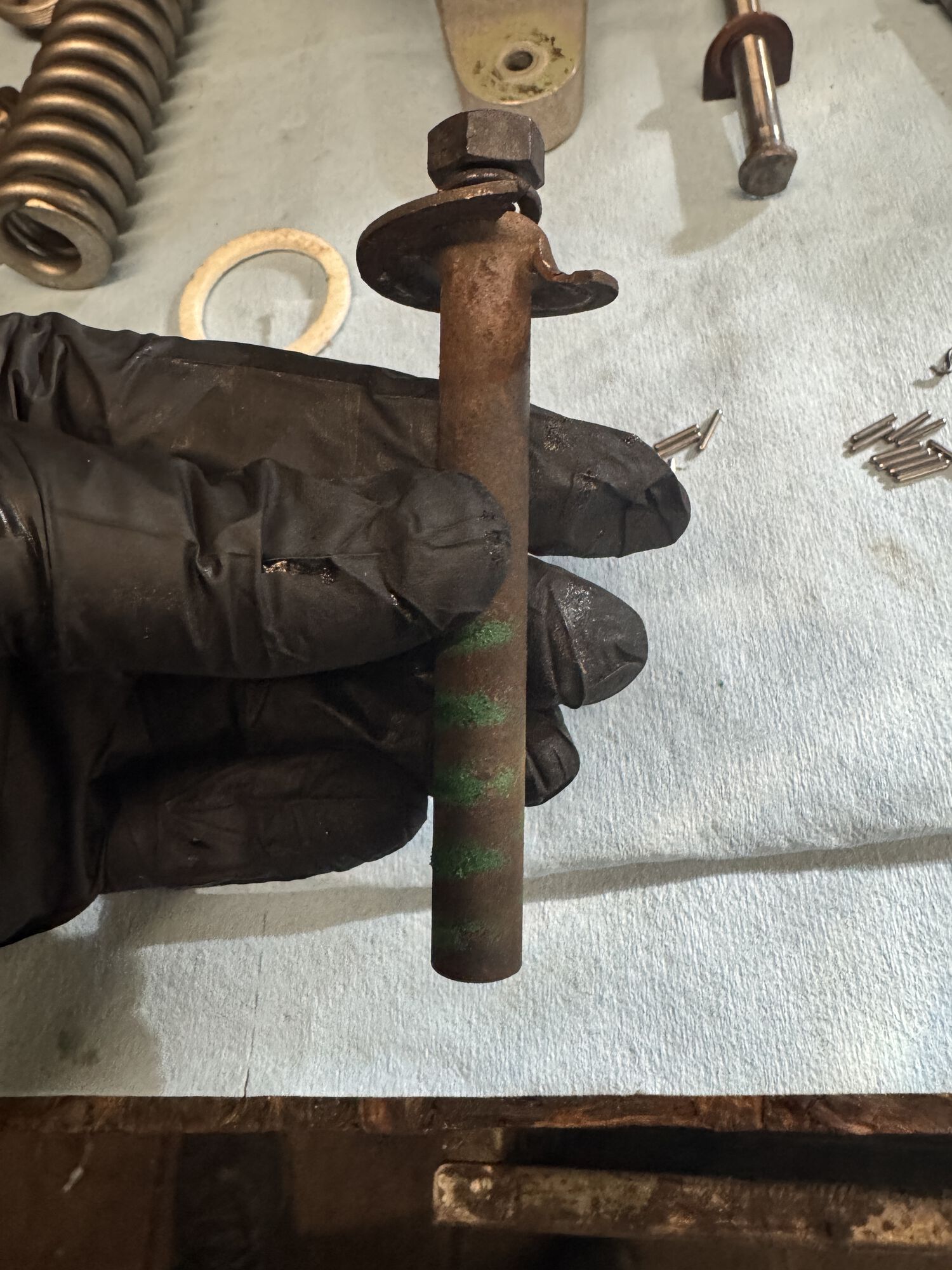

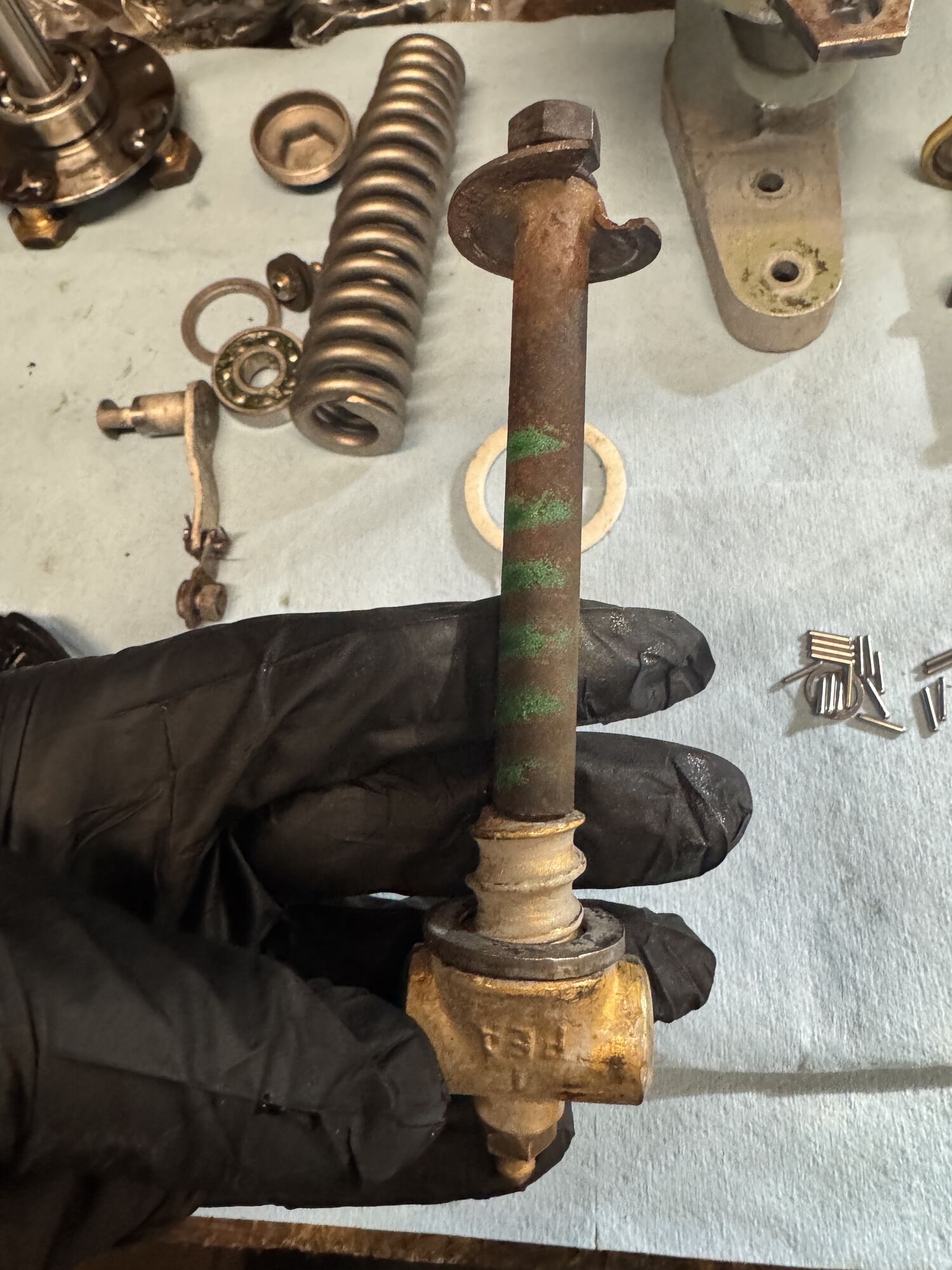

Brass trunnion has a rod and the upper a tube- acts as a primitive damper.
Spring is different.

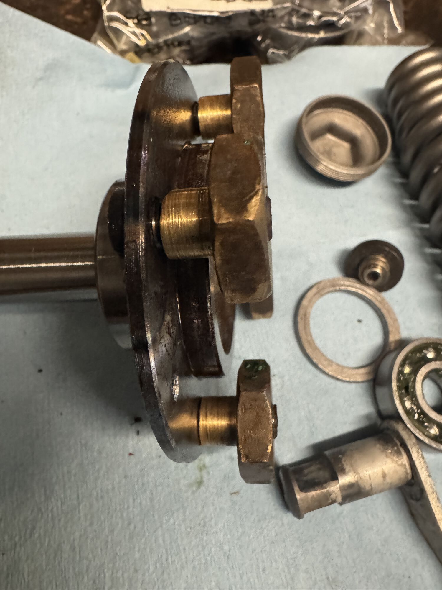

Front axle has no gearing as the bikes have no speedometer; headset designed for no speedo - not even a blanking plate. Same headset as the Vespa U model.
Collared nuts are brass

Is the internal "damper" just a friction device?
I can't imagine it would work well or for very long. Must be a reason they quit making them like that.
Friction. To be fair, 32 mph is about all you get out of a single port, 125cc.
