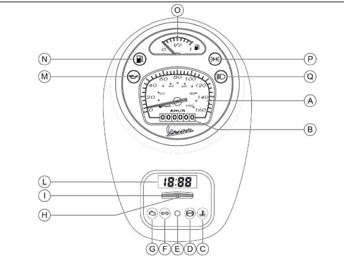

Wait...does the 2018 GTV have a coolant temperature light, or a gauge?
@germangtsdriver avatar
Vespa GTS 300
Posts: 1799
Location: Germany
Vespa GTS 300
Posts: 1799
Location: Germany
"C" is the warning light for the engine temperature
@jkj-fz6 avatar
Posts: 4718
@jkj-fz6 avatar
Posts: 4718
Thanks for that info! I was trying to imagine what a blinking warning light would look like and I realized my scooters have gauges, not lights and I wasn't sure that a GTV was any different.

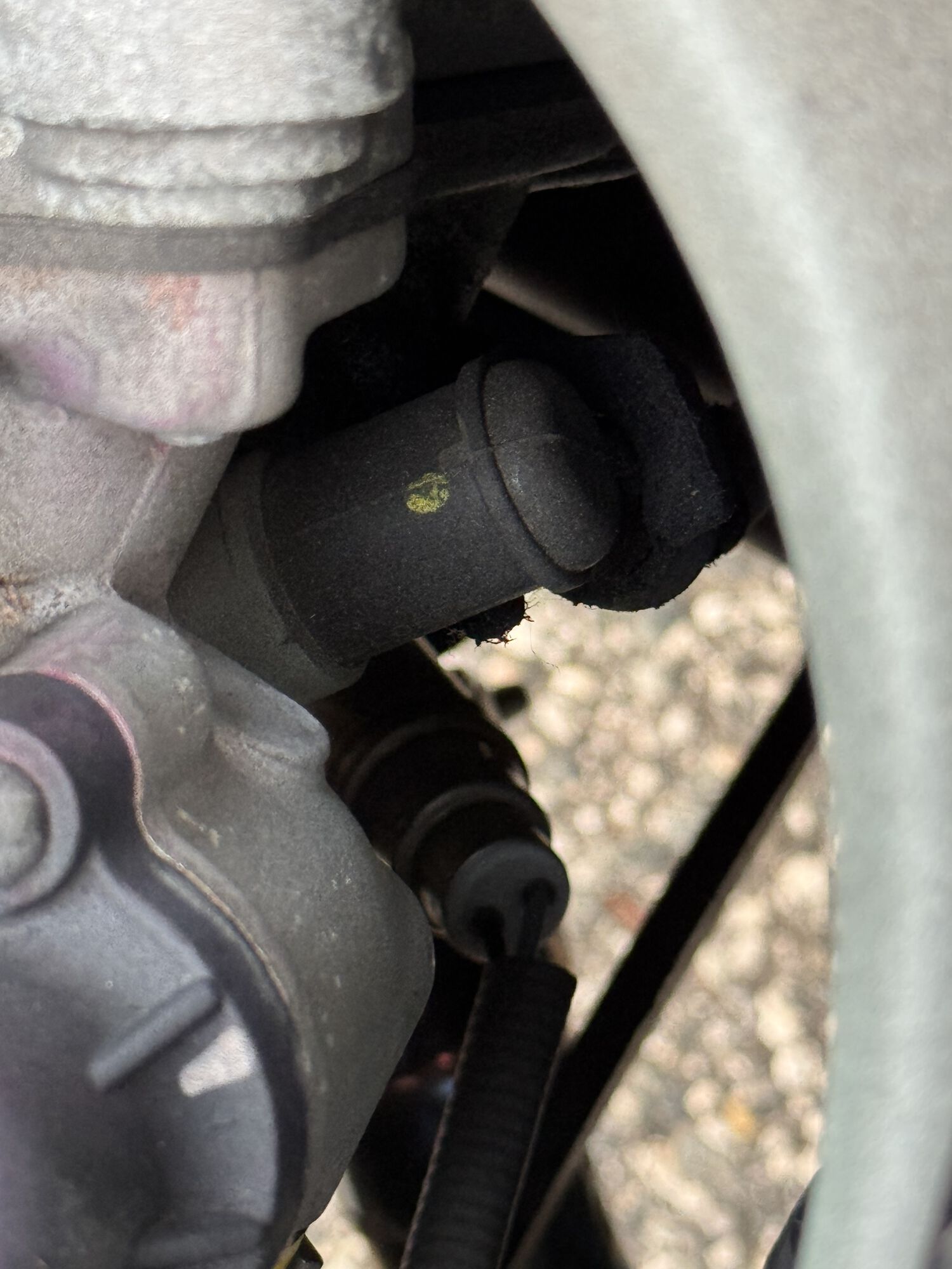

It's definitely the coolant. I need to fill it. I'm going to try this and will get back to y'all.
Posts: 8319
Posts: 8319
Is that pink tinges in your photo? That's a typical coolant colour. Might have been leaking...
