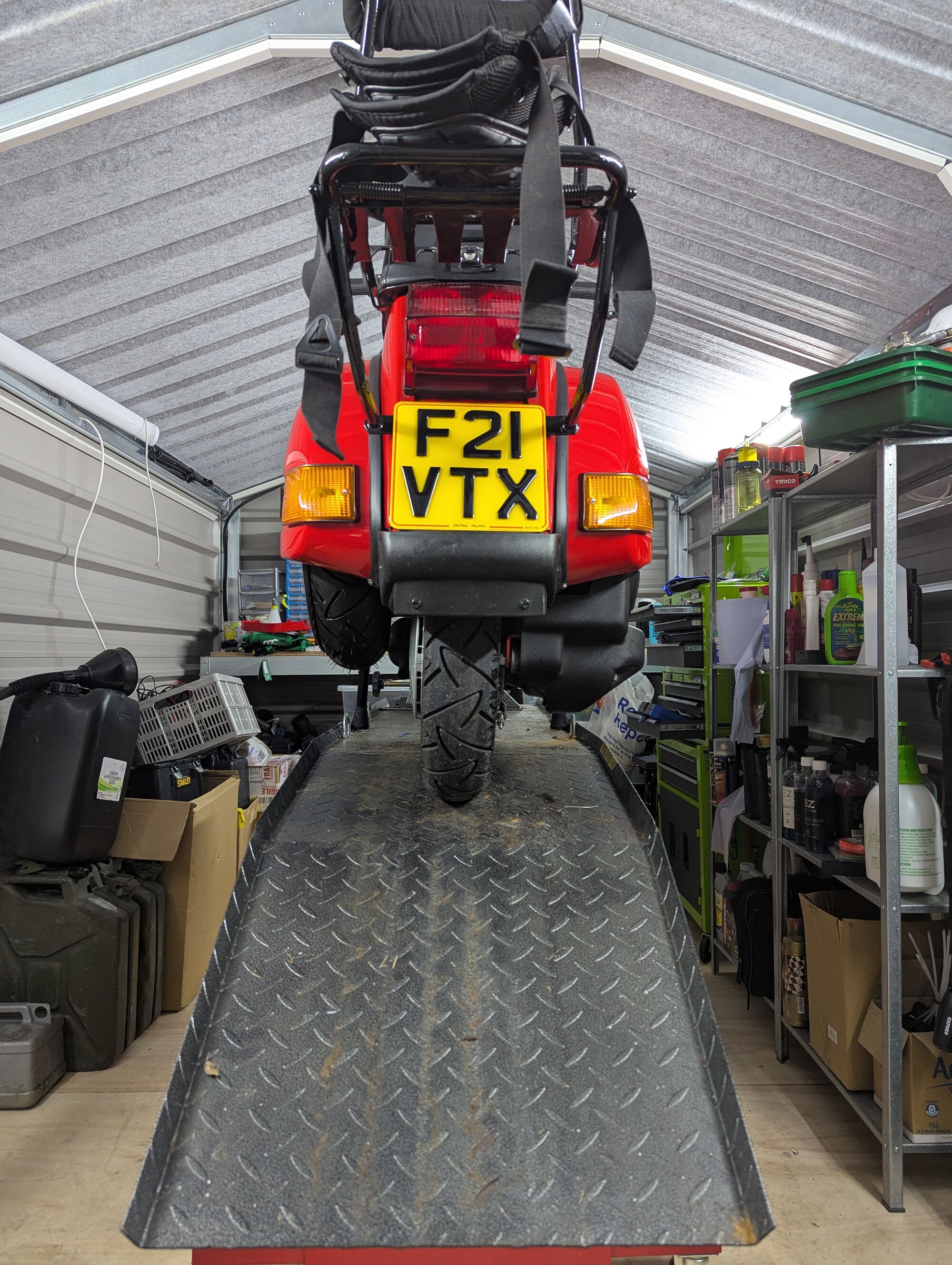

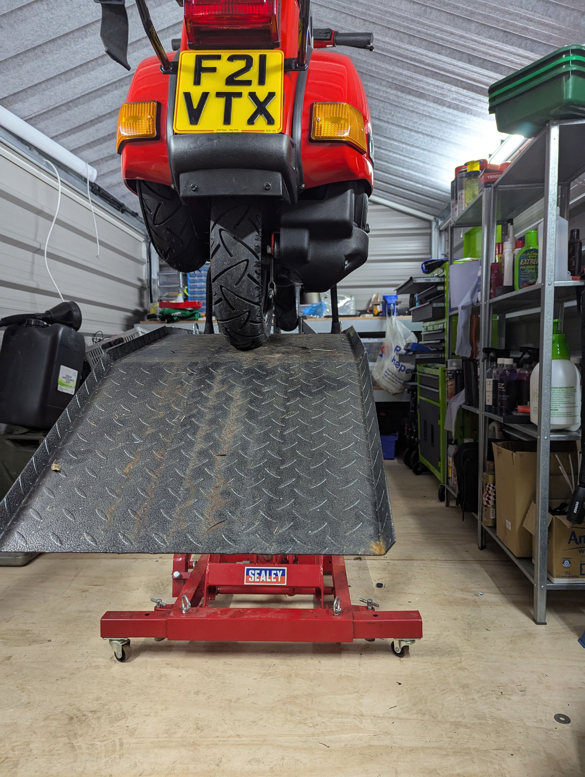

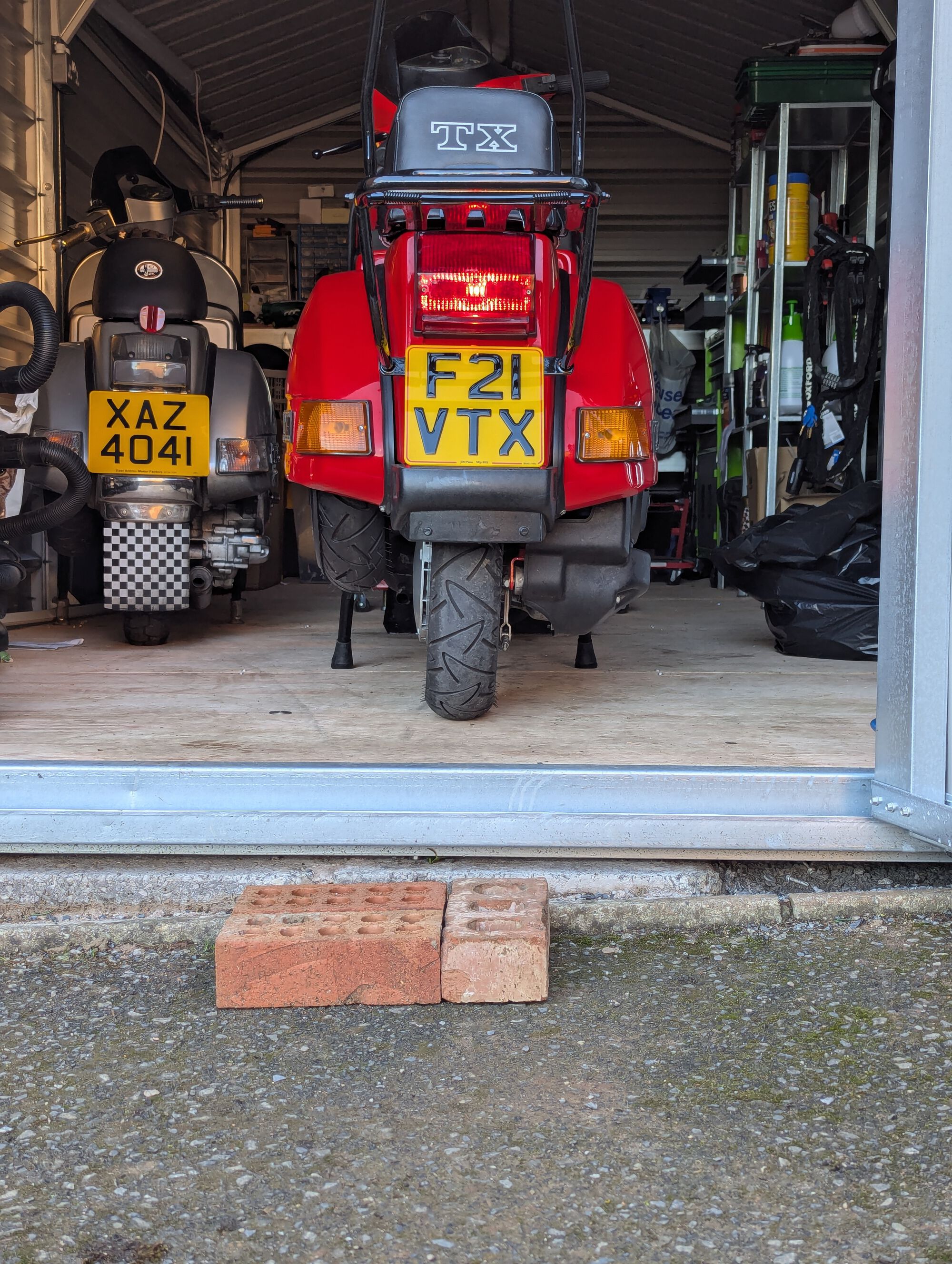

I recently came into possession of a rebuilt vespa tx200. Seems very clean with lots of receipts for parts from the restoration. Everything on it seems great however there's one thing that's giving me quite a bit of concern and that's the handling or balance of it when driving at any speed. It lists very hard to the right when I lift my hands from the bar.
I know the vespa isn't the most balanced of 2 wheeled vehicles, and I have others that do the same that can normally be corrected by counter balancing on the seat a bit. But this seems extreme.
So far I've checked the below.
SIP tubeless rims seem fine.
Brand new contitwist tires
Tire pressure tested at different psi's
No play in front or back wheel or bearings.
New shocks were installed on it

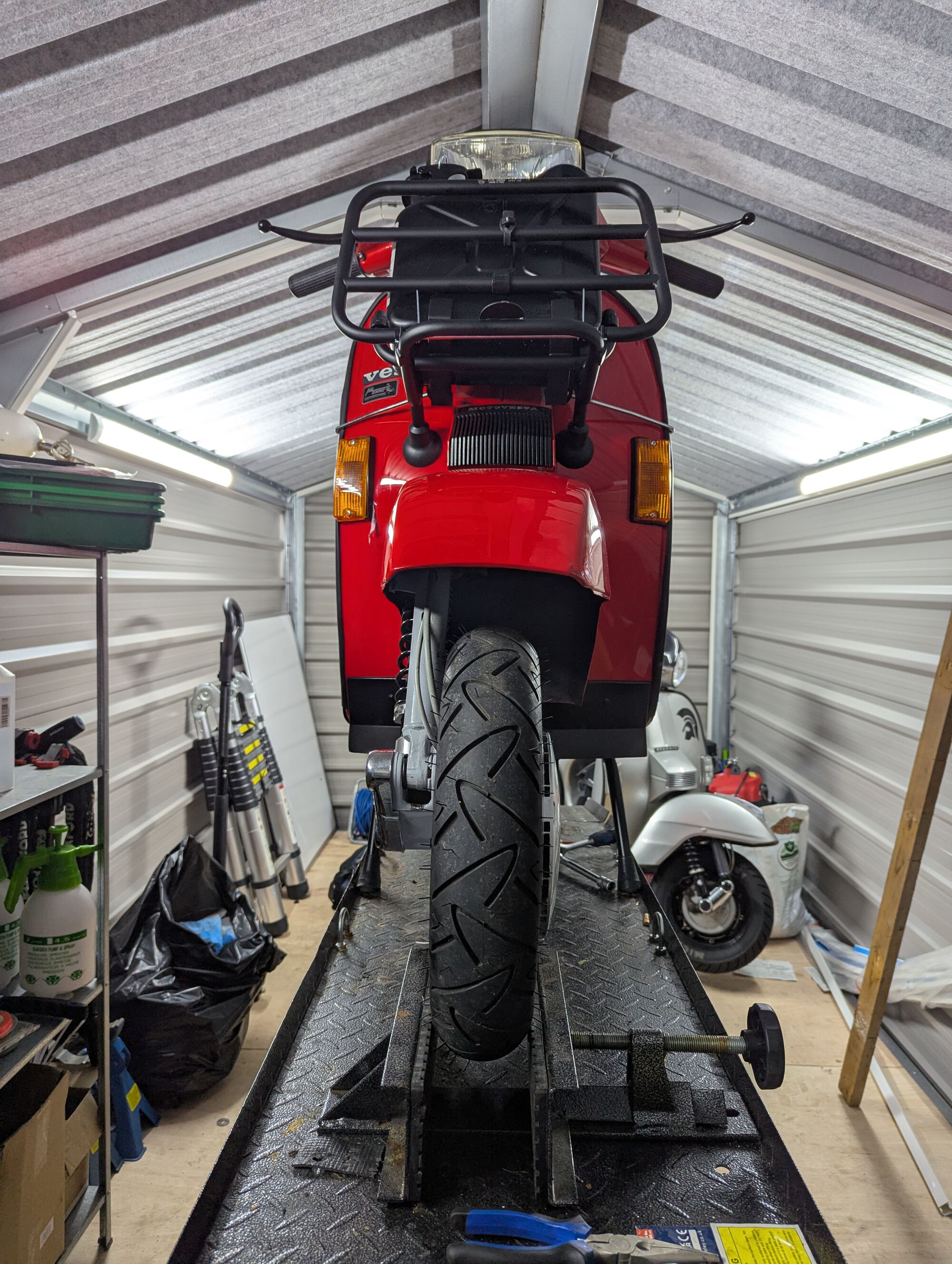

Front wheel seems to be sitting aligned ok.
Not sure about the back alignment of the frame which has me worrying it might be twisted
Is there anything else I can check before pulling the front forks out and checking they aren't bent?
Hard to tell from the photos if things are out of alignment or not but running out of ideas.

It appears that the rear wheel is canted to the right. I would guess that something is twisted in the swing arm. New bushings might help, as above.

Rear tyre is definitely tilted. Look at the dust coverage. More sidewall on the left.

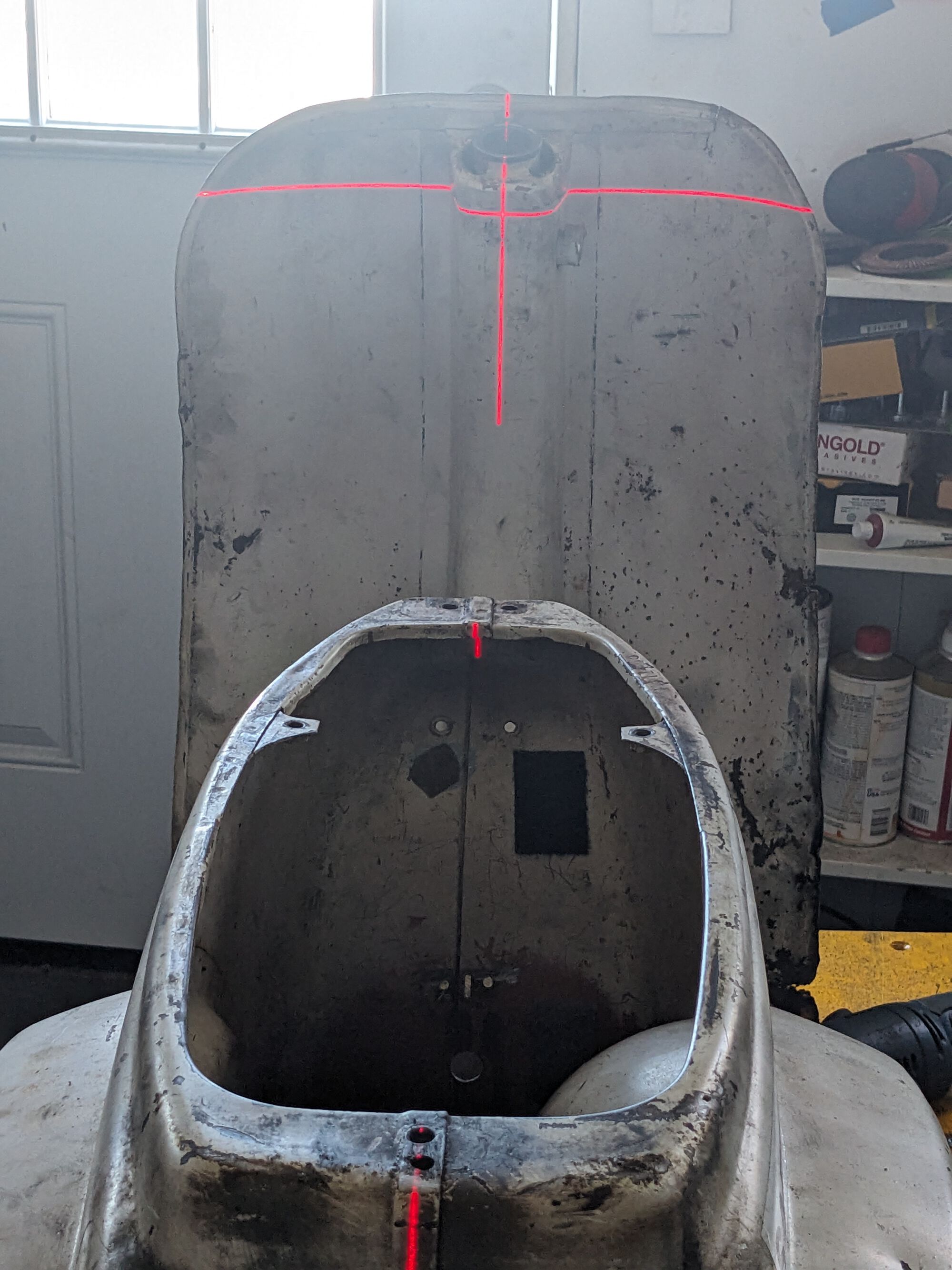

If you have access to even a cheap laser level, you can check if the frame is straight.
Take the seat off and make sure the center seam at the seat post and front of the tank cavity align with the center of the fork.
