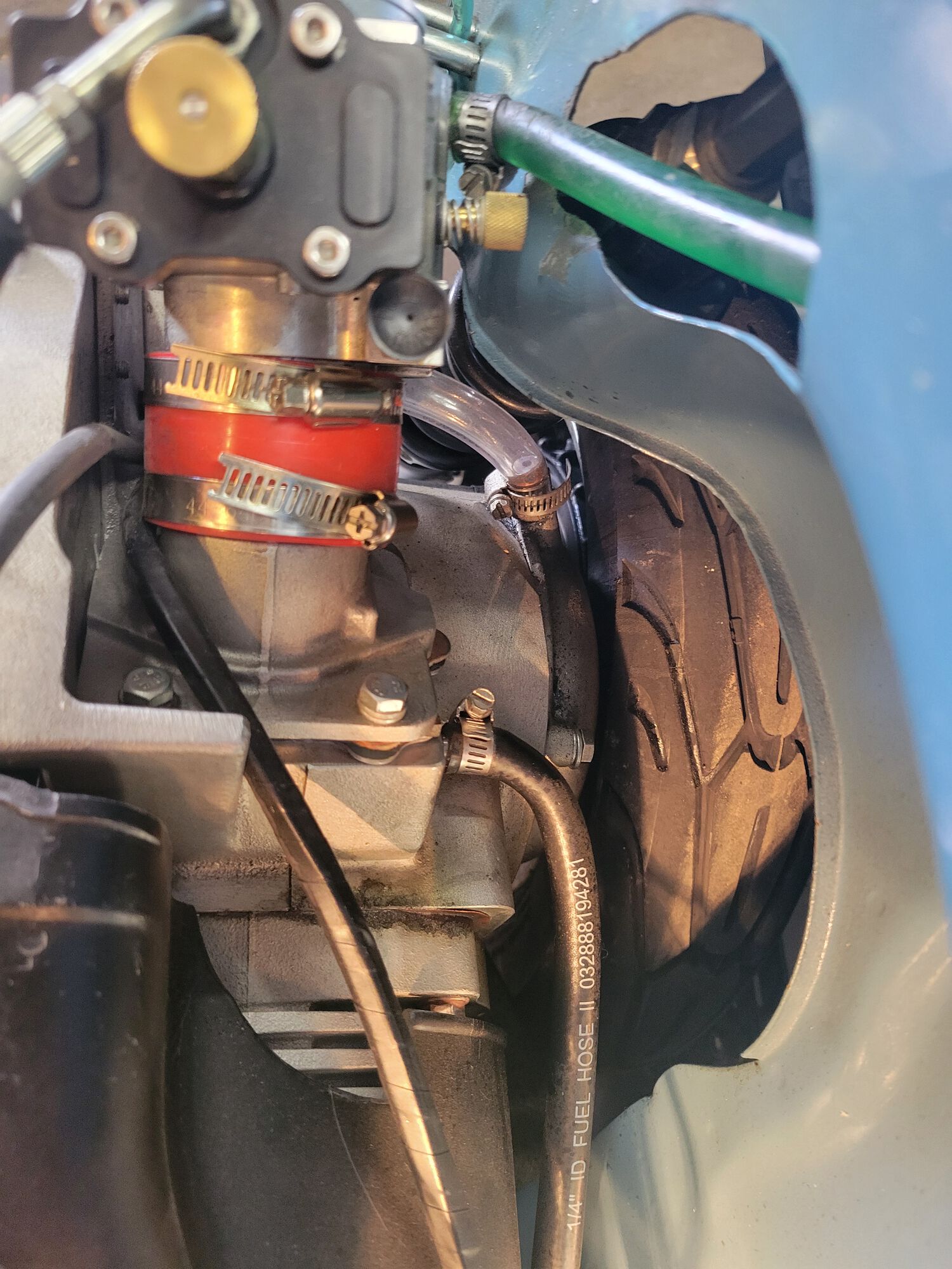

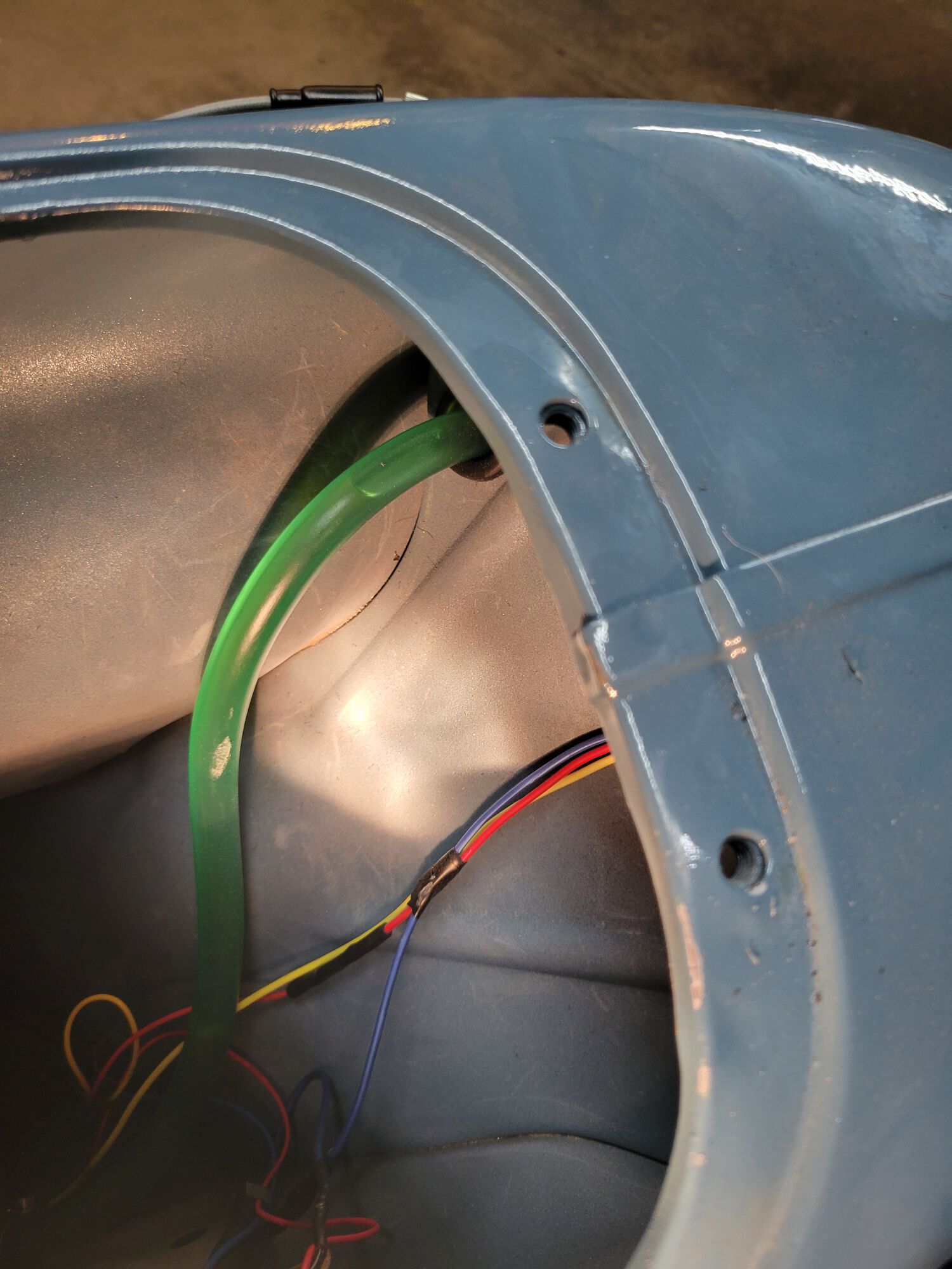

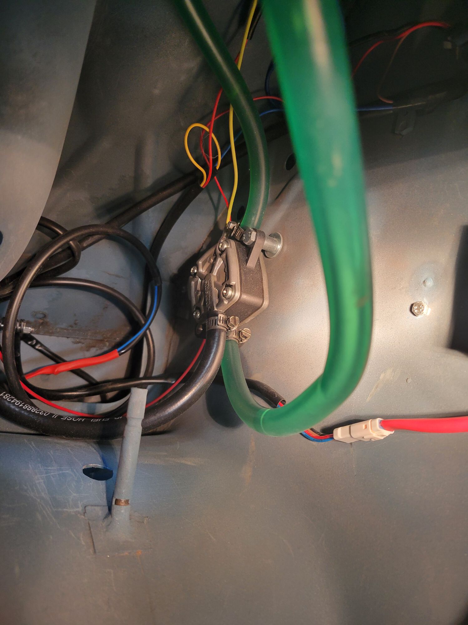

Here are some pics of the setup.
Black line from engine to pump
One green line from tank to pump
One green line from pump to carb
Thanks

That helps explain it. It should work. A few changes will certainly help it work better.
Turn the pump 90 degrees, so the vac line is at the top. Shorten the line from the tank to the pump, so its straight down. When the tank goes in, things might change.
