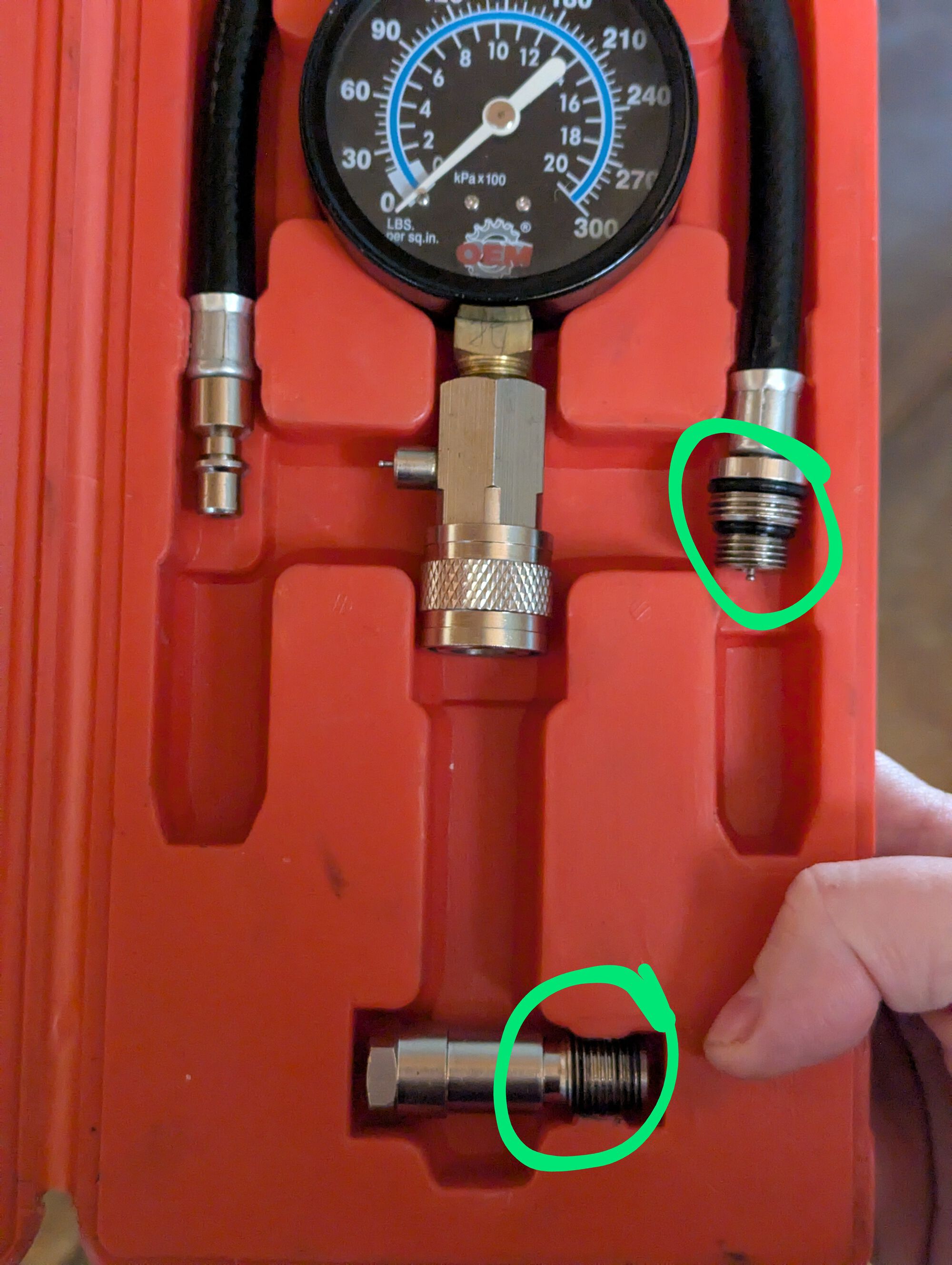

If you have a compression tester like the one below, put a dab of grease on the adapter threads and run in down by hand. When it stops, put a wrench on it and add at least a half-turn, possibly more depending on how loose it feels.
Put a thin skin of grease on the O-rings of the hose assembly. Screw it into the adapter by hand; the hose will be a bastard from being stored in a curved state. Twist the hose until it seats firmly. Then connect the gauge.

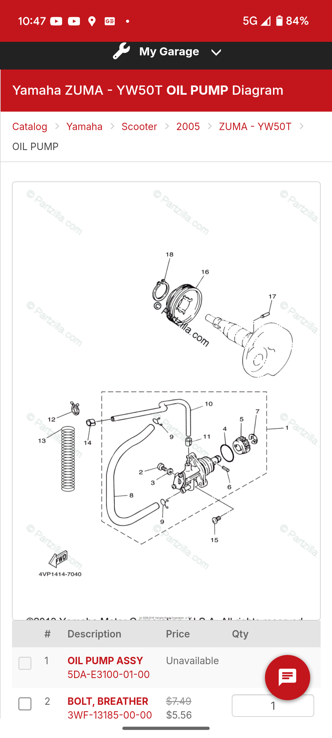

As for the oil pump, have you checked the worm drive gear assembly yet? It's accessible if you pull the fan cover, the fan, the flywheel (27mm left-hand puller needed) and the stator plate. There's a gasket behind the stator; if you carefully lift it with a plastic knife, you can probably reuse it. That well behind the gasket holds the pump worm gear.
The gear held on with one snap ring and is driven by the crankshaft by a single pin. The whole thing is lubricated with white lithium grease. It the grease is dessicated or absent, the plastic worm gear will get chewed up while driving the pump gear. Check for plastic shavings. The drive gear is the same as an '02-'11 Zuma 50. Part is still available from Yamaha, per Partzilla.
For additional details on the pump, if there's oil in the tank and the lines are connected, does oil gravity feed out of the pump if you loosen the bleeder screw (#2 in the attached parts diagram)? We're looking for obstructions in the line or the tank screen (if present). If it's good, put oil in the line to the carb as well and let it bleed from both sources for a minute or so. You want to ensure there's no air in the oil lines.

Lubricate the areas circled in green.
Screenshot showing the oil pump and big plastic drive gear.

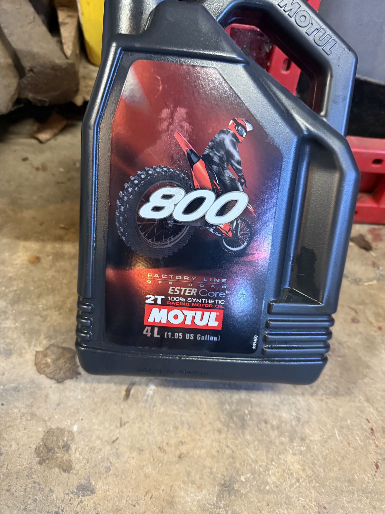

Oil is Motul 8000 2T synth.

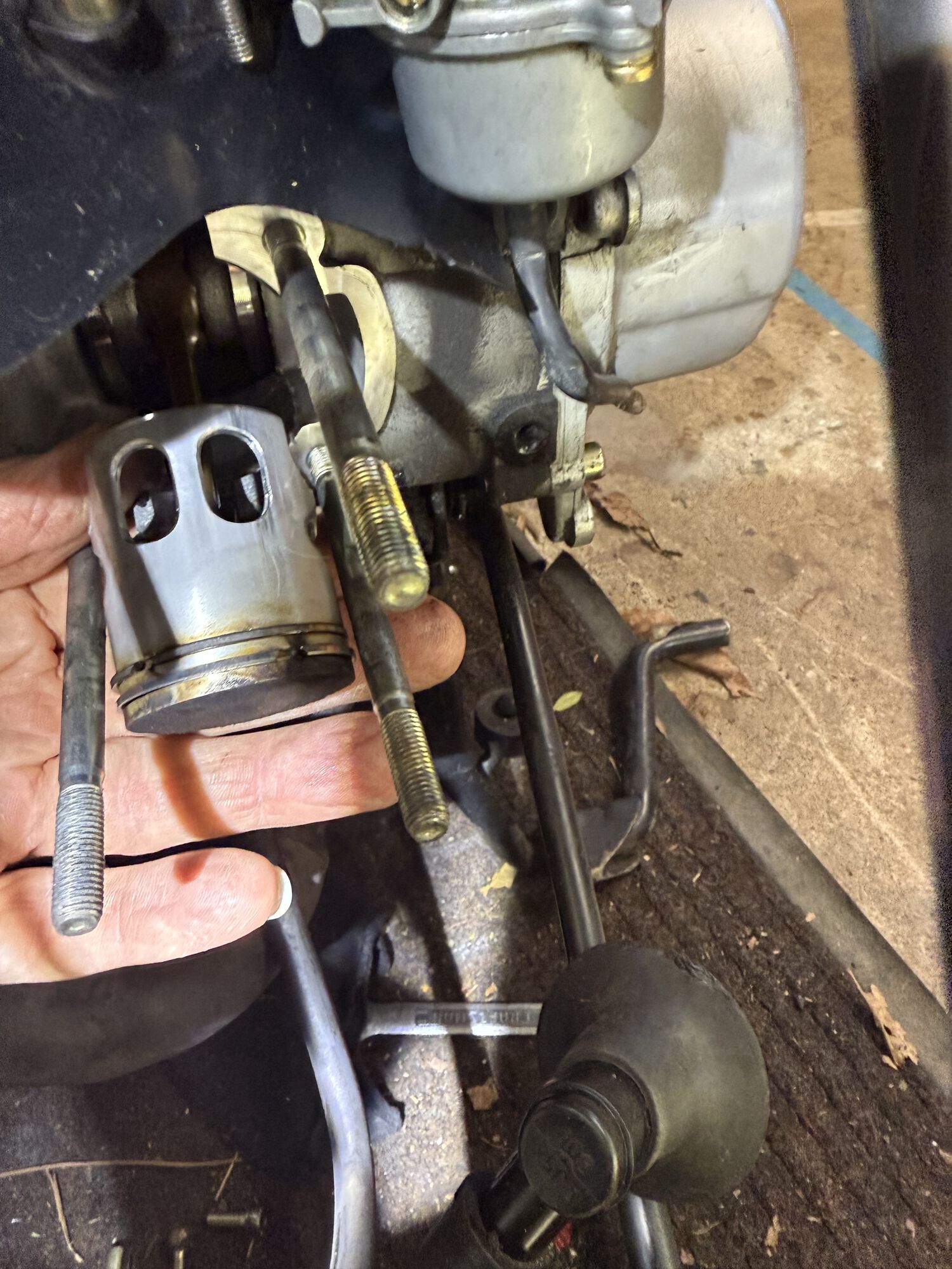

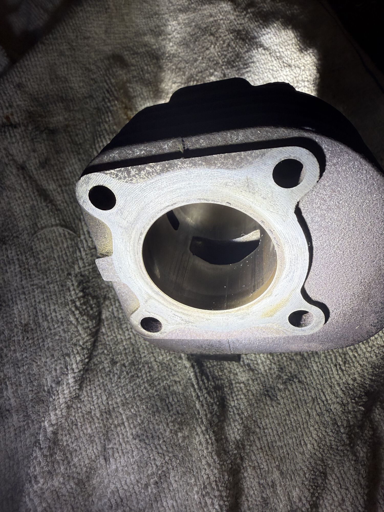

While i reassemble and do compression check, as advised, here are some pics. The worm gear feels complete and it does turn.
And, i'm not against simply replacing the bits, i don't want to have overlooked something. And if i can get the thing to rip without requiring more upgrades, i'm good with that. But more power can require beefing up other parts. Been there with a big 4 cyl Suzuki GS1100.
This whole thing began when it seemed to lose most of it's power one eve so i assumed lack of oil in the mix. But it never seized.
I'm going to remove and bench-test the starter again also. Something down there makes a crunchy noise when i press starter button. The starter spins though.
Thanks folks!

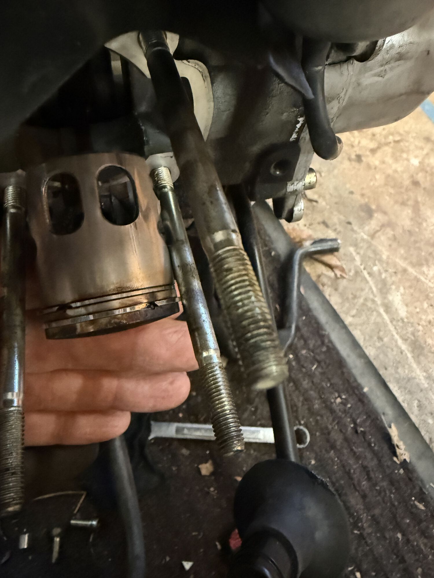

Piston #1
Piston #1
Piston #2
Piston #2

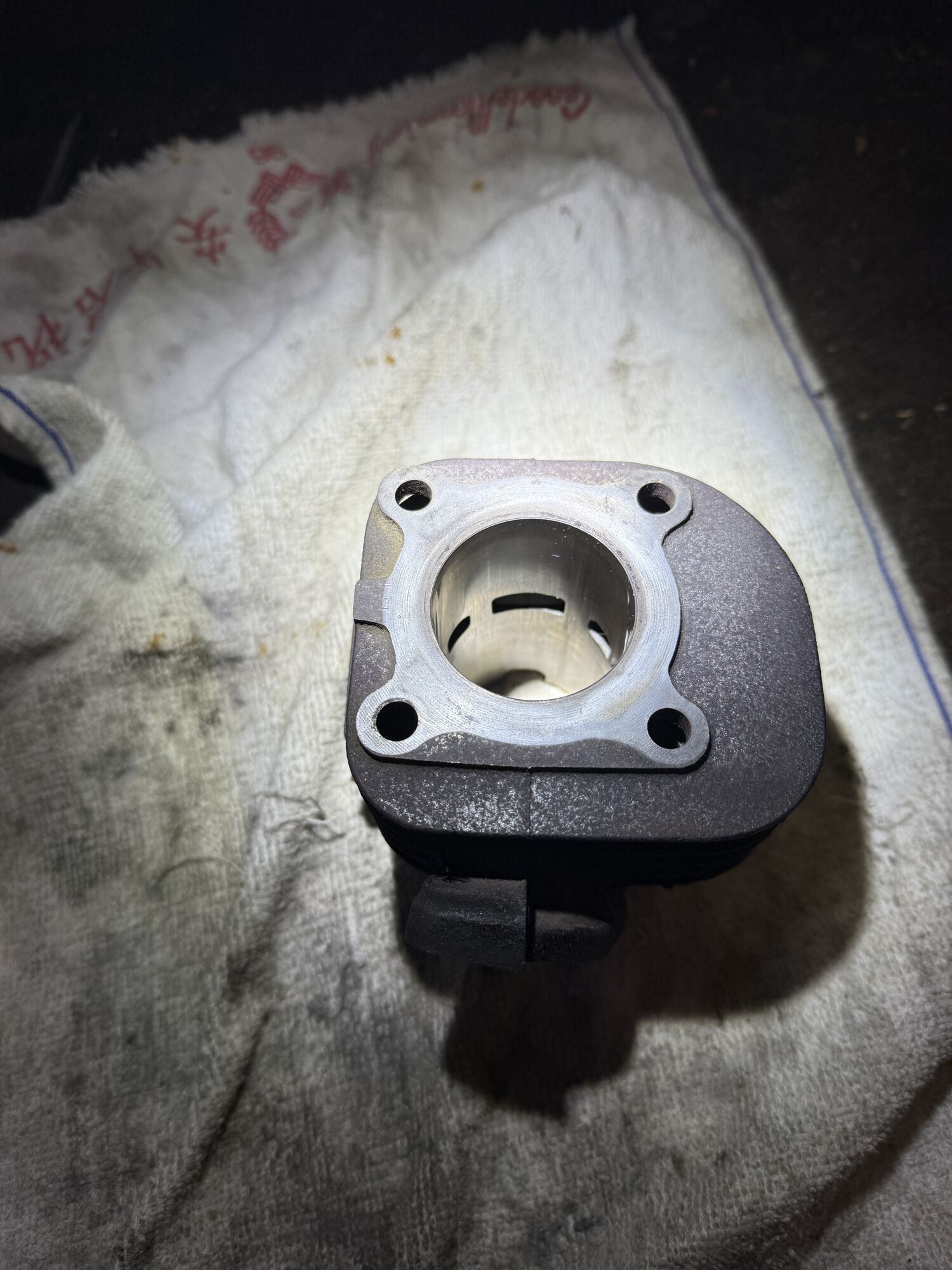

Cylinder 1
Cylinder 1
Cylinder #2
Cylinder #2

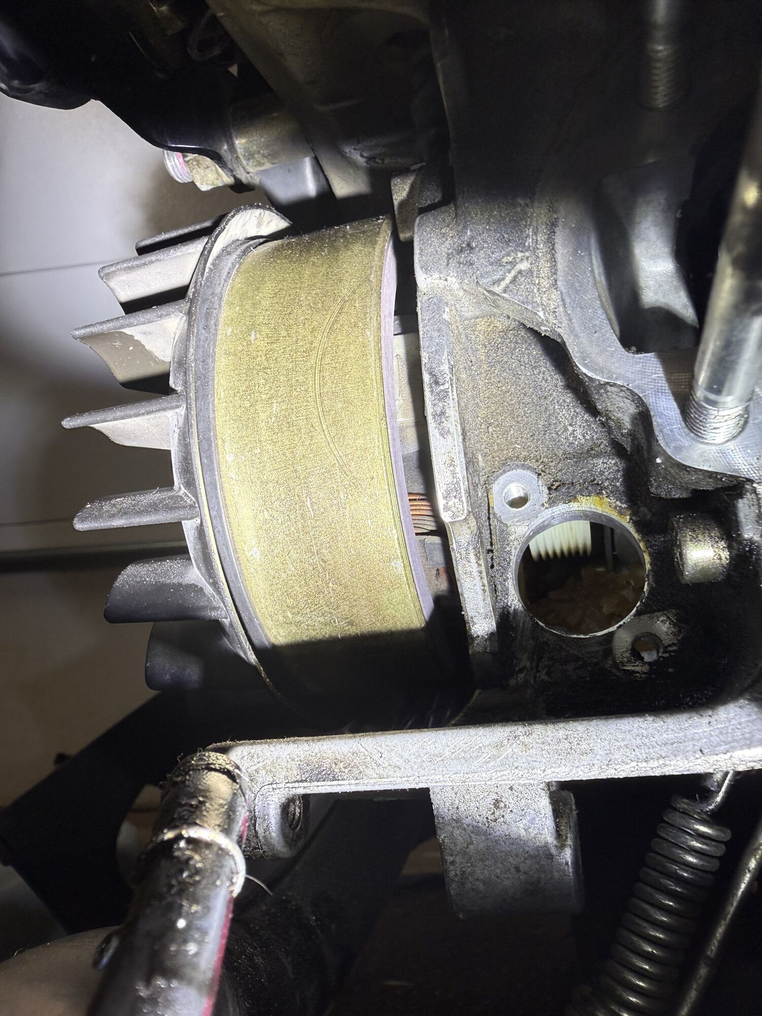

Barely visible plastic gear

Cylinder looks decent. Seat each ring in the bore individually. Push it down the bore about an inch with the piston crown and then back up to within 1/4" of the top of the bore measure the ring gaps and share your findings.
Motul 800 is premix only; it's not meant for autolube. You can run 710 and it's more than adequate for this engine. Heck, my buddy swears by Honda GN2 in his modded Zuma and it just plumb works.
Technical Data Sheet for Motul 800

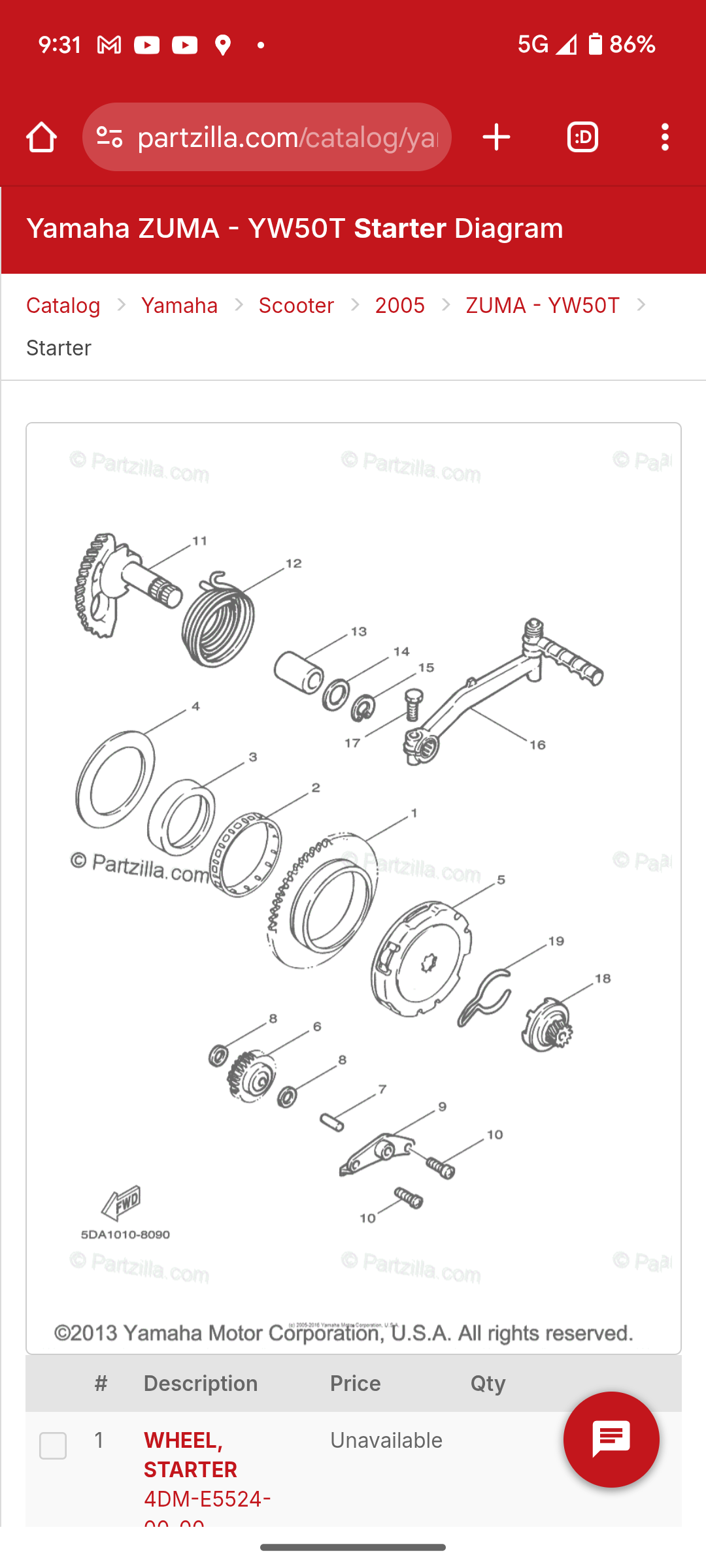

Crunchy noise could be the starter gear bearing. Pull the variator. Behind it, there's a starting gear with a roller bearing inside it that is lubed with lithium grease. When you pull the gear, there's a one-way clutch that fits on top of the gear and is splined to the crank. Pull the gear off, leaving the clutch on it. If you pull the clutch, the three rollers, spring covers and springs will shoot off someplace. If you want to pull it apart to clean the belt dust out, place the gear and clutch in a gallon-size Ziploc before separating them. If you lose parts, Partzilla still sells everything but the starter gear. See the attached image
Part #s 1-5 make up the starting clutch assembly. Clean everything religously and lube the needle bearing thoroughly before reassembling.
1". ——- .25" +/- .0005
Top end gap: .007. .006
Bot end gap: .007. .006
I ordered the 710. I guess the 800 I'm using is too thick? I use it in a pre-mix 40:1 Motron-Minarelli V1.

Ring gaps look to be within standards. I'd have trouble blaming the piston/rings at this point. I'd be wondering if the starter clutch is buggered and the scoot is down on power because it's dragging the starter motor along when running.

az_slynch no scooter work yet. You know how life (and in VA, weather) goes. We had a nice day, but i took a couple other bikes out for a spin! Including this Motron. (Yes, i know. These are not Modern Vespas, but I do have a GTS250!)
The proper injected oil (Motul 710) arrived today. its much thinner and gravity-feeds through the pump bleed hole.
I've pre-mixed, in the past… had a Suzuki RM125 that screamed..but not dealt with an injection system.
The Motron Minarelli V1 is a 40:1, pre-mix.

Essentially, it just lost power one evening. I can't associate it with anything i had 'touched' immediately prior, except the wrong kind of 2T oil for the injector.
Right now, the carb is soaking, so I'll unbolt the manifold and check reeds at same time.
Thanks for the tip.
I'm over-documenting, but as it was pointed out, maybe the details will help another ET2 or any 2T rider.

Can i borrow a towel? I throwing it into the ring.
Removed and cleaned everything from case up.. i see nothing awry.
So after many hours spent, and lots learned, i'm done debugging.
az_slynch suggested a new Athena top.
I think I'm going that route. I got it to start and idle and rev up and down and idle.. then, after a few minutes, it dies and resists starting again.
I can't find anything i can 'fix' and i actually want it to be usable again.
I can only guess, Sean and BajaRob, that running with the thicker oil not flowing so well, the cylinder has been ruined enough.
Next time I remove the cylinder, piston, it will be to replace it with fresh.

I know it's been a while.. and y'all are anxiously waiting for results.
Ok.. first, i took a 2 week west coast tour on a hired BMW. We flew into LA.. and, after stopping at the Quail in Carmel, we continied up to Portland.
Back to the Tiny 2T. Verbosity for future readers with similar issues…and because, well, I'm me.
I did replace the barrel and piston with the recommended Athena piece.
While R/R and thoroughly cleaning the carb, the little brass tip on the e-choke broke off. However, i merely installed it as is. Its only an issue on startup…bit it does start after some cranking.
I've located an aftermarket replacement, but in the meantime, it's now running again.
I replaced the reeds also and thoroughly inspected the manifold for cracks.
The air-mix screw is out about 1.5 turns and it seems ok.
I'm not reassembling the entire body until after i receive the new e-choke. It's a 30 minute ordeal that is annoying.
Also, it takes a minute or so of cranking to start and i dont want to wear out the little starter or those associated parts.
For now, though..i'm declaring a success.
What was the issue!? Im not 100% certain.
I'm only guessing it was the wrong oil that was too thick for the injector?
Or it remained sticky in the carb.. slowing down atomization.. and burn?
Thanks for your input!

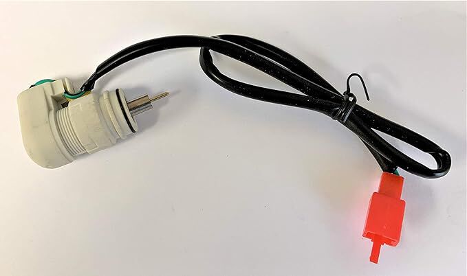

More..
I received a new, replacement bystarter (proper term for the e-choke), plugged it in.. bingo!
I'll wait a day or so, do a couple more cold-starts before i put the body back on.
I found a part supplier in Houston that is knowledgeable and priced reasonably.
While others may 'fit', i'm confident there is a functional difference between the 2T and 4T applications.
The one i plugged in worked.
Also, they do require voltage in order to work. But it needs AC. The engine needs to run to generate enough current to heat the gizmo inside.
az_slynch recommended a Dellorto carb, i cant find one. The Gurtner 12y is doing it's thing for now.
2T Bystarter/e-choke

I dispute that it needs AC. 12V AC RMS from the regulator (which is roughly what should be supplied to the auto-choke - where did 'bystarter' appear from?) is exactly the same power provider into a resistive load as 12V DC.

Ok… i will relent and allow that what i read was inaccurate. Y'all be smarter than i, sometimes.🤣
But without engine running, the wires show no voltage.
Where did i acquire the part?
From a place called Global Motor Imports, in Houston, through Bezos.
Much internetting suggests that the name for the e-choke, is bystarter..dunno why.
And it has same affect as a choke, but works in reverse. It changes the air-fuel mix, for sure though.
It allows air to flow across a small port, sucking more fuel, until it warms up. Then the needle drops and blocks that extra port.
This guy explains it pretty well. Images missing though.
https://www.modernbuddy.com/forum/viewtopic.php?t=27646
Edit: spelling and added a link

Air screw is 1.5 out, stock Gurner 12y, Athena aluminum cylinder and head with their piston, still 49cc.
The oil pump seems to be fine. The issue, i believe, was i correct oil.
I'm now using Motul 710, getting the factory-spec drip-rate a d i ise e-free, 89 gas.
