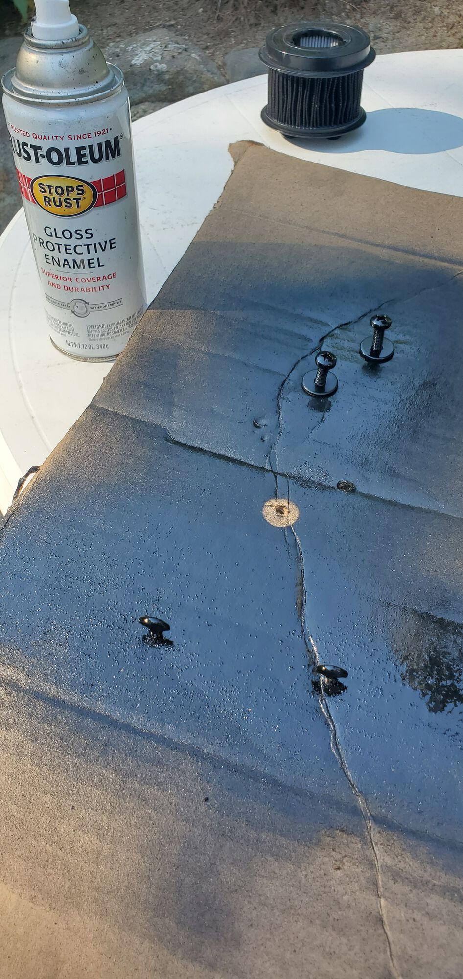

Hello gentlemen
Not sure if I have the correct answer 🤔 but this is what I used for replacing my old worn-out windshield hardware
Purchased at home
Home Depot.
⚠️ Last edited by semprespqr on UTC; edited 1 time

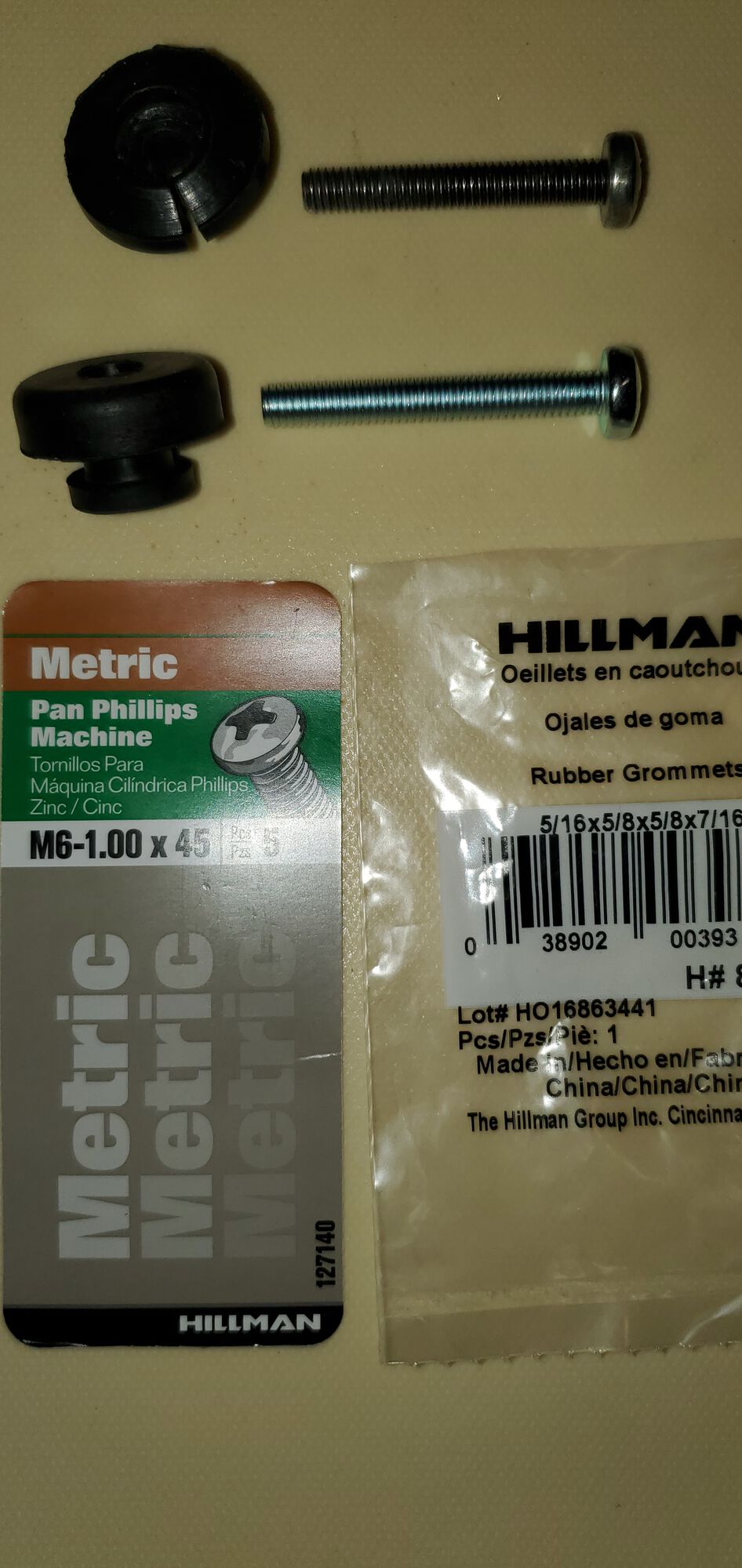

Hello gentlemen
Not sure if this help.... 🤔 but this is what I used for replacing my old worn-out windshield hardware .
Purchased at Home Depot.
Better then the original screws and new rubber pieces.
Ps: I did paint the pan machine screw to match the others:P
