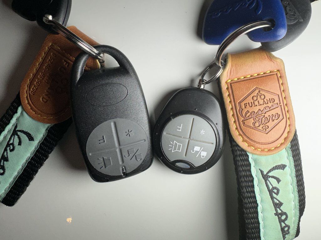

The remote control is available individually, with a cable set and with an alarm system (each costs more or less, of course).
I know that there are two different remote controls (NOTE: the RC only is called "for alarm system"!):
a black one with gray buttons, rather roundish: SKU: 1D001288
and a black one with black buttons, more elongated/angular, slightly larger: SKU: 1D002052
Price is around 20-30€.
According to a dealer, Vespa installs these alternately, depending on what is available at the time.
Attention: These are SKUs for European Vehicles. Maybe there a different SKUs for non-European vehicles due to different radio frequencies!

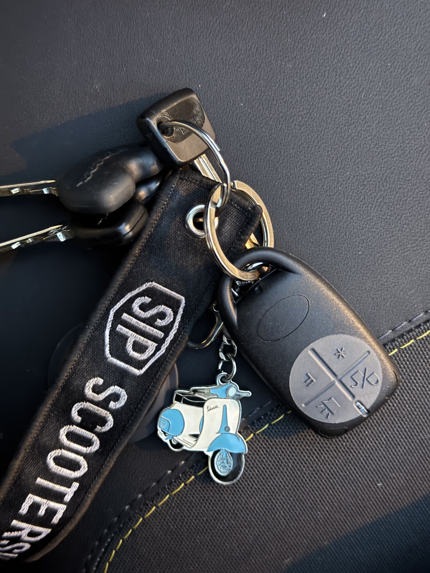

Hey there!
Unfortunately my struggle continues.. Facepalm emoticon My remote controller has arrived today and i was very excited to pair it with the scooter. Followed the above steps and wait for it.. nothing happened.. Facepalm emoticon
Tried to press the buttons twice and for a longer period as in Robot's video but none of them were successful.
I am a bit clueless. Do you have any idea what could be wrong?

According to the workshop manual, the buttons with the lock (1) and the blinker (3) should be pressed together twice within 5 seconds of reconnecting the battery.
You have not received any visual confirmation from the indicators? Try again, be fast, better to do the job with two people…
Perhaps my dealer's statement that the remote controls only differ in shape is not correct... Can you find out which remote control came with the vehicle?
For me it was like this:
Vespa GTS with blue key and the small round remote control and the other GTS with black key and the somewhat angular remote control. I'm not sure whether this constitutes a rule.

The one with the Blue key and round Remote Control is 2019 / the other with the black key is 2022.
The workshop manual describes that several remote controls can be programmed (up to four), so you must be able to buy them somewhere...
Why don't you go to your dealer and give him the two order numbers/SKUs of the two remote controls? Tell him to find the right one...

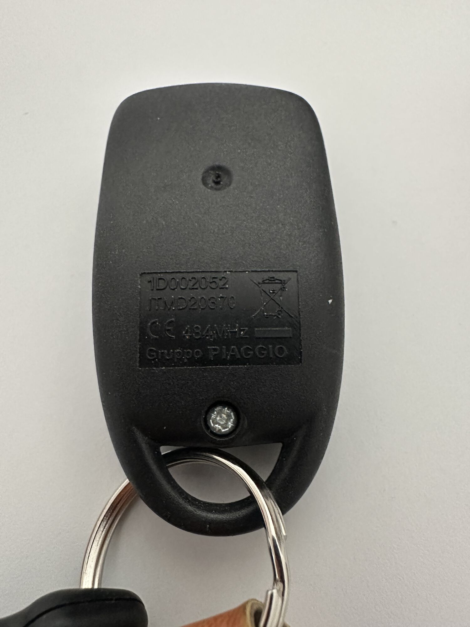

I looked again on my original remote control, which I received with the vehicle. It has the SKU 1D002052 (Even if the article is labeled "for alarm system", which I do not have). Thats exactly the one you ordered…
I see the following approaches:
- Pairing procedure not carried out correctly.
- Defect in the remote control ordered.
- It makes a difference whether the remote control is round or square.
- I don't like to believe that your dealer is right, otherwise why is the pairing procedure in the workshop manual, the SKUs are identical, etc.?

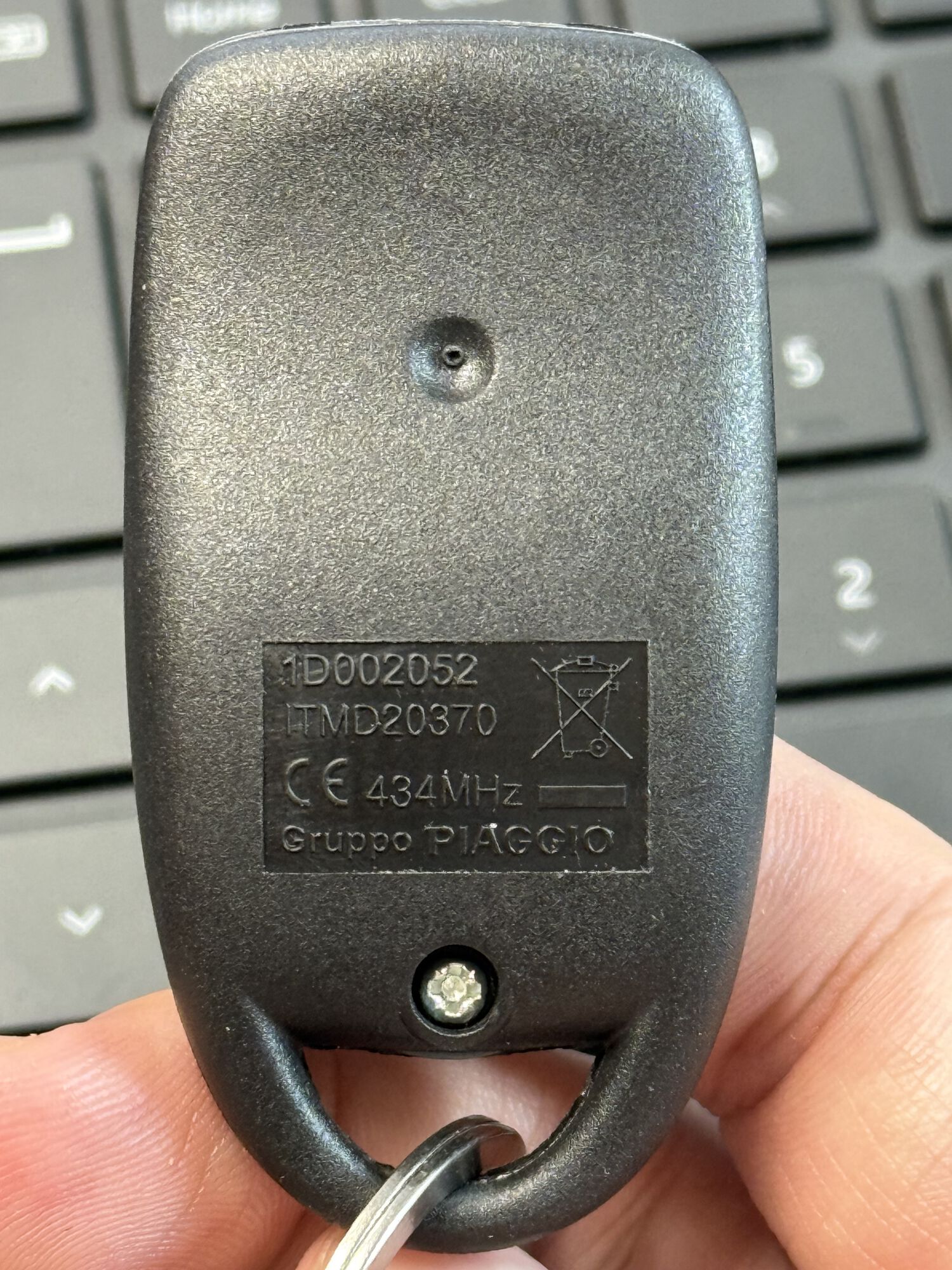

GermanGTSDriver For comparison here's mine (Australian 2019 SuperTech) which has a different MHz but same part number.
I'm wondering if the module in the bike has the MHz written on it.
The frequency looks the same to me. 434 MHz.
Posts: 8433
Posts: 8433
GermanGTSDriver's looks liki 484 to me but maybe that's my eyes
It is 434 but i had to zoom in as well. Or if not i have the australian one as well. ROFL emoticon

RMark wrote:
Another thought.. I wonder if that means anything if the user manual i got with the scooter shows a round or rectangular remote. 🤔
I only know operating instructions with the round remote control. Unfortunately, I don't have the original printed operating instructions for my GTS 300 delivered with the square remote control.

RMark wrote:
Unfortunately I have not received any confirmation by pressing the lock and the blinker buttons. I tried it several times though.
Similar to the instructions posted above by GermanGTSDriver , here is the video
If your VIN is ZAPMD3101, then this is the full unit you need.
https://www.sip-scootershop.com/en/product/bikefinder-piaggio-for-vespa-gts-gts-super-ie-125-300ccm-4t-lc-16_PI012235?usrc=remote
If your GTS 300 is a 2022 model, then the remote is different.
https://www.ebay.it/itm/365045270810
Instructions are on page 6 of this document (a bit different than the video)
https://www.sip-scootershop.com/download/article/1/pdf/f3e864a8-d51a-4be3-86f7-6dace815d06d/Manual+PI002554.pdf?contentType=application-pdf

Video is great!
But:
The reference to the remote control and receiver set is pointless. We are discussing the fact that it should also work with the individual remote control, as shown in the video.
The reference to the keyless keyfob from MY23 (first vehicles from October 2022) is also irrelevant, it's about a 2021 without keyless.
The instructions are for programming in conjunction with the optional alarm system, which uses the same remote control (see also the video). So this only works if the alarm system is installed.

I am very grateful for all the help I get from you. GermanGTSDriver is right we are trying to get a solution to make it work without the receiver module being replaced.
An additional info, today the dealer has confirmed that the remote ordered is indeed compatible with my Vespa so I am still a bit clueless what could be the problem. Also I am trying to reach out to the former owner if he has any additional info which may help solve the mystery.
I've been fine without the remote control for the past two years, but now I just want to get to the bottom of it. I will not rest until we somehow pair this remote control with the scooter.
my manual has the round remote yet my remote is rectangular

I don't know if you got the manual or not, here is one for the 4 button switch
@germangtsdriver avatar
Vespa GTS 300
Posts: 1827
Location: Germany
Vespa GTS 300
Posts: 1827
Location: Germany
The instructions for the alarm system were already linked above. But the Topic opener does not have an alarm system.
The remote control is identical (same SKU) whether with or without alarm system, the question here is whether a replacement remote control can be programmed (without replacing the receiver).
