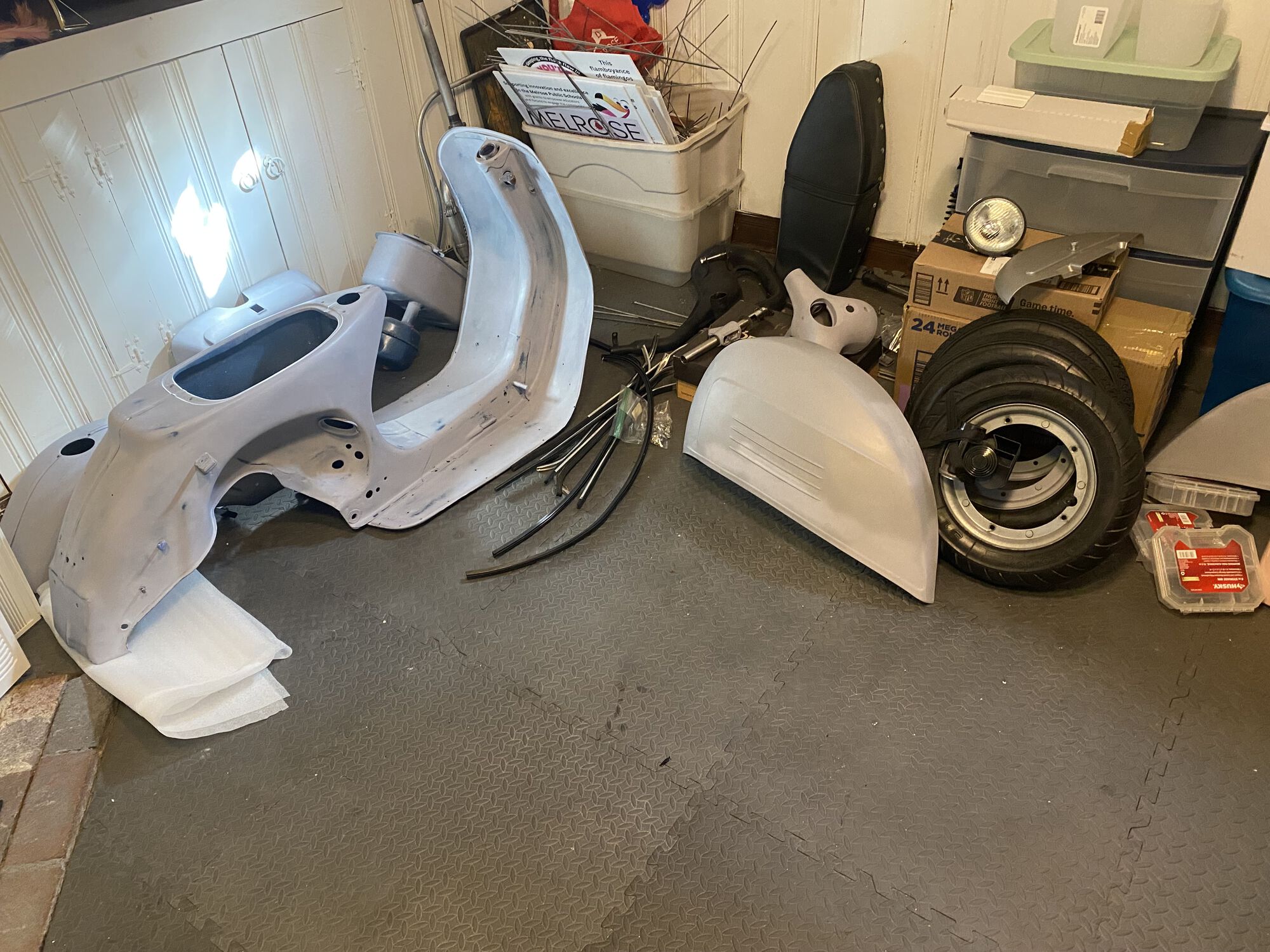

Not much to look at at the moment. Total resto underway.
If that's the bike it's going in, I'd say you have some time to figure this out. Razz emoticon
