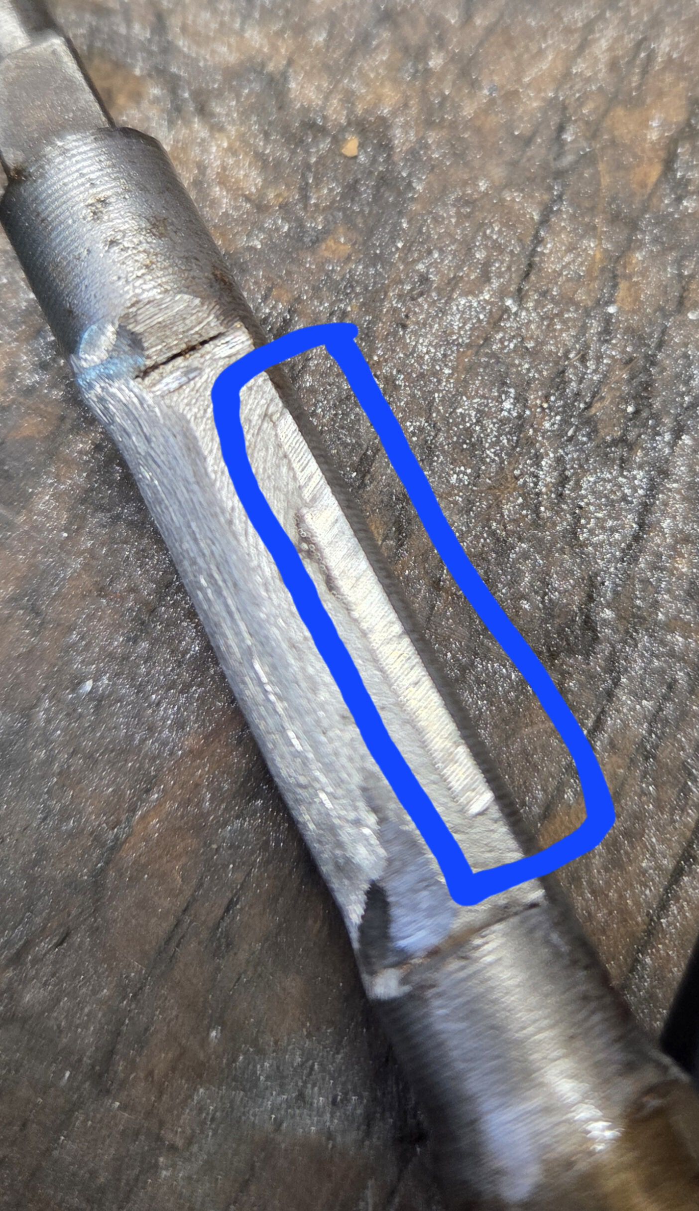

I've just reassembled it after removing the cable and the clutch and checking everything. It's now much lighter and seems to be working ok in the garden but a test ride at the weekend will confirm it. I didn't find much, the clutch cable outer was 2 1/2" too long, and the clutch release arm had been rubbing on the clutch.
Clutch rub in the blue box, the other side is where I'd already trimmed it before fitting.

the arm rubbing is a new one to me, but it could certainly produce the symptoms you were experiencing, I think.
Glad you maybe have it sorted. Let us know how the weekend test ride goes.

I found it odd that edge which was rubbing is the one that rotates away from the clutch when it's operated. I still haven't got my head around how it could give the symptoms I was getting but I couldn't find anything else wrong.

seems strange, I agree, but if everything else is better, it may be that you inadvertently fixed the problem when checking/cleaning everything else.
