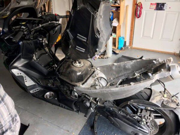

These use the same 30mm fuel pump that are in a lot of Yamahas. A tell tale sign is just as you describe. Problems when hot, works once cools off. That is until it quits working entirely. See if there is any chance your bike is under recall. Has to be done through a certified Vespa dealer. Good news, is you can access your fuel pump assembly in 15 minutes. You can buy a good quality aftermarket pump for under $20. It takes a little finagling to get the new pump into your old housing, but it is doable. At 24k, you should be on your 2nd valve adjustment. Same fuel pump as in this Yamaha Tmax. Darn near 5 hours to replace it in this bike.
Ah, the old "TMAX Fever". Got that merit badge. Did it on a Morph too. Picked up a spare pump assembly for my Maj in case it ever decided to get fussy.
Biggest trick seems to be popping the plastic bits apart while hoping they're not so embrittled that they shatter.
Totally worth swapping the pump itself versus buying a new assembly.
