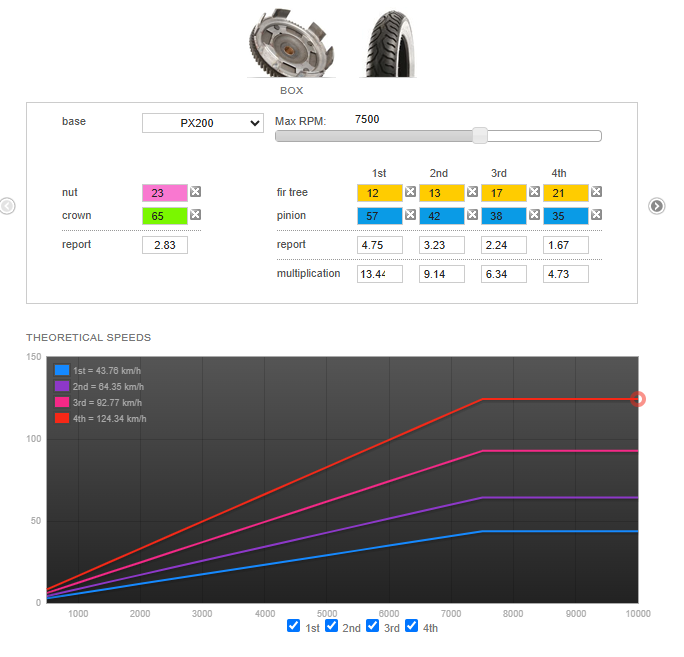

So just building another 232 as per my usual setup...
232 top end
57mm quattrini crank
malossi 30mm phbh carb and x360 intake
SIP 3.0
probably do a static vape this time.

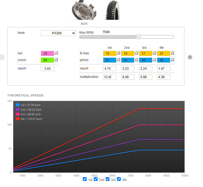

I normally just change from 23/65 to a 24/65 but thinking maybe different gearing for this one... maybe a 24/63. Do we/you think that's a good option? 232 will pull that? What about 24/62?
24/65
24/65
24/63
24/63

I know it can pull the 24/65 gearing as that's what I've done in about 8 -9 builds that I've completed over the years. I have a feeling 24/62 would be too far, that's why I'm thinking 24/63 + maybe short 4th?

Like I said, I'm not worried that the motor can't do the job . It's more a matter of "how low can you go?" and still be able to maintain speed in 4th gear.
As to the crank...a 60 mm crank will fit standard cases without machining. It's only when you go to the 62mm+ that you have to mill anything.
As to the gearing, 24/62 w/ 36t 4th gives you 83 MPH at 7,500 RPM's and 39 MPH at 3,500 RPM's.
I think that'll work just fine. I still think you'd be better off with a variable ignition, especially with the longer gearing, but I don't think it's necessary by any means. Even if you're not lugging in 4th at 40 MPH, that's still only 5,000 RPM's in 3rd, so I see no reason it wouldn't work.
Hell, you could do it in 2nd if it came to that and only be at 7K.
Final question I'd ask myself is "what speed do I intend to cruise at, and at what sort of inclines?" and target 4th accordingly.
Like...I went to a very short 4th in my Smallie not because I needed to, but because I didn't want it to go 95 MPH. (The fact that it'll race up to 85 like nobody's business is just an added bonus)

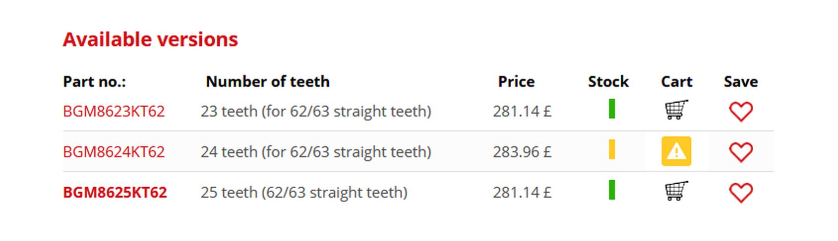

I would simply start with a 62 or 63 tooth BGM primary gear, and buy 1 or 2 extra clutch gears. No decision now, swap your clutch gear and then work out what's best.
https://www.scooter-center.com/en/clutch-incl.-primary-drive-set-bgm-pro-superstrong-2.0-cr80-ultralube-sport-alu-type-cosa2/fl-primary-gear-bgm-pro-62-tooth-straight-vespa-px80-px125-px150-px200-cosa-t5-sprint150-veloce-rally-gtr-ts125-super150-vbc-25/62-tooth-bgm8625kt62?number=BGM8625KT62
Known good - 24/65 = 2.70
23/63 = 2.73
24/63 = 2.625
25/63 = 2.52
23/62 = 2.69
24/62 = 2.58
25/62 = 2.48

My Pinasco 225 has the Malossi 24/63 setup and a 36T 4th gear. It pulls like a train, and most of the time with a pillion, so yours will have no problem.

Yeah, this is what I'm thinking, the 36T will pull 3rd and 4th together.
