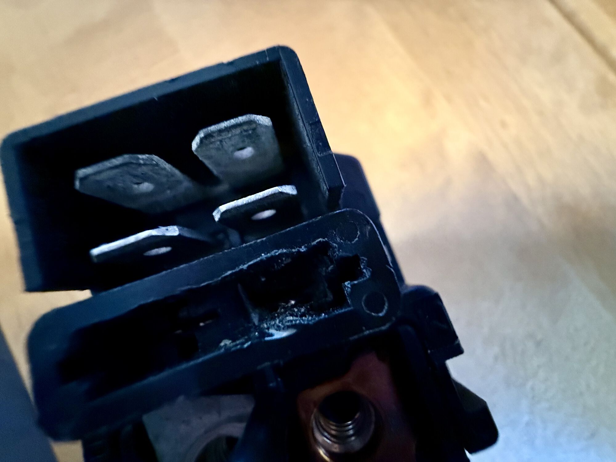

Unfortunately the old fuse broke apart trying to take it out. I had to remove the whole unit by removing the allen bolts holding the two wires.
There looks like some of the green plastic from the old fuse is still inside the hole. If I dig in too much trying to clear it out I risk doing more damage to the unit and the new fuse may never go in properly.
Just wondering if it is worth changing the unit. Assuming I can get one in the UK, what am I looking for, the only identifying mark on it says... MR5 and below that 3 and to the side of that... 2F 01

That 'hidden fuse' has been a scourge since the Fuoco/MP3 came out. ( Another Fuoco hidden fuse story... )
It's situated in the bike such that it can easily get corroded terminals, which heat up with the charging current, eventually becoming either so corroded that no meaningful charging takes place or the whole fuse melts and becomes an insulating blob.
I'd replace the whole starter relay, and ensure the new fuse has plenty of dielectric grease in and around it to ward off any future corrosion.
If it's still not charging, the regulator may be faulty - but I strongly bet that's it's AOK and the charging system works just fine with the new relay.
