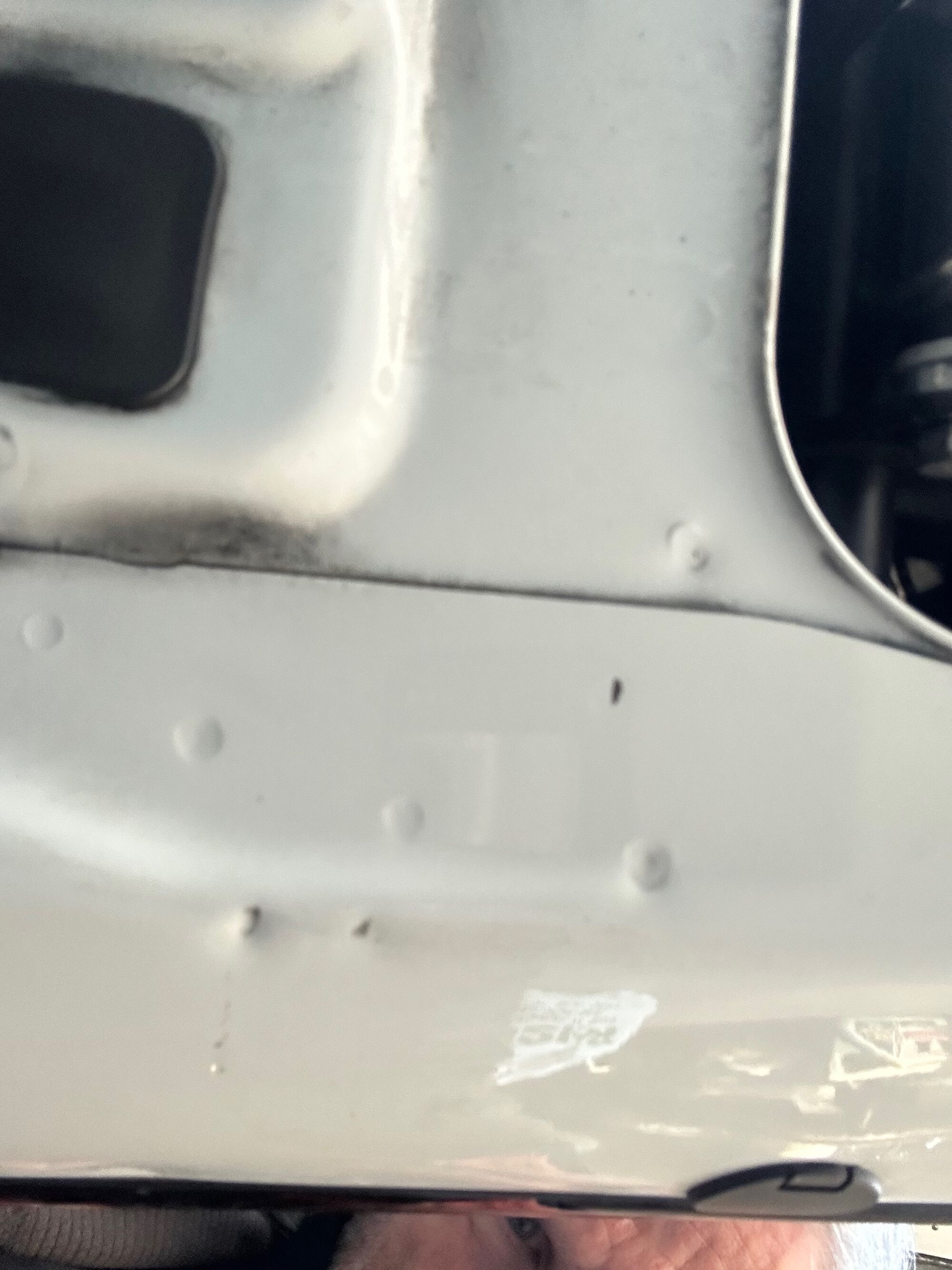

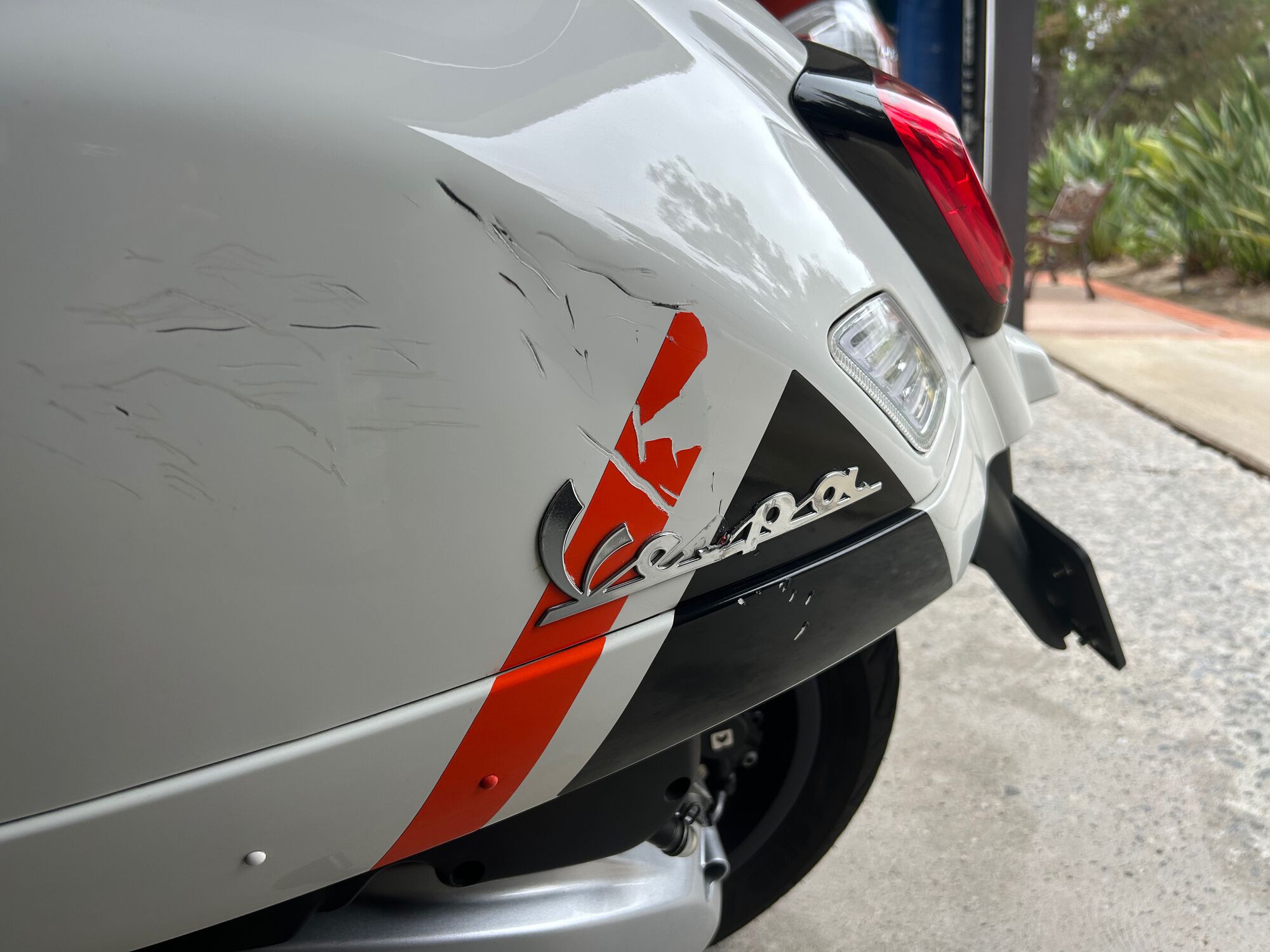

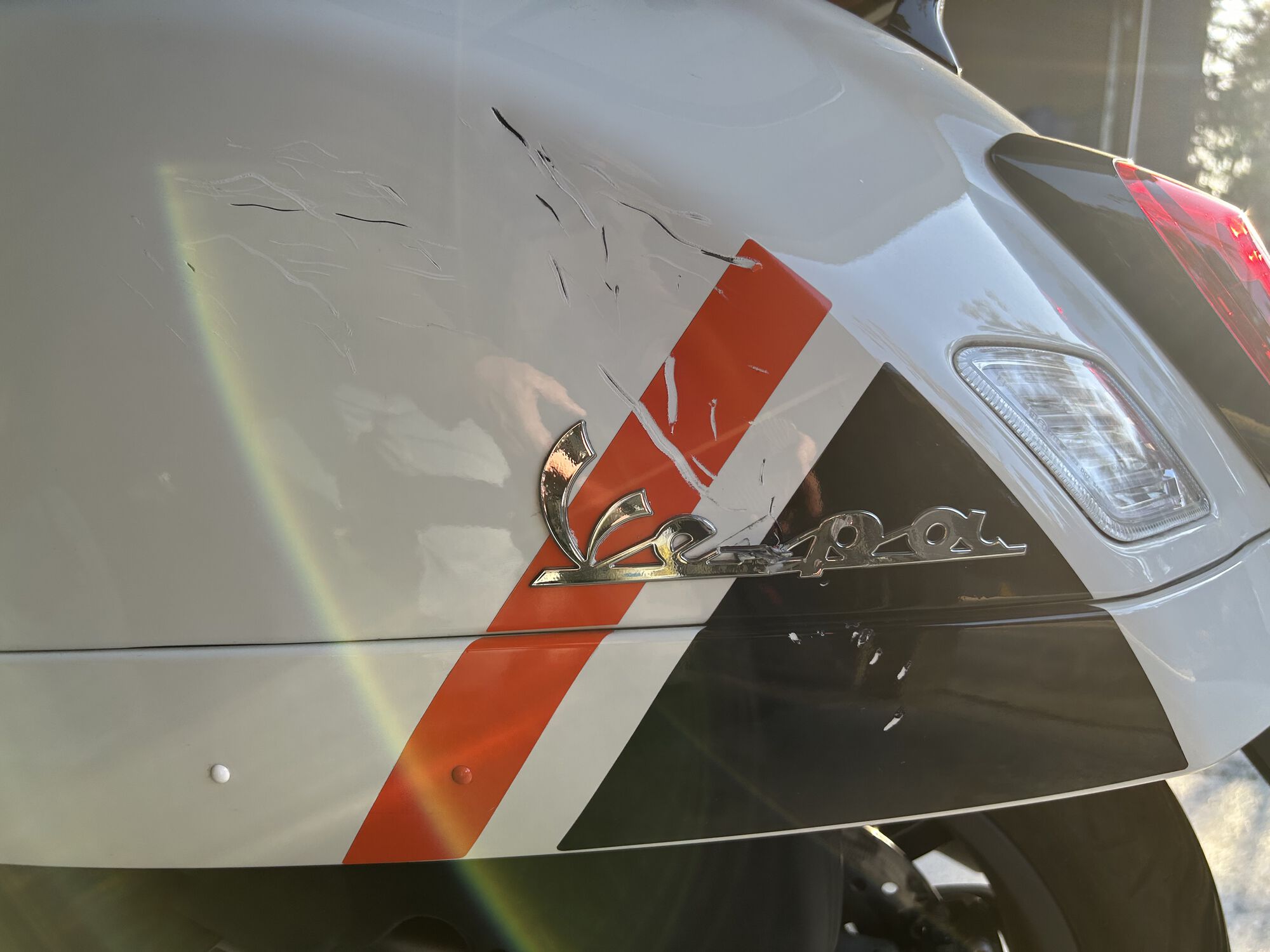

First, this is my 23 GTS, the sidestand is NOT the self retracting stand of earlier bikes. I went to visit a friend, the house is on a hill. Parking there is always tricky, backing into the drive way is tough, riding on to the flat part then backing out works best.
As I backed out, I hit the rain gutter nest to the curb and the bike would not roll back, and being a hill, almost impossible to roll forward, even with power. I put the side stand down, the plan was to get off the bike, roll it forwards a few inches, then back and into the street. Easy peasy.
Except that the hill made the bike feel really top heavy really quickly, and the bike rolled over on it's side. I was able to upright it, start it, and ride away, as I didn't want to assess damages on the uneven surfaces.

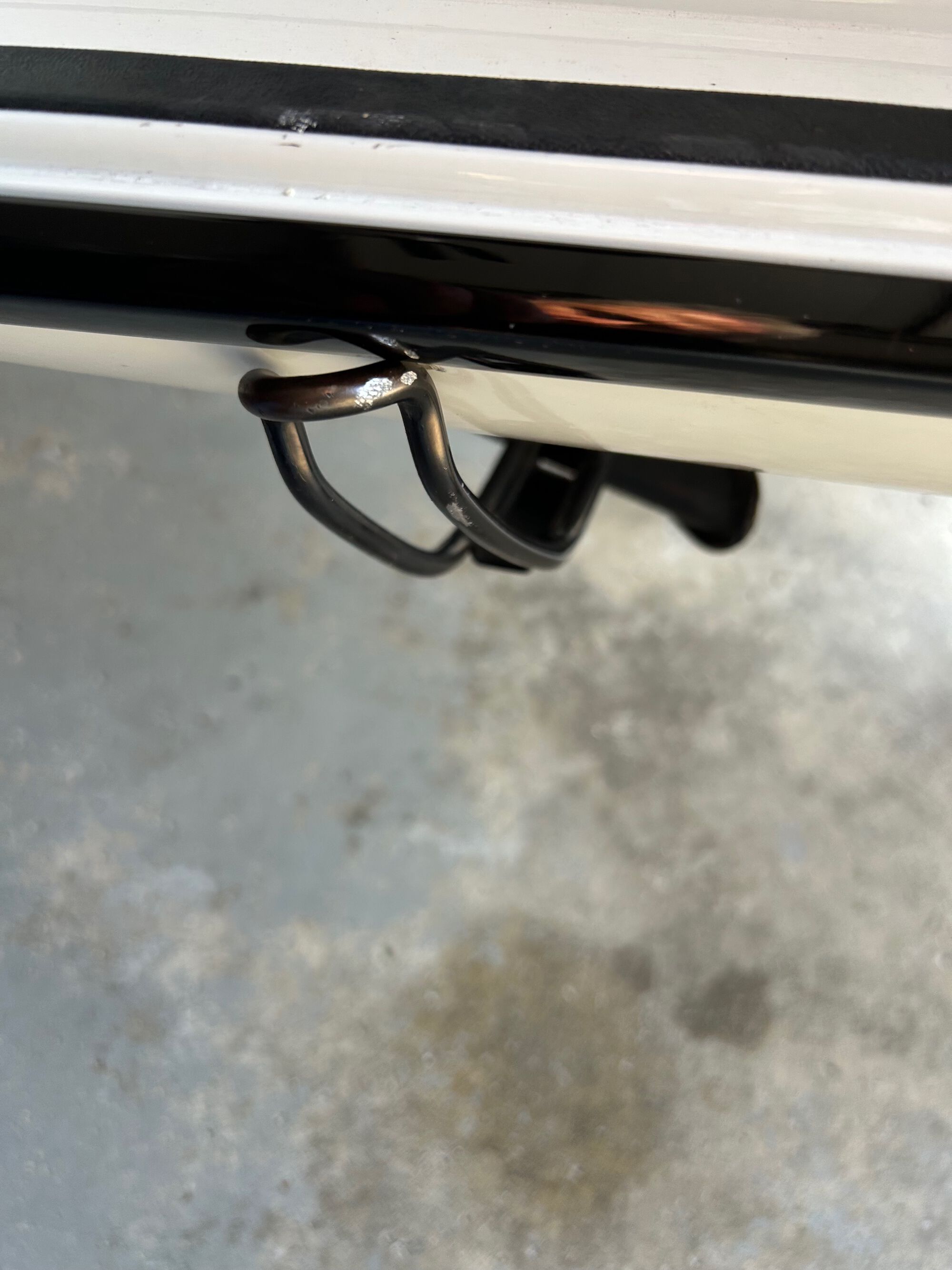

The side stand pushed up into the body, and it is over towards the mid line of the bike. There are several small dents in the bottom of the bike, and it's hard to tell if the bend is the stand, or the welded on mounting bracket is bent. Right now, the foot of the stand is almost too far to reach with my foot to put it down.

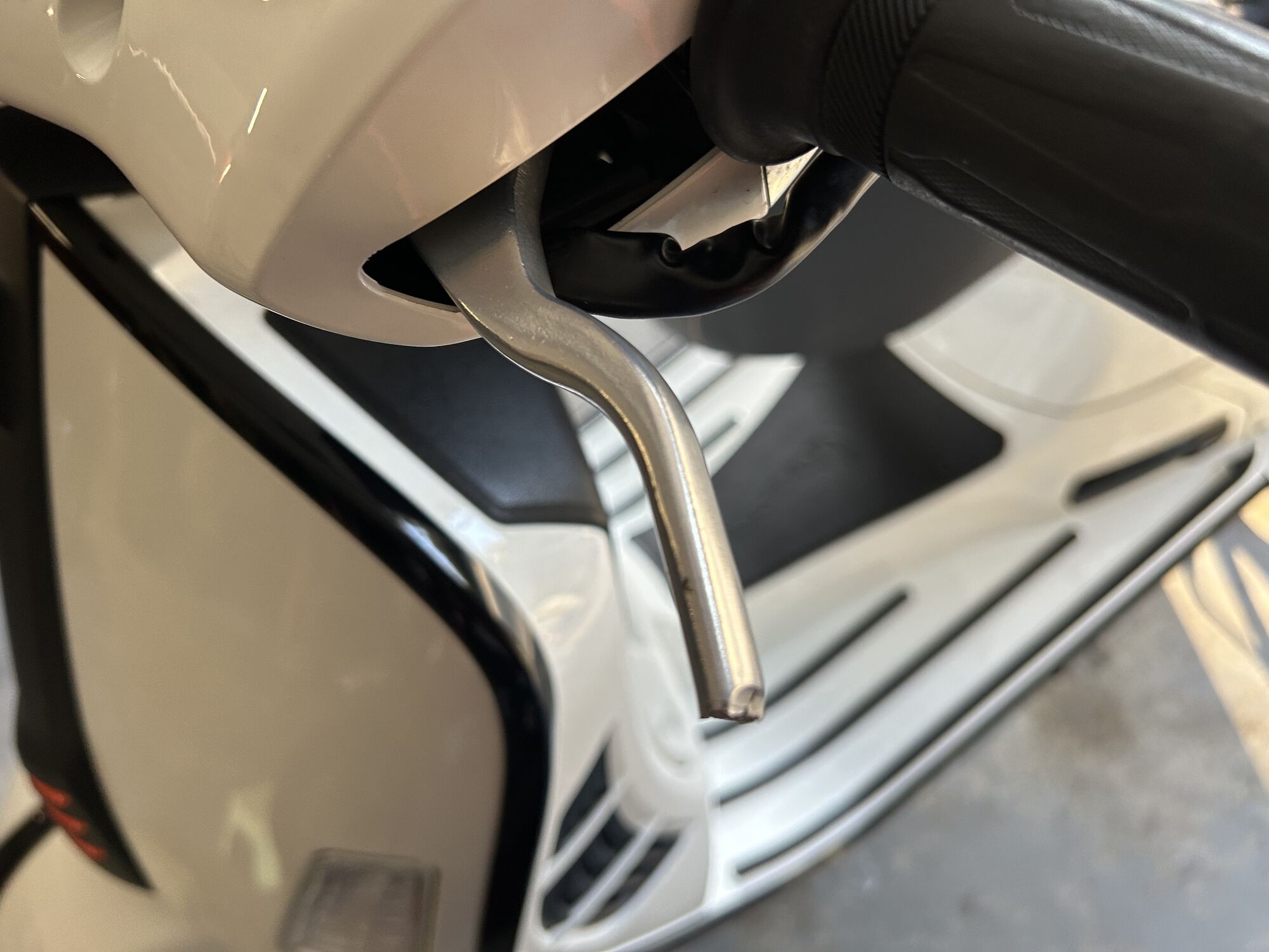

The left lever broke off, the mirror and side trim got scratched, and the left rear panel had some scrapes and a minor dent.
I'm not happy, but what can ya do? It's no longer a perfect specimen. Neither am I.

Stickers FTW.

I think I will peel the stickers and put on a rubber tank pad.

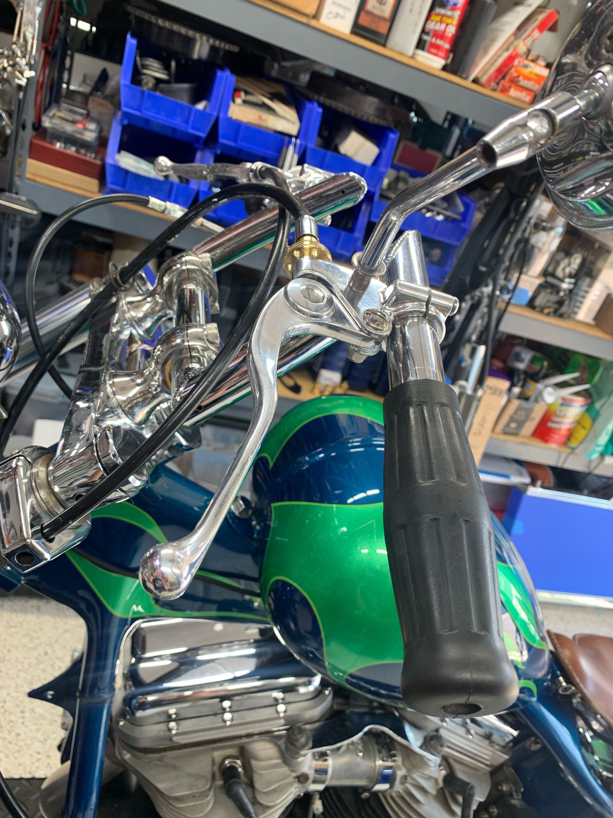

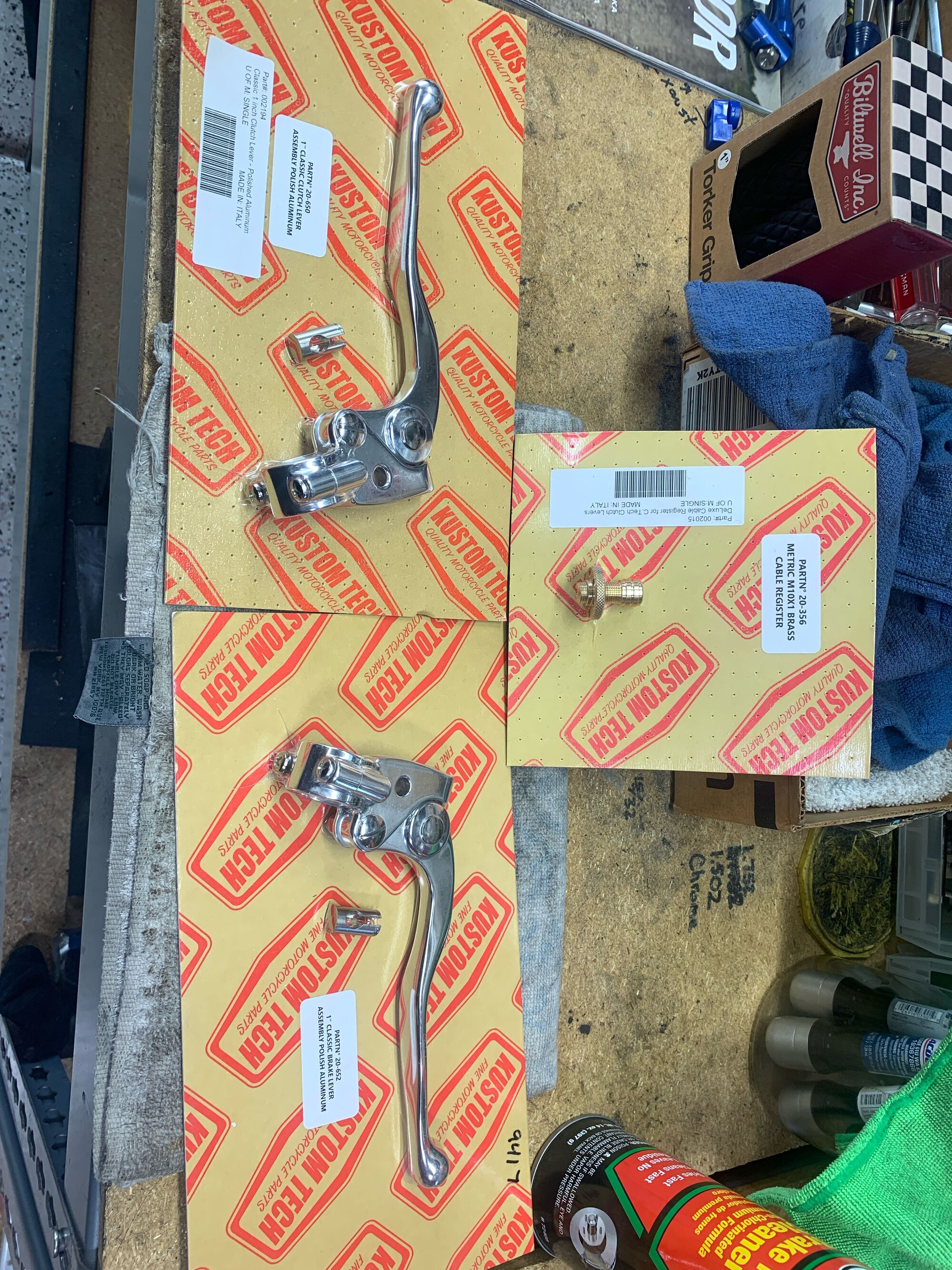

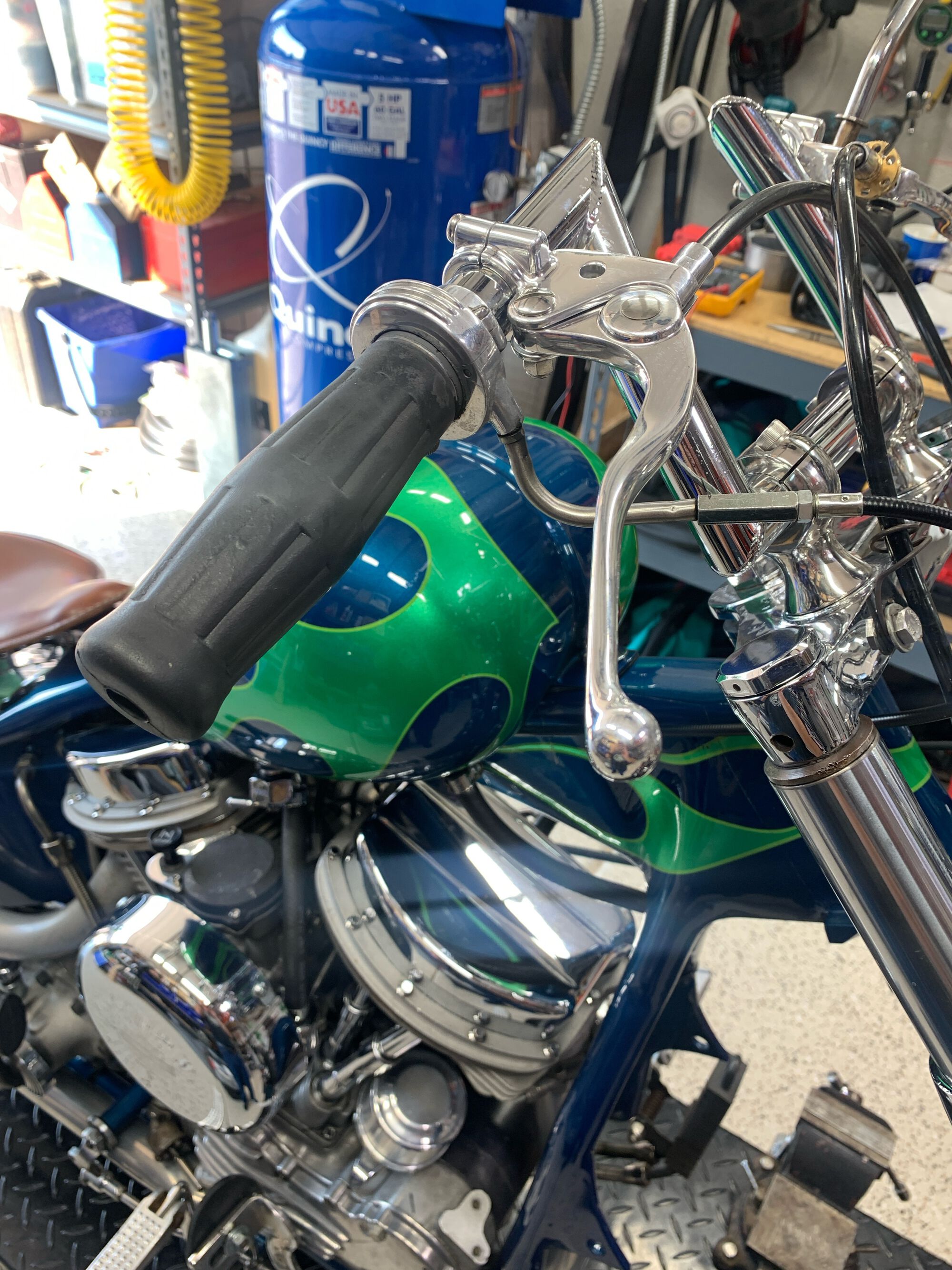

I agree! Using a high quality lever/perch is high on my list. I put these on my PTW last year. $400 was a bit painful, but you gotta pay to play.

There's a notch cut in the OE lever with the intention it breaks a portion off, rather than the entire lever breaking, in the unfortunate event of impacting pavement.
It's designed this way so that the scooter can still be ridden (assuming no serious damage/injury results) away from the incident.
Levers that snap because they're made with the melted-down remains of whatever came out of a dumpster the previous day then painted all pretty are not the same.

Mine broke at the notch and the lever was fully functional. I dropped my 2012 and it bent, it had no notch. Curved the brake lever and there was some binding at the perch.
Went to Scooterwest this am and Robot offered me a deal on a single silver notched lever, same as the one I broke. I felt as long as I have it open to replace one lever I might as well get a set of the black levers for the bike.
My side stand was bent and the bike leaned more, one option they gave me was to bend the stand back, but I opted for a new stand as I would be waiting for the stand to bend again.

PS crashbars would have saved the rear panel, for sure. Robot gave me the number of the paintless dent removal guy the shop uses.
That and a new decal and it will be fine.
Or just a decal. I'm in no rush to figure out what to do as there is no bare metal under the scratch.
Just good Italian primer.

I've had the hilariously curved levers and also the snapped off at the notch ones. File down the snapped end so it's smooth and won't wreck your gloves.
I always thought the snap notch was to stop it curling but is it actually to stop it busting your trapped fingers?

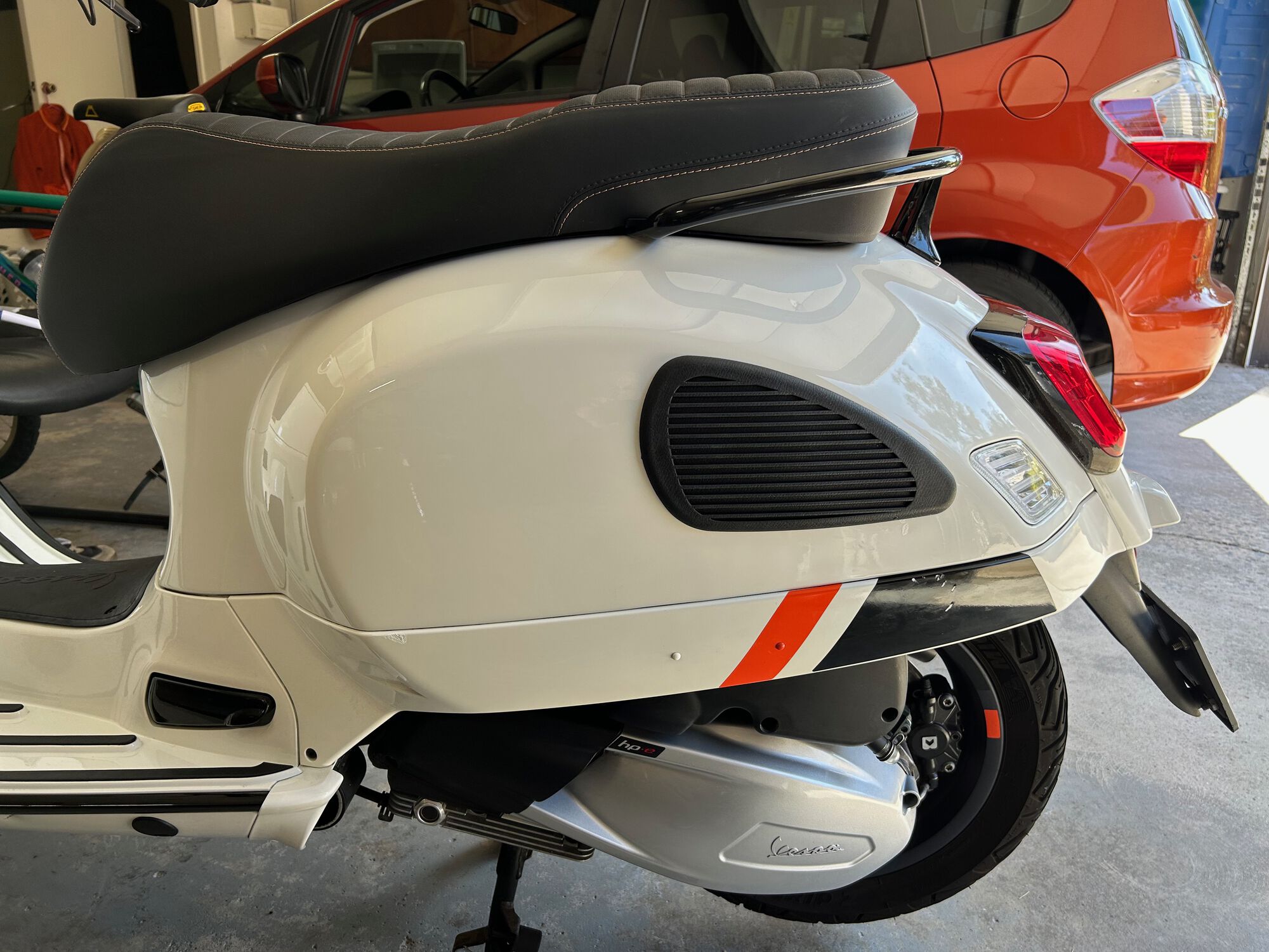

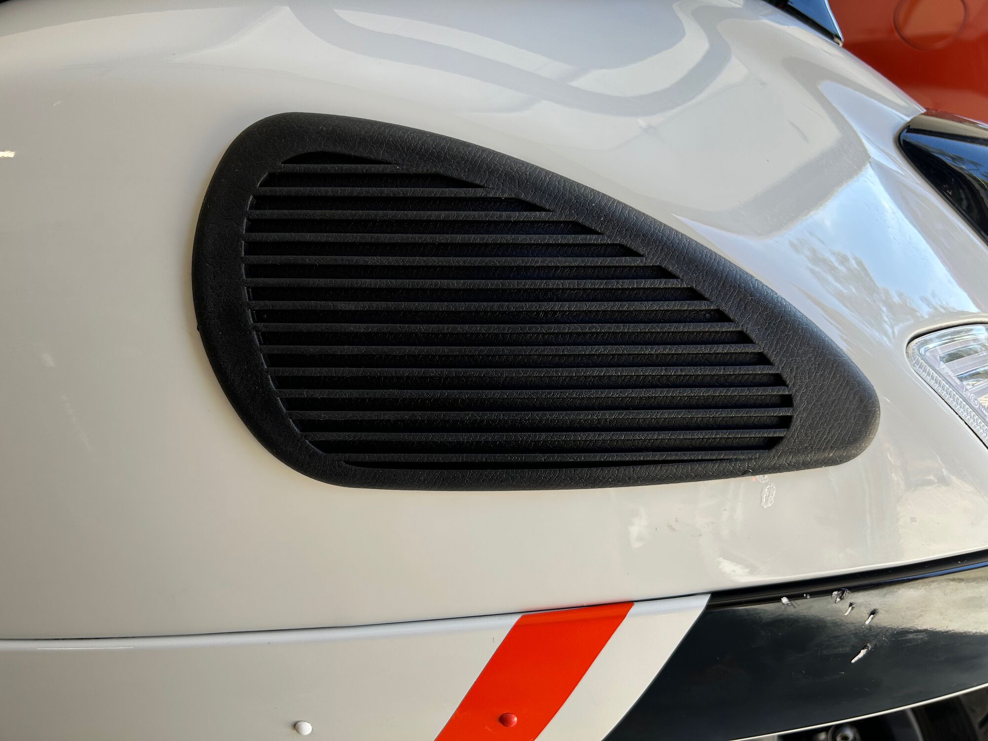

Finally got around to doing something about the fall damage. I think it looks great. Not that I wanted to drop my bike, but it's ok. I haven't decided yet on whether to peel off the rest of the black sticker, or use a sharpy or some black paint to fill in the scratches.

That rubber panel looks good there. Speaking of levers I remember many,many yrs ago a Puch brand MC my friend had. After falling over the end of the lever was bent almost into a circle. The ball end still attached. I assume that the OEM had lots of magnesium alloy in the aluminum to do that. Now that was really something. I know we'll never see that again, unless maybe racers have/use levers like this.

That's a great repair.
