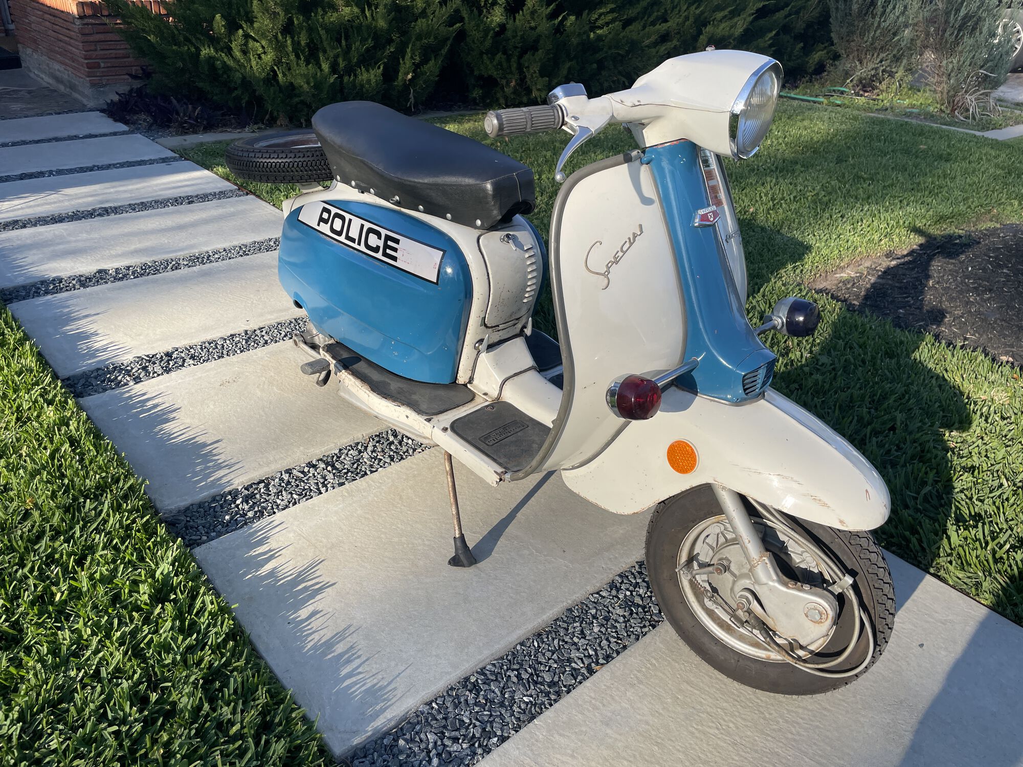

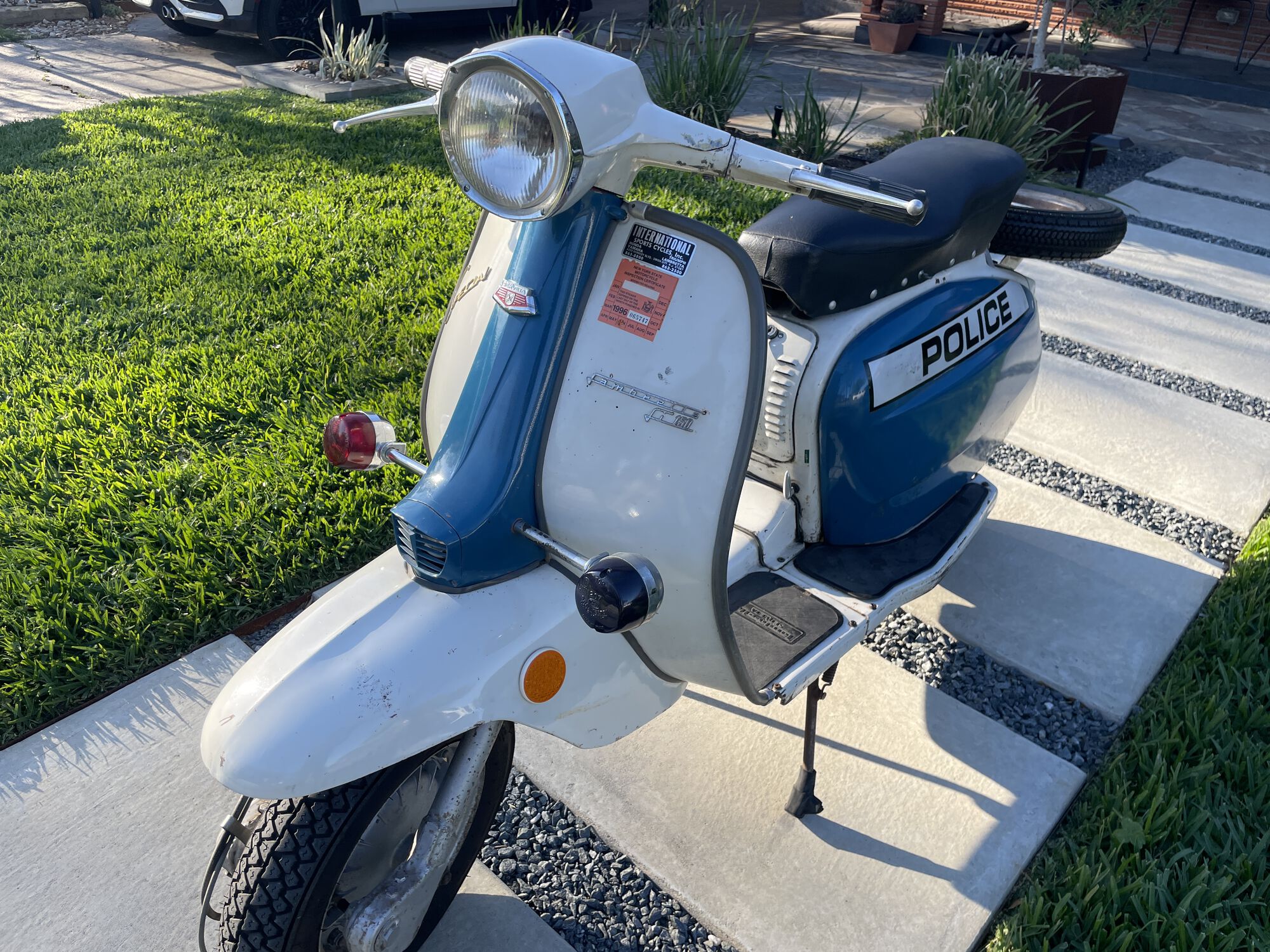

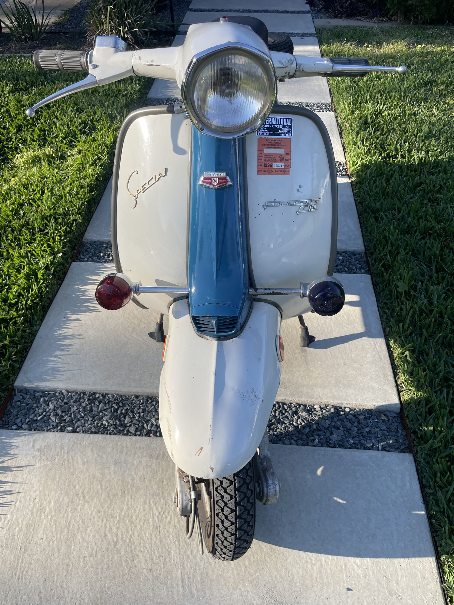

I am aware this is Vespa adjacent… but just wanted to start a thread about my Ithica PD police bike. It is a Li150 Special from Serveta.
Scooter was in service in 1976/77. It was taken out of service and mothballed for a number of years before being sold at auction sometime in the 90s. Garage kept for a number of years before my fellow Texan John purchased the bike while on a ski trip in Colorado.
John had a mechanical restoration done at Casa Lambretta, remade the service decals, and kept the bike in good repair for the next 15+ years.
I'm gonna see about getting the red and blue lights working at some point and doing some minor maintenance tasks…. Otherwise it's a first kick Scooter and doesn't need much work.
The only thing top of list right now is that the kickstand is a little wonky and the Speedo drive is a little wobbly as well. Happy to be the caretaker for this one for a while! Ok…. Pics
The original paint is very solid.

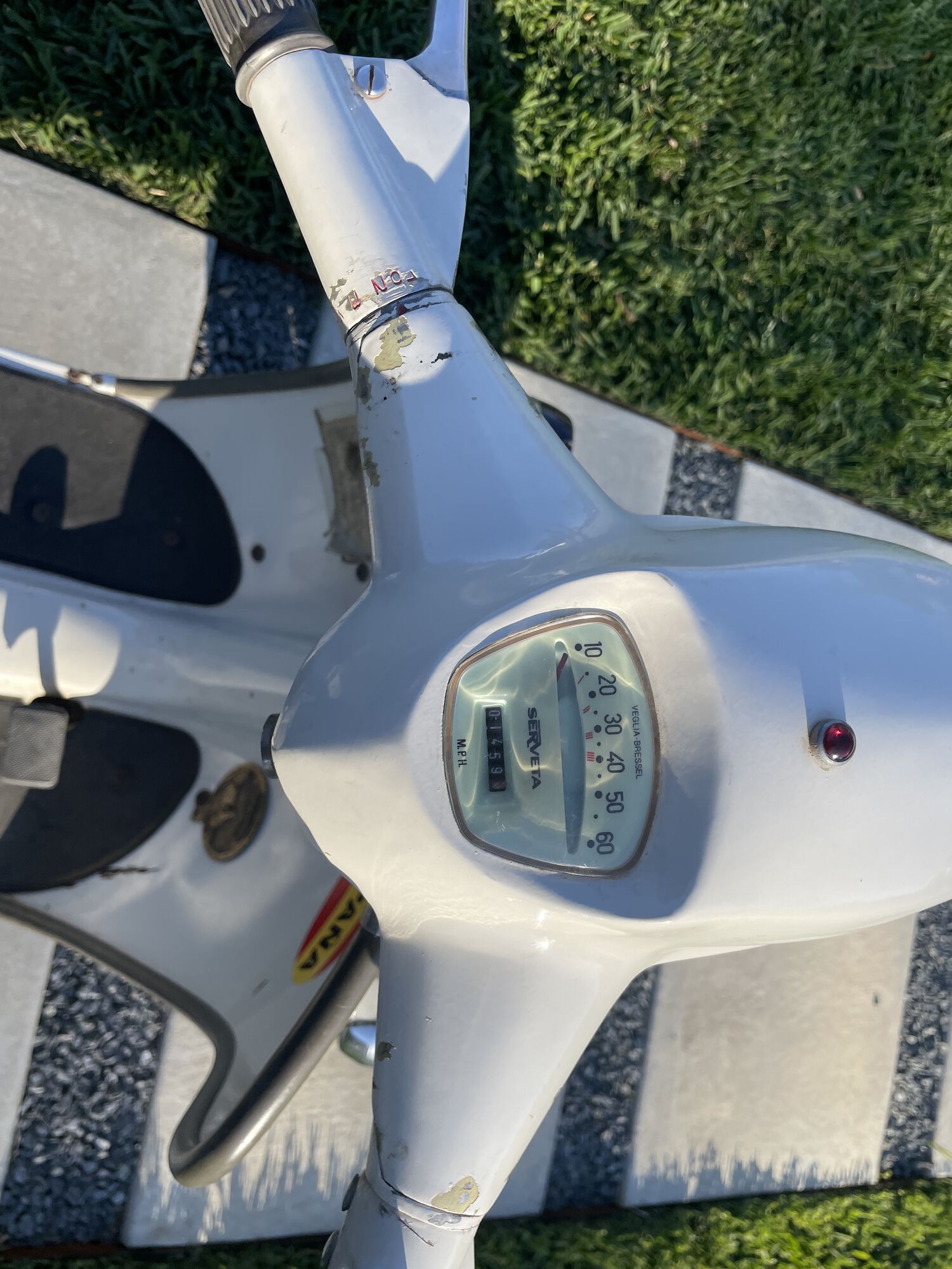

Low miles and you can see where the windscreen used to be… I need to find one eventually.

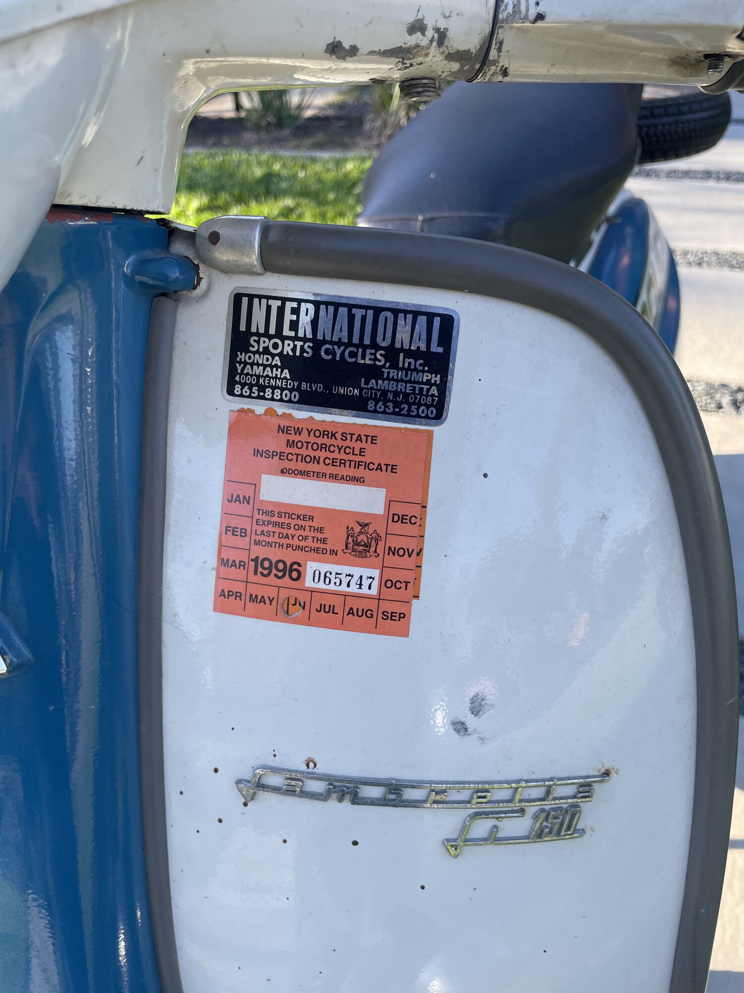

Dealer stickers and auction era inspection tag.

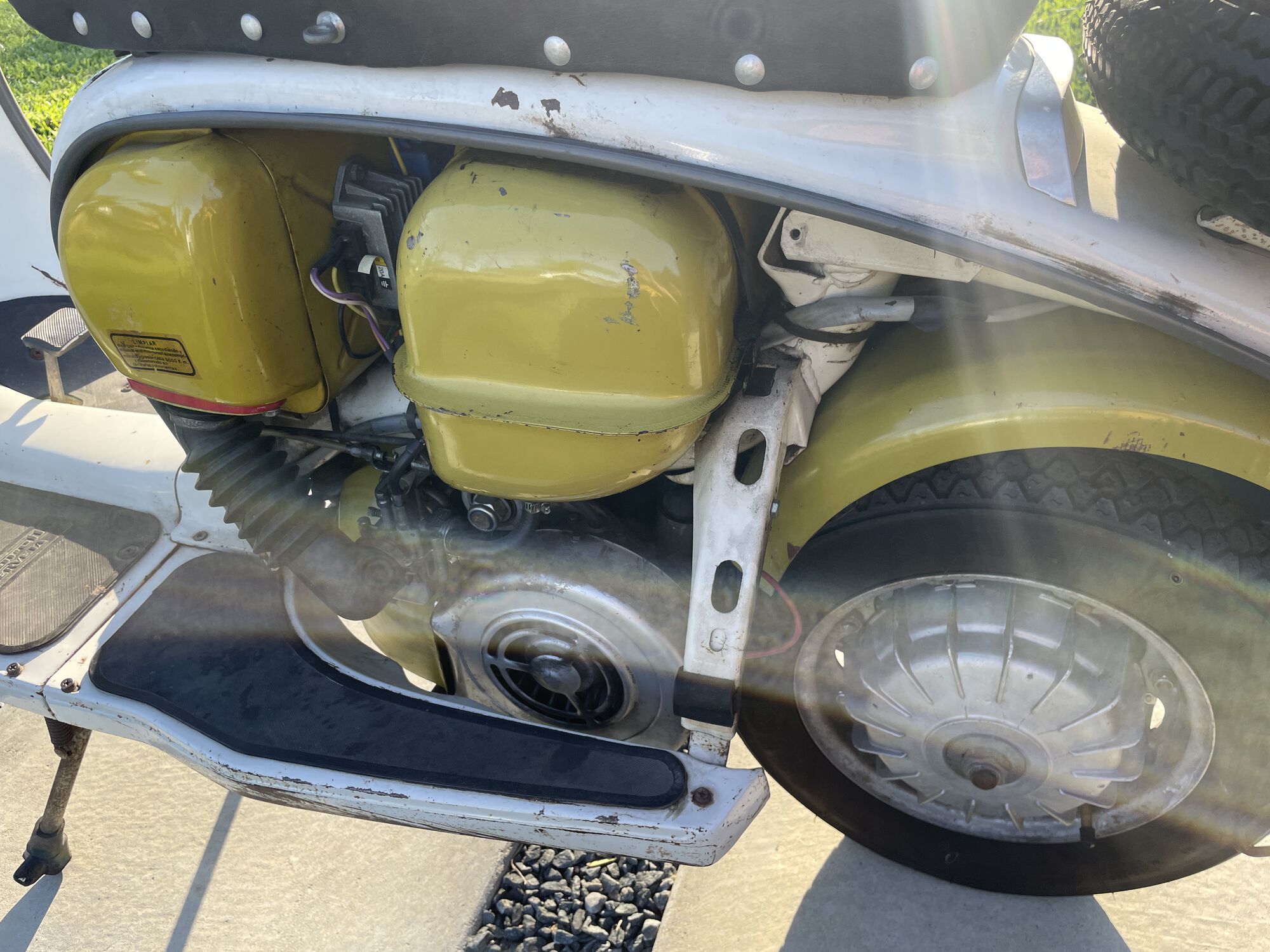

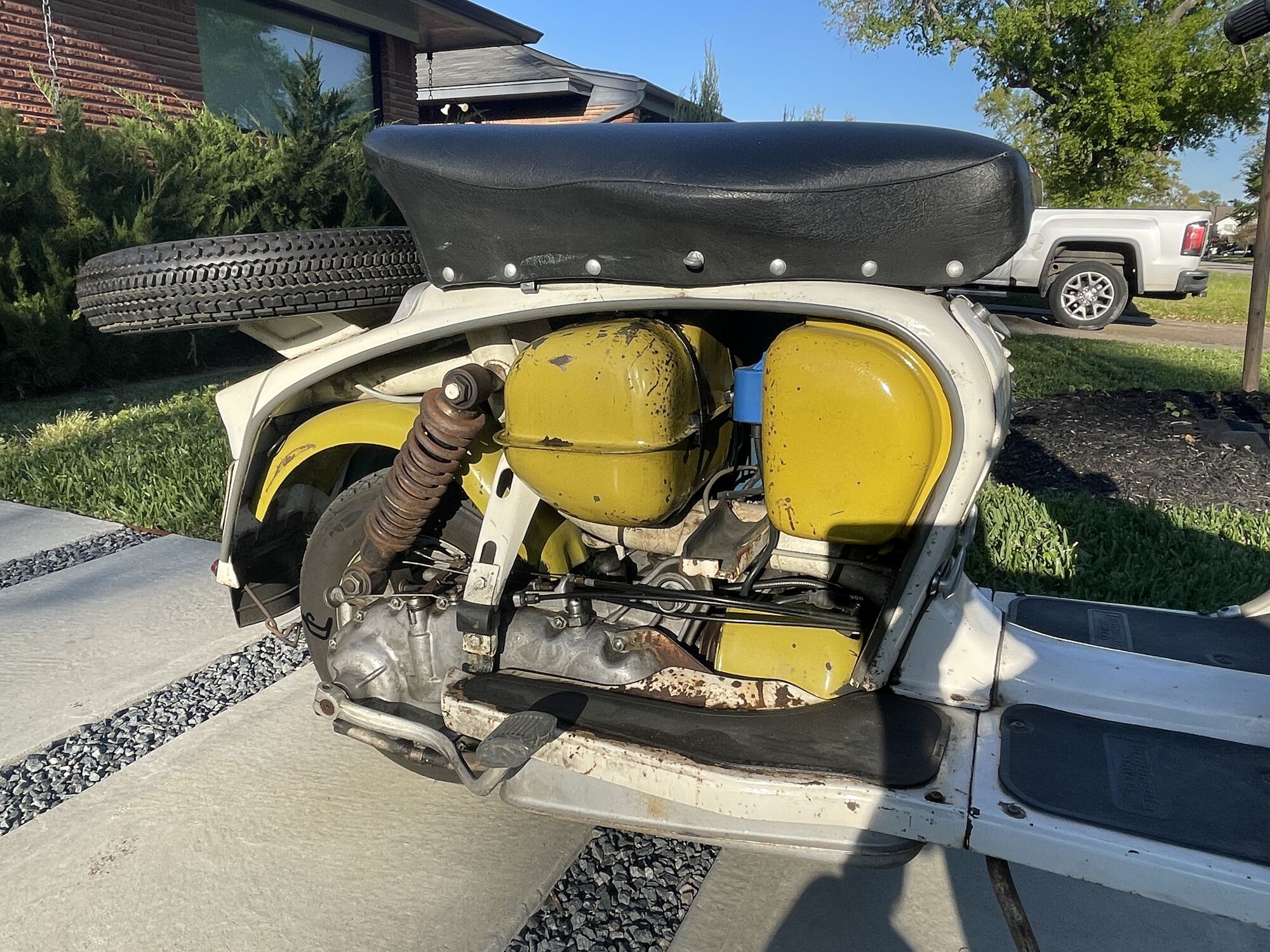

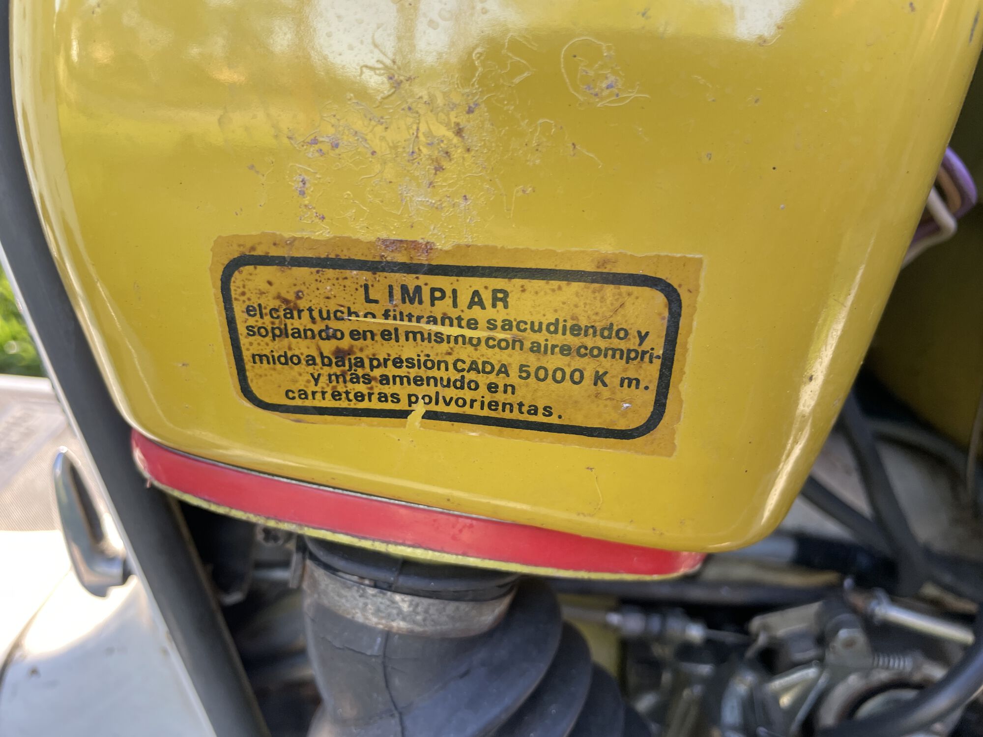

I'm told all the Servettas of this era were either yellow or kind of a lime green inside the panels

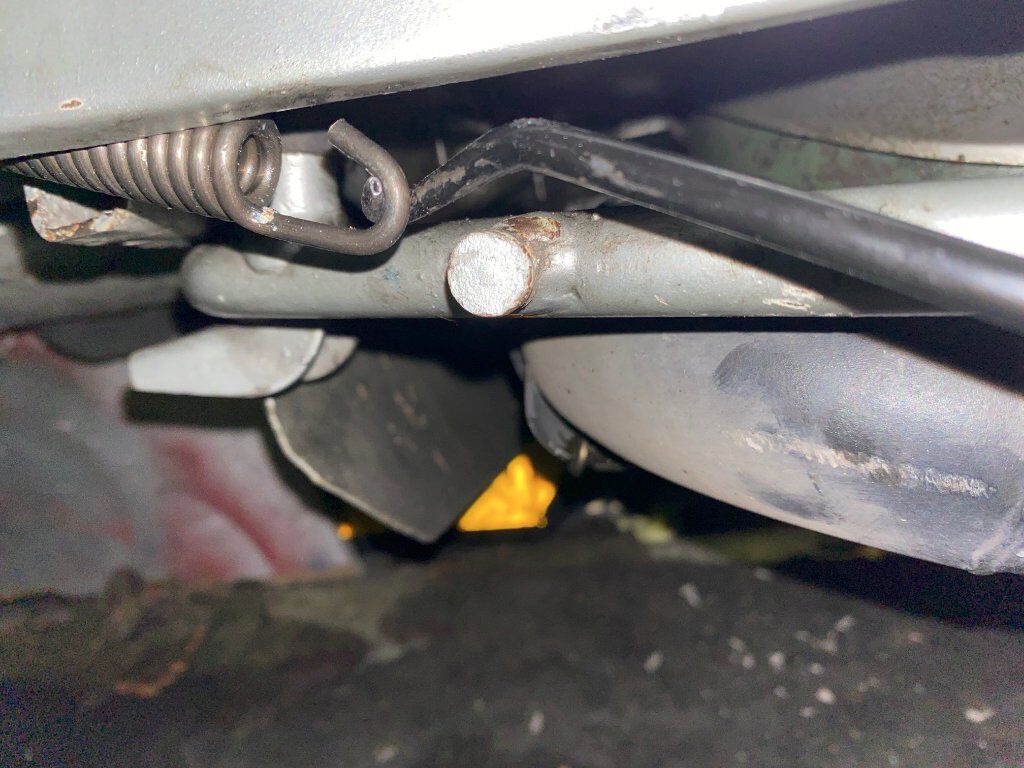

I have reinforcement plates that i welded onto my lammy. I think i used MB's stainless steel version?

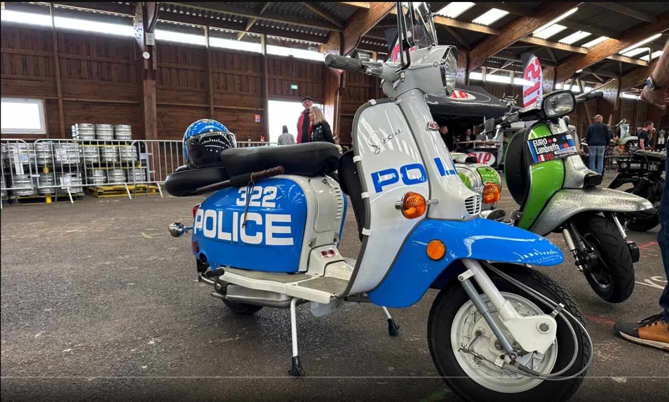

Here's something for you to aspire to, BN.
of course, you have the OG red and blue flashers/turn signals, but soemone did a gorgeous job on this one from the Euro Lambretta.
(seen here)

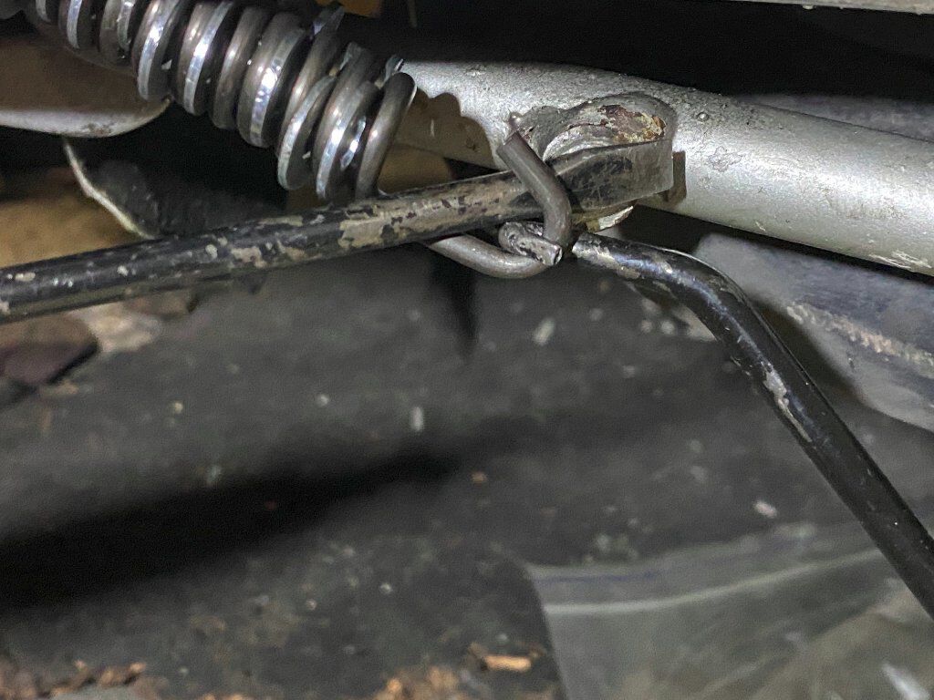

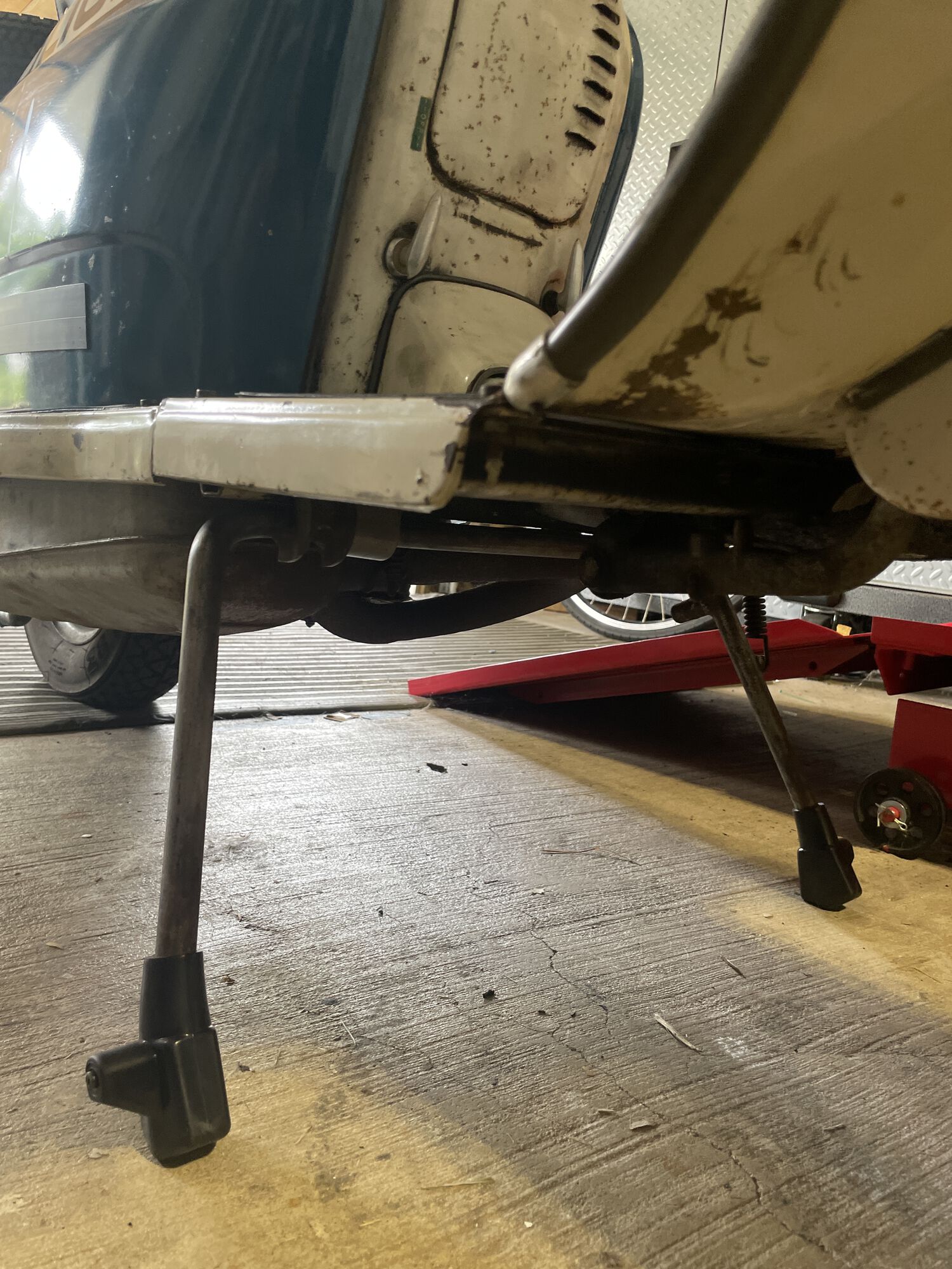

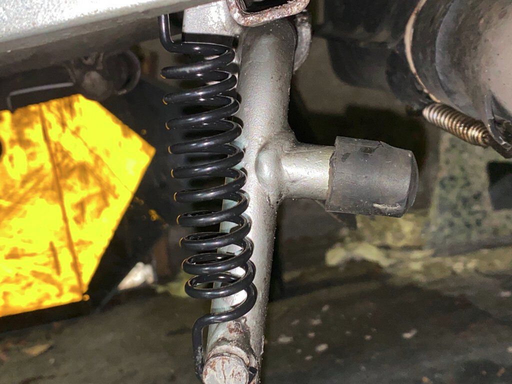

Fixing a center stand on a Lambretta.
What I learned.
1. Unless you have all the correct parts on hand, it will take around 30 days. (Shipping, etc.)
2. Servetta stands are different than innocenti stands. They have a rubber stop that prevents them bashing into your floorboard. (I now own an unused casa Lambretta stand… please reach out if needed.)
3. It is a fiddly job. Access to some of the screws and nuts is extremely silly.
4. Stand feet - repop feet did not come close to fitting the repop stand. The retaining peg hole was so far off one would need to drill a new hole in the stand to make things match up.
5. SLUK Clips are defo worth buying.
6. Comparative maintenance Score: 2.75 times harder than doing a Vespa stand.

You're lucky you had no issue fitting the spring. When my original Serveta spring broke (rust), I ordered a new one from Casa, and it was impossible to pull out enough to reach the peg, whether using a screwdriver as a lever or fitting coins between the coils to get it to extend that far....
I finally gave up and found a spring for a Piaggio goped that happened to be the right length.

I just dealt with this (and will deal with it again soon enough).
The trick is to loosen the left side center stand bolt a few turns. it'll let the top bar of the stand move forward a few millimeters and you can put it on with your bare hands.

That's what I'd done the first time I reinstalled the stand a few years ago with the old spring, but this spring was a different beast, with hardly any elasticity. No dice however I tried...
I had the same issue with the Casa spring that you did… thinking it was different between the Innocenti and Servetta set ups. I just cleaned up and reused the OG servetta spring. Even with Chandler's trick employed I couldn't get the new spring to pull far enough.
