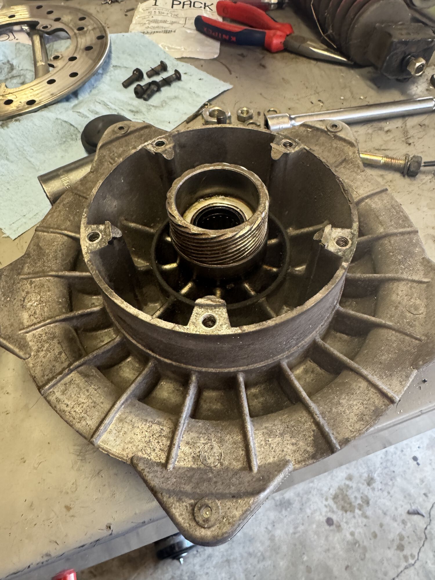

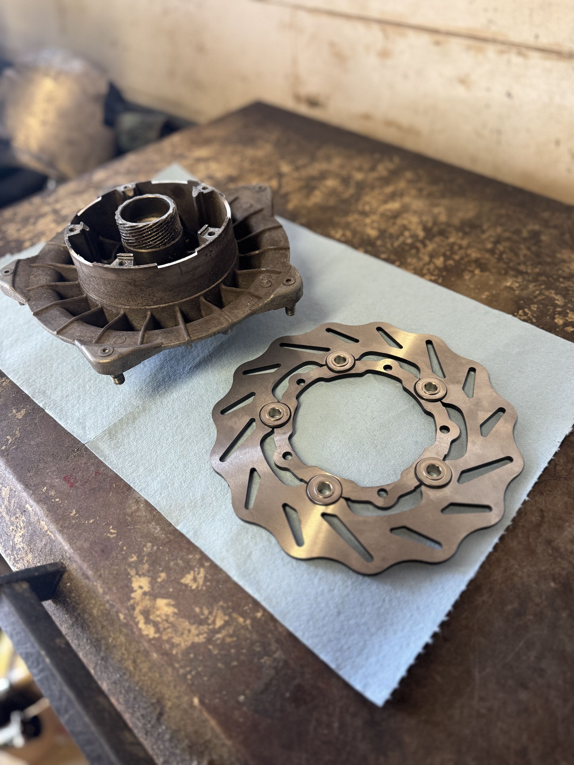

Did this for a local-ish rider that now resides in St. Croix and flies back from time to time for riding in and around Indiana.
Besides updating the rest of his 2005 LML Stella, i have changed his original standard disk to a floating disk by machining crenellations to the drum.
Standard LML front drum with the original standard disk in background.

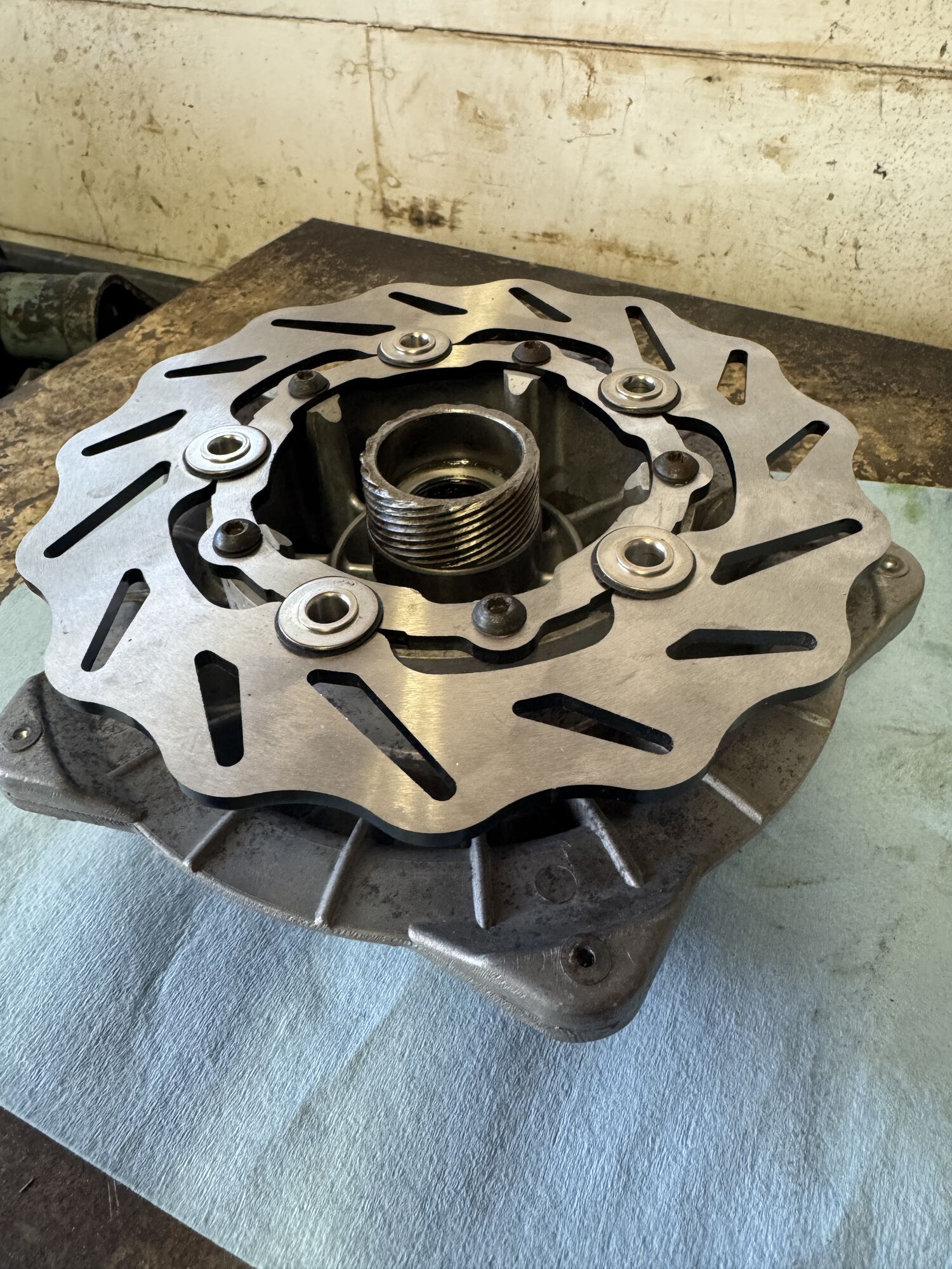

Drum machined with a mill.
machined drum and new Polini floating disk 175.0006.

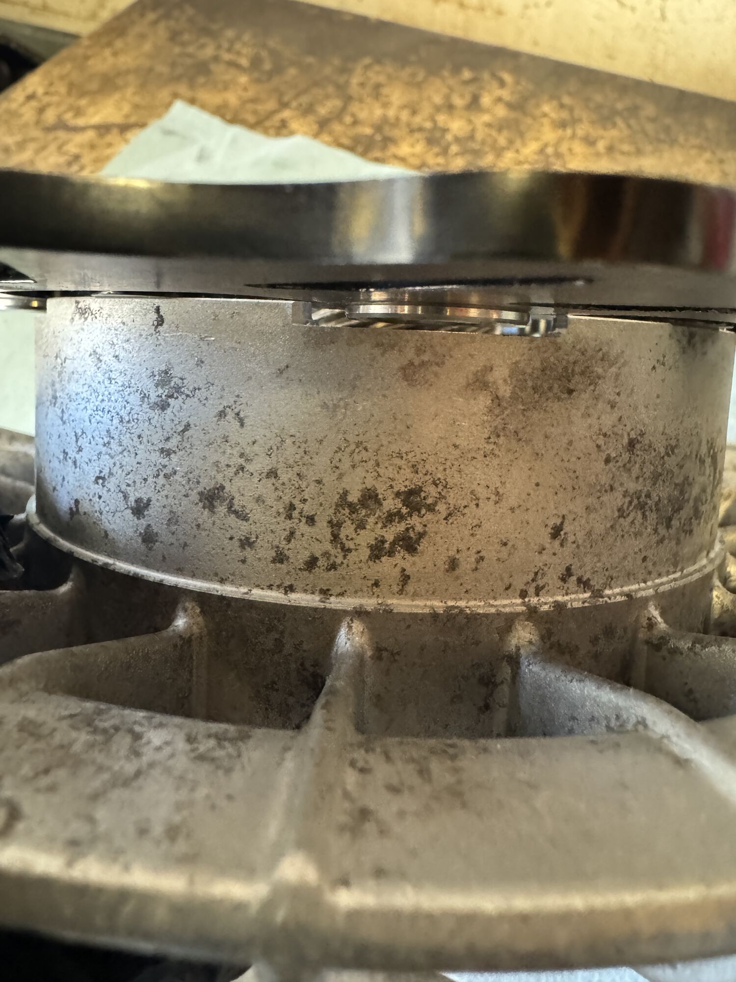

Floating disk positioned on top of the drum in correct orientation.

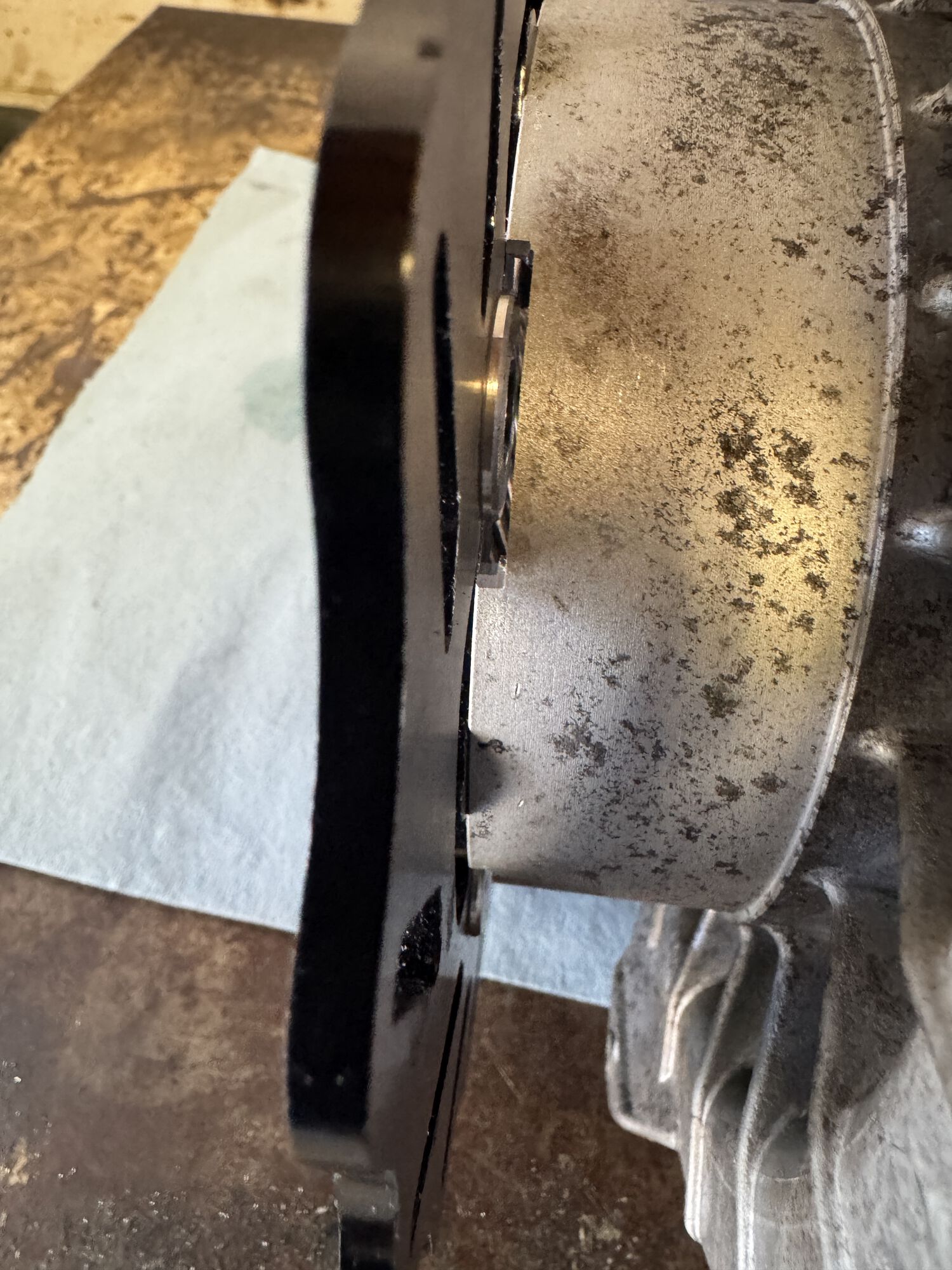

This is why it has to be machined- to allow movement of the floating rivet.

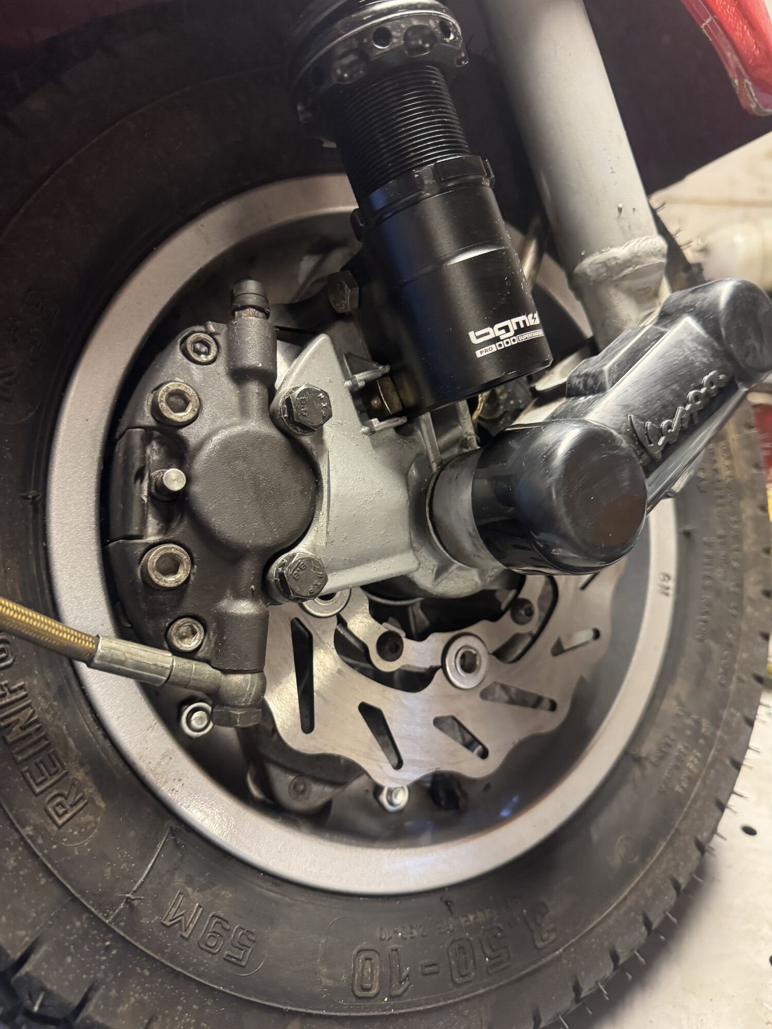

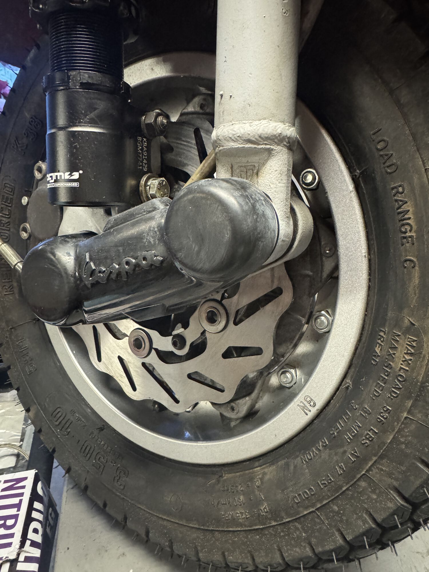

installed and updated the brake pads to Polini S21/organic.

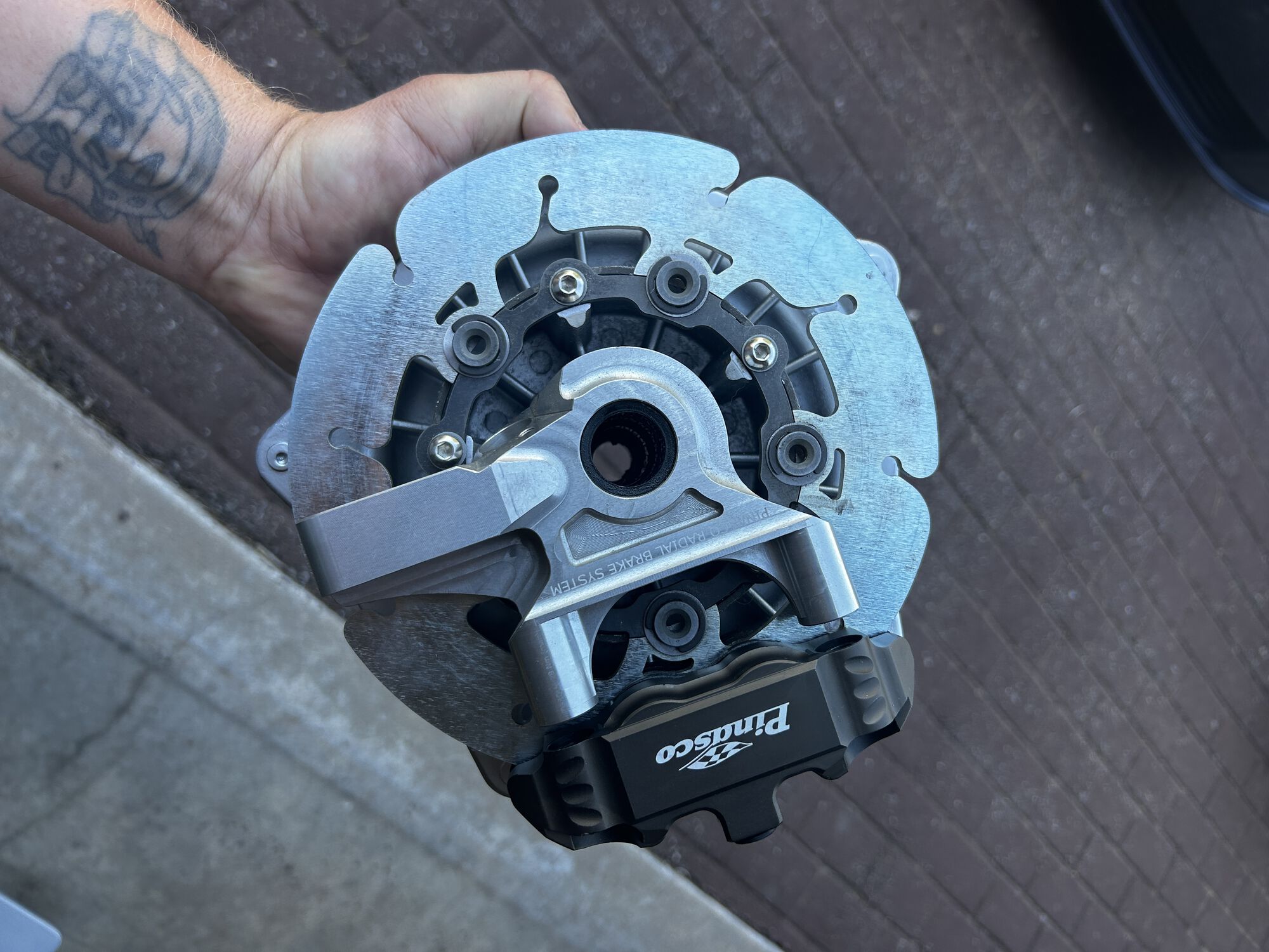

Love the Polini disc.. got the AF radial mount and GS caliper, this thing stops so good now, unbelievable!!

the radial caliper is much easier to take it off when running a external fluid reservoir.

Great work! Did this upgrade a few years ago with a radial master cylinder, massive improvement.

I got lucky and got the pinasco radial bracket and caliper for trade of some bits I had laying around. The other option by VMC is better priced but don't have the bling factor.
