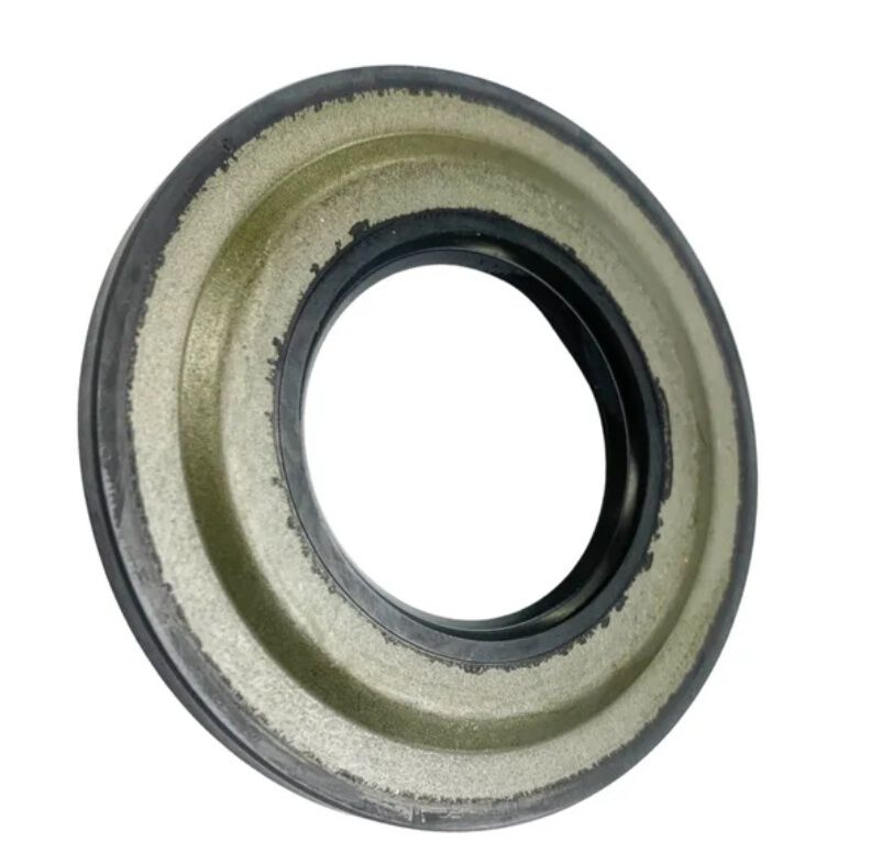

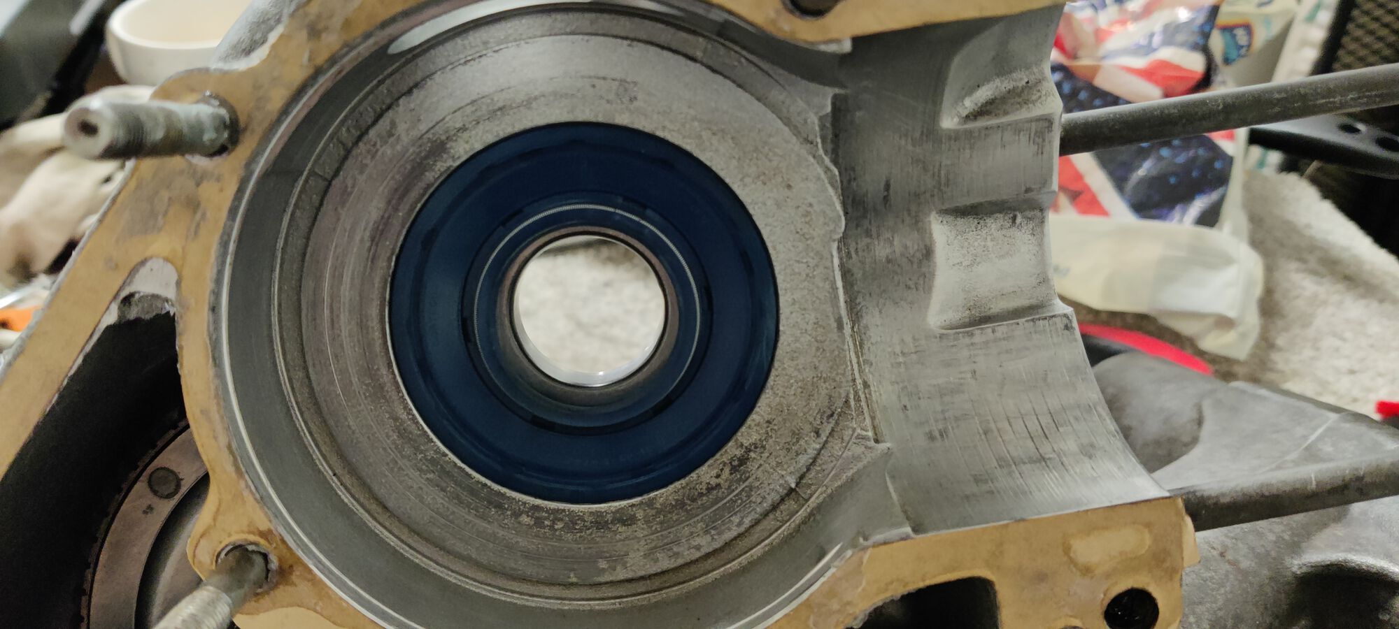

Kowalski
I'm sure I put the seal in the correct way.
The picture was the side facing the clutch.

That is the correct orientation. No idea what else it could be.

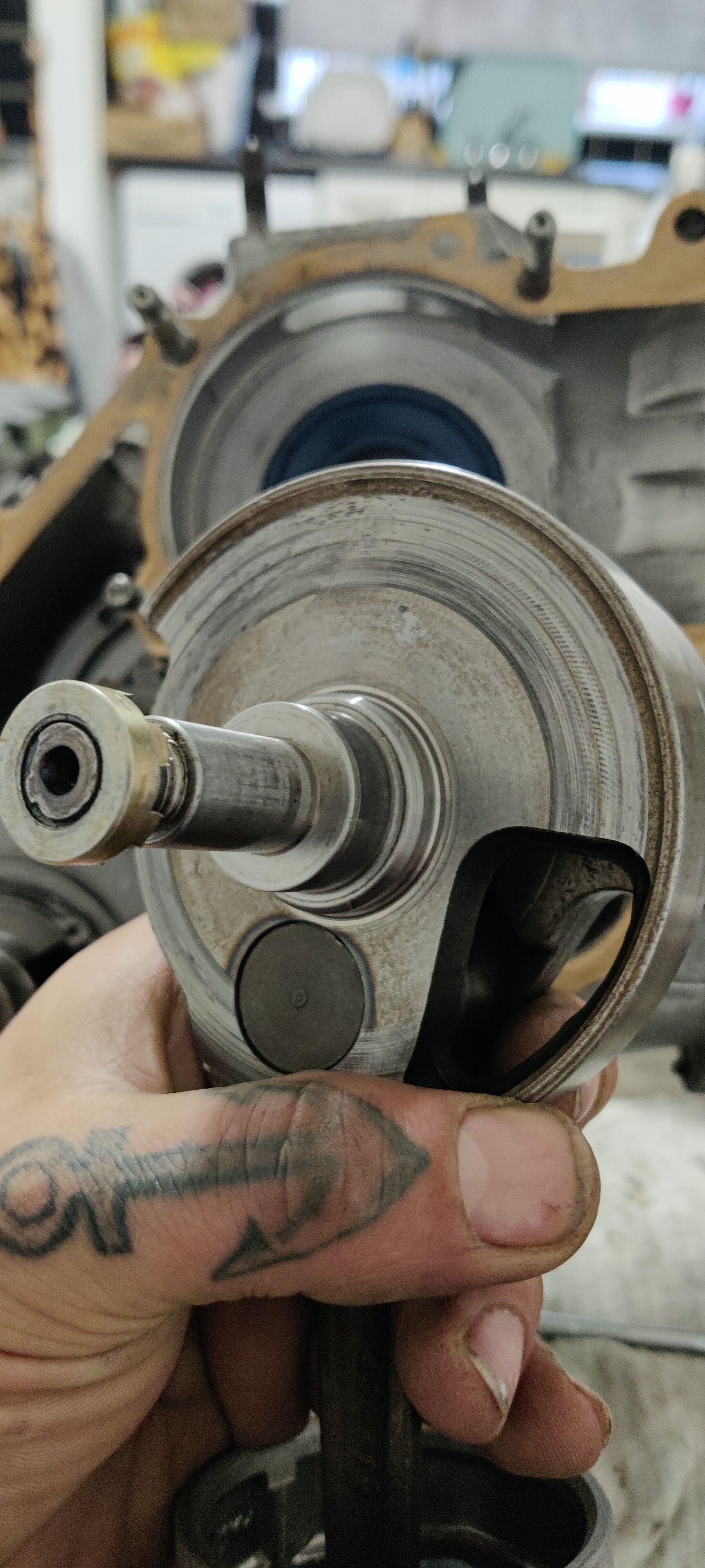

Just opened it back up. I think maybe the webbing of the crank is binding? Crying or Very sad emoticon

Goodness. Well, mystery solved.

I couldn't hear anything grinding though. Could the crank have not been aligned correctly or do I need a new one?

Wasn't expecting that. Big end pin looks like it's moved. Check the bearing is ok and is retained correctly outboard.
Good eye, Jet-eye.
Is that blueing from heat I see around the crank pin?
I find that it's harder to tell if the clutch side bearing is properly seated on the older p cases. Later cases have a more substantial shoulder for the bearing to seat in. I think it aligns it better.
I suspect you have a crank that is out of true. You can measure it with v-blocks and a cheap dial indicator, take it to a machinist to measure, or set it up on something to eyeball it while you turn it over. If it's really out, you should be able to see it.
