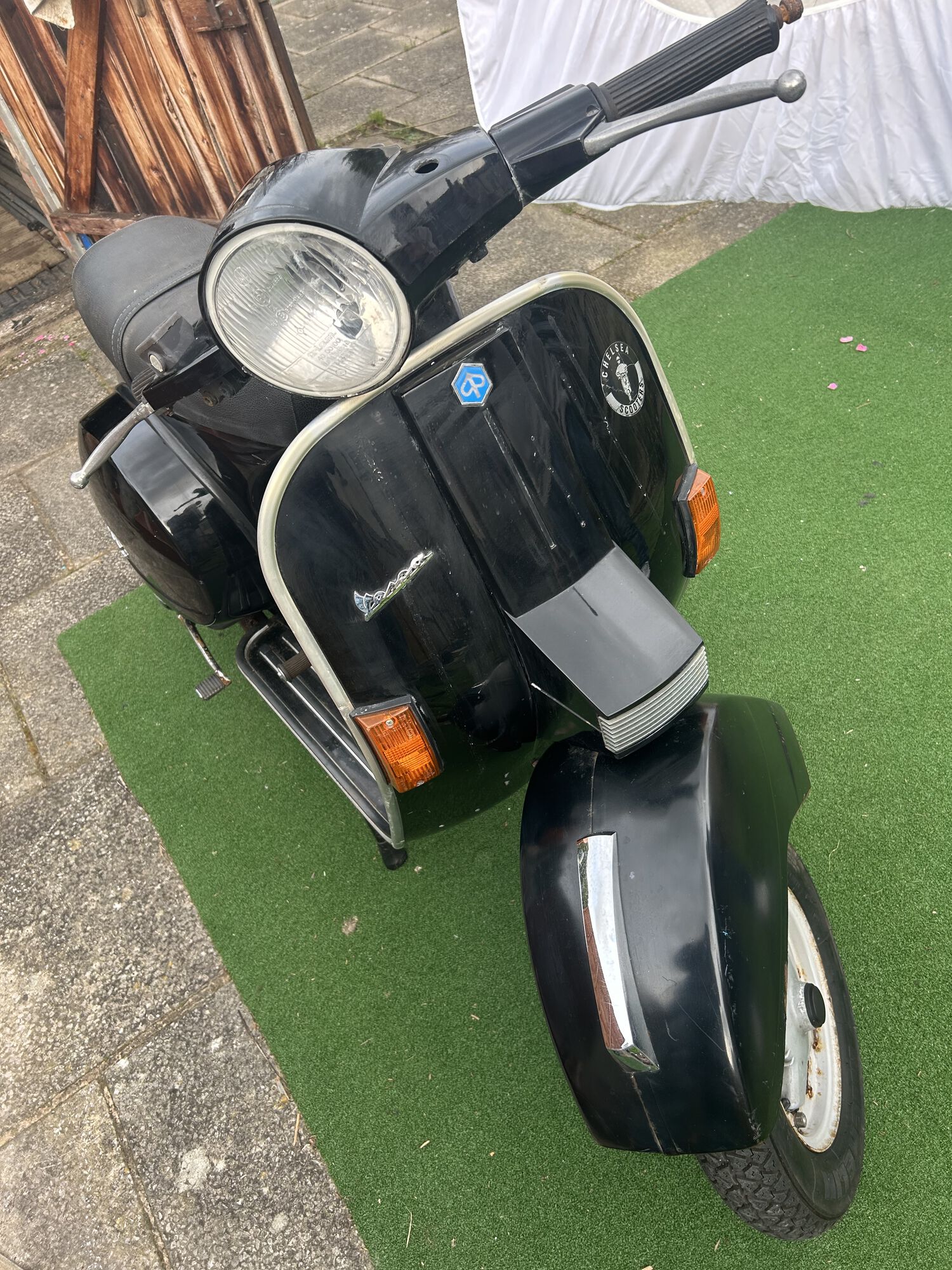

She's a 2001 px200 but with a px125 engine and a sip exhaust. And I have a few questions.
The guy told me the autolube might not be any good and not to trust it. So what is the fuel to oil ratio? I'm not even sure on the tank capacity either.
The exhaust was fitted but the carb hasn't had new jets, how much should I increase the jets by? And is this something that is urgent and needs to be done immediately?
Also what oil is best for this engine?
Thanks, Ellis.

Something's fishy….can we see more pics please?

Smelling dead fishes here? I guess you mean the bike? This seems just a legit follow on to when he was deciding which to buy here T5 or a PX125?

Haha no I was just wondering about the 125 engine in a p200. Never seen it go that way. Usually the reverse. But congrats on the new scooter. You are gonna have a blast on it.

Thank you very much. From my understanding this bloke put the 125 engine back inside so he could install a 177 kit? He said something like that. Cos apparently the 200 was really sluggish. But he never got round to putting the kit inside.
