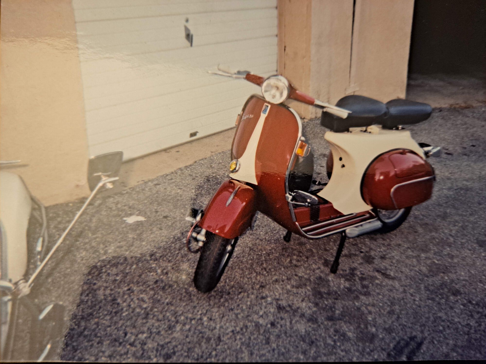

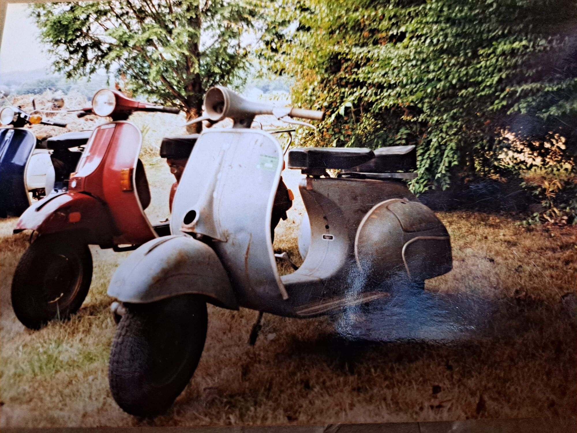

Here's where I started back in the 90s

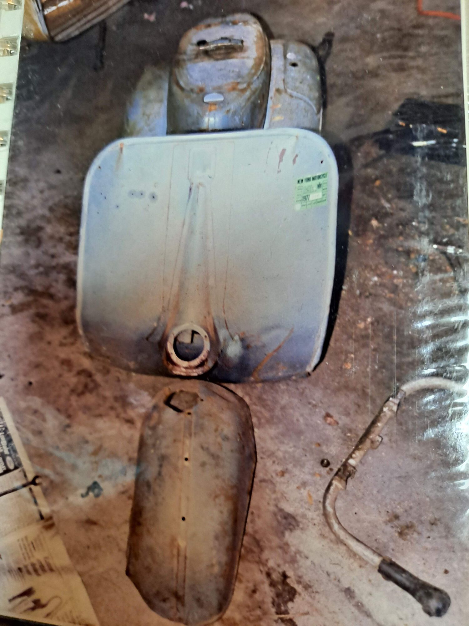

In the dank garage I was renting in college.  Seized motor out and the rest of the bike all dismantled. The VNB is just barely visible in the corner.

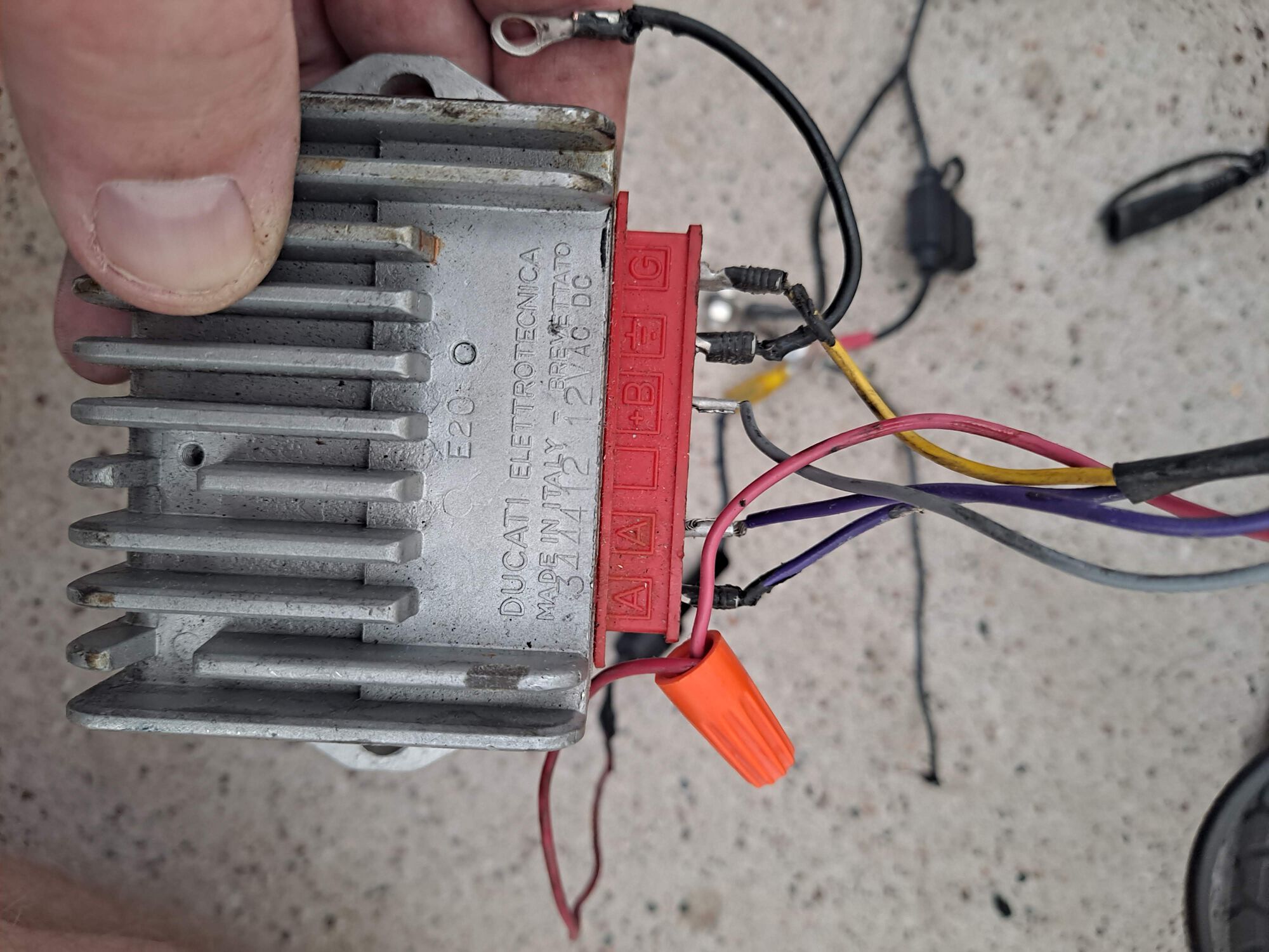

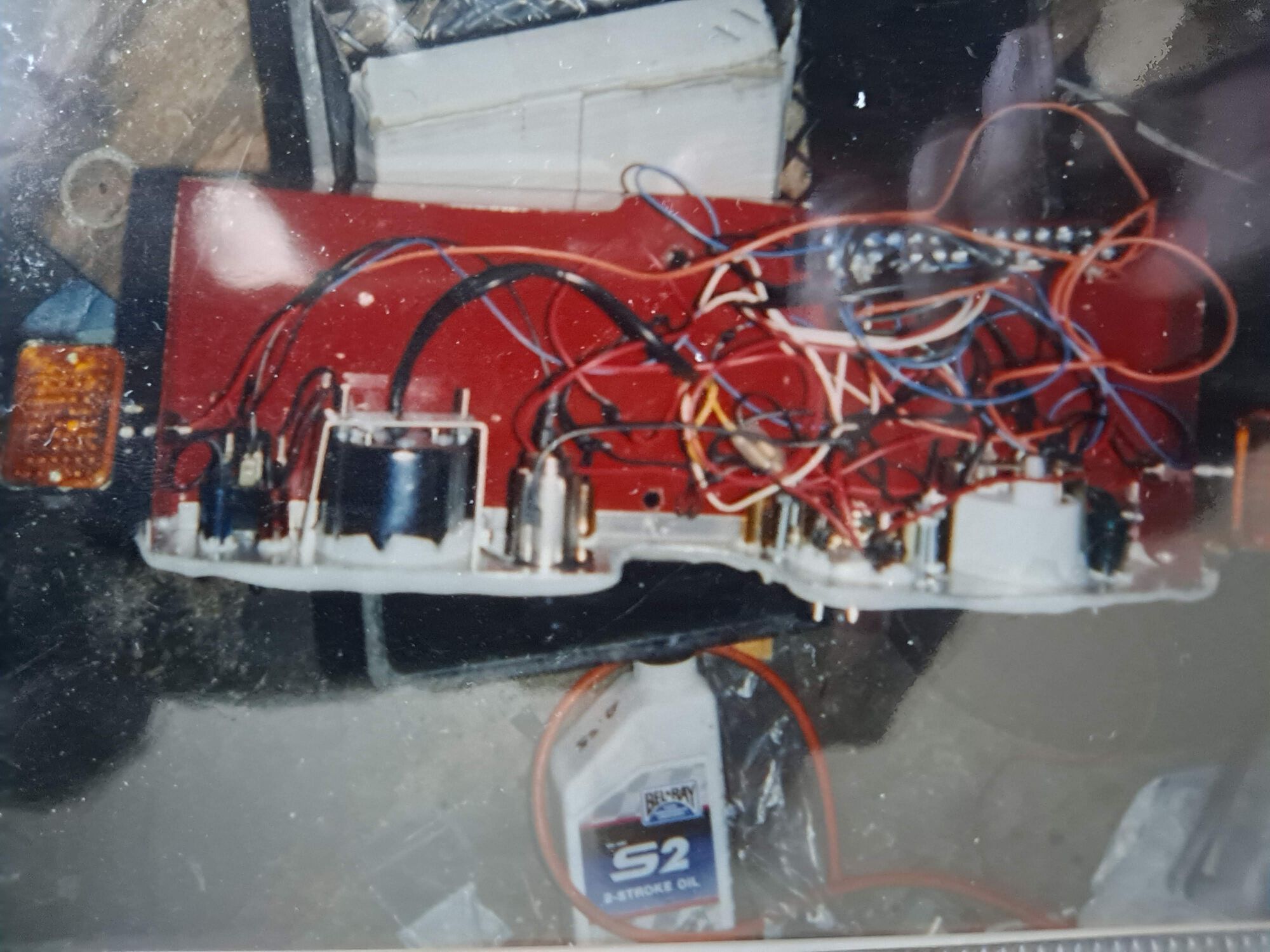

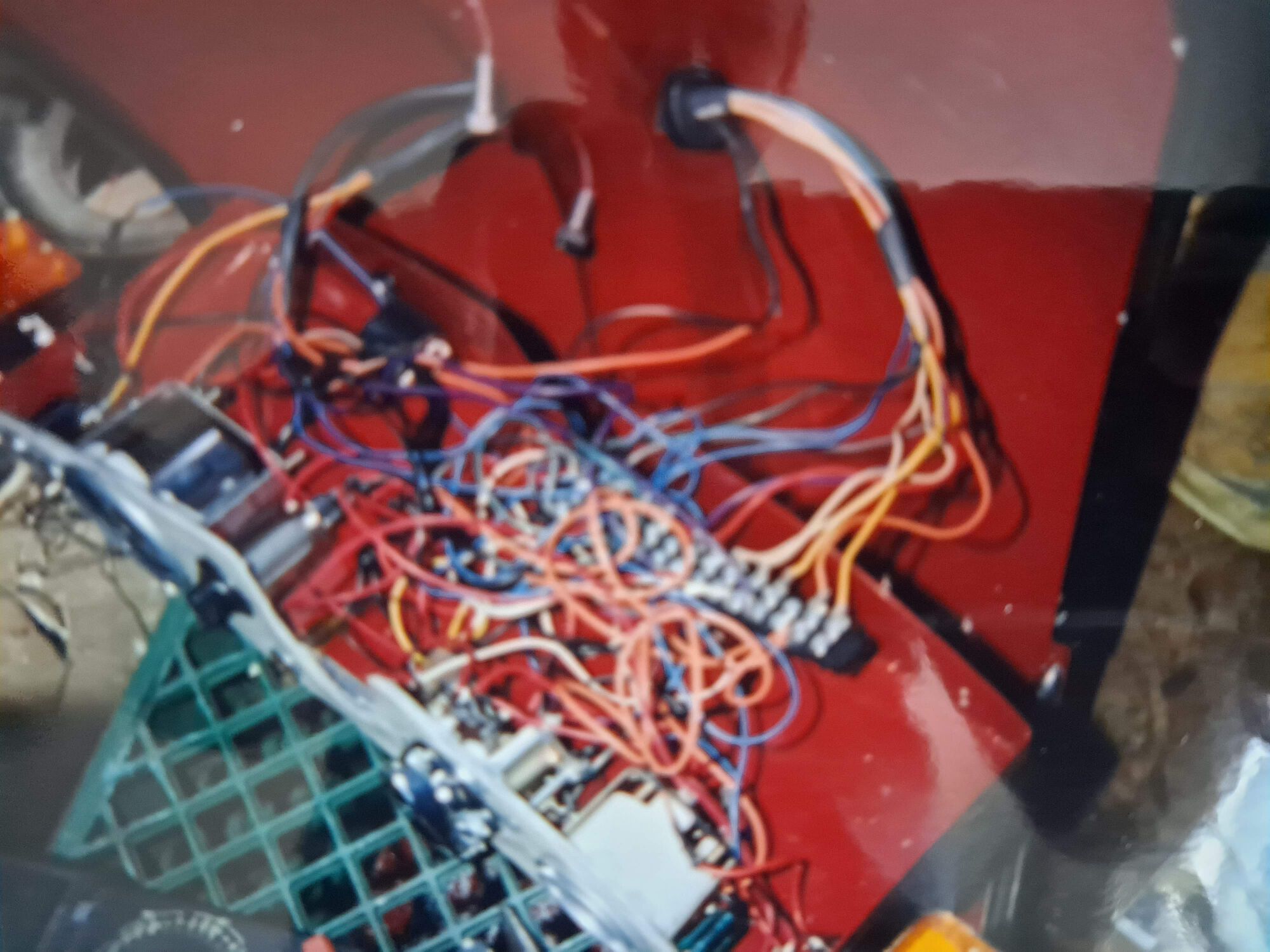

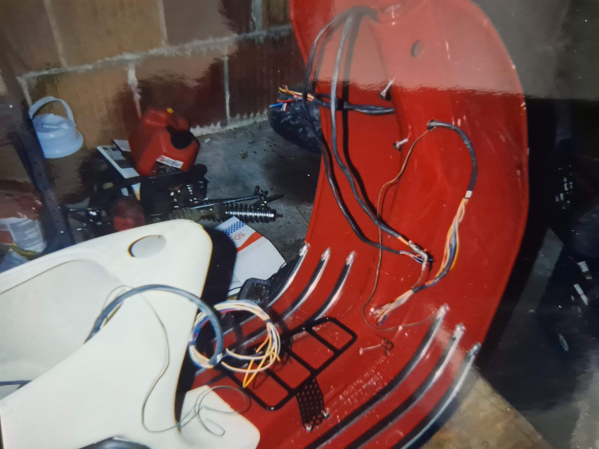

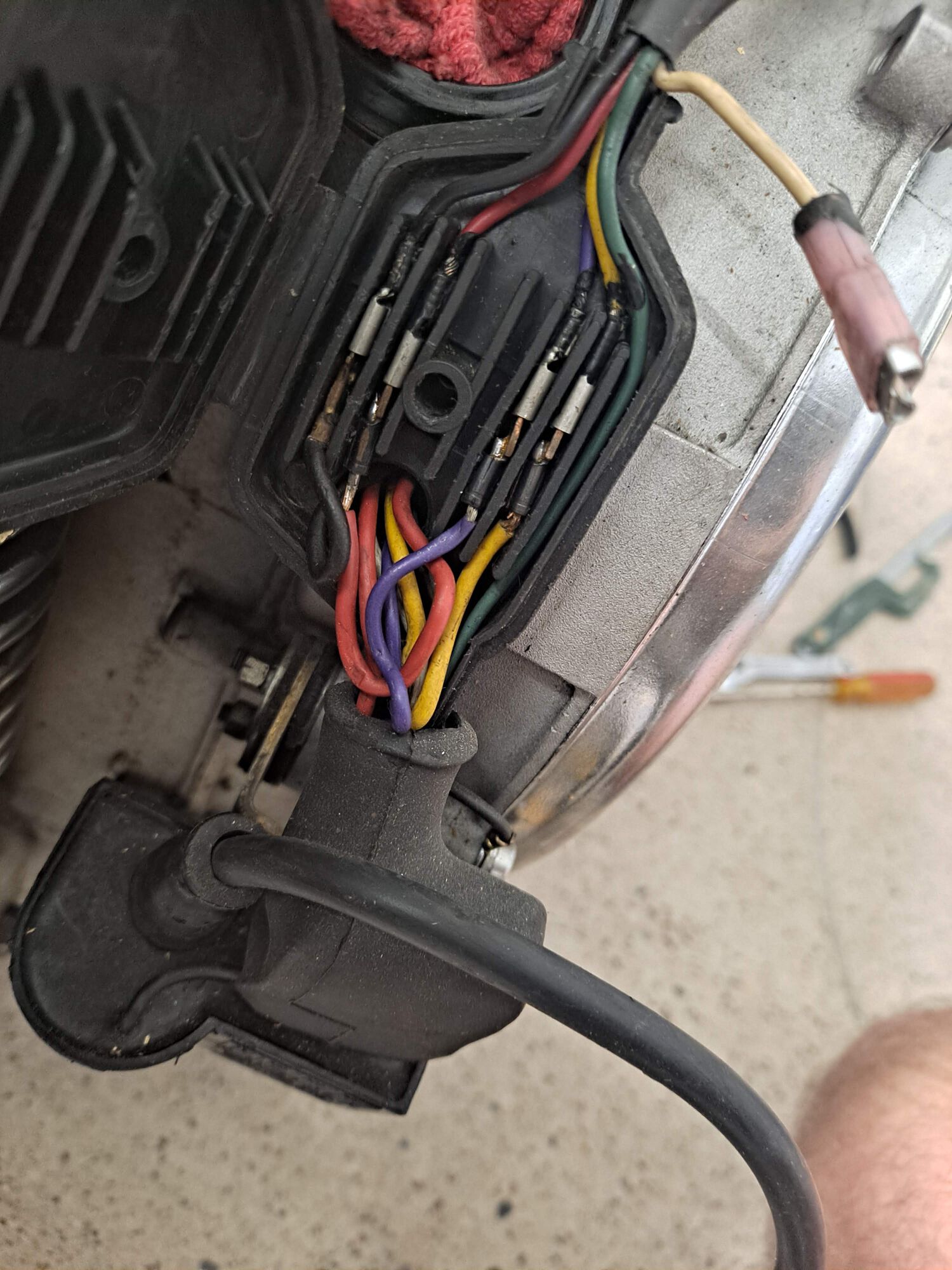

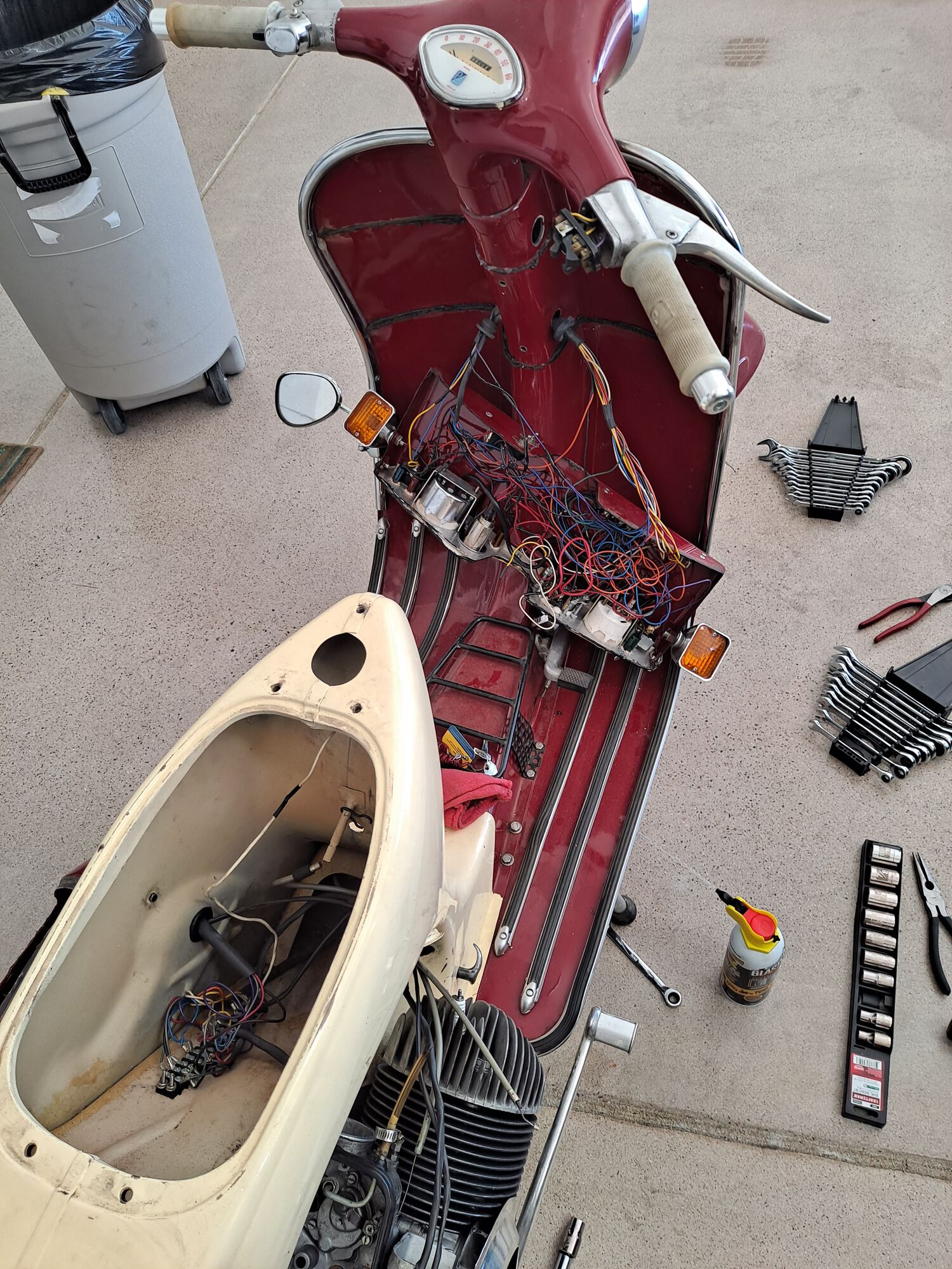

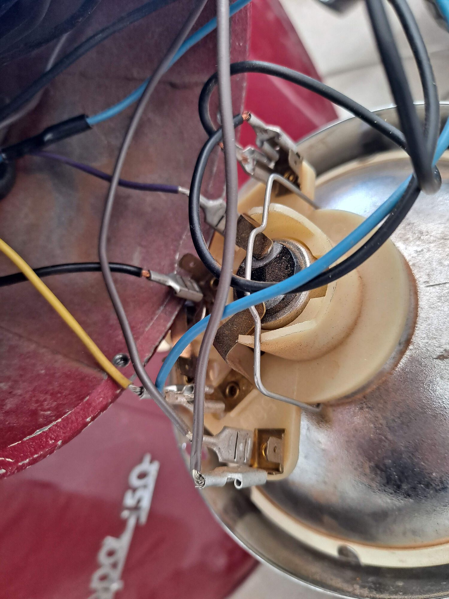

I made some... questionable wiring decisions back then, including a custom instrument panel in the legshield.  It worked great with a tach and fuel gauge, but was ridiculous in hindsight.
More of that wiring nonsense

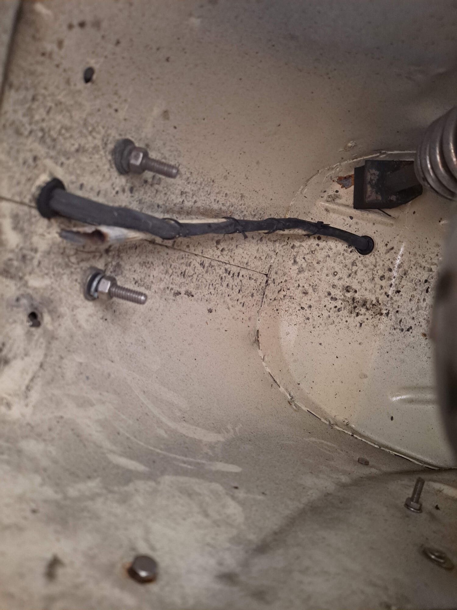

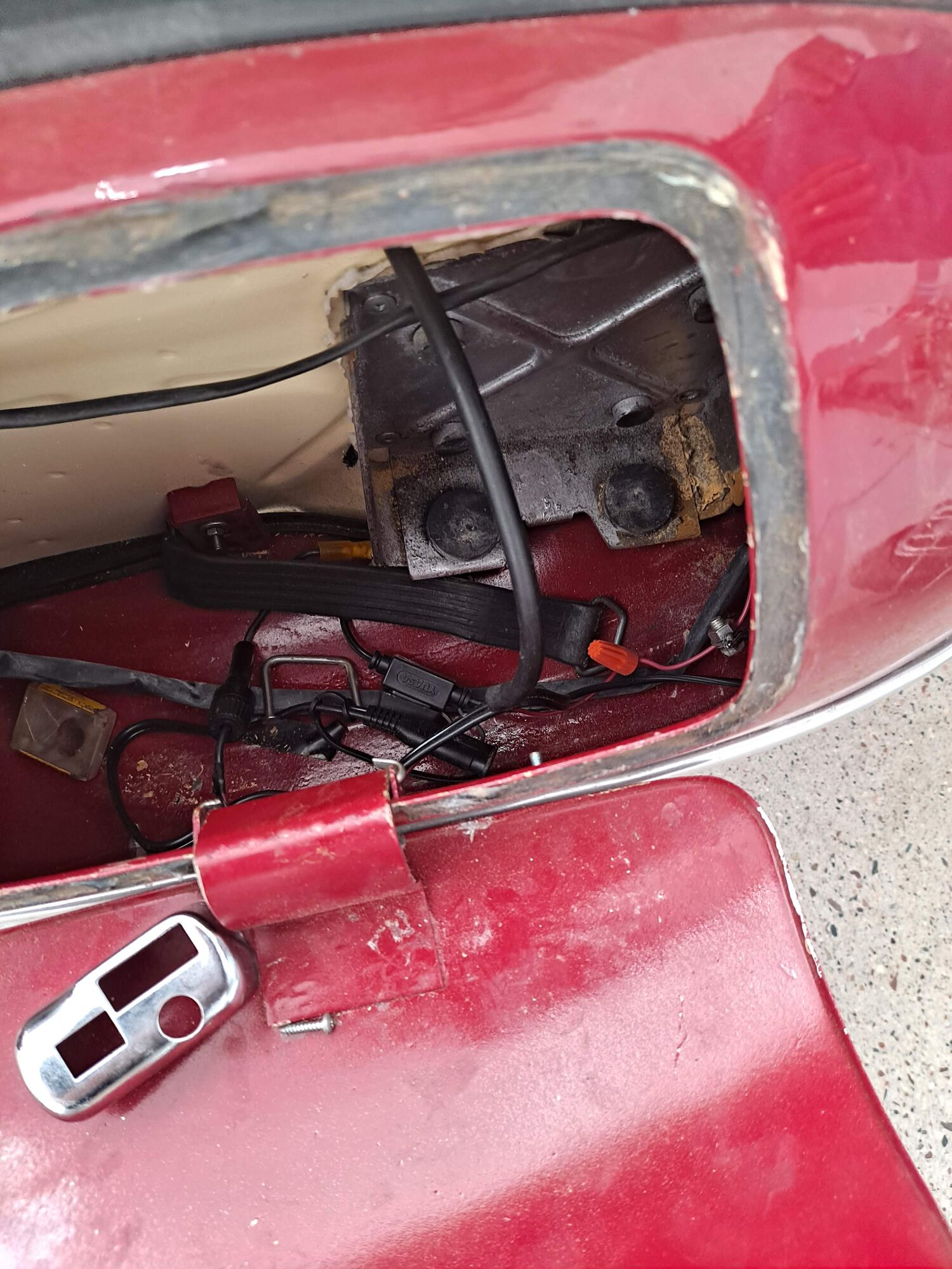

Taking things apart I'm finding all the corners I cut, like running loose wiring under the rear frame...

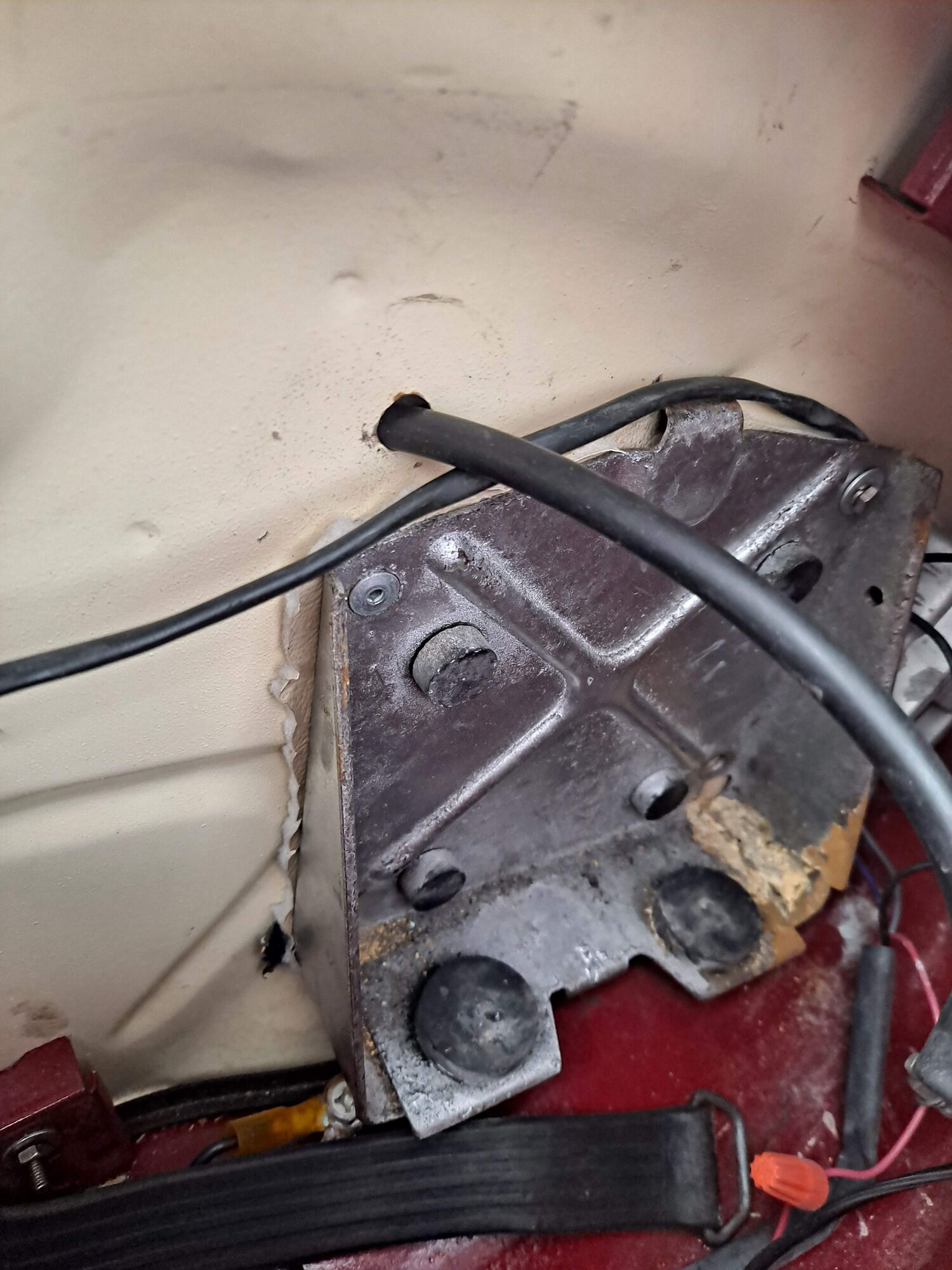

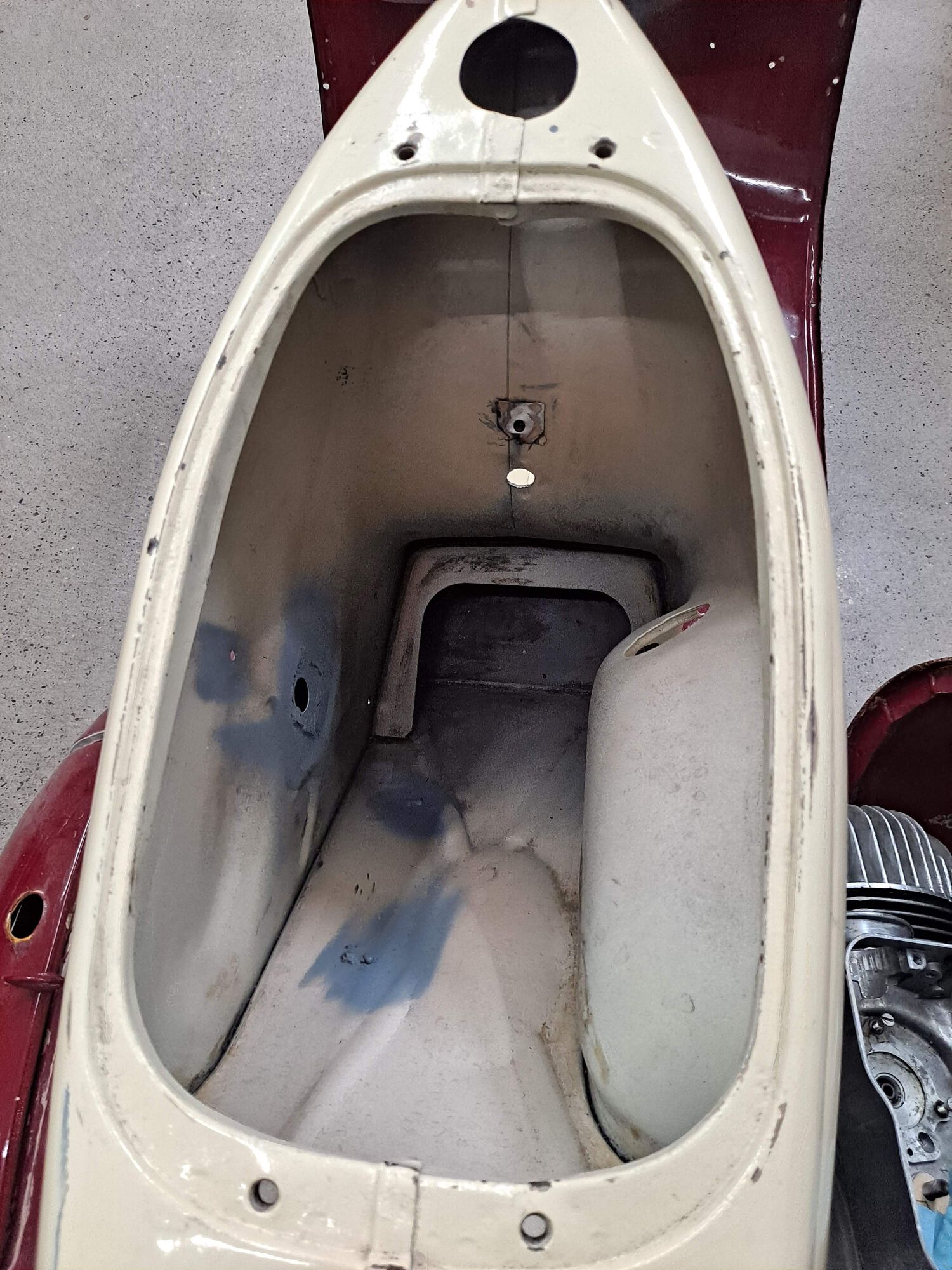

Lots of weird stuff going on here, including the remnants of vinyl lining behind the battery tray.  Weird college brain tried to line the whole glovebox with it.  Don't ask why, I took it out soon after I did it.

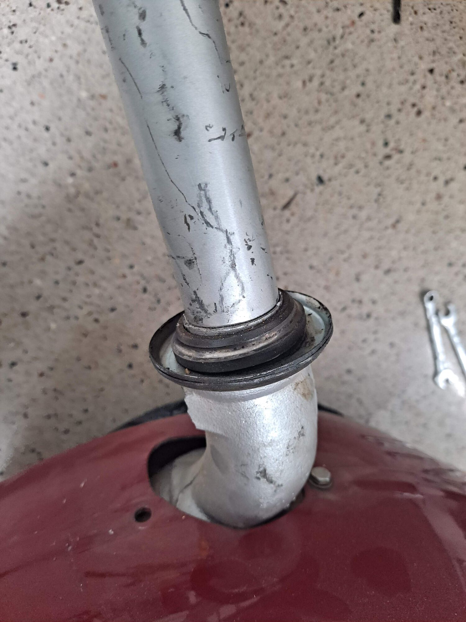

The PK fork was unceremoniously cut down to accommodate the VBB fender, but it was never quite right and rubbed against the body regardless of my hacks.

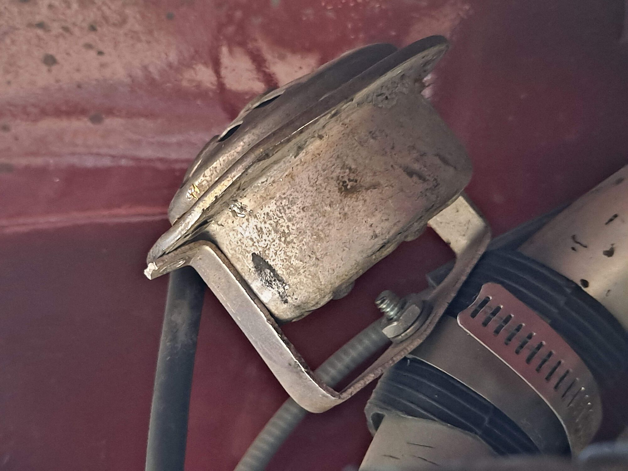

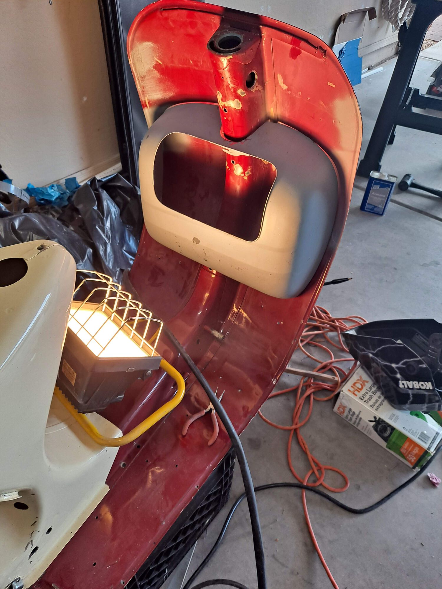

Weird college brain strikes again.  Cheap fog light I found fit nicely in the horn well, and so why not mount the horn under the fender?

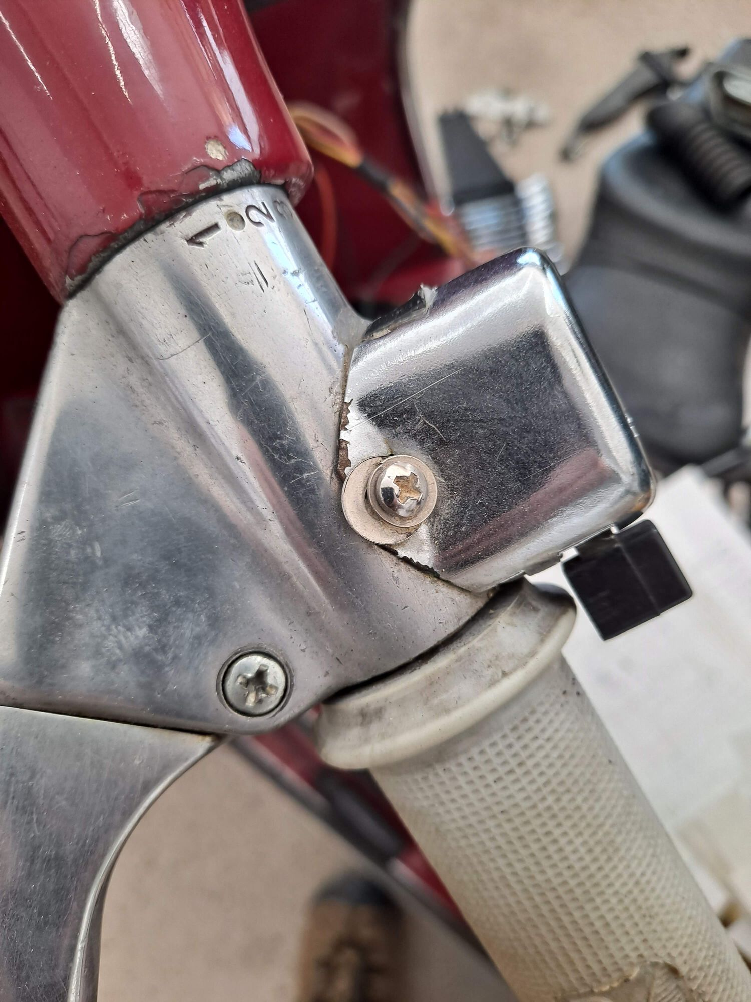

I couldn't find a decent turn signal switch back then, so this is a cheap substitute I was able to source, crudely screwed into the handlebar.

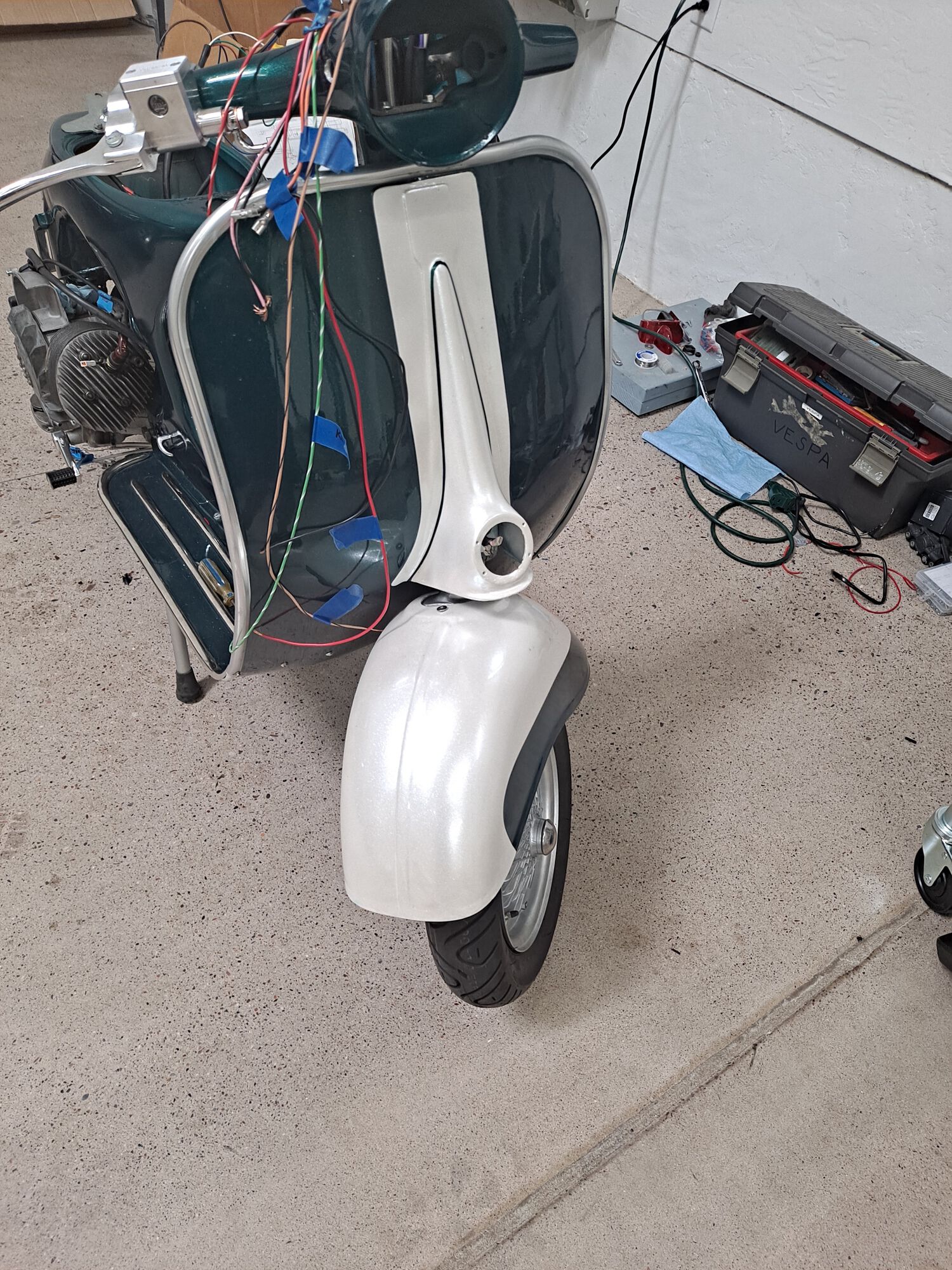

starting to catalog all the wiring and re-acquaint myself with this nonsense.

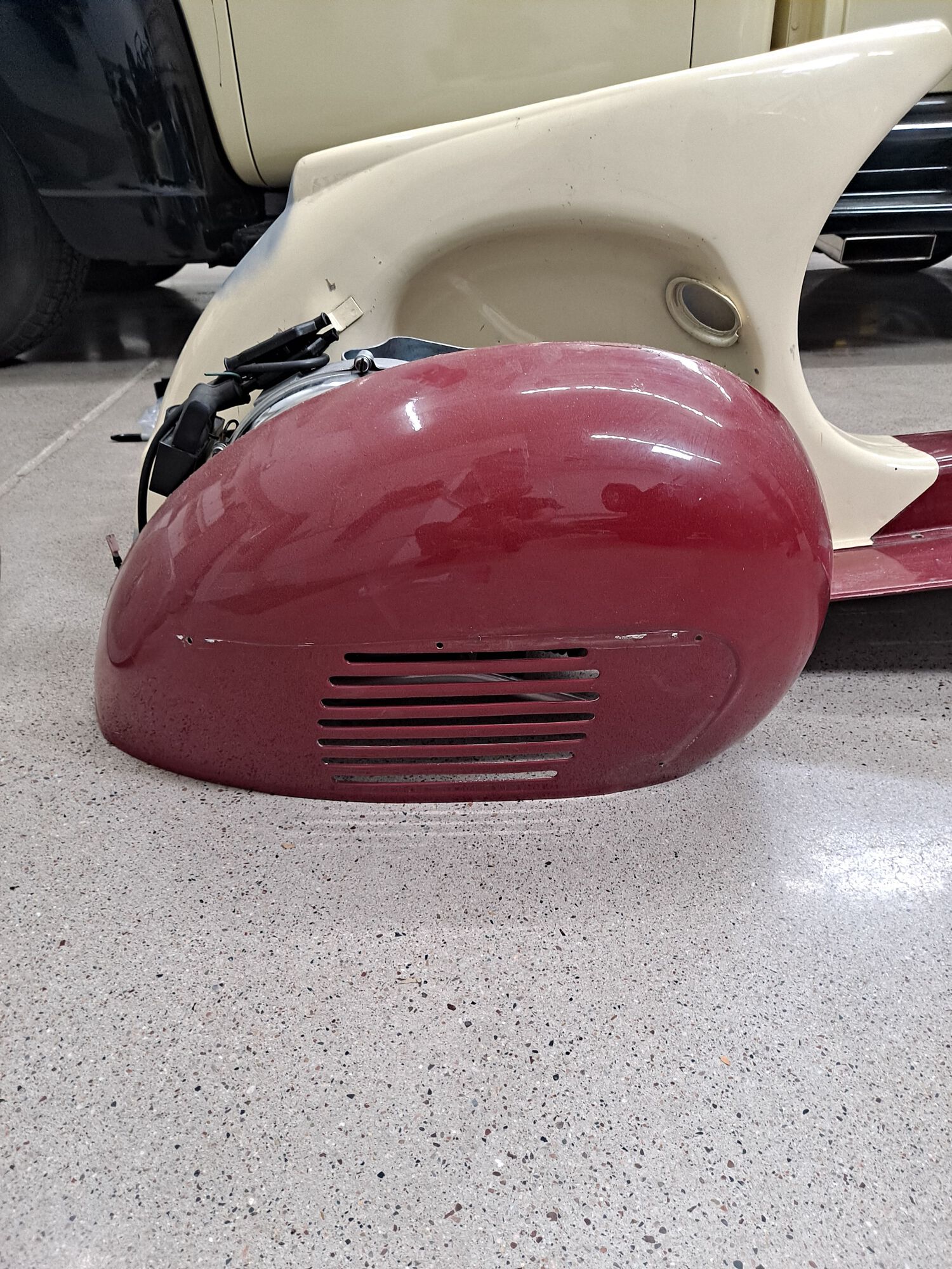

Getting a good look at the strange mounting job I did with the VBB fender on the PK fork

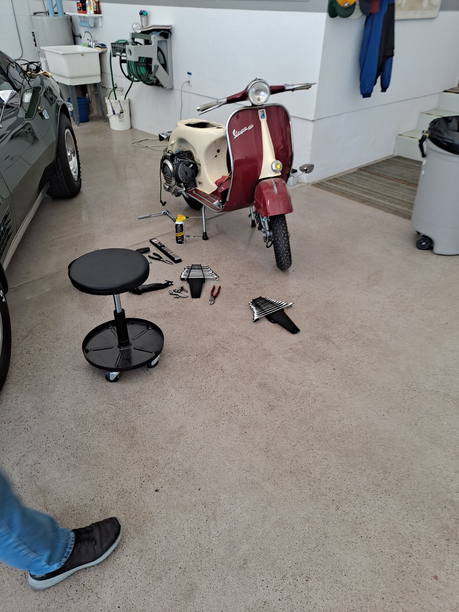

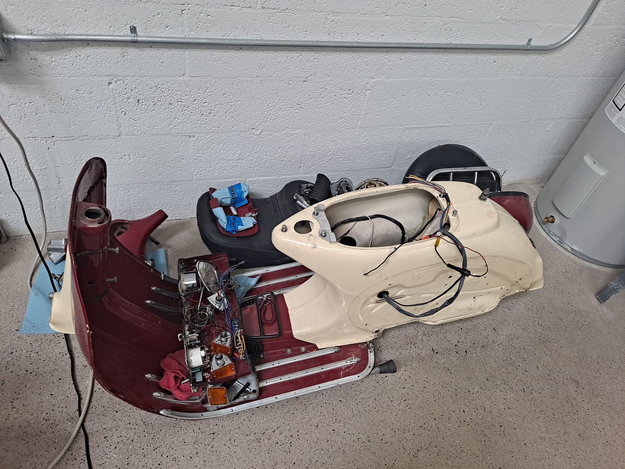

Stripping it down
Stripping it down

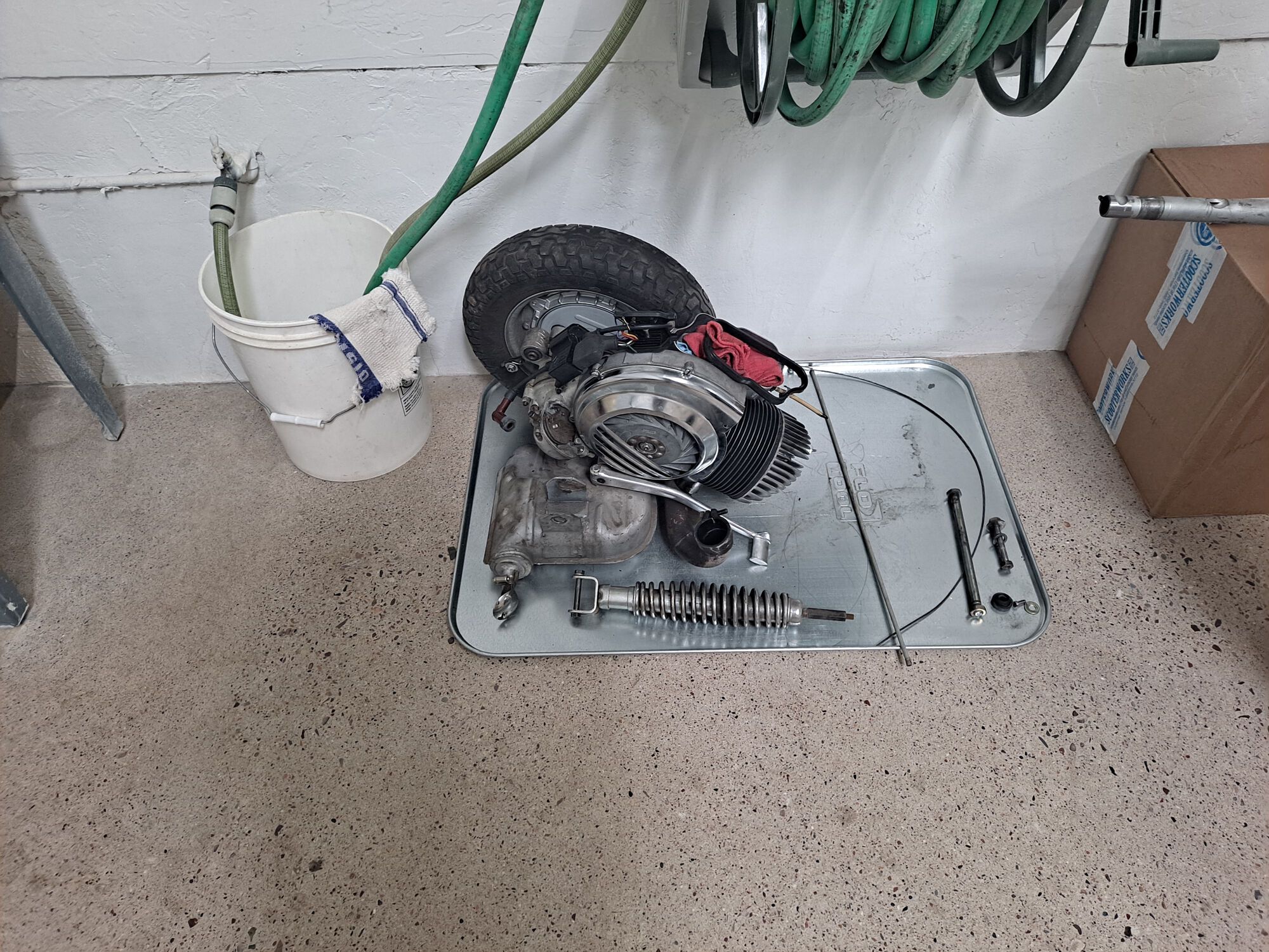

Motor out, and it's still in good shape.  It'll have to be rebuilt sometime in the not-so-distant future, but that's a future problem.  At least now it has a new cosa clutch and upgraded ignition.

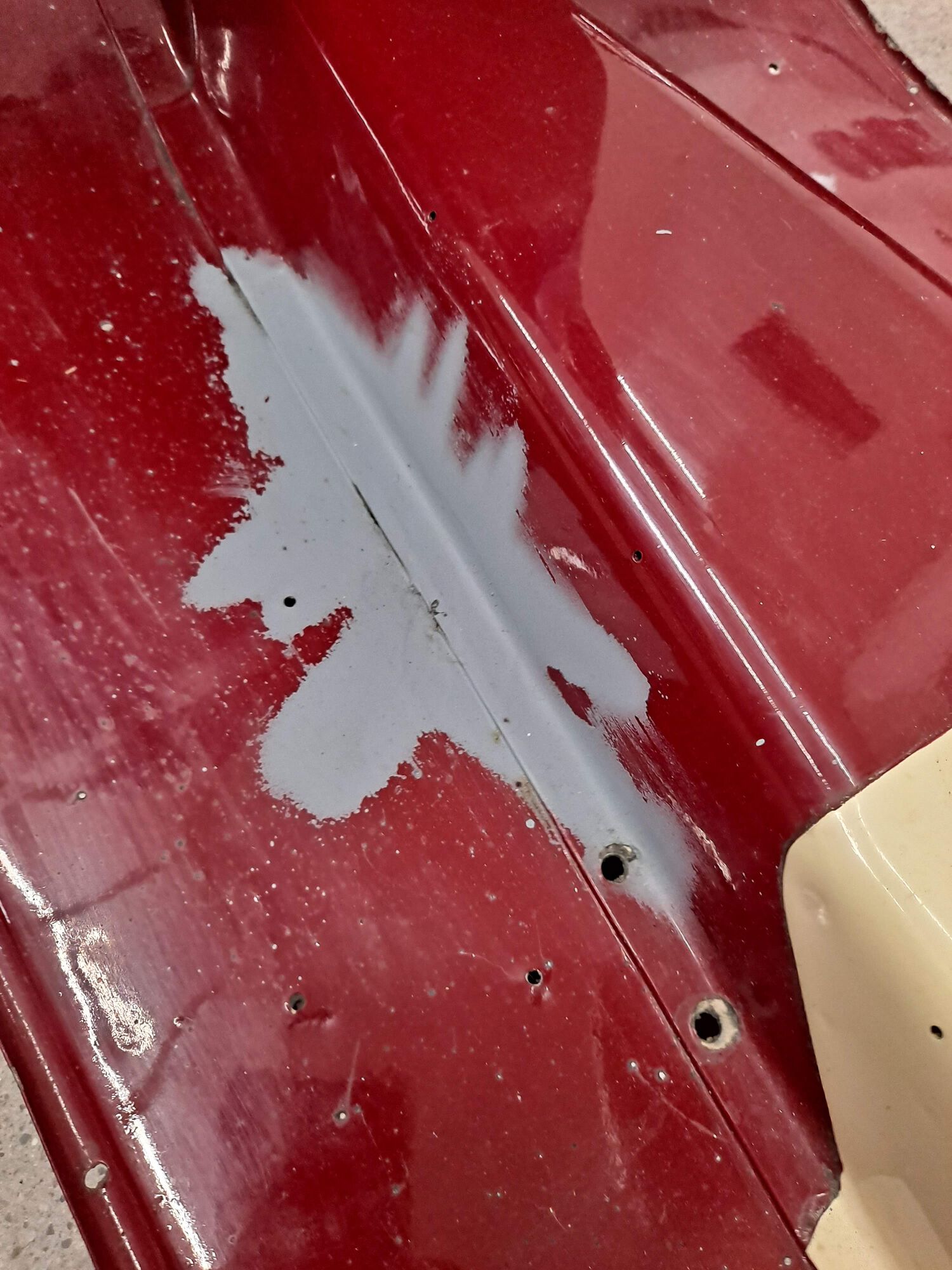

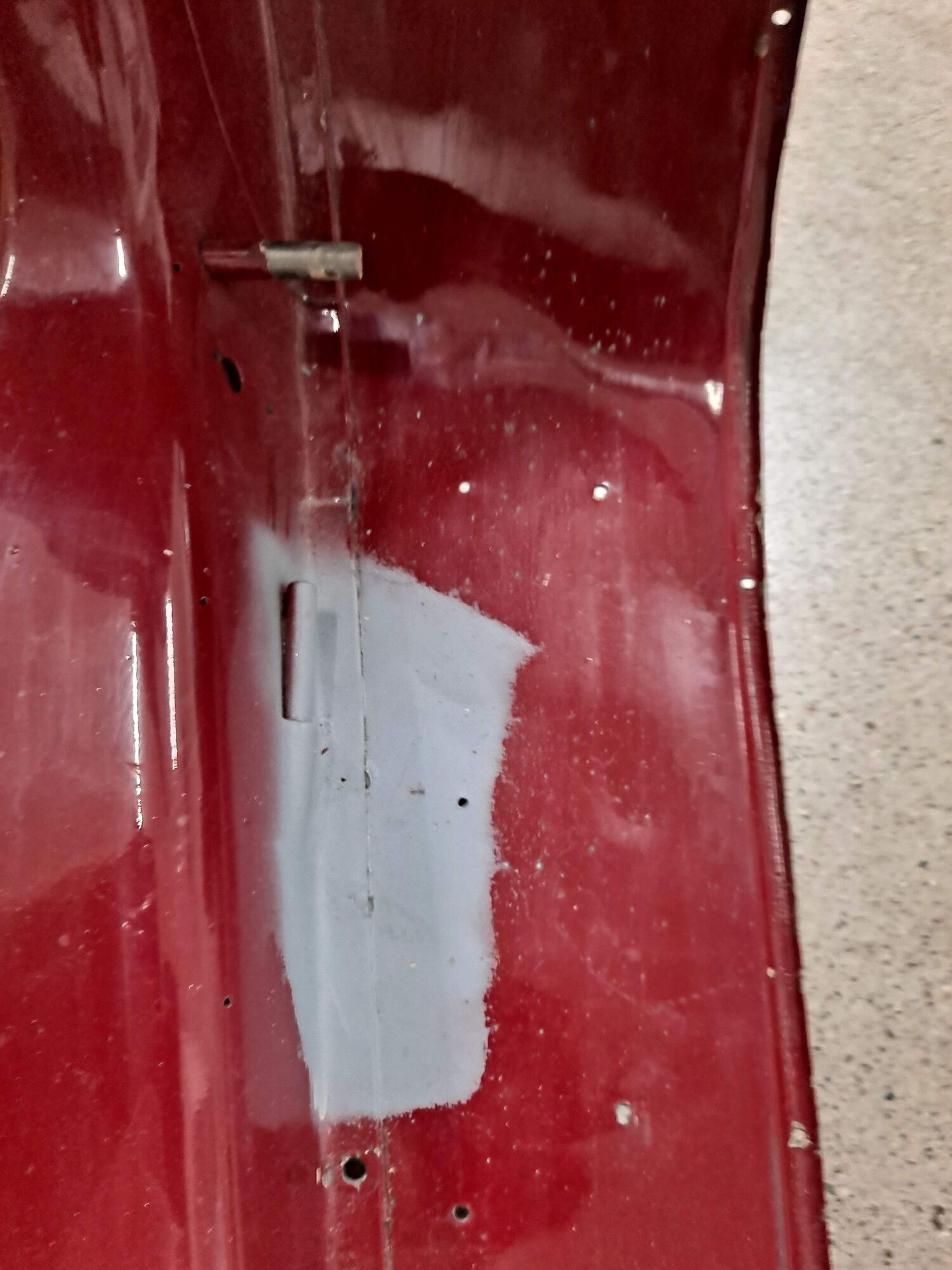

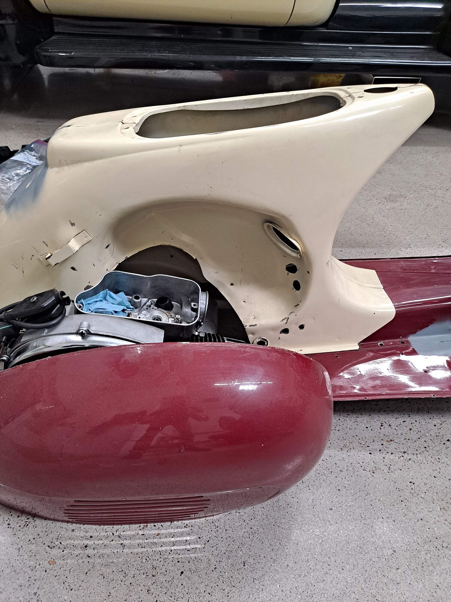

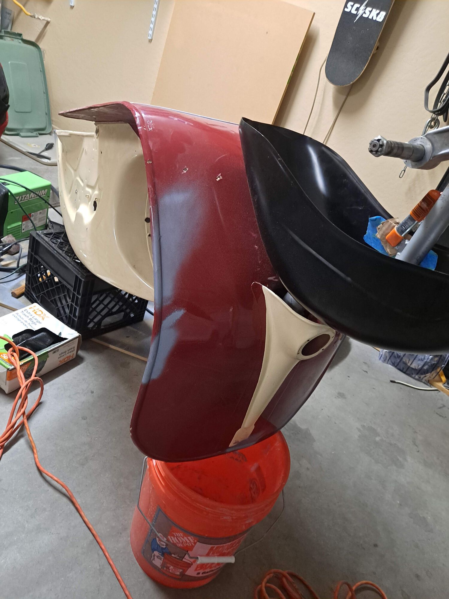

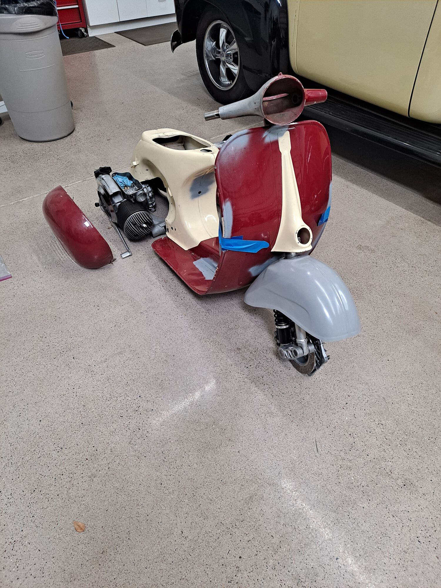

Trying a different fender.  This time an aftermarket Rally mudguard, but it's not what I wound up using in the end.  Still trying to figure that out in this photo, working on making the mounting work without rubbing against the body.
Realizing at this point that the side mounting would be still problematic without further surgery on the fork.
Realizing I wanted to go fully hydraulic and not use the semi-hydraulic kit that was already a little corroded.  I tried a couple options but this kit from Scooter Center was the right choice.

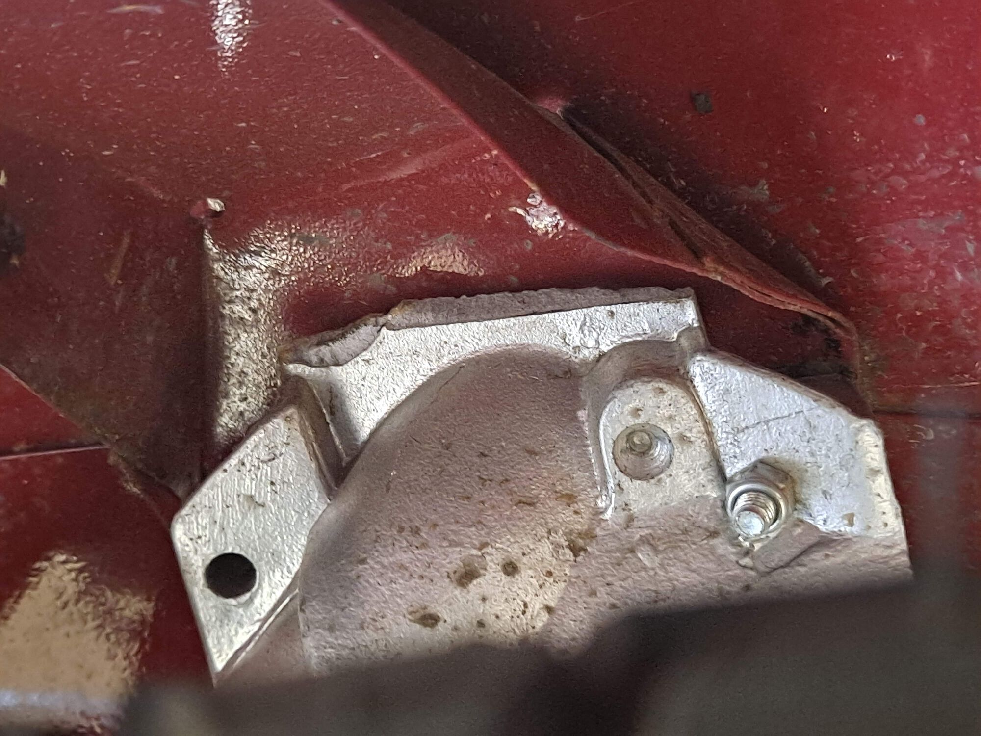

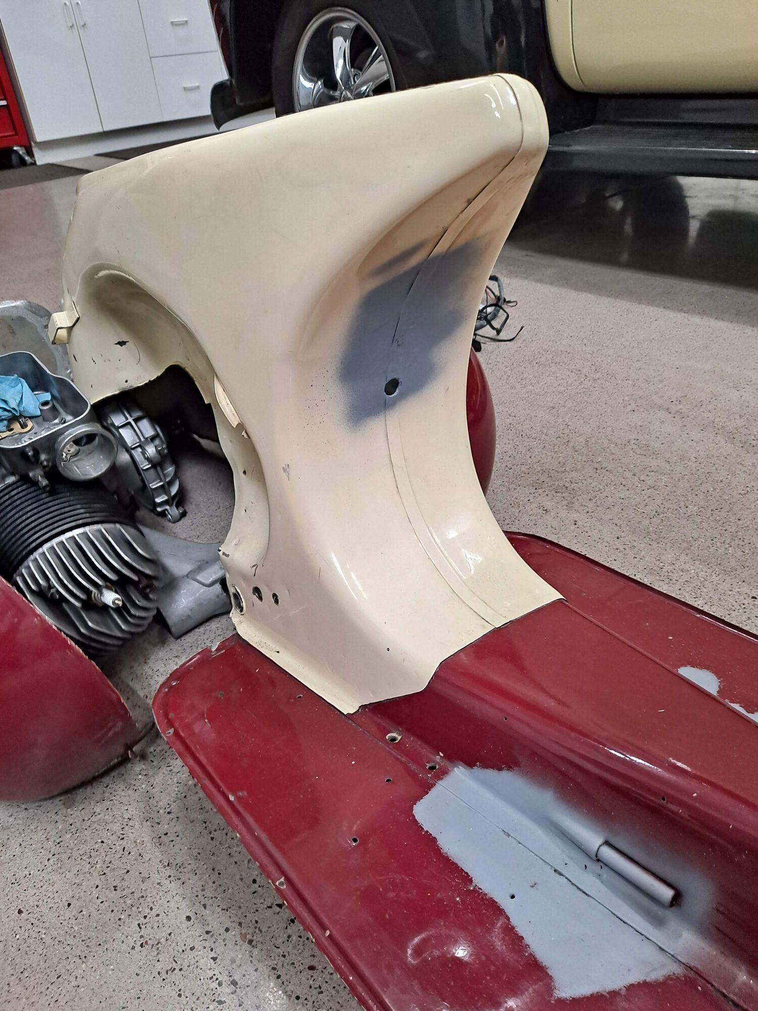

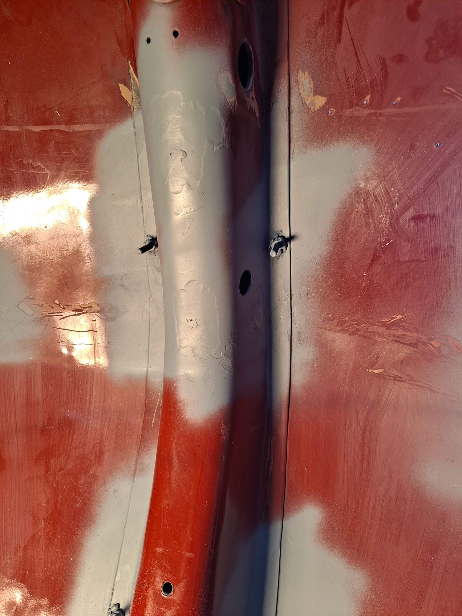

Fixing the issue I had before with missing steering stops.  This was my first attempt at getting things lined up correctly before officially fixing blocks to the column.

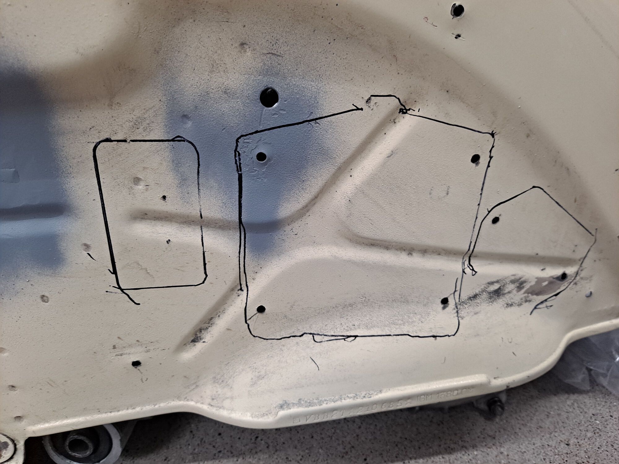

Welding up holes and laying out where the battery tray, voltage regulator, and other wiring will go in the side glovebox

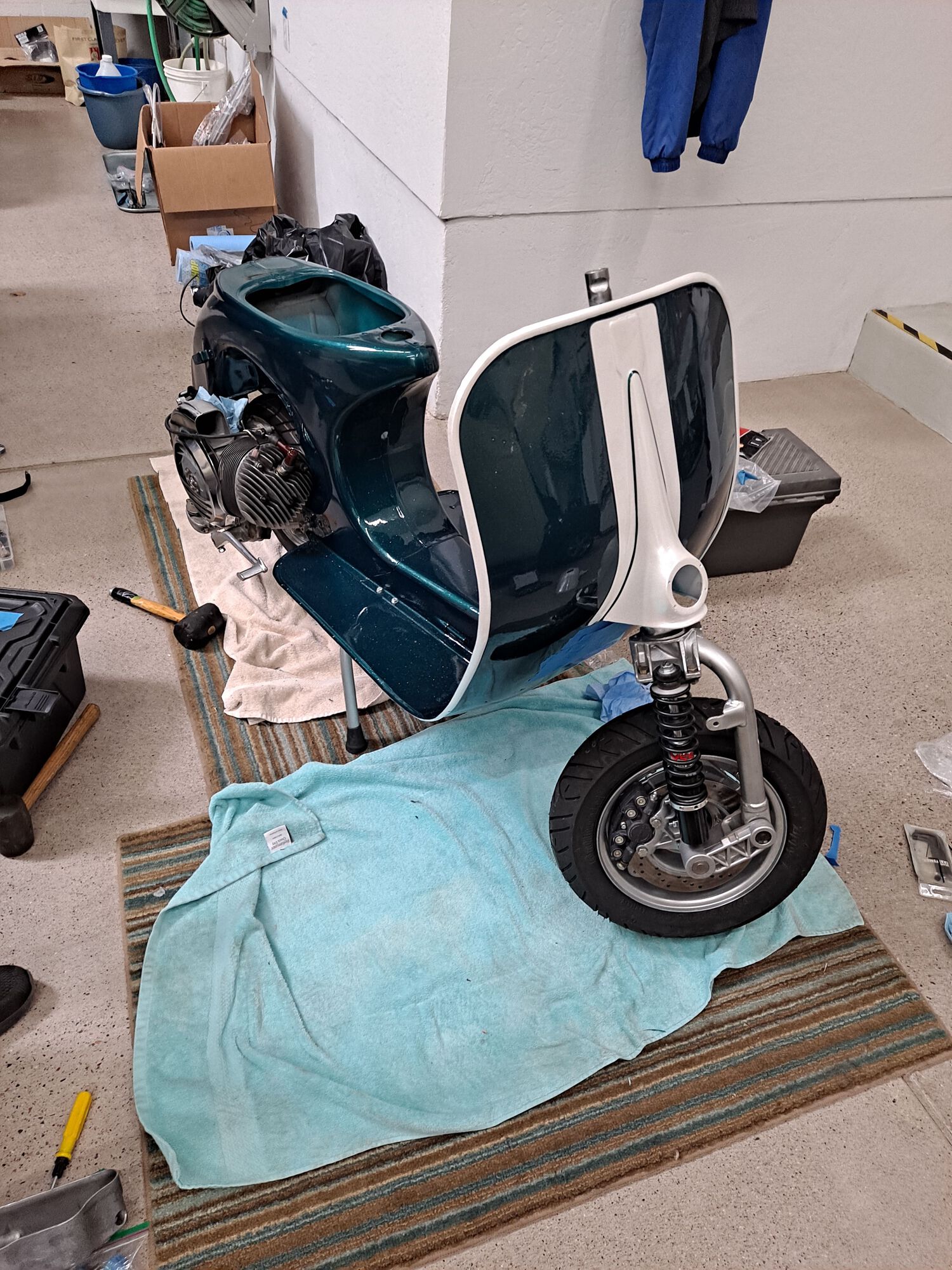

Starting to dry fit
Starting to dry fit

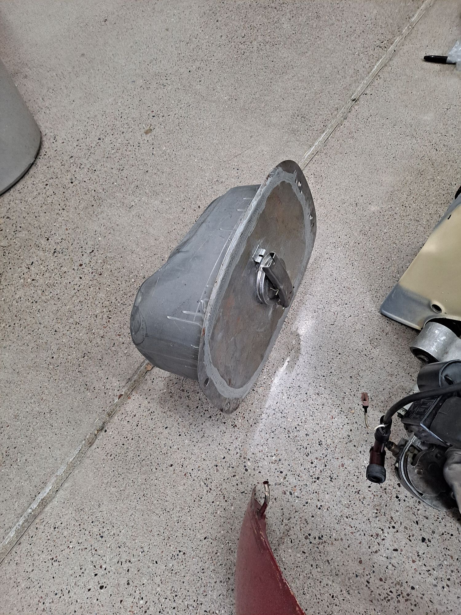

Shiny new tank.  The original one had been hacked up with a generic fuel gauge sender and my welding skills were no match for thin, abused steel.

My first attempt to drill a hole for the hydraulic brake line was poorly placed, so I removed the paint off that side of the headset to fill the hole and do it right.

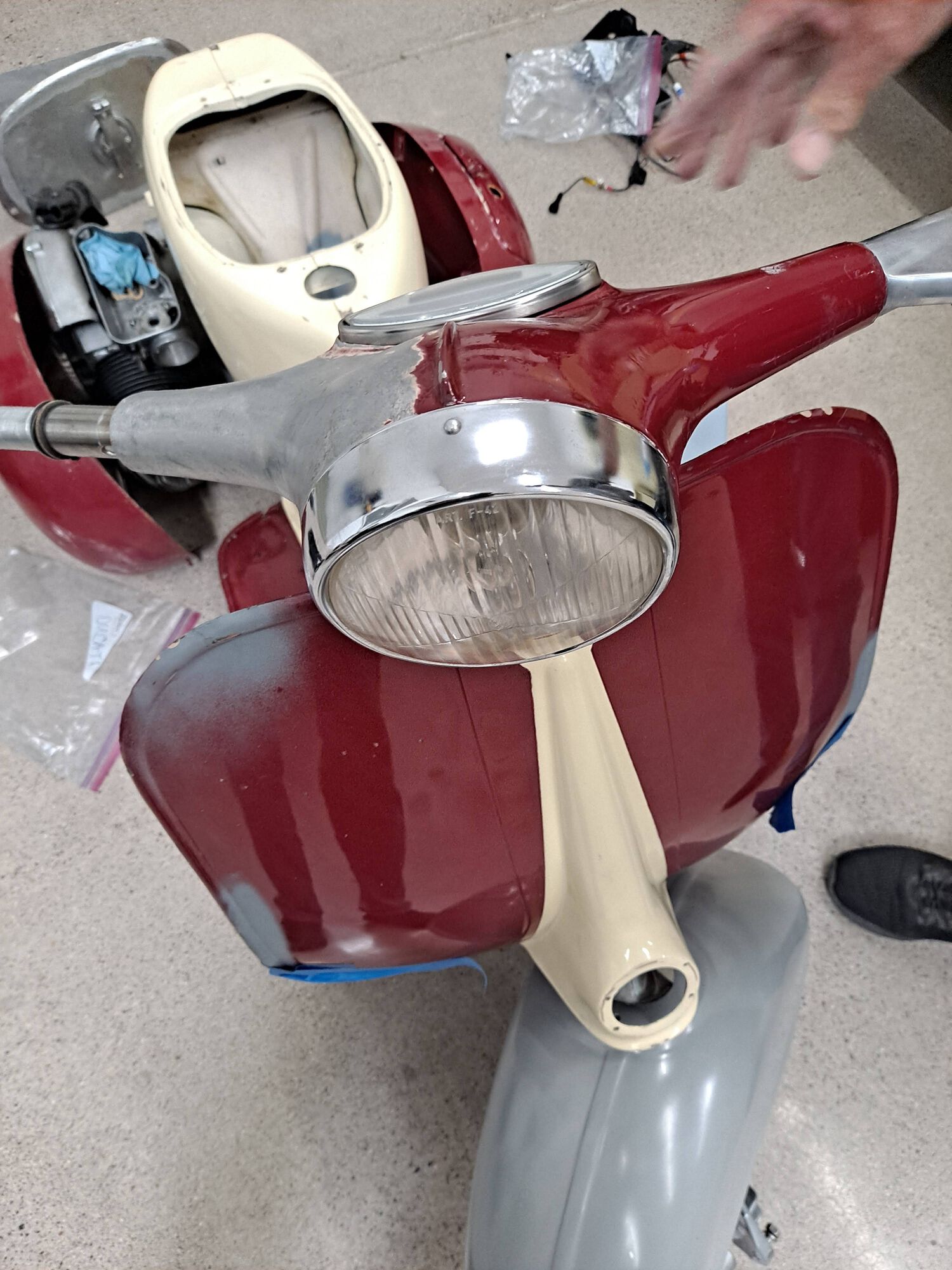

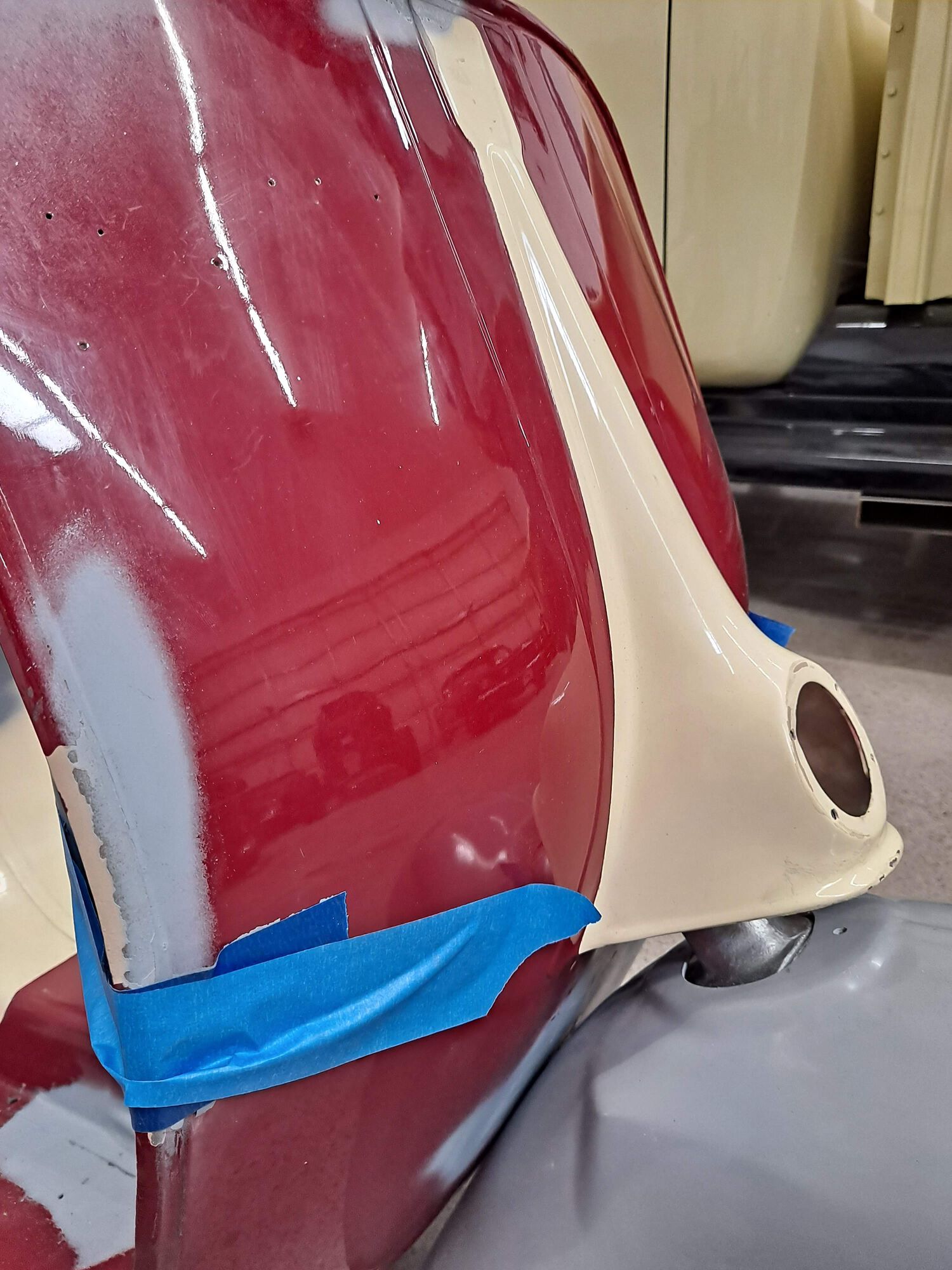

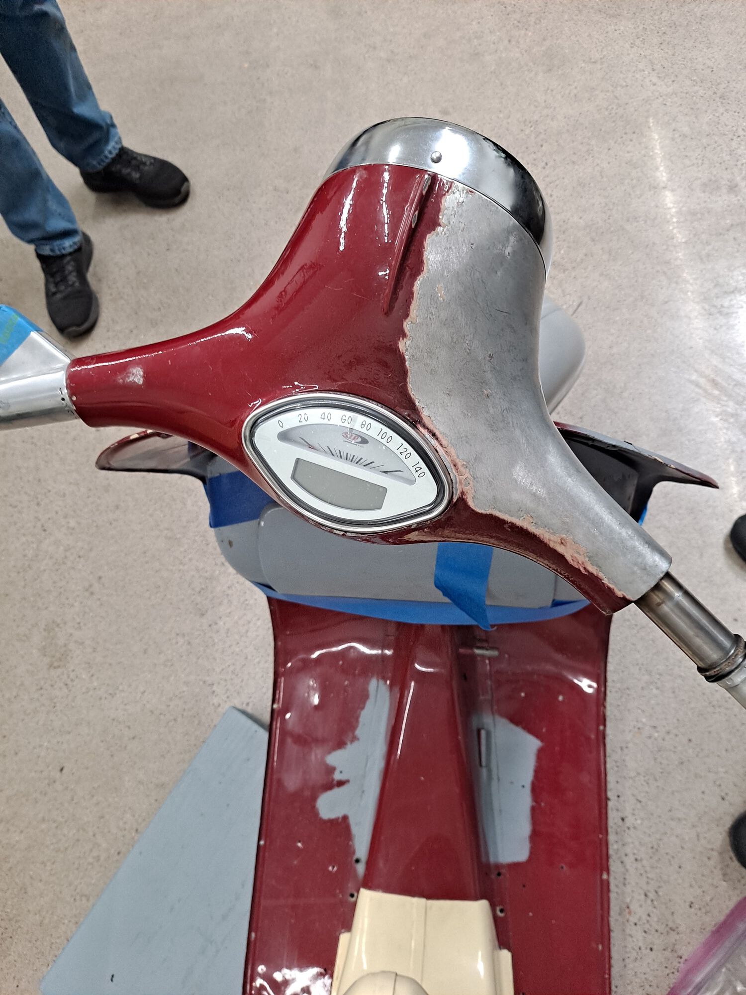

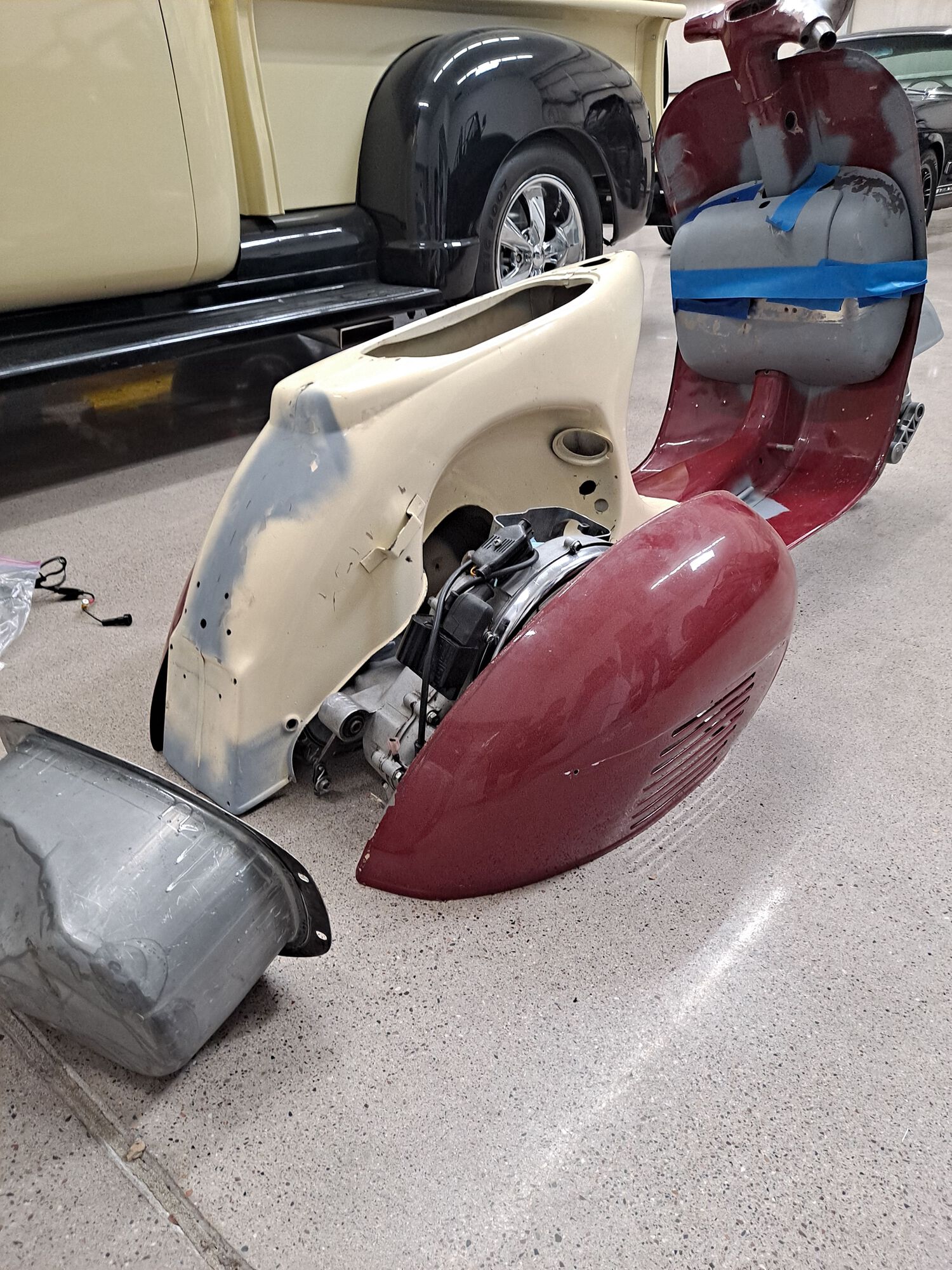

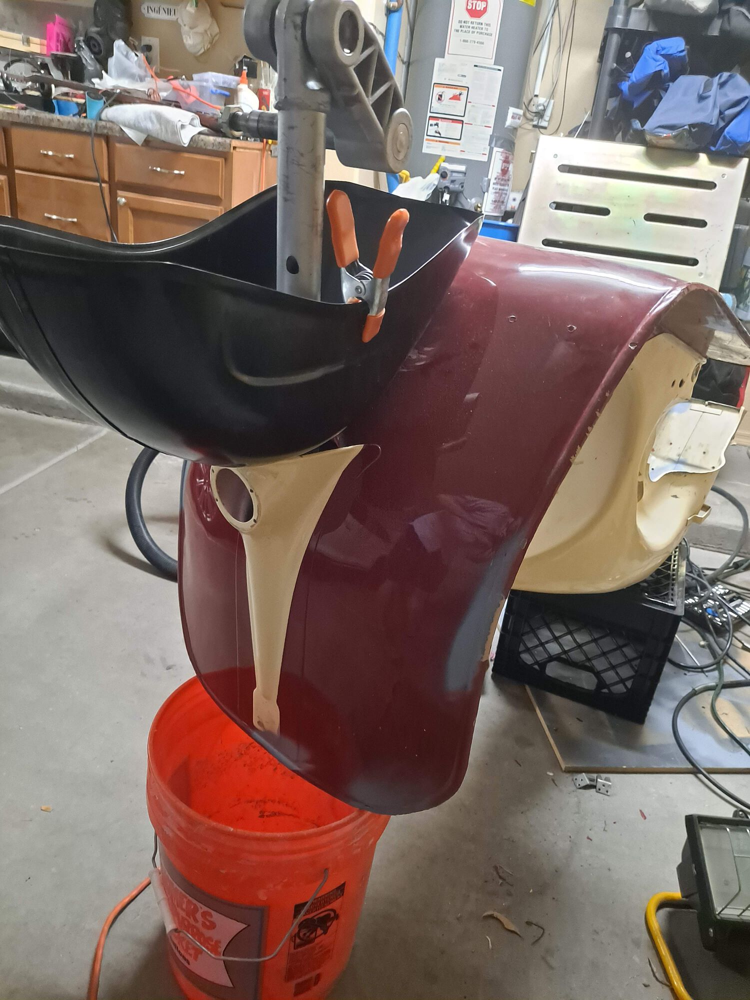

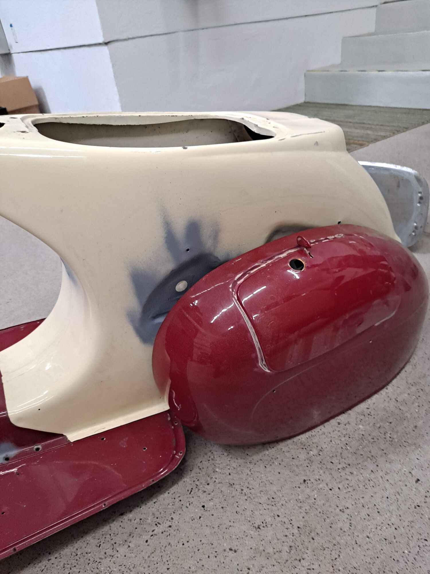

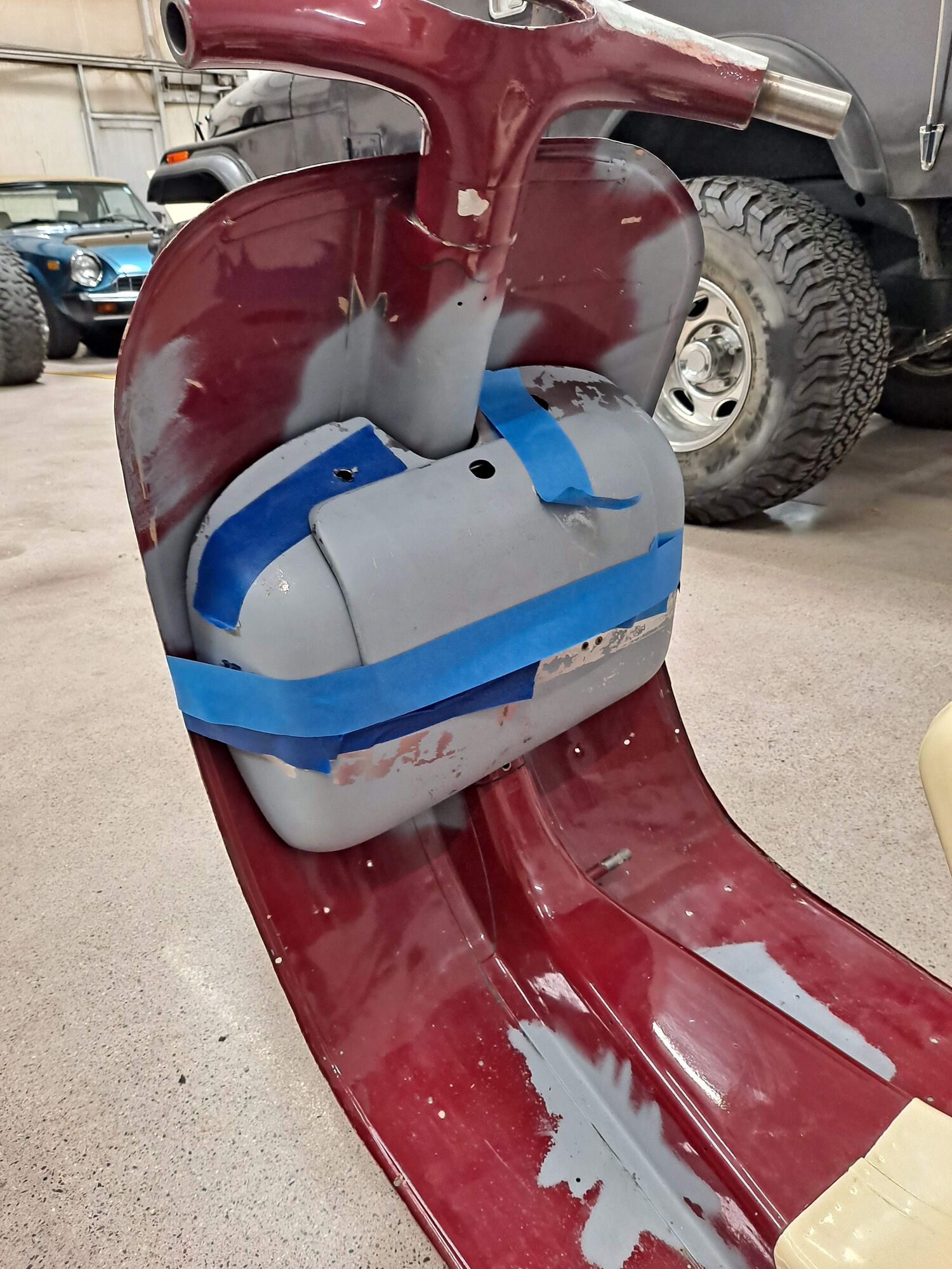

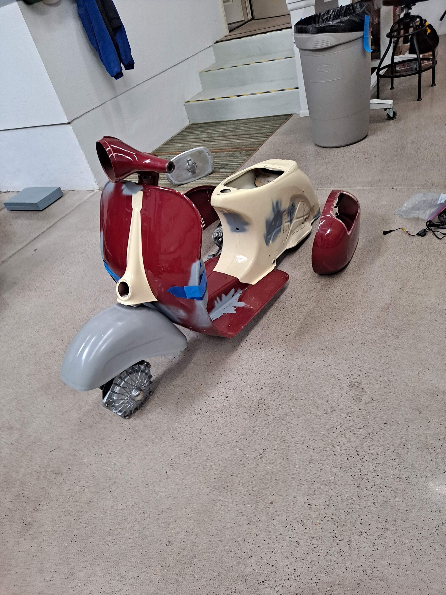

Fast forward to a full repaint.  This was an adventure and a half, resulting in the painter completely ghosting us despite doing the fender wrong.  We'll fix that in some upcoming shots.
The lack of mudguard here shows we're working on something.  Basically, the painter took some liberties in making everything 2-tone except for a fully white mudguard that just didn't look right.  Dry fitting without it for now.

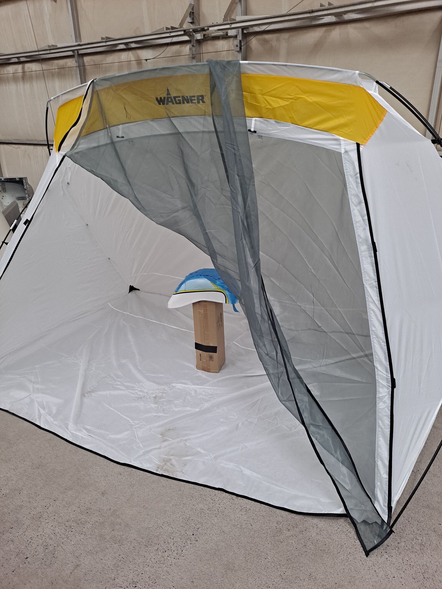

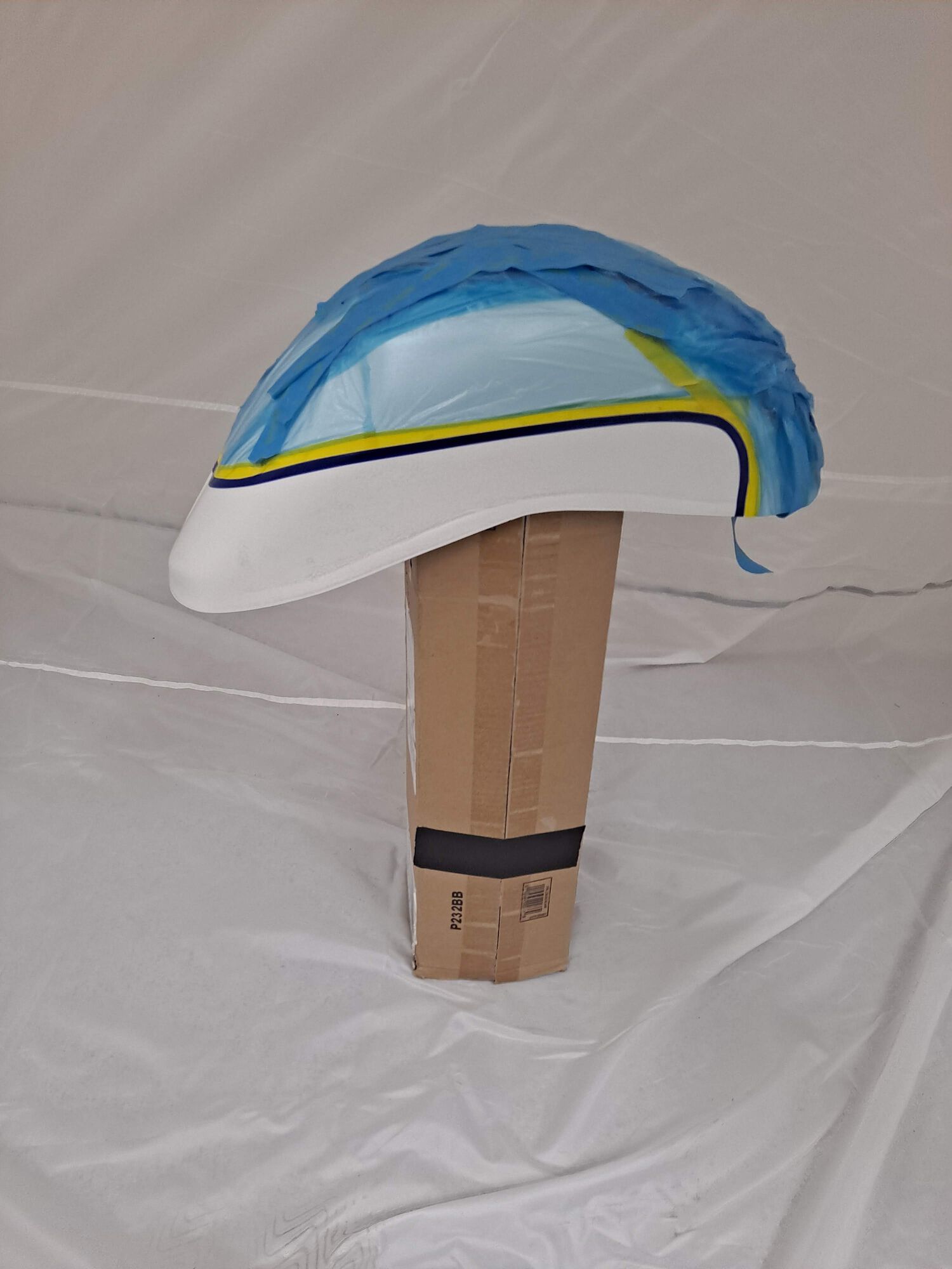

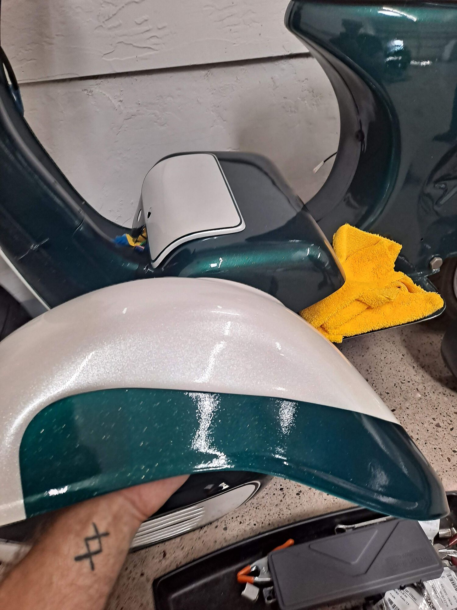

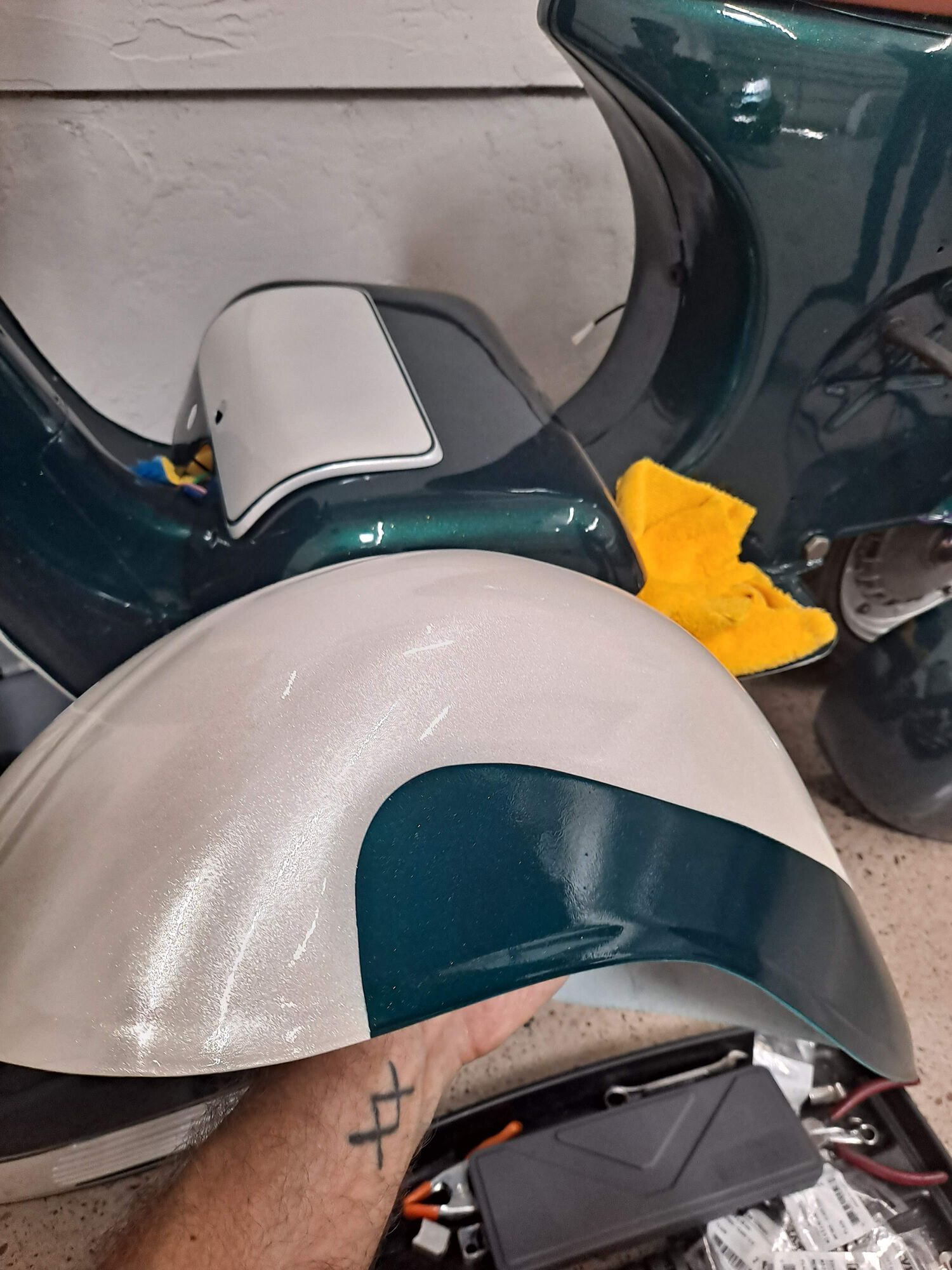

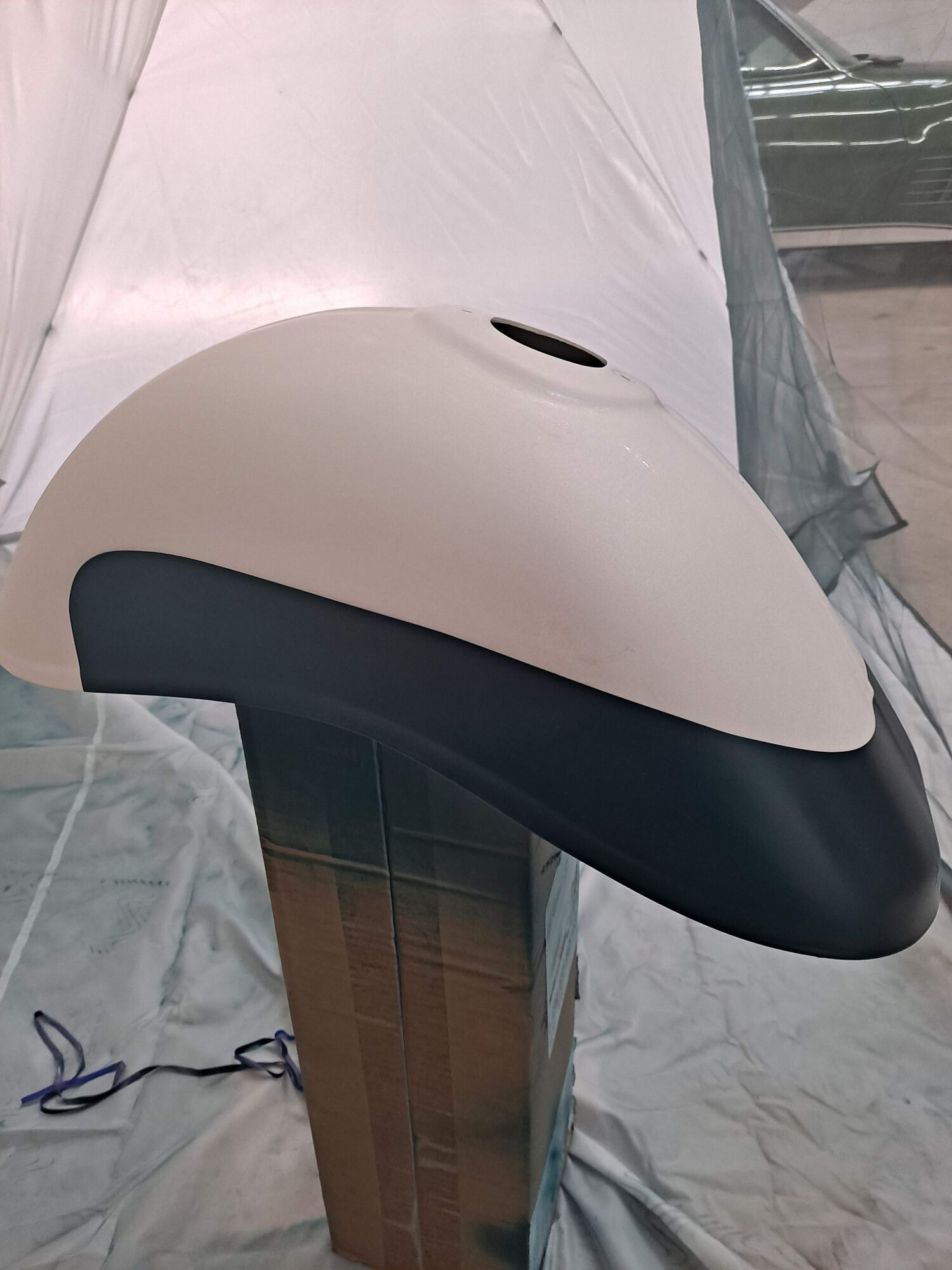

Time to fix the mudguard paint in a cheap paint tent.  Had to find a place that would mix up a near-perfect match since the original painter fell off the face of the earth and never gave me the codes or any touch-up paint.
Sanded back all the clear coat and cleaned the mudguard well before masking off to add the green it was sorely lacking.
Green went on nicely with several coats, and now onto the metalflake clearcoat.
it turned out great.  Kind of wish I'd left a pinstripe masked into it, but I'm happy nonetheless.

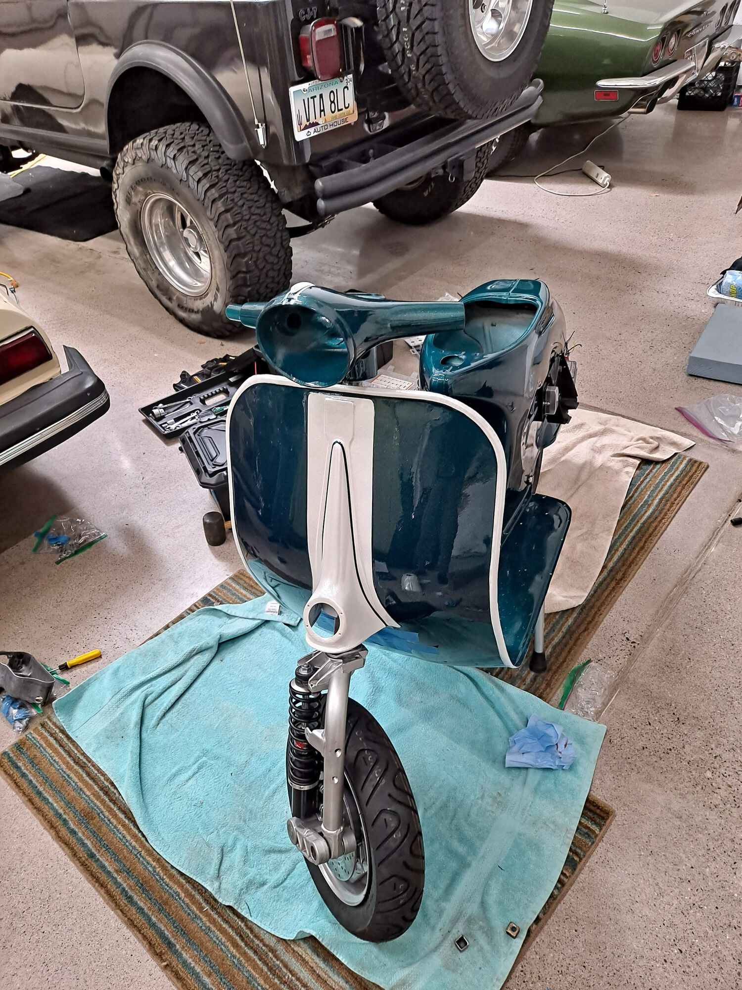

Now it looks like a real bike!

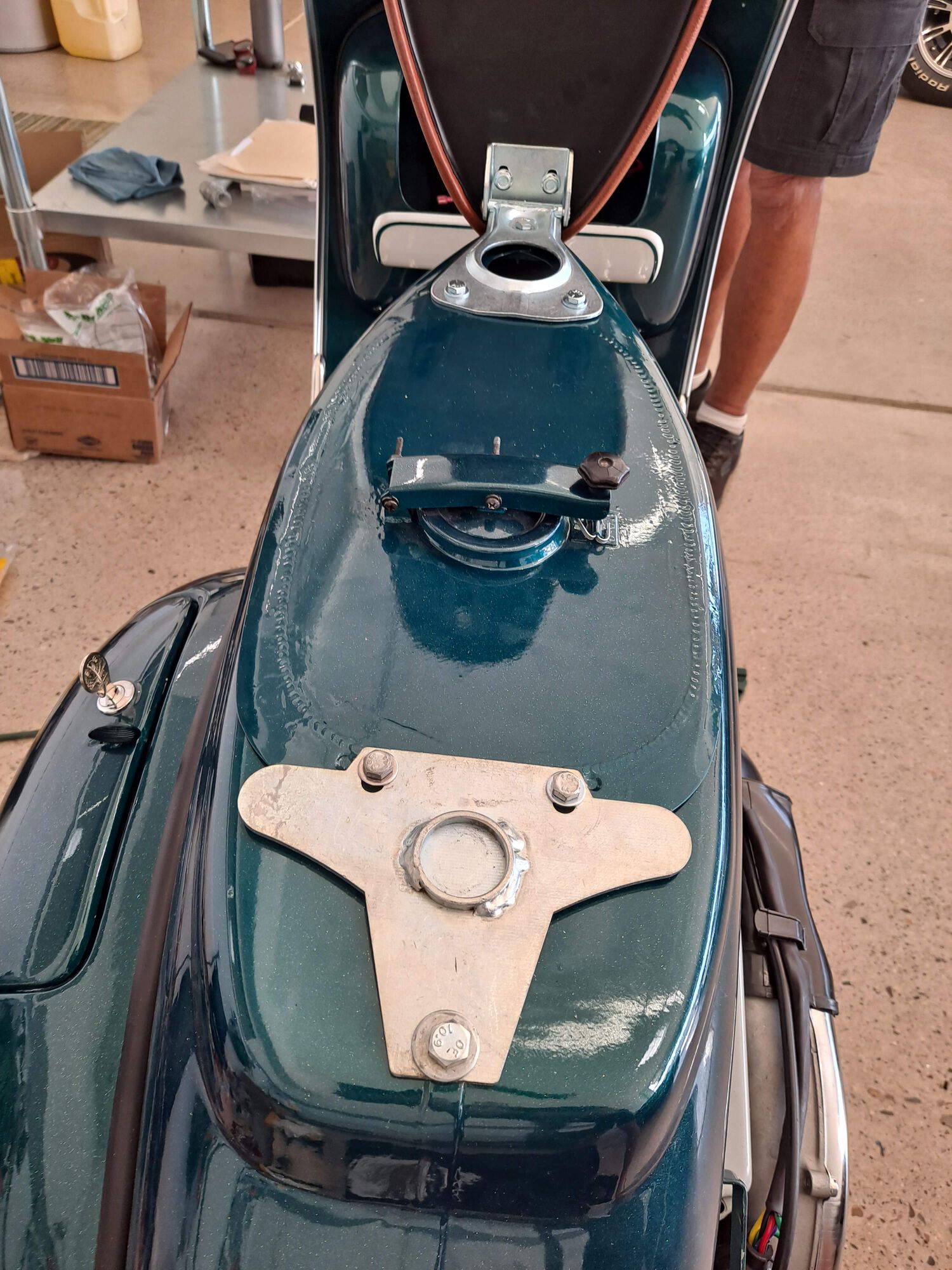

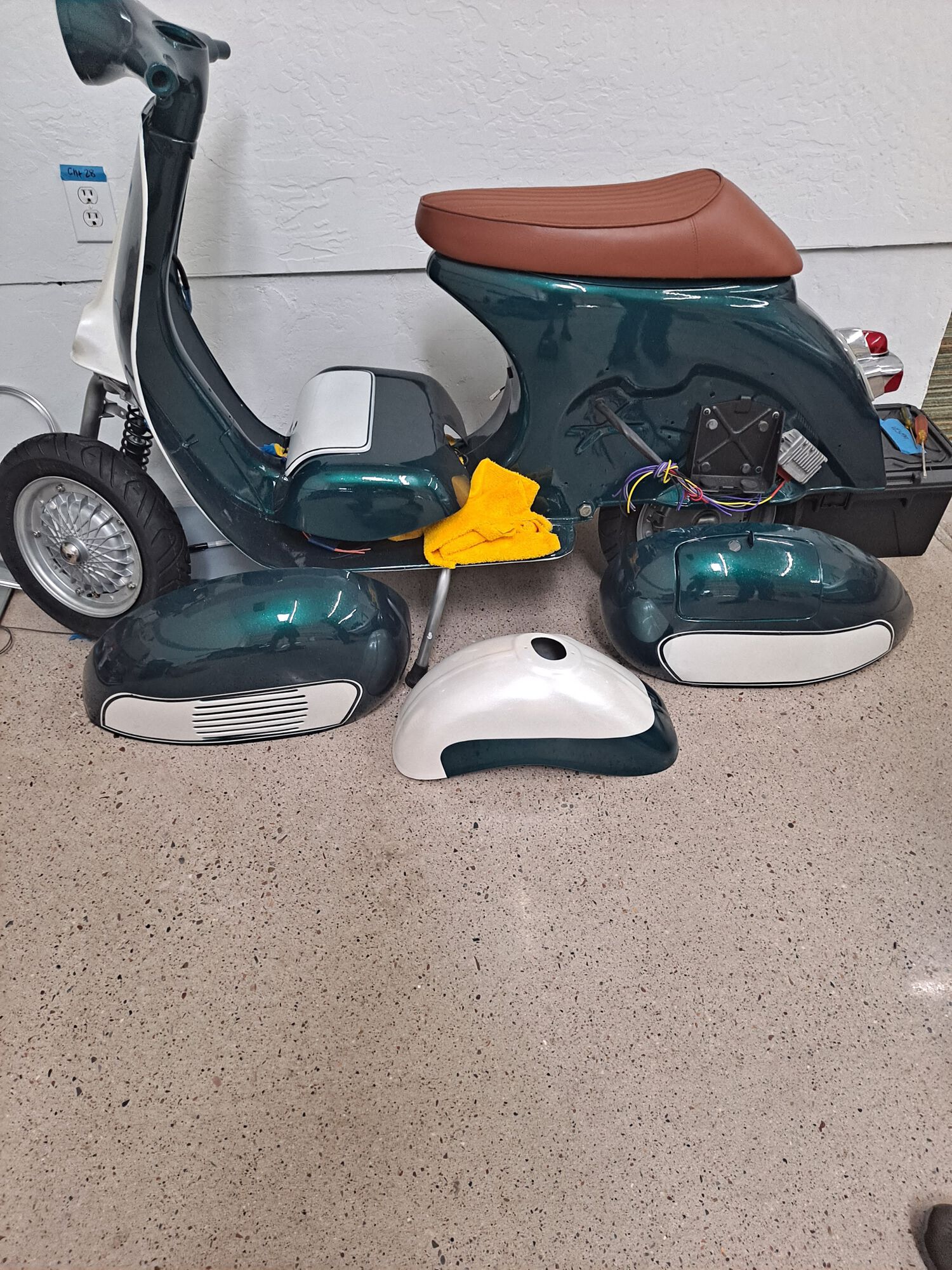

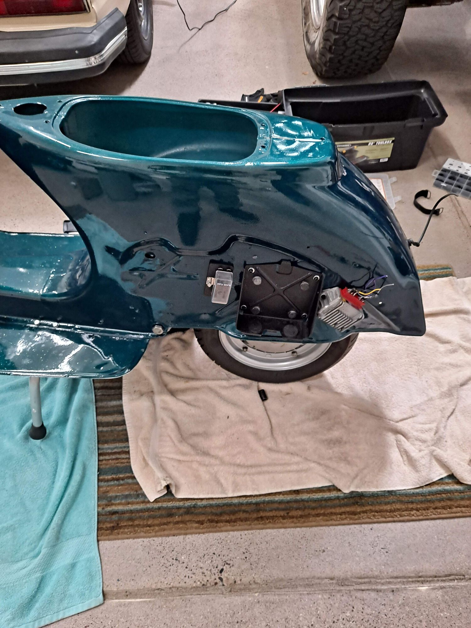

At least the back end of the bike is looking a little tidier

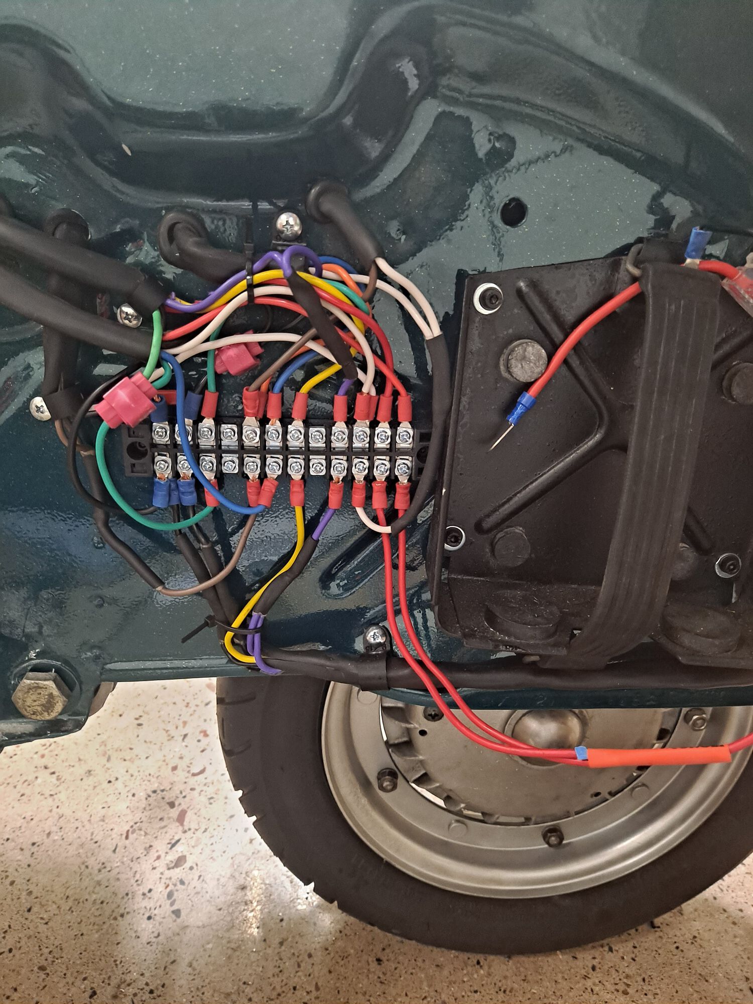

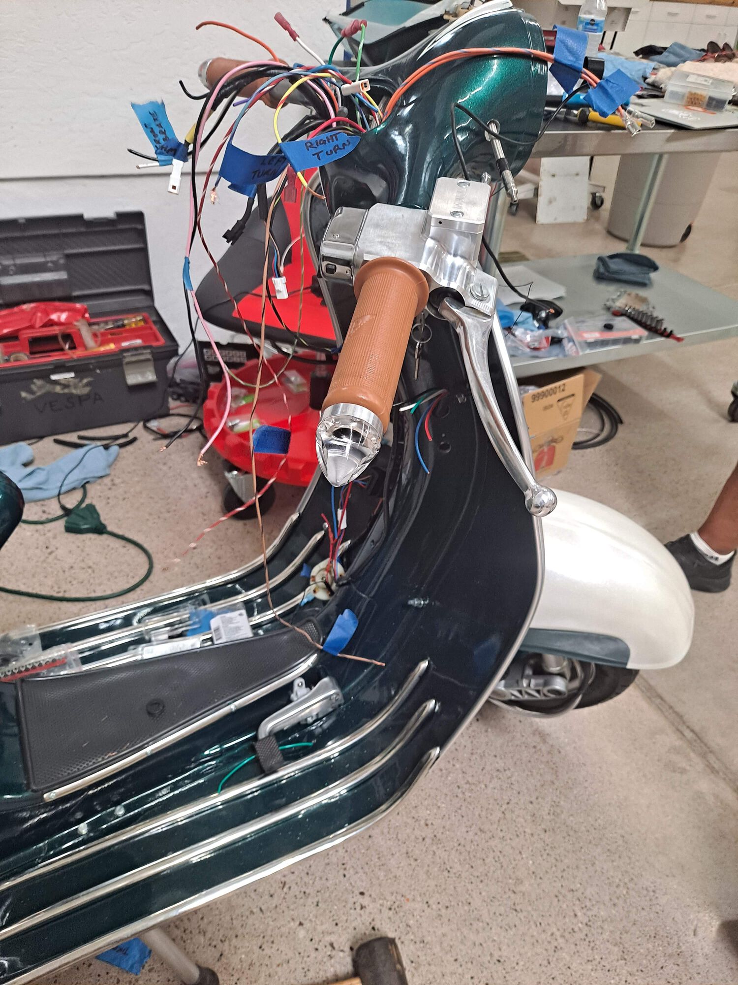

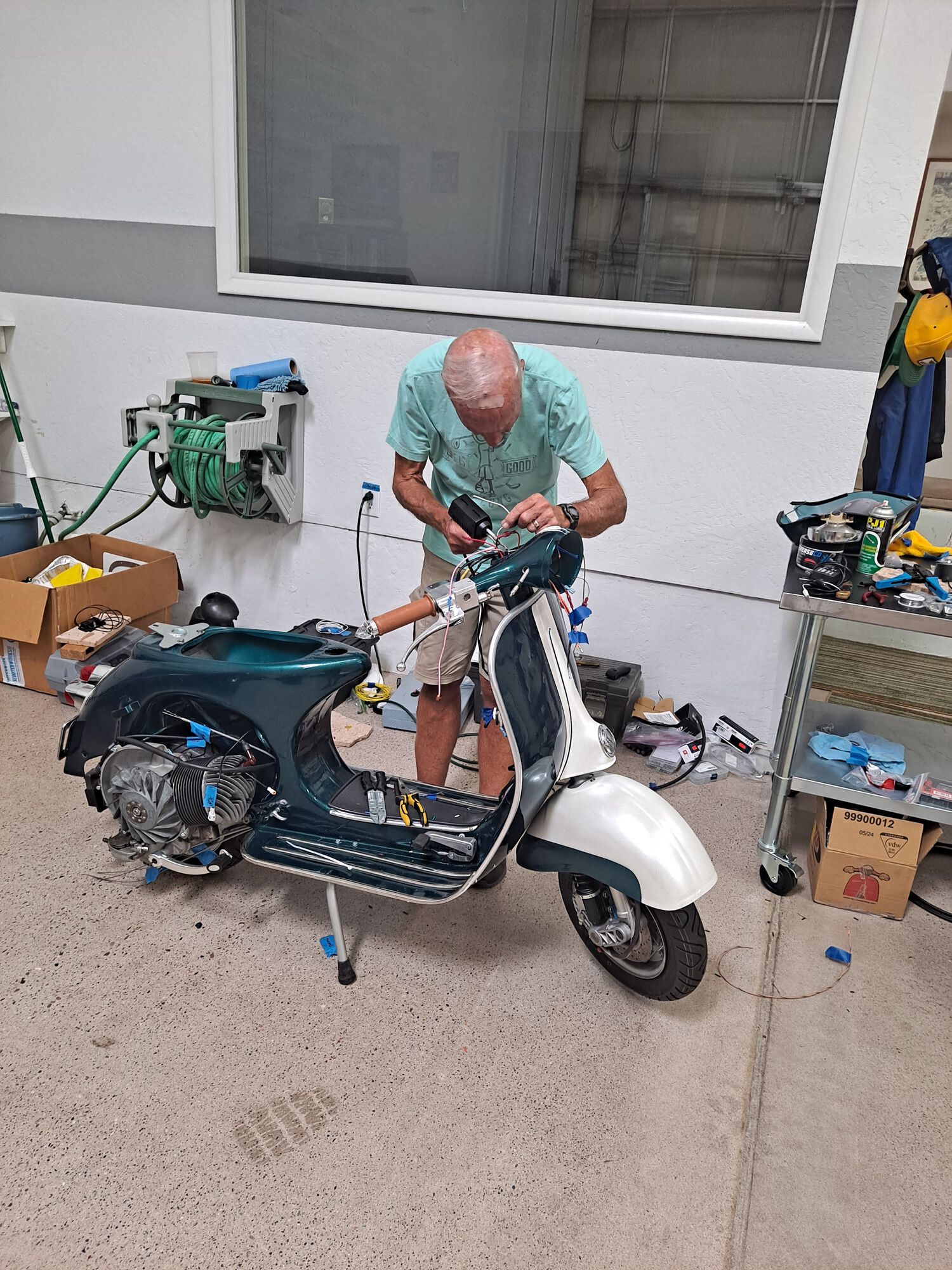

This may have been the 5th, 10th, or 25th time we rewired the headset.  We only took it off a few times, including re-running full cables once

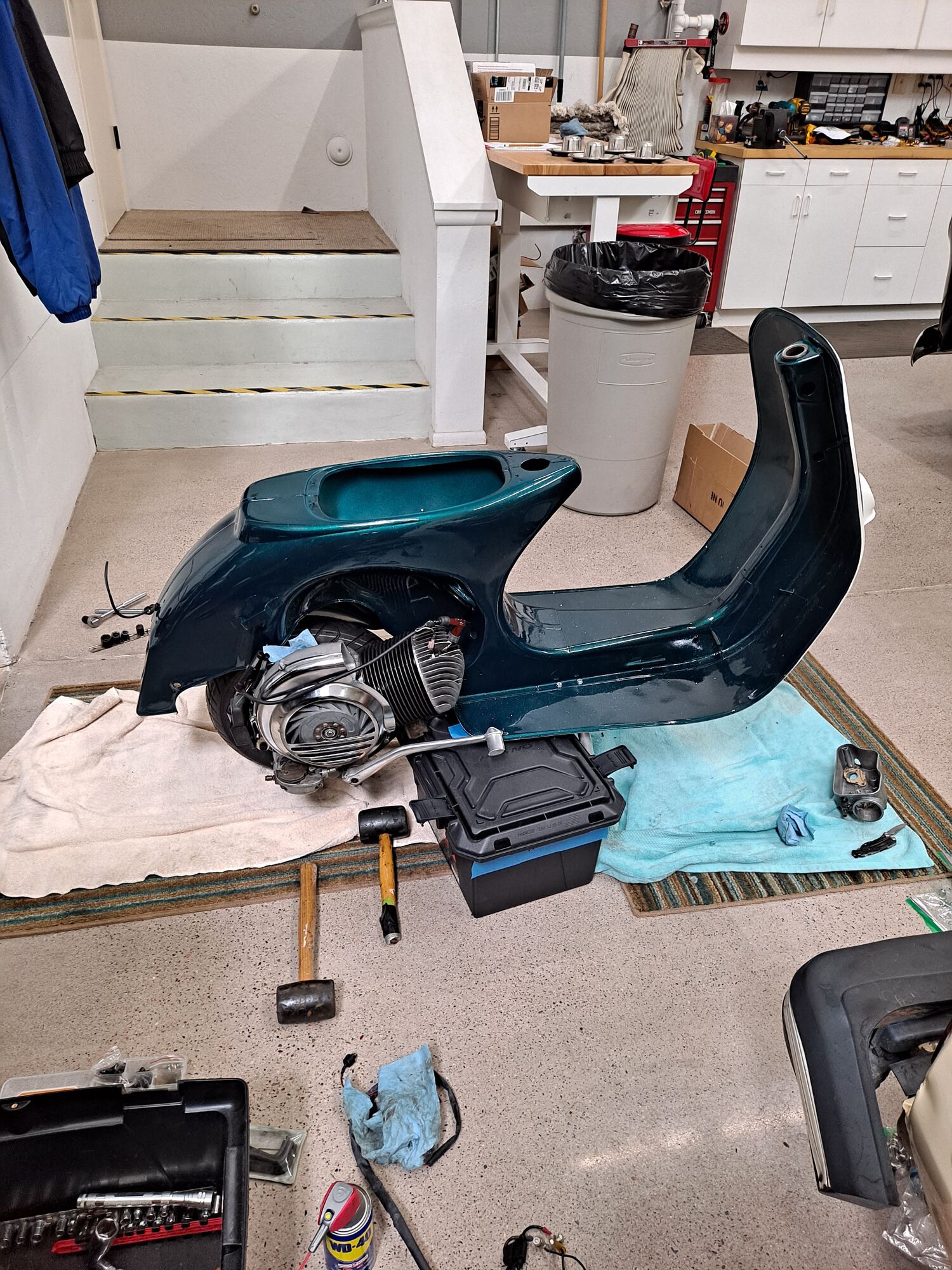

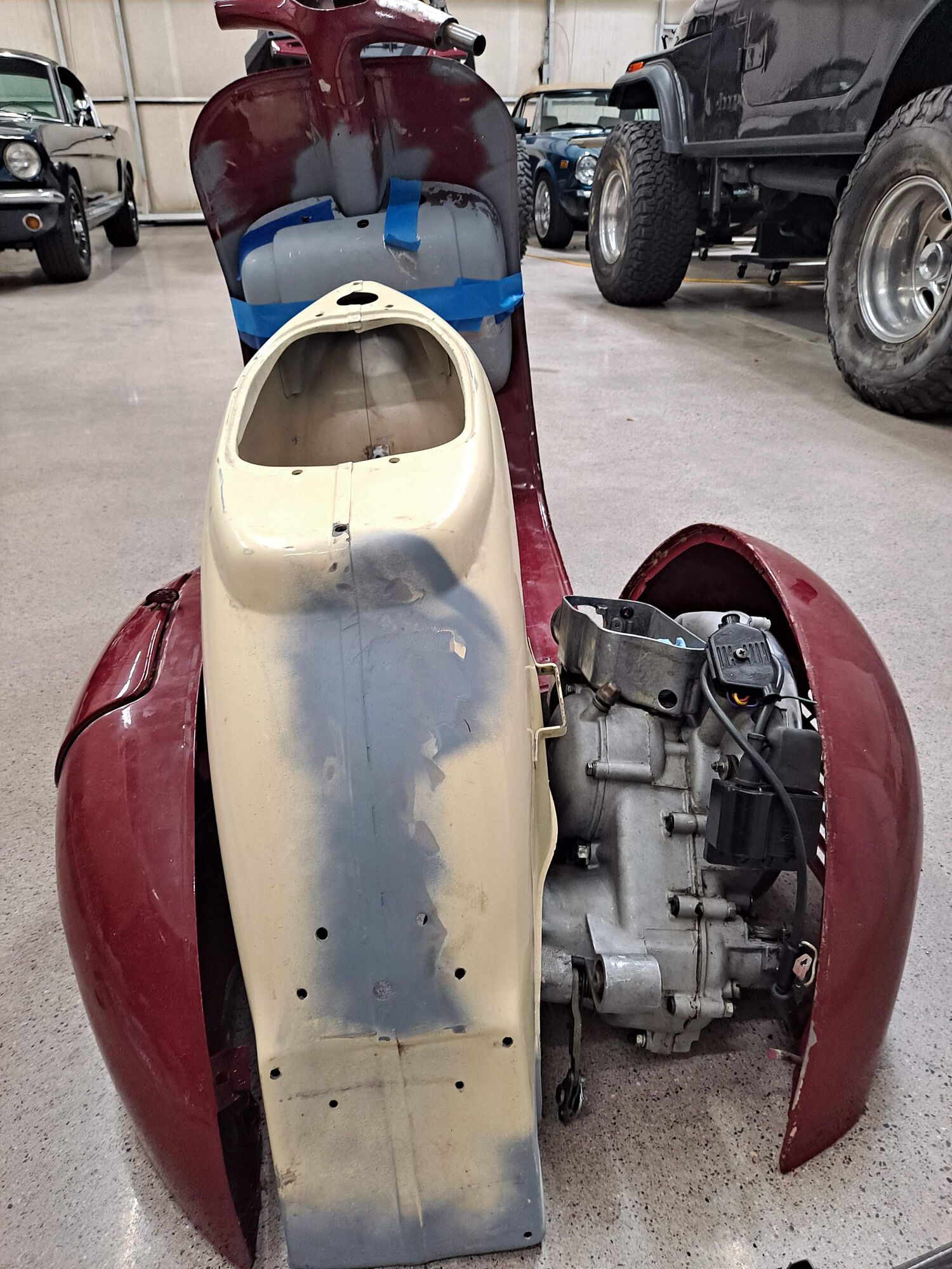

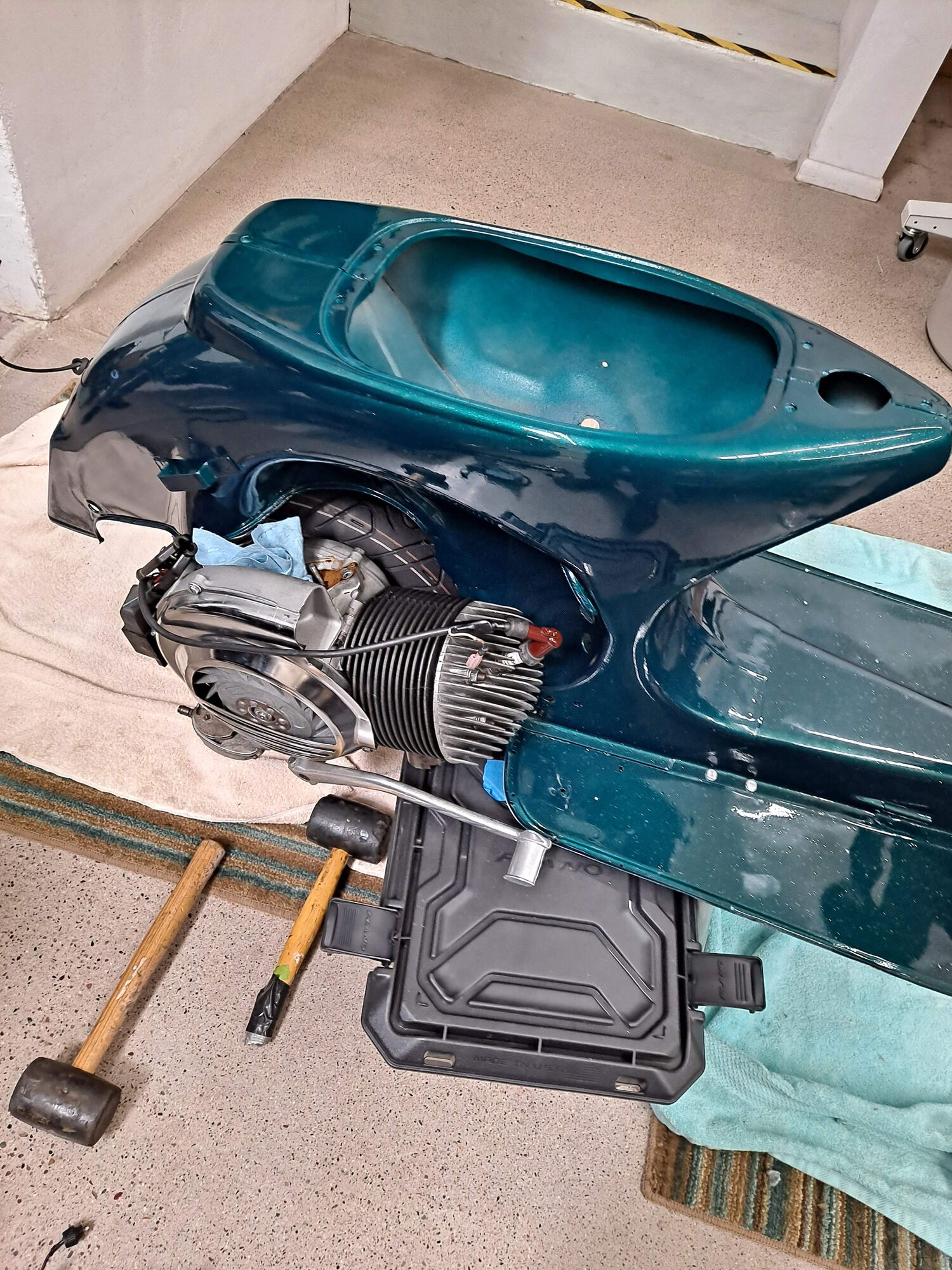

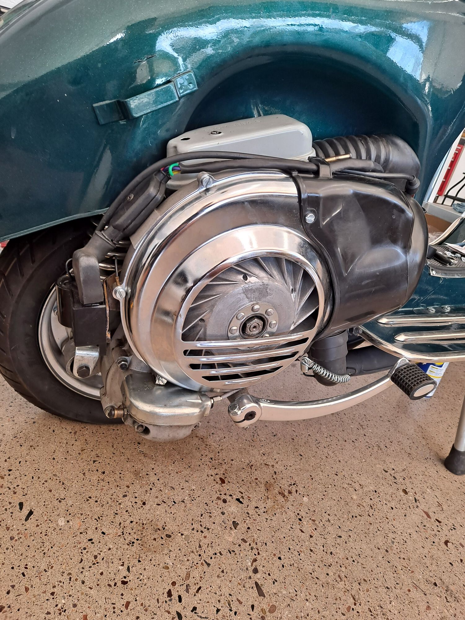

Motor is looking nice in the freshly painted frame

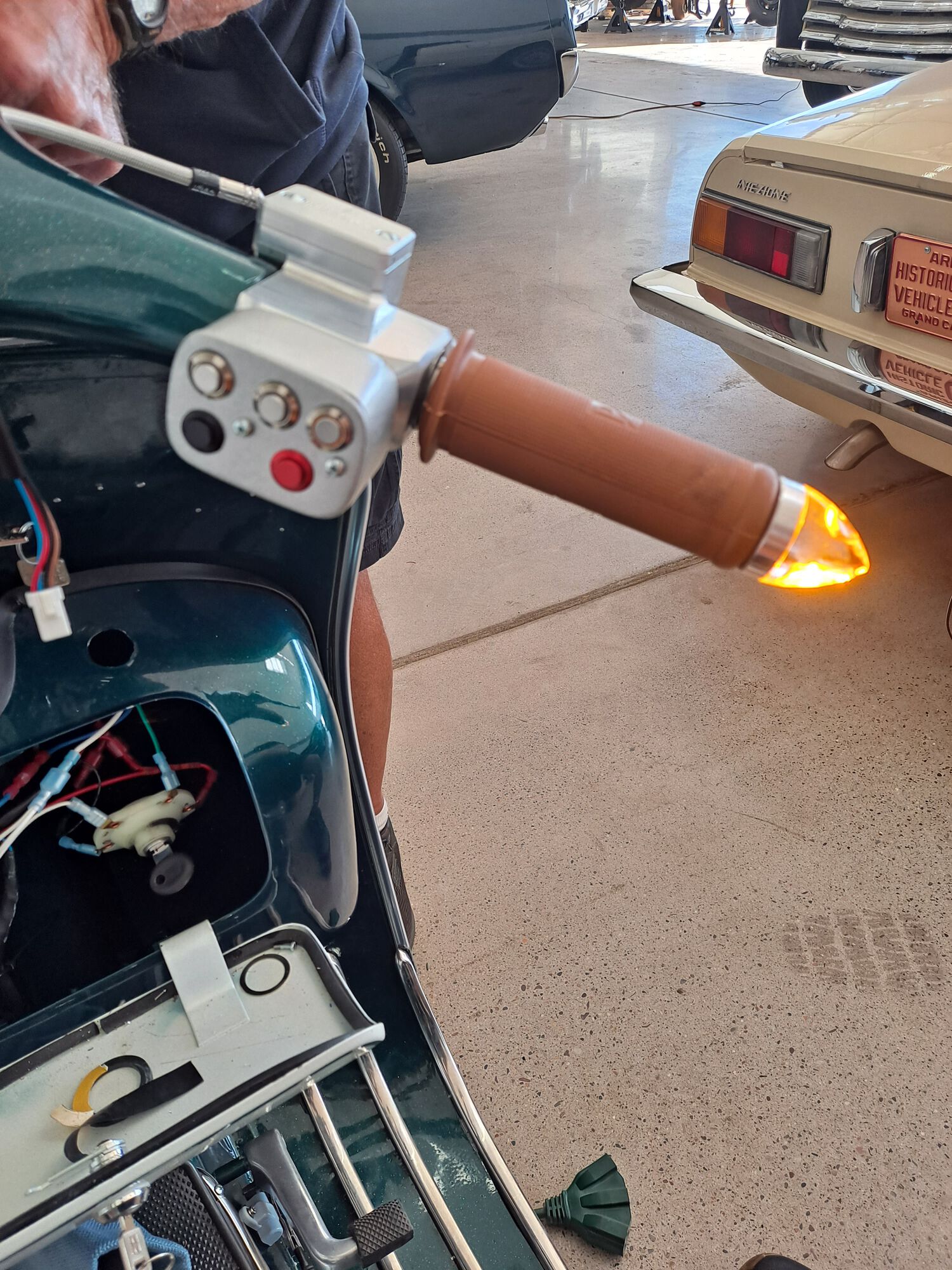

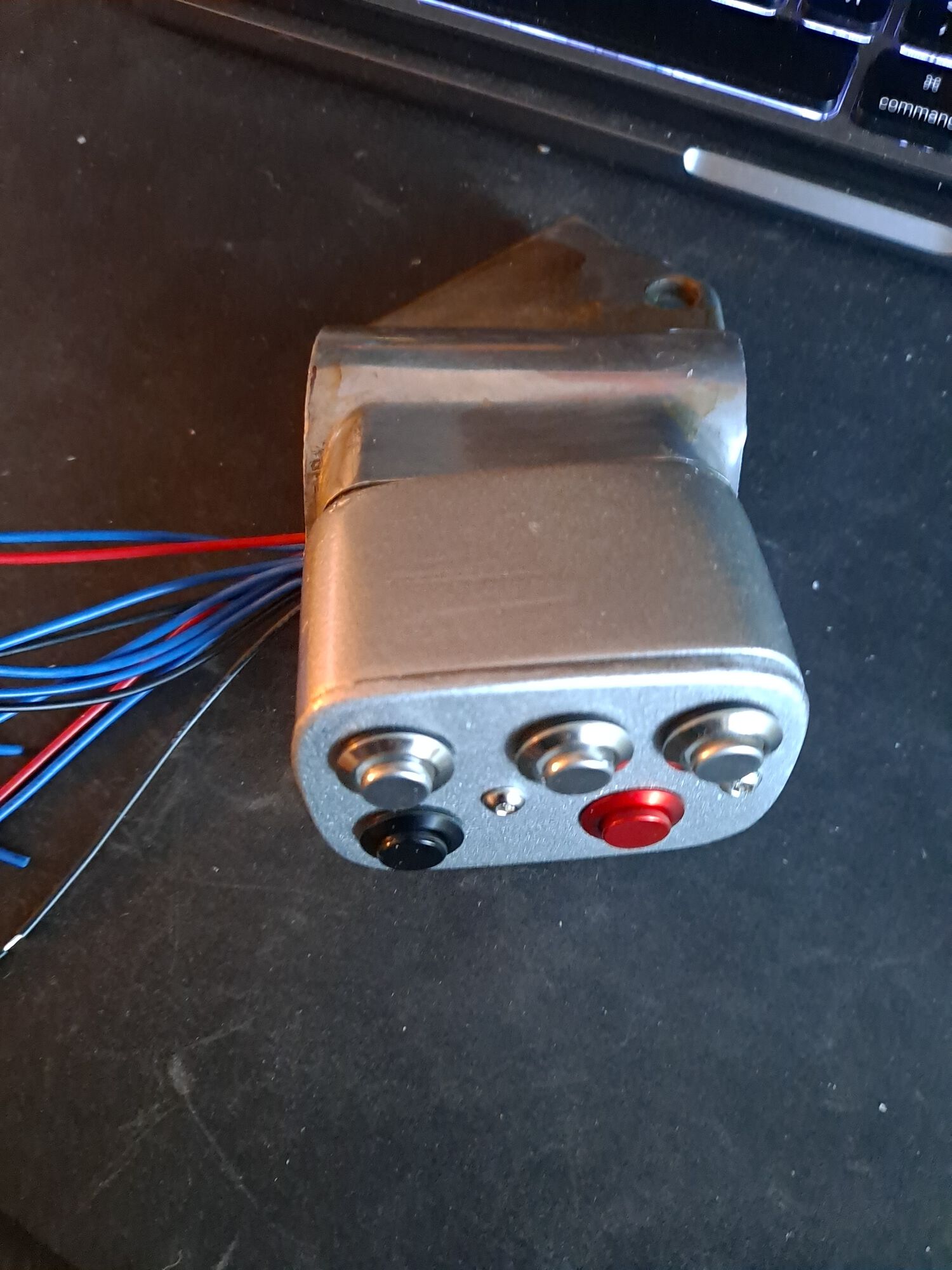

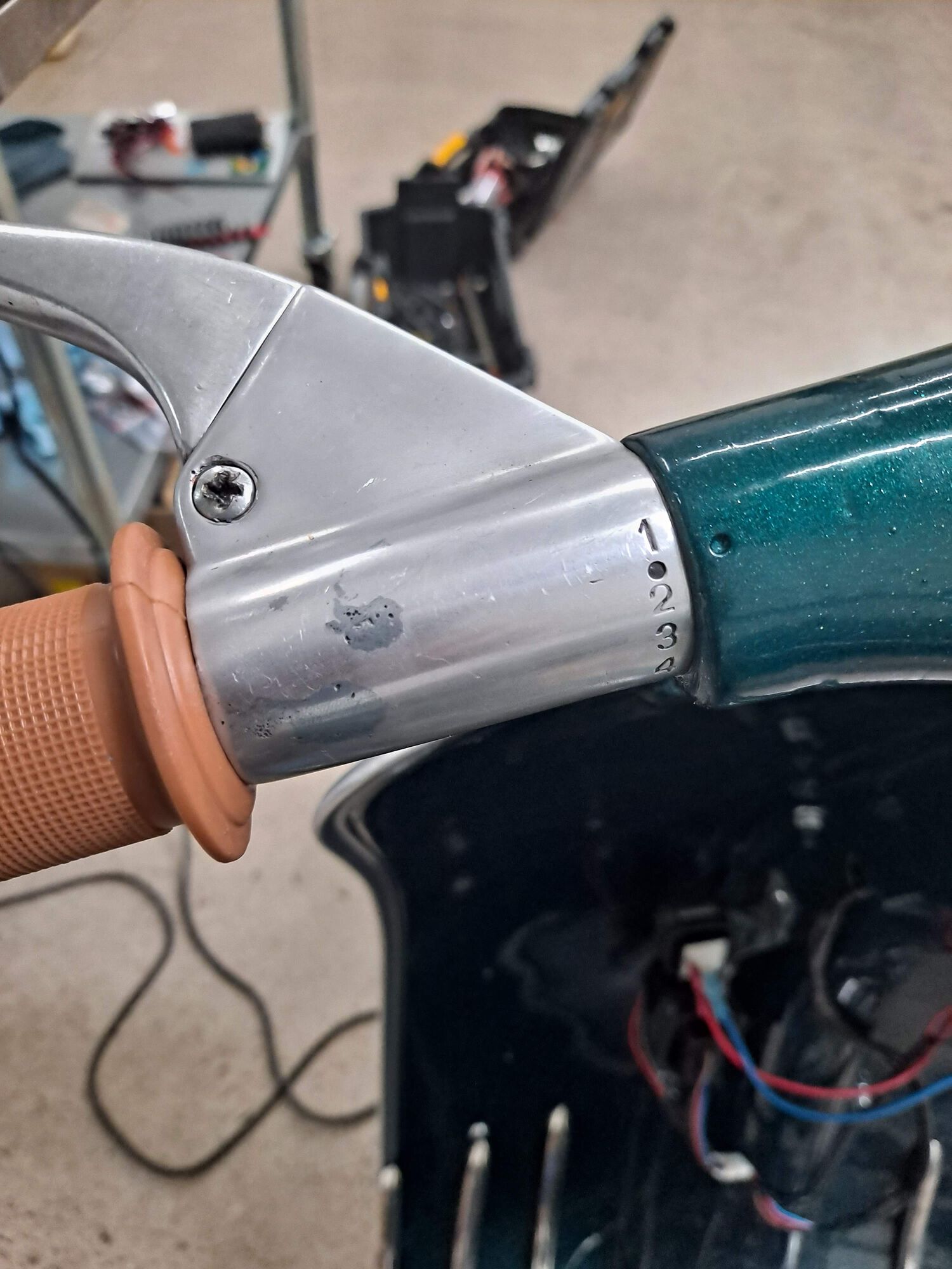

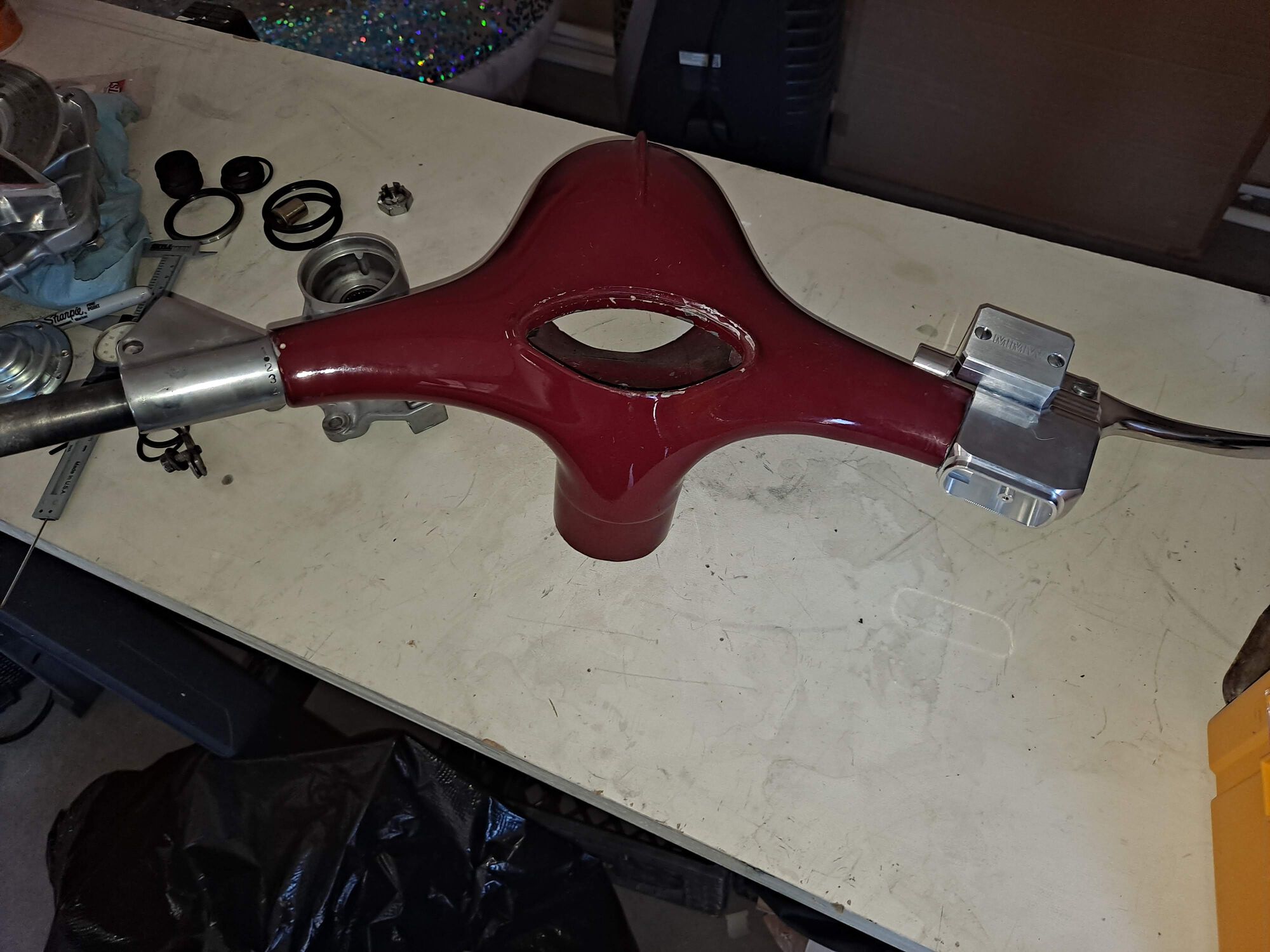

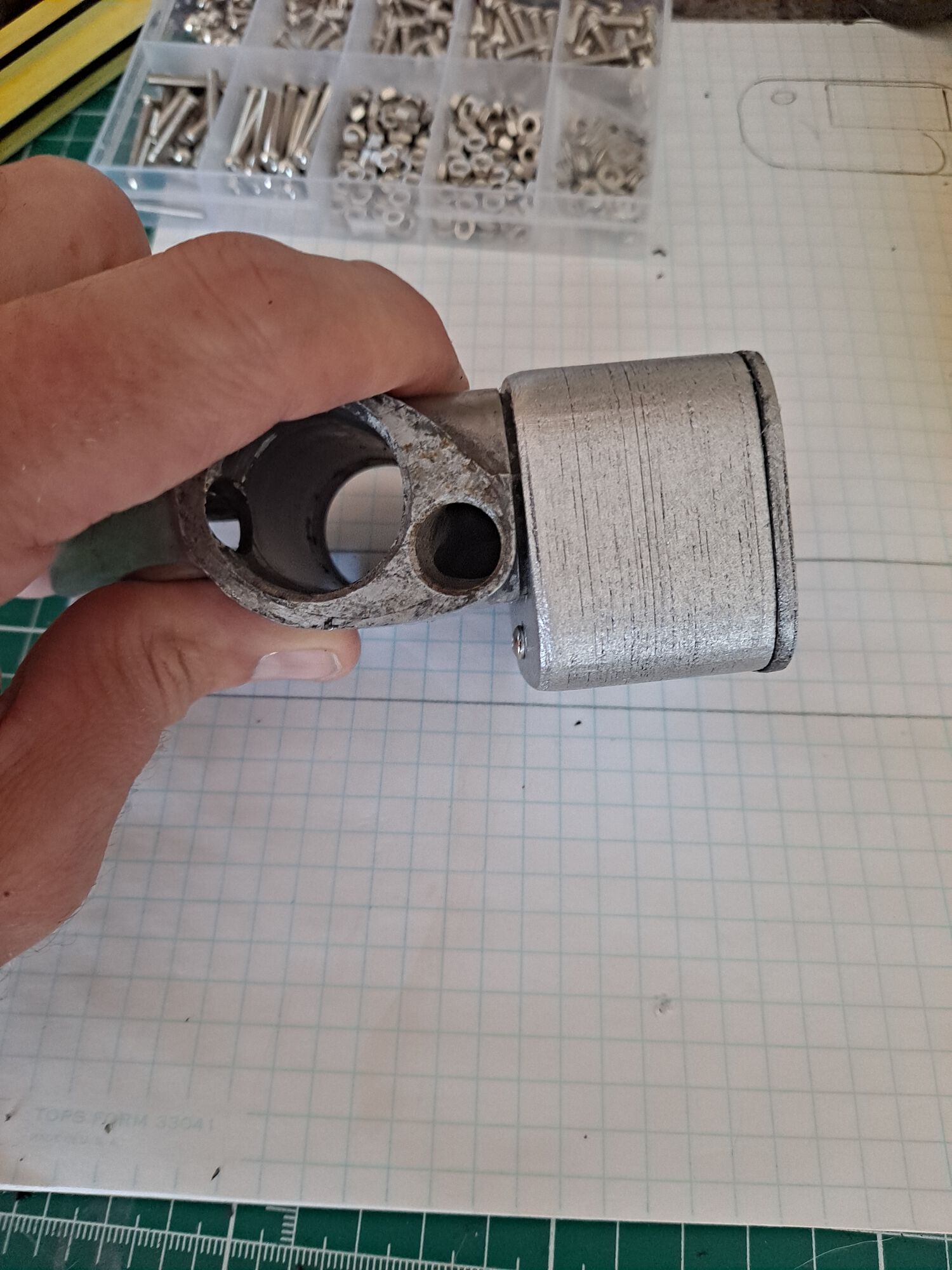

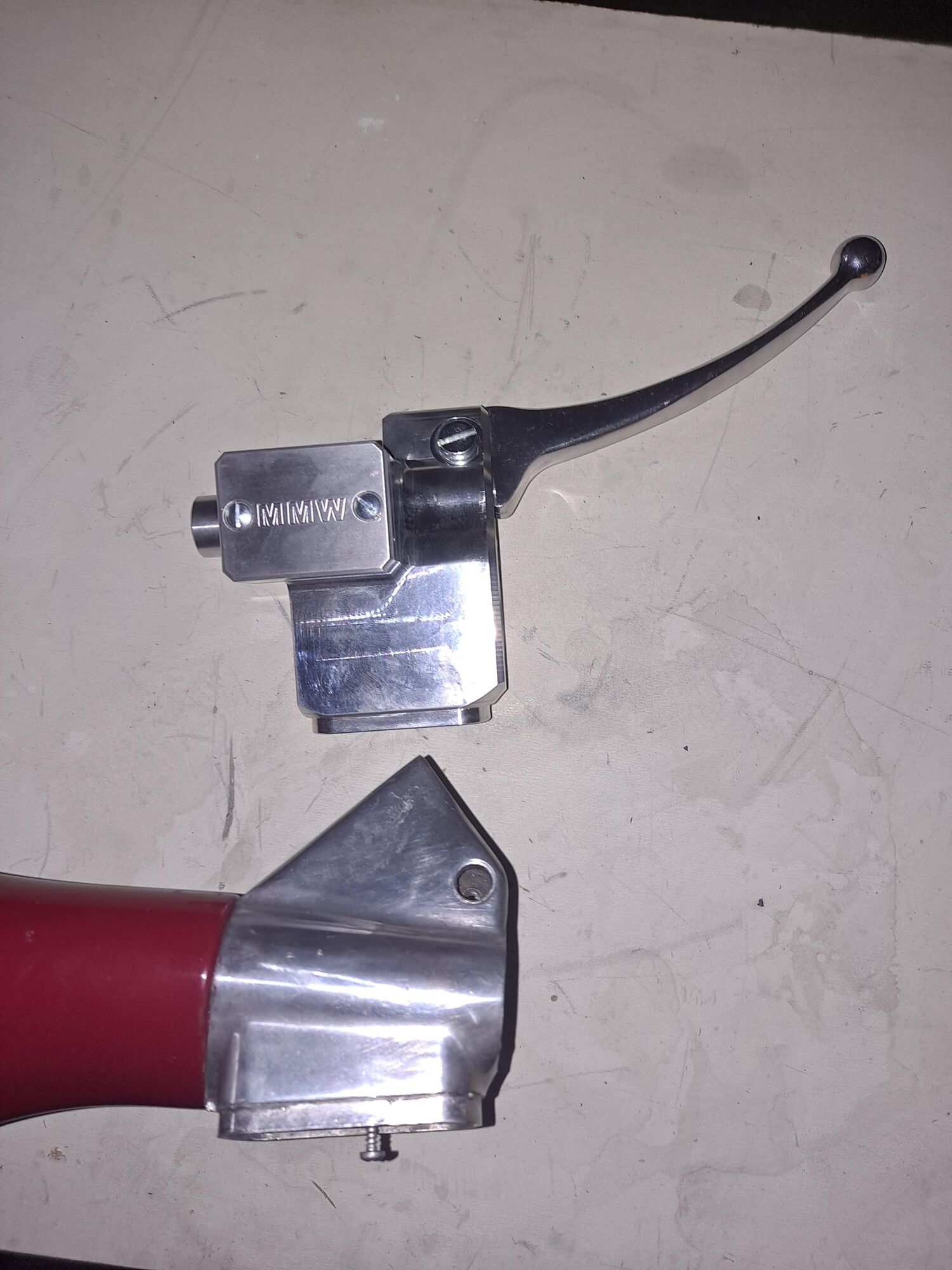

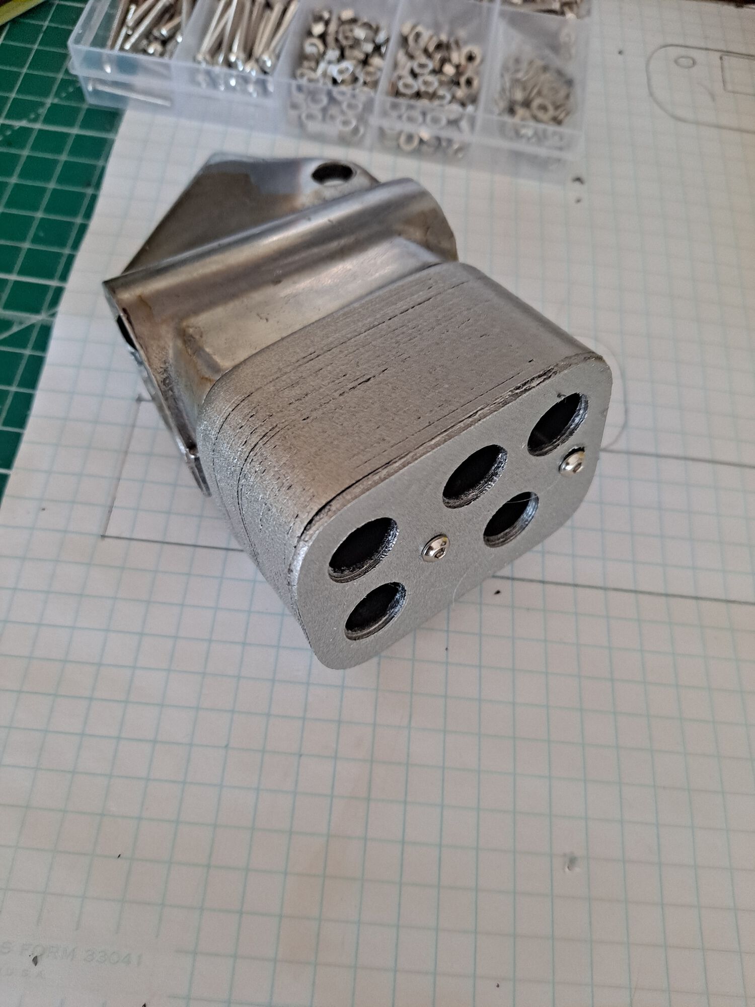

Continued. Here's where necessity becomes the mother of invention for the handlebar switches.
Short of completely rewiring the original switch assembly (of which I tried 2 prototypes), I opted for creating my own. Here's my first attempt at a 3d printed housing for my switch set up.
Prototype 2 is looking a little better but still rough.  I'll have push buttons for high beam, left/right turn, horn, and kill.  The high/left/right will be lighted so I have visual indication of what's on.

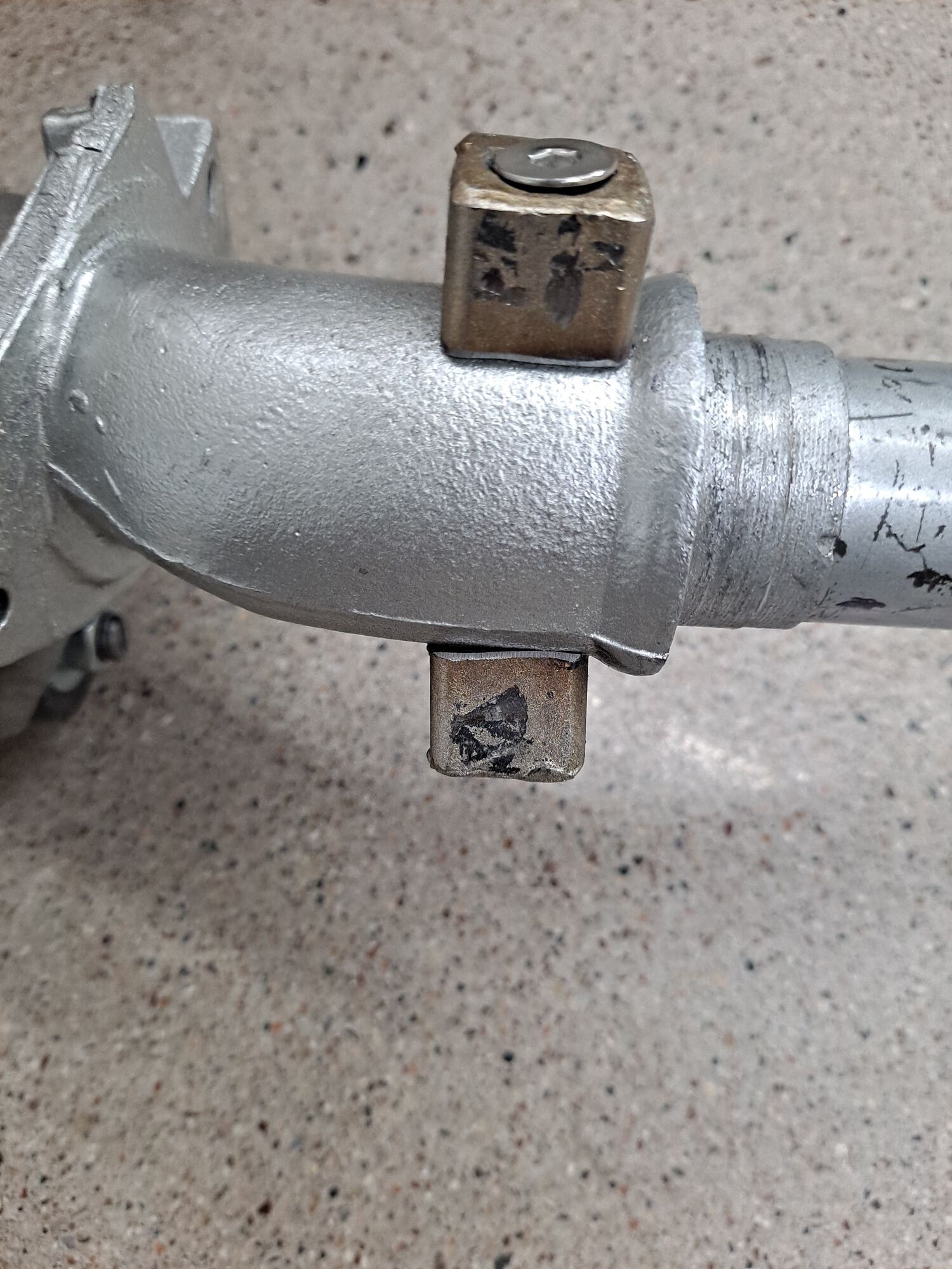

This is what I went with.  Some UV cure resin, sanding, and aluminum paint smooth out the finished look a lot.  and yes, the wiring has been simplified inside the unit on the final assembly.

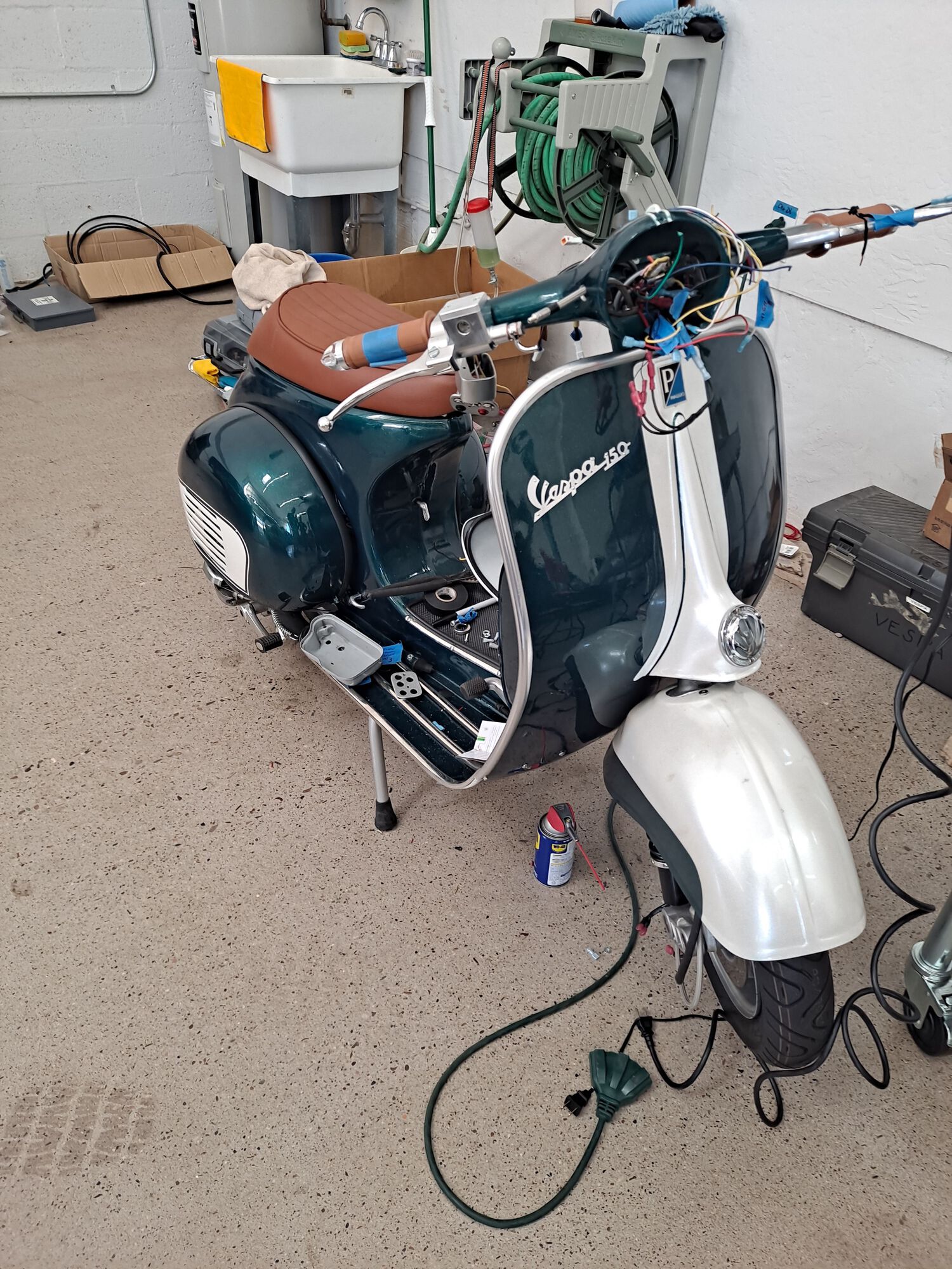

It's alive
It's alive

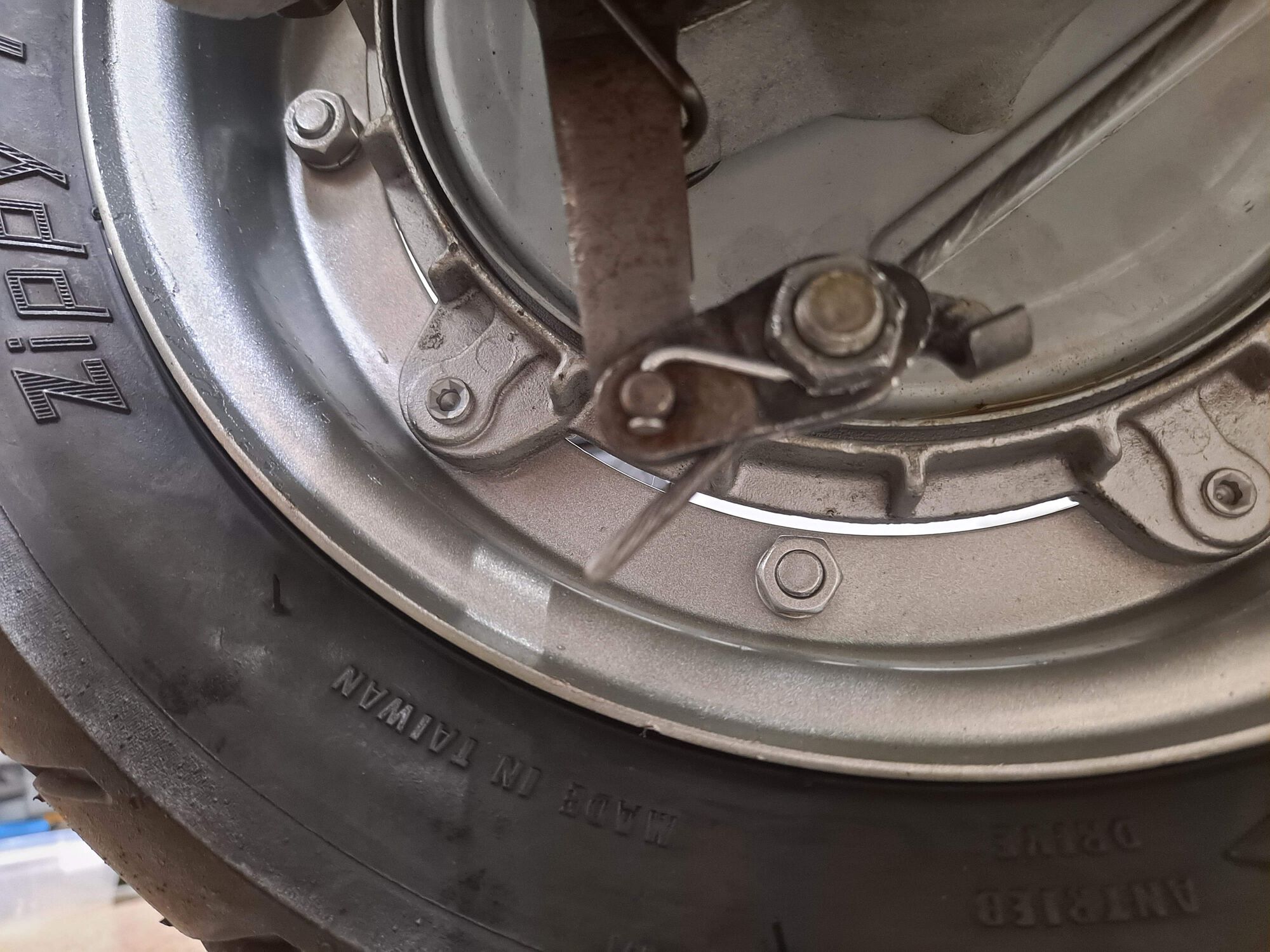

First test ride was solid except for the lack of rear brake which was a simple brake shoe cleaning and cable tightening.

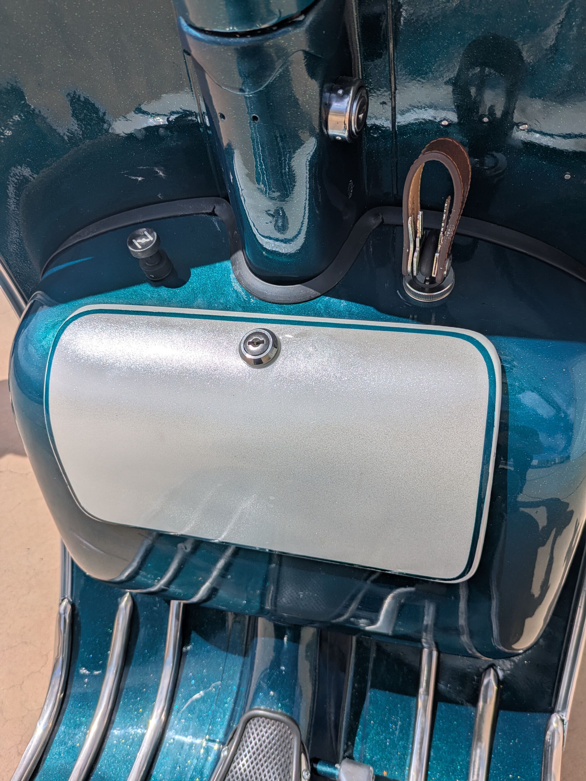

Here are those plans I had for the legshield glovebox.  Choke pull on the left and p200e ignition switch on the right.  The internals of the glovebox also hold the flasher and control box for the SIP speedometer.

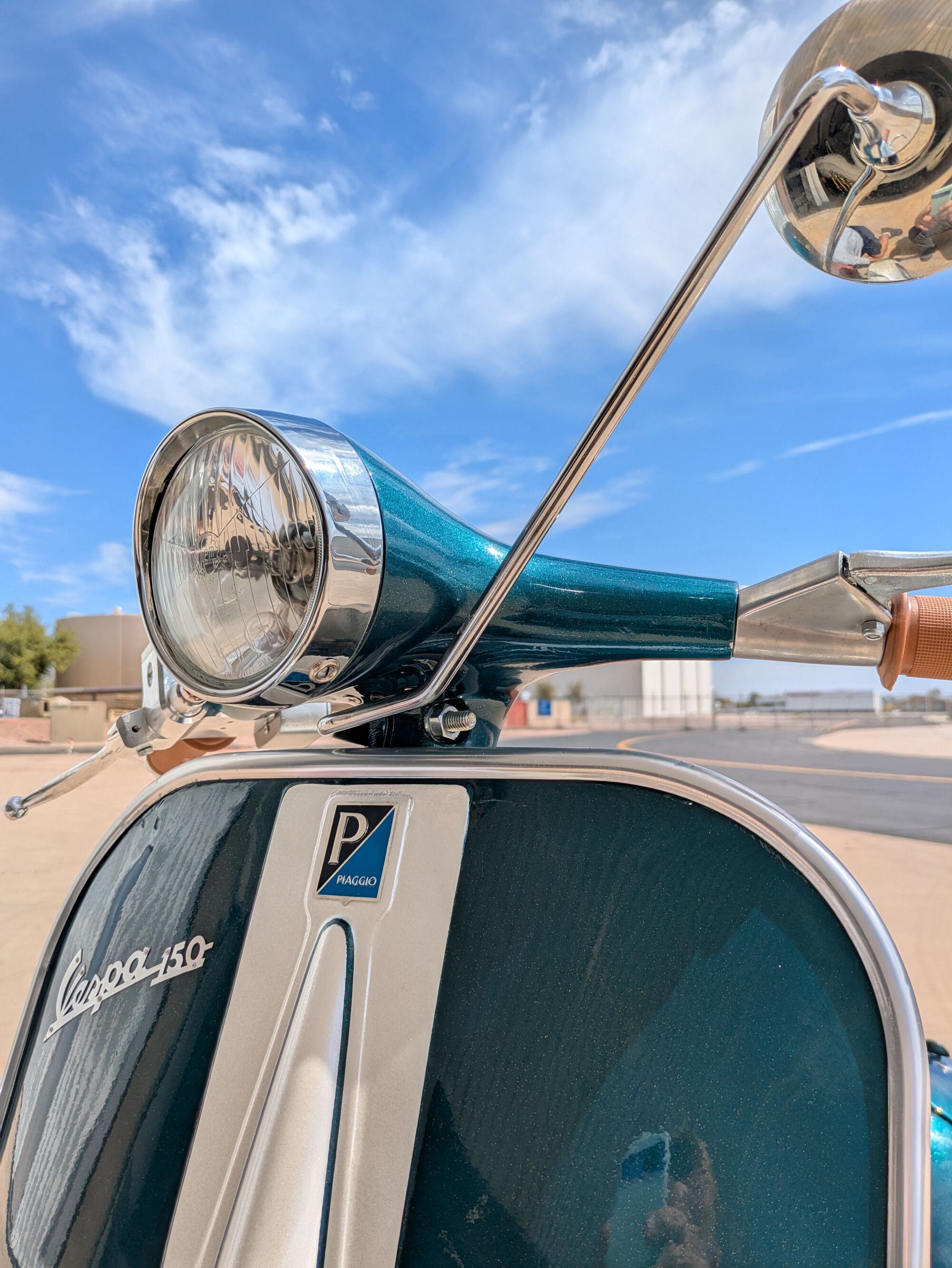

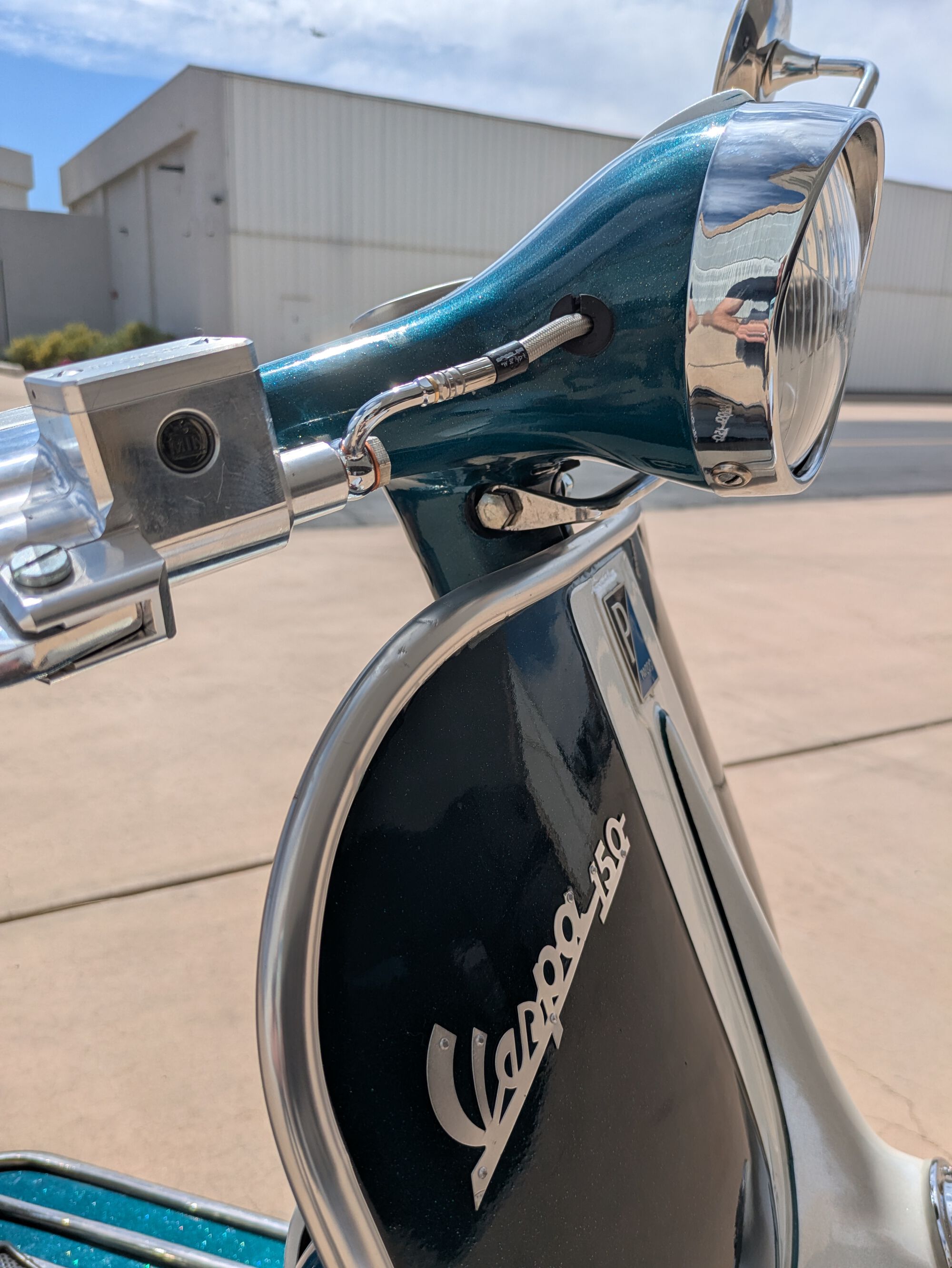

The mirror is a special piece held on by the headset pinch bolt.  Nice and clean.
Here's the mirror mount and a closeup of the hydraulic cylinder and line.

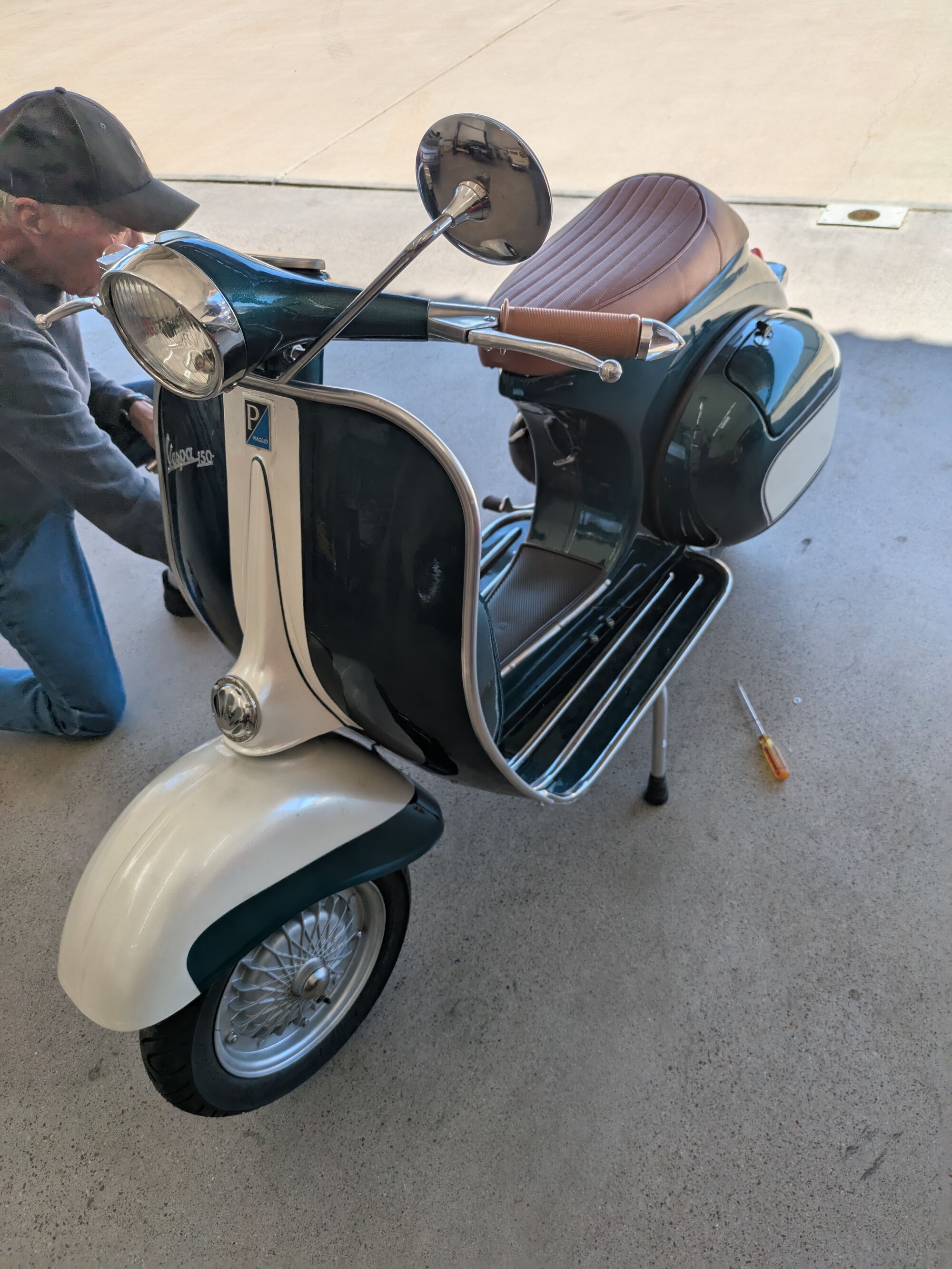

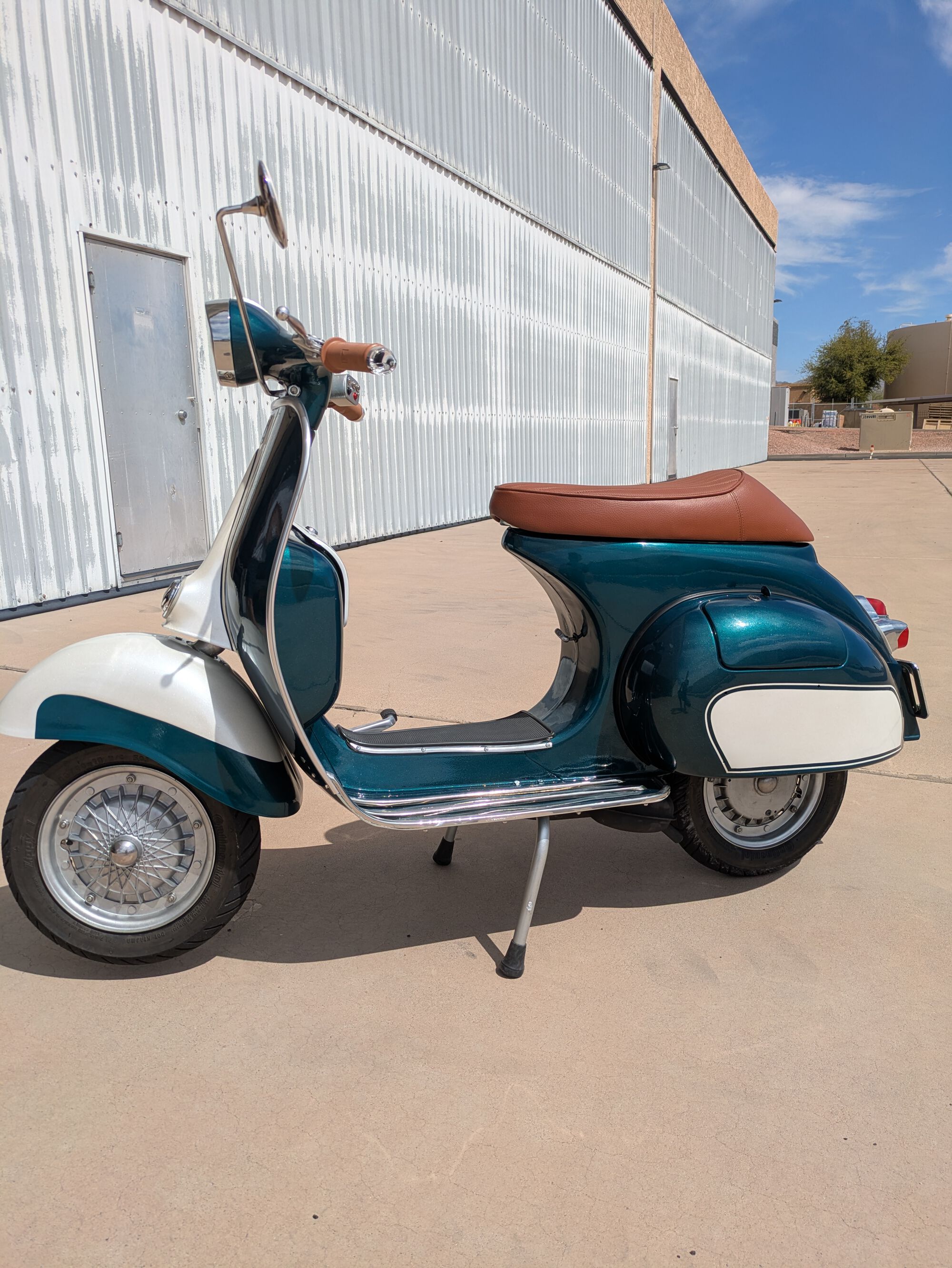

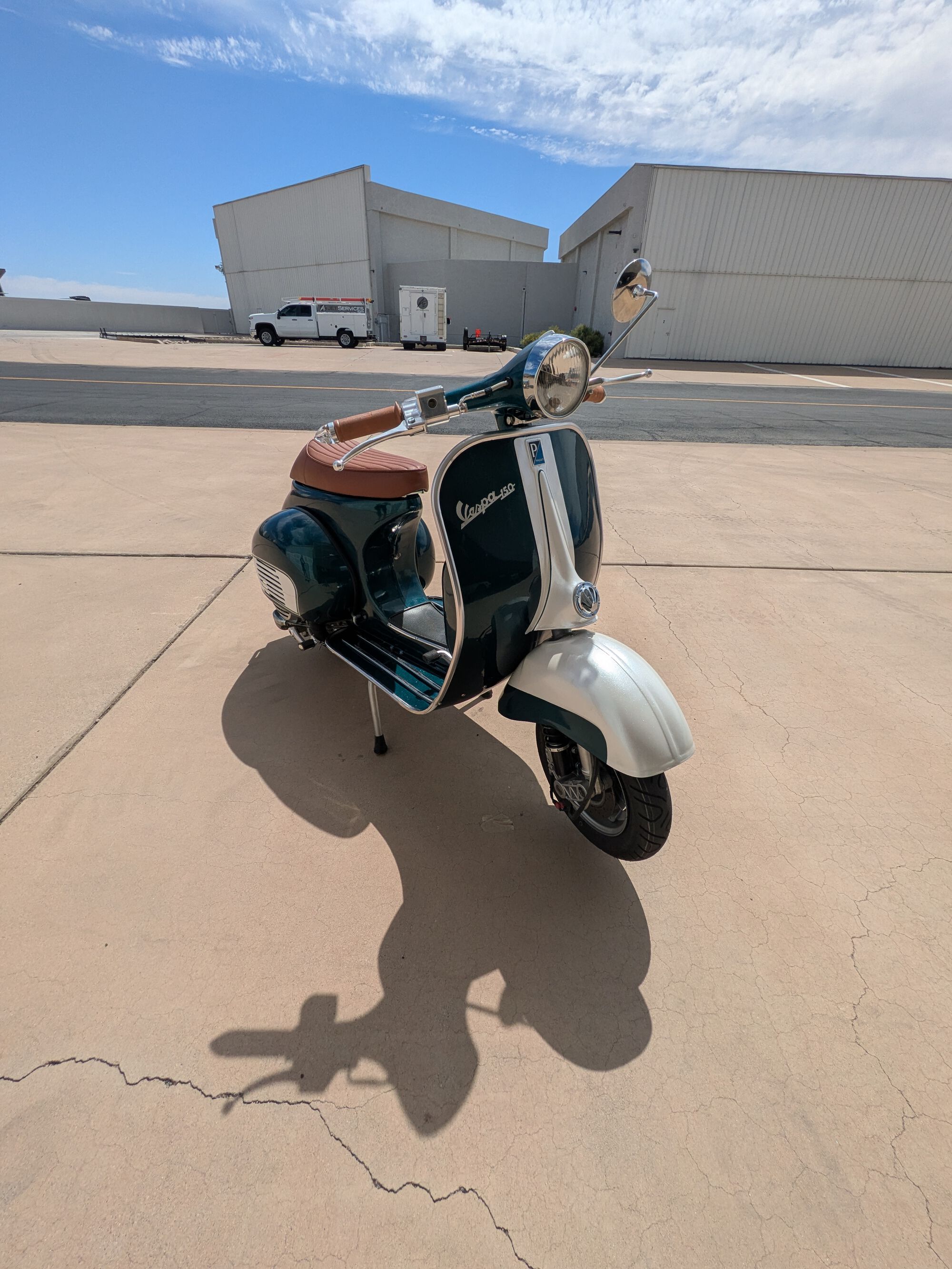

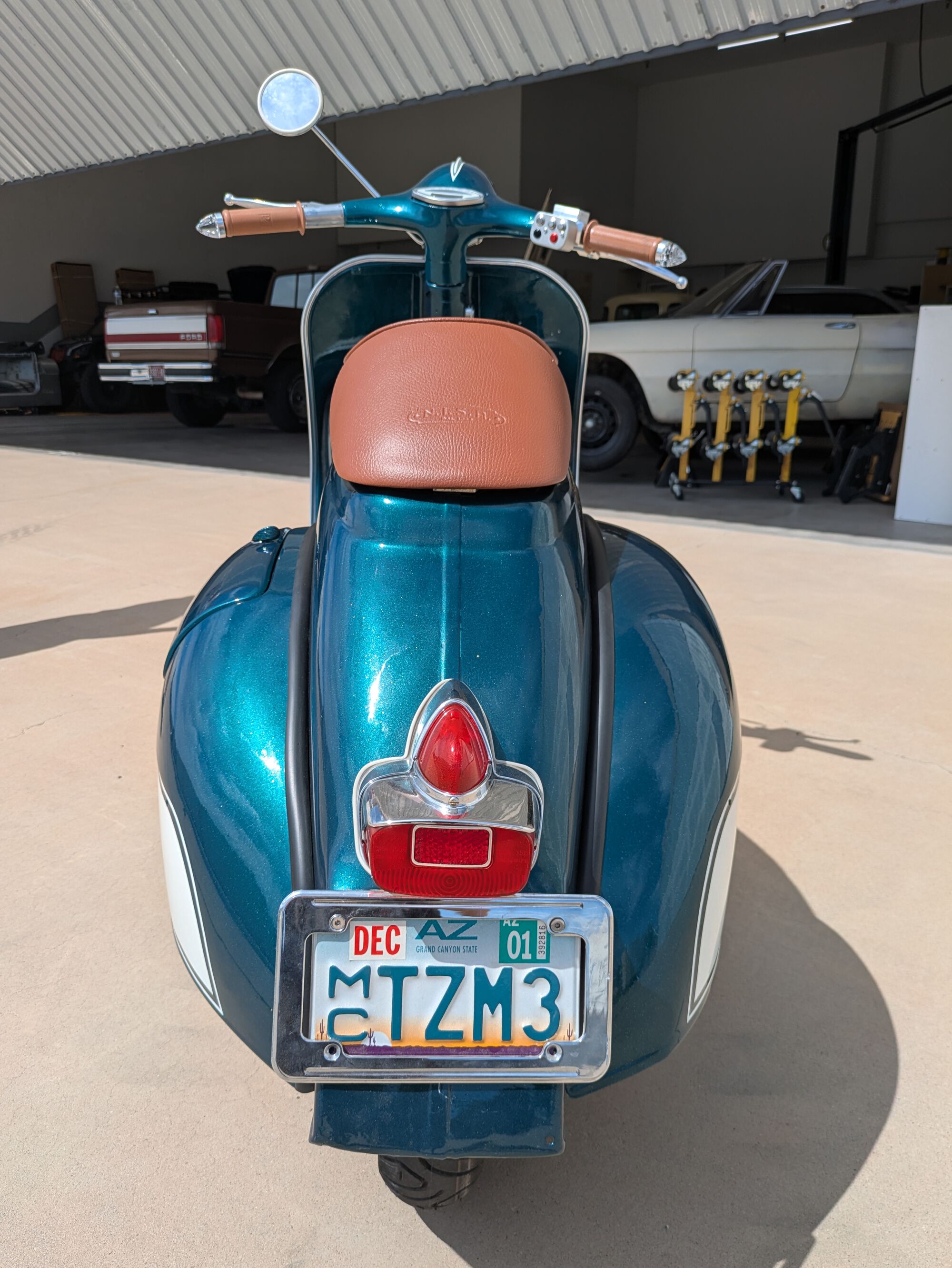

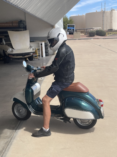

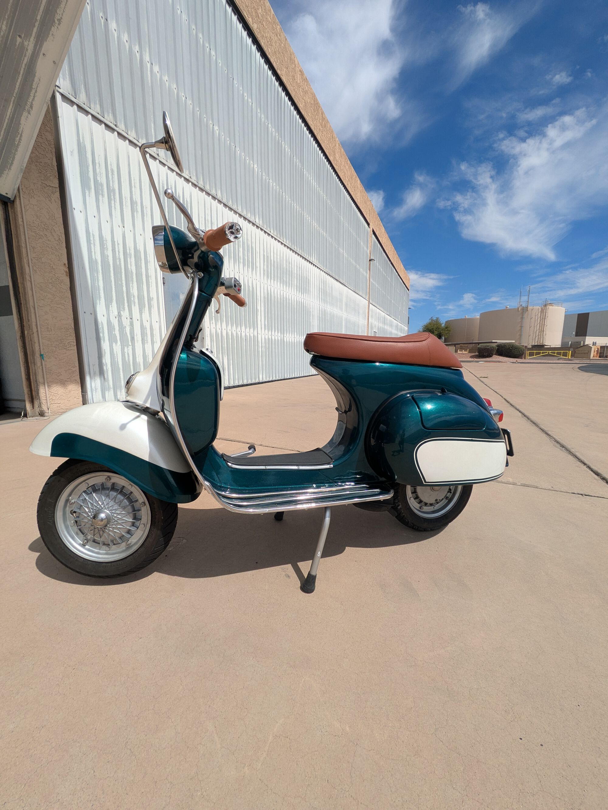

Fin! The project is pretty much complete. Well, for now. I mean, it's a vintage Vespa after all...
First time I've REALLY driven this bike in close to 25 years and the fun is still there
Thanks for the adventure, Dad!
