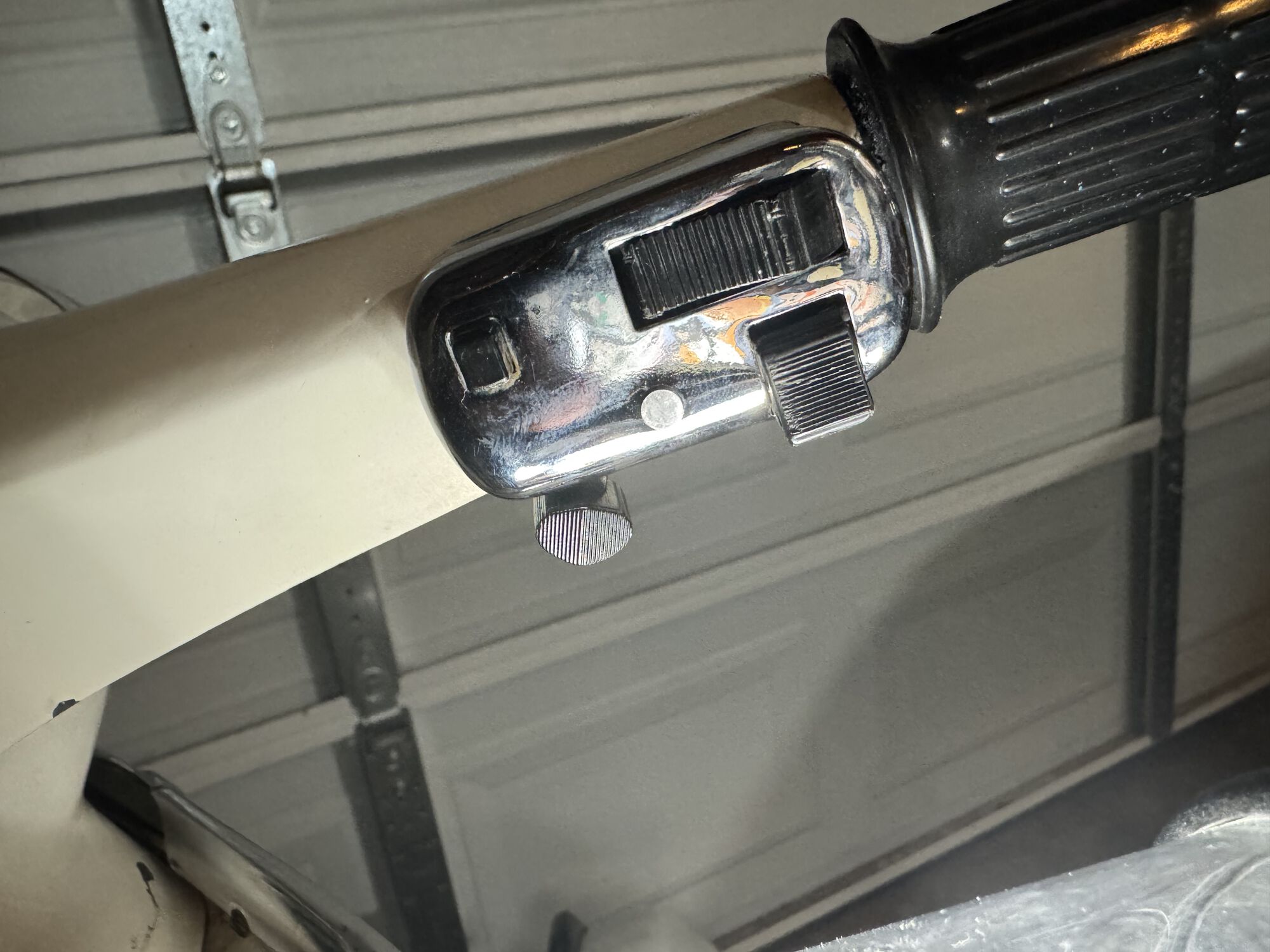

Yes. Correct. However, the headlight switch - and running/brake light interactions on the right handlebar toggle switches are not working the way they originally did. Perhaps this is due to how it is wired to the back side of the switch problem I can trouble shoot? I will need to check this again in person when I get home, but there is some sort of weird set up where only at one position will headlight, running taillight and brake light all work properly as they did with original system. Any other setting gives one either no brake light or no headlight. Sort of odd.

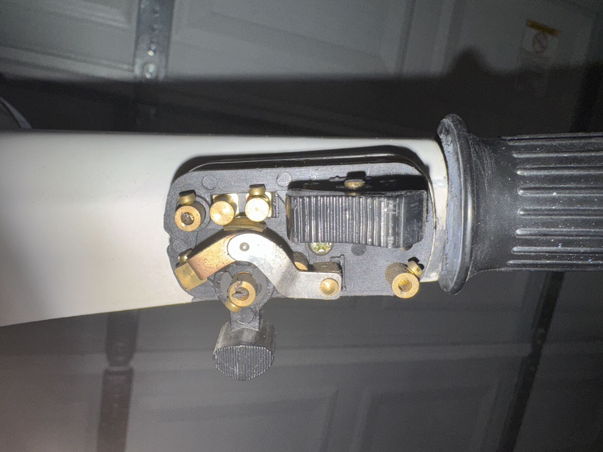

Can you post a pic of your headlight switch?

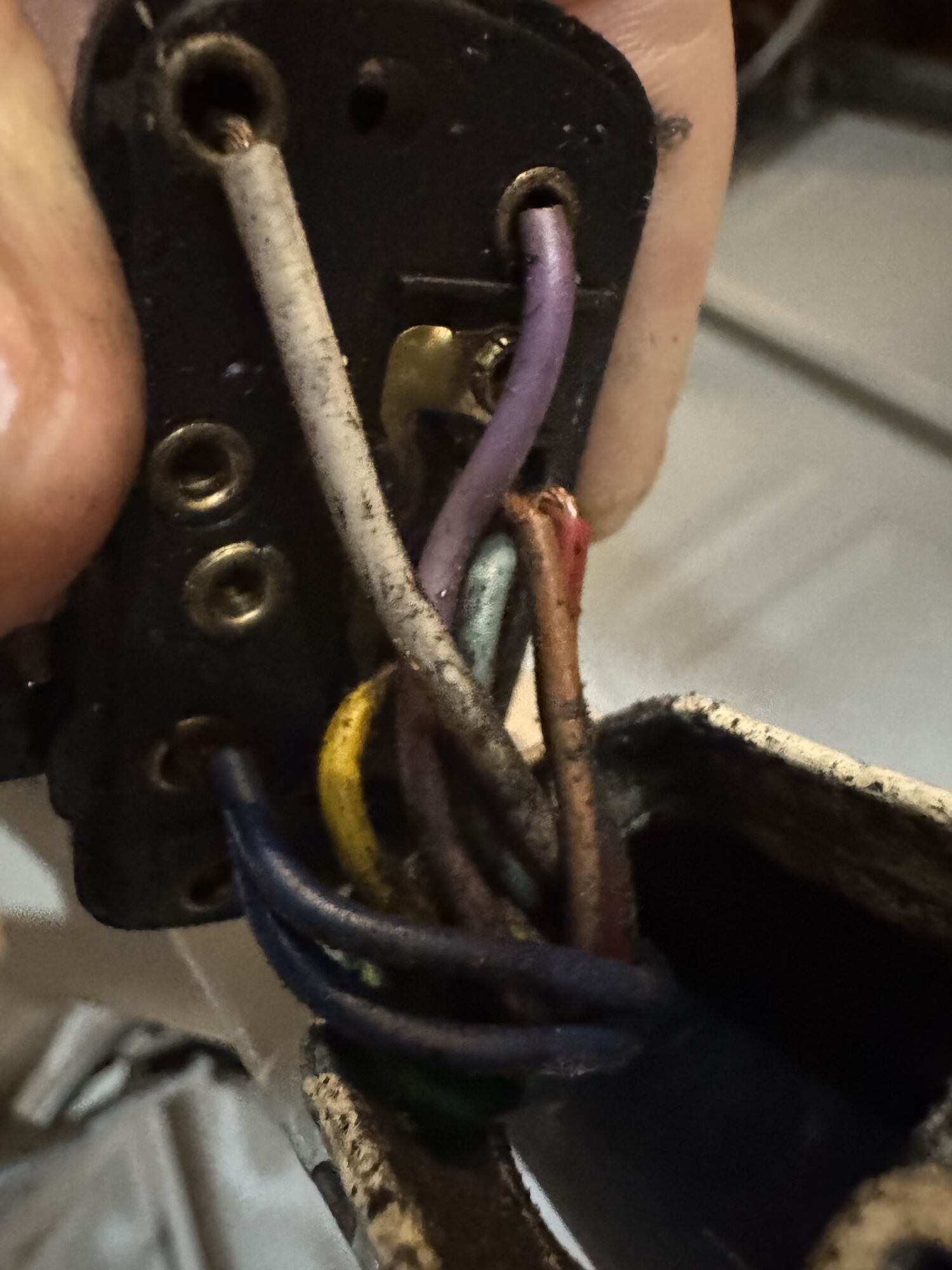

Okay. I attempted to get back of it for any wiring hints.

Switch is close, but not OG for a 74 US spec. Unfortunately you can't find replacements anywhere! It shouldn't go full blackout mode or one/ other like the 60s batteryless scooters. Probably wired up that way when it was covered to batteryless.
I don't have pics of the switches on mine but I'll try to get to my storage unit soon.
Back to your front brake, mine works because I have the OG lever with a little post screwed into it which activates the brake switch. Modern replacement levers don't have that so you would have to make one. The brake switch is on a little V shaped bracket that's screwed into the bottom of the headset if I remember correctly. Have that bracket and switch?

There is something about the switch that is not right. When I have time, I'll look into the original on by other bike, and see what I can make work. If you have any specific suggestions, let me know. BTW. thanks again for your help, very grateful. !

That's a conversion switch. You can totally get that to work.
But it's wired currently like "what were they thinking"

Thanks for the help. I was looking at the light switch on my other Rally and it is the same, except the wire colors do not match and they are going into different slots, so oh well.
I am going to get some pictures and diagrams and come back to this thread for some more guidance because I think I can figure this out, but I do not see any one diagram in any of my books or references that matches up to what I am seeing.
