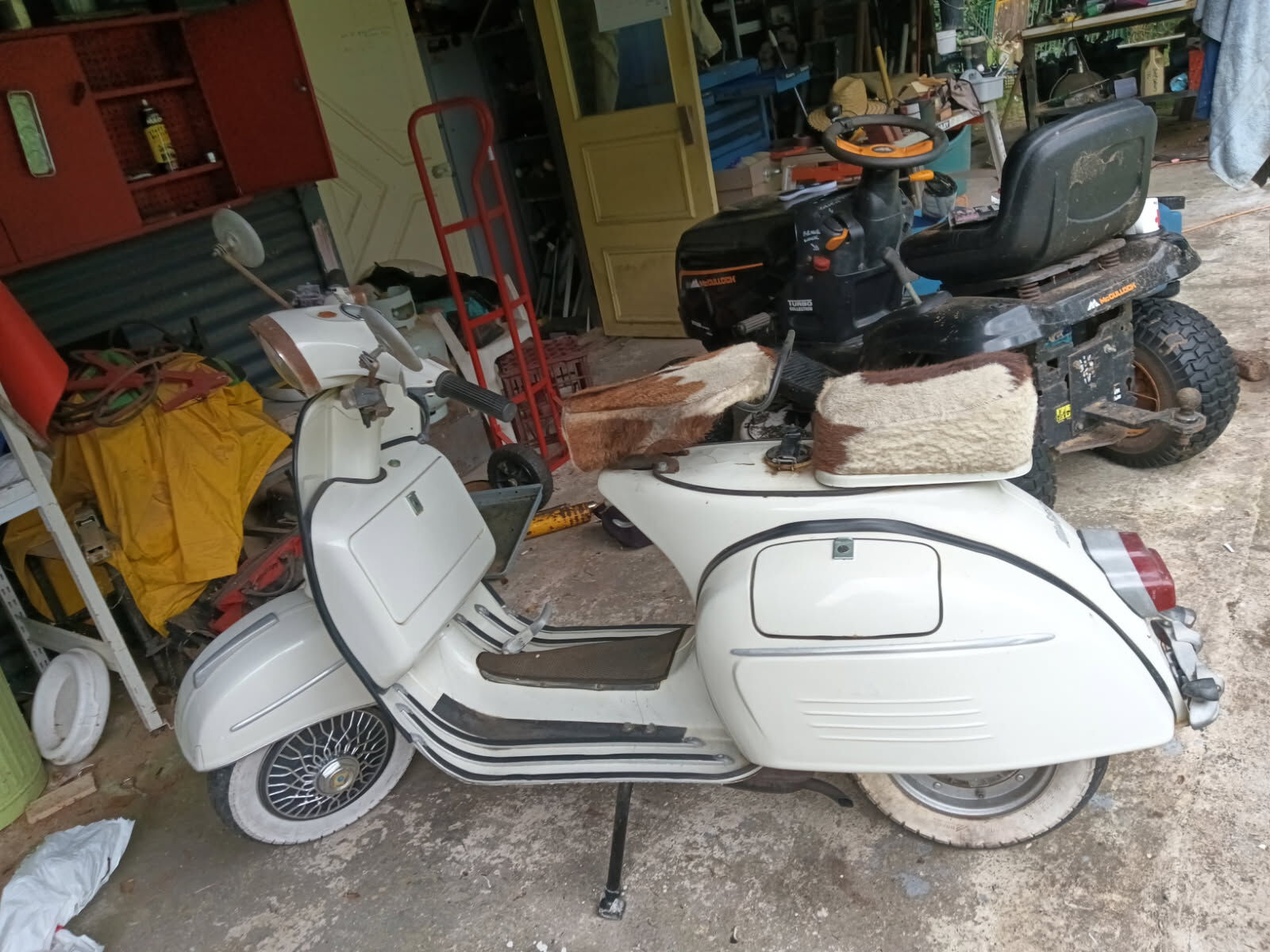

Retired firefighter, own a 2007 Piaggio BV 250ie. I decided to purchase a Vespa 1977 ? Sprint 150 VLB1T and have a dig at restoration. Bought it a few weeks ago ( it sat on display in sellers lounge room for 12 years) and I feel it could possibly be a Vietnam special but in good nick I think. The previous mods most noticeable to me is ie front disc front end which involved a bloody dodgy master cylinder install, 12 V electrics I'm sure more surprises will come my way.
Doing up the front end atm , new bearings, cables, and of course a new headset etc. Crikey parts are a bit rich.
Hopefully haven't dug a hole too deep. Great to join the site and I look forward to some banter and swapping ideas.

Looks a lot better than most I'd say. If the metal is solid and the nice paint isn't concealing gobs of Bondo, you may be in luck. Junk motors can be replaced or sometimes properly repaired, but a good body gives you a solid foundation regardless of the stuff that's been added to 'improve' it. The glovebox is not original, but useful and looks OK so keep if you like it. But please ditch the seat covers! In fact consider sourcing a bench style seat which are more practical and look better IMO.

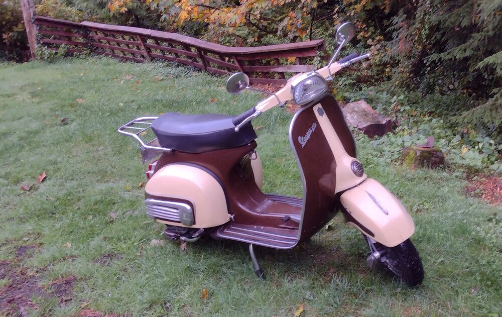

Is your headlight round or trapezoid? If the latter I think it may be a DanMotors Vespa from Indonesia rather than the dreaded VN bodge... They can be OK, but no guarantees. Look here to see what my experience w/ a similar DanMotors 150 Super: PT Danmotors Super-T & more
Here's the trap headset. Dos yours look like this?
Two tone scoot looks bodgey as Hell but it's totally solid!

Welcome! Seeing the trap headset and your other post about the fork, everything points to Indonesian origins, not Vietnamese. This can be good or bad depending how much questionable work has been done to it. Personally, I don't know if I would be putting any money or time into it…

For sure it is a bodge, but could be a savable one, as long as you don't discover some crazy welds into the tunnel and the frame is straight. Otherwise I would not throw any money into it.

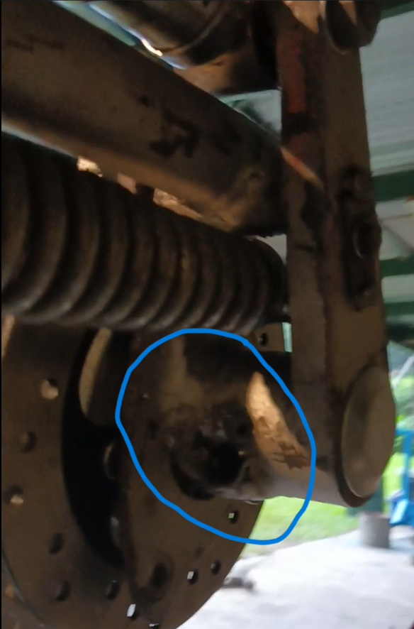

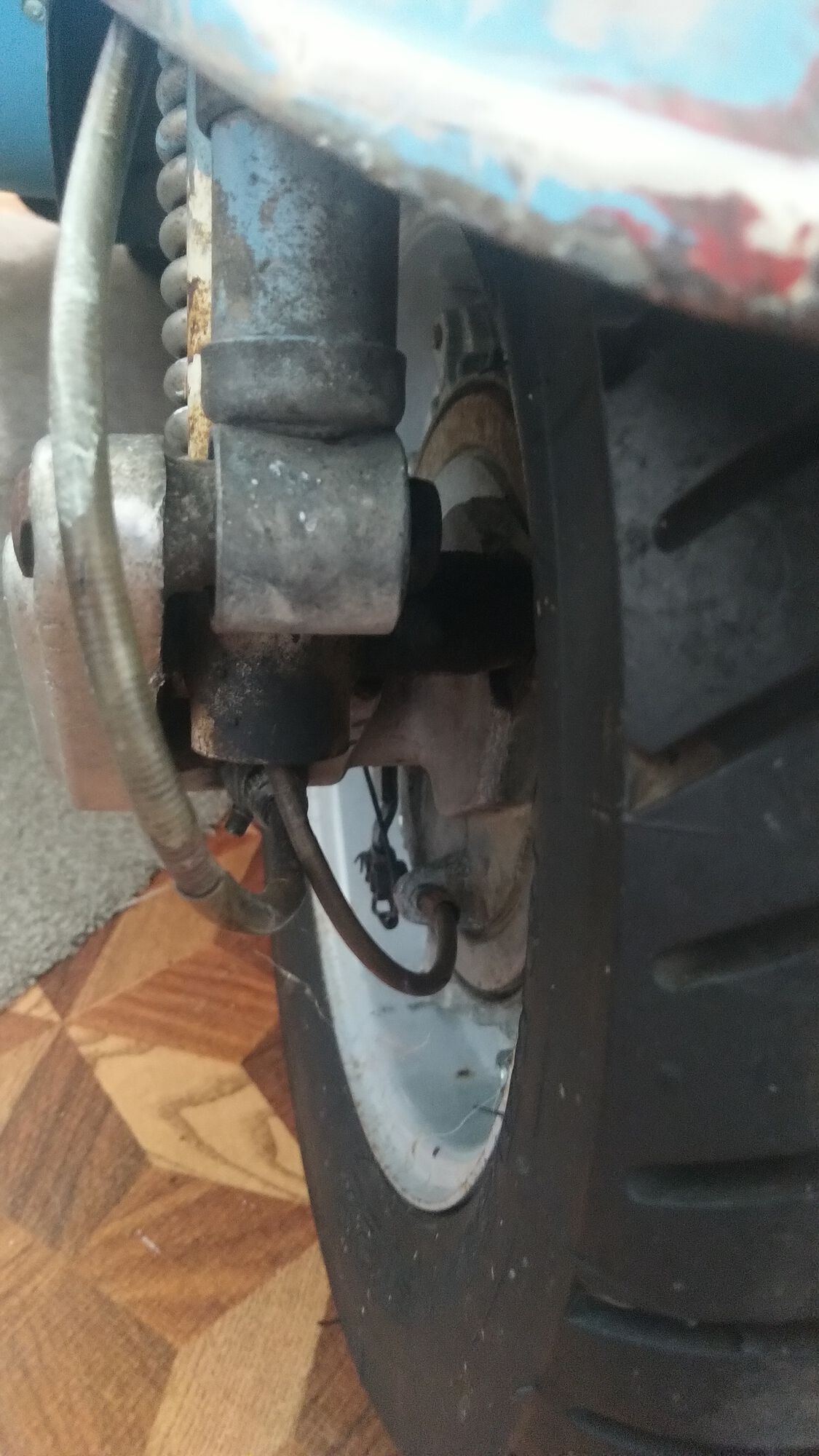

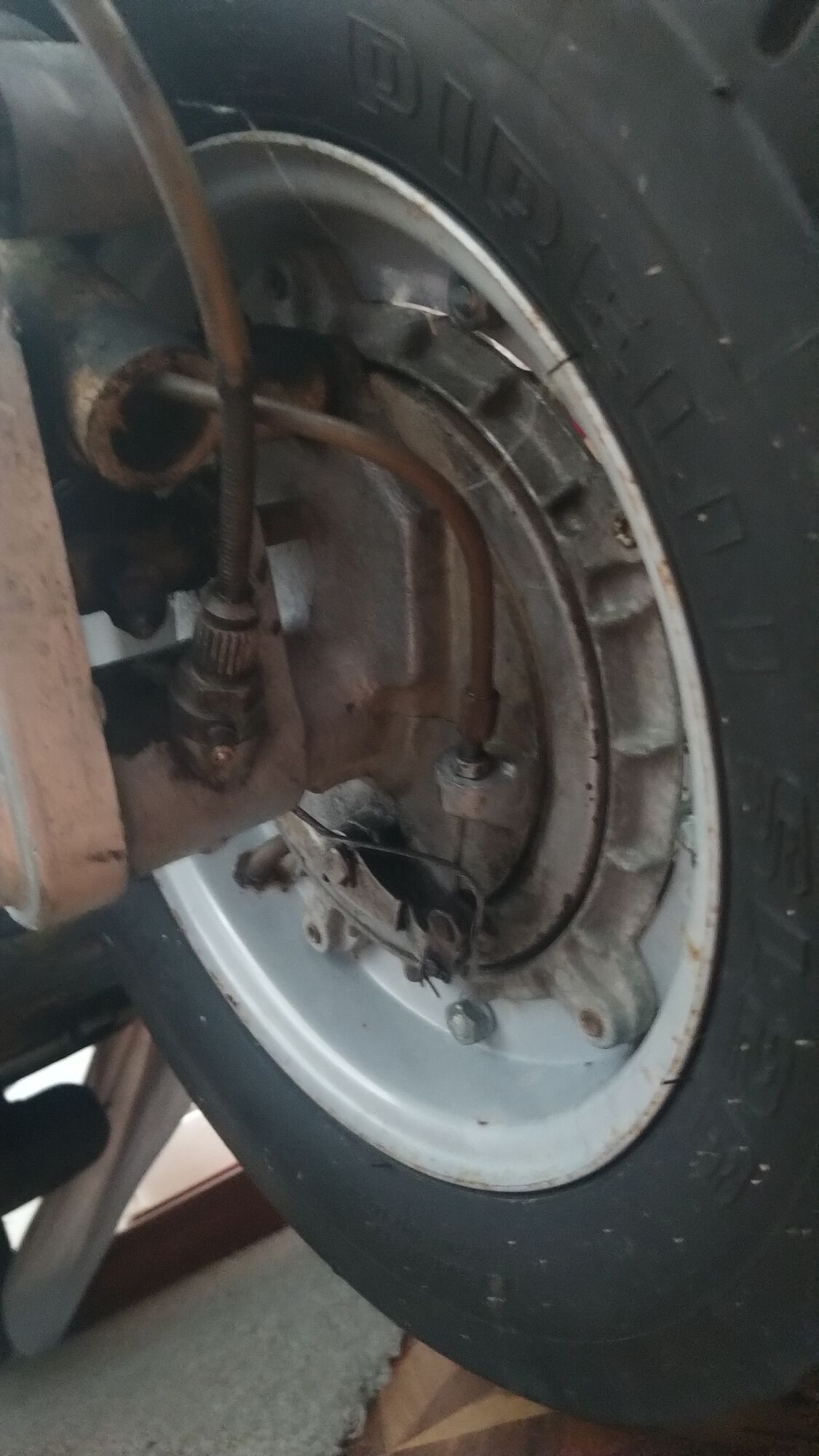

Mine doesn't have the Veloce script anywhere that I can see. A further question to all is regarding the front axle .From what I can discern I possibly have a gs160 axle 20mm ( but mine looks longer I think maybe something to do with disc brake) with no worm drive cast or ground in for primary speedo drive see pic. As per pic 2 the speedo cable hole is in the centre of the hub as is the gs160. Is a speedo primary worm drive available to press on as I would like to have an operational speedo. Any other input would greatly appreciated.

Hi,
Yeah, for peace of mind ditch that disc tomfoolery and reco the lot back to stock. Stock is sweet as. New rim (Piaggio), tube, and Pirelli Angel front and rear.
I can post a pic of my 1966 Sprint fork if that helps?
Did you run the engine serial number or just the frame? It would be good to confirm exactly what motor is in it before frothing prematurely.

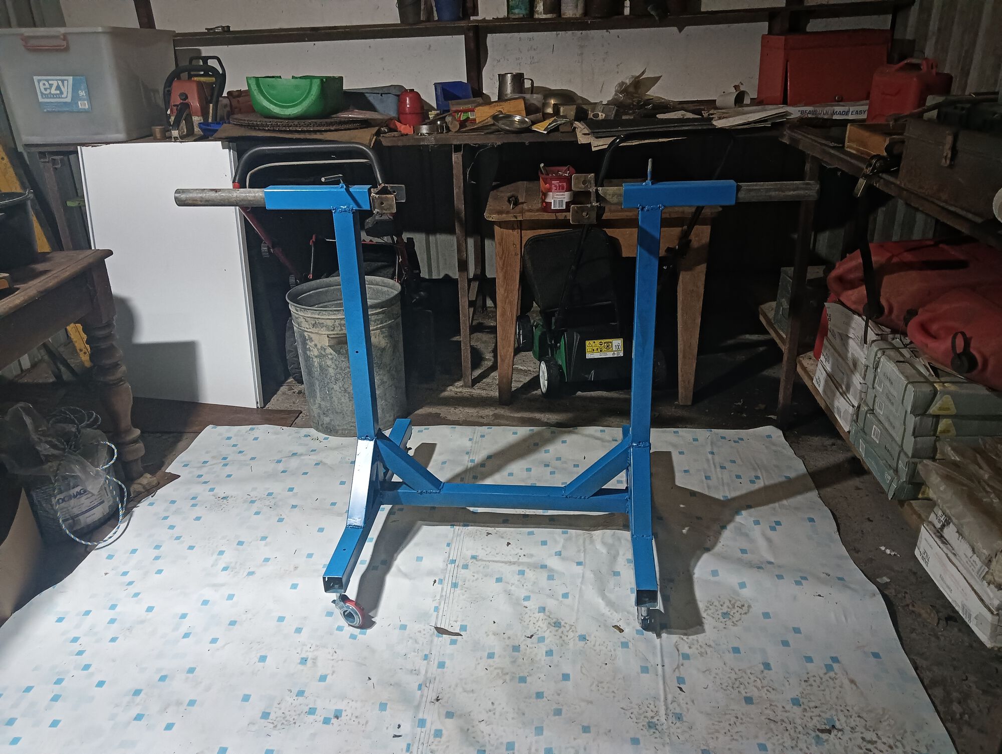

SubEtherBASS thanks for the info and looked at danmotors etc. I thought that you had nailed it. The P150S seems to have a different front to the cowling, it comes to a rectangle where the tooter is, mine is round. It seems that they started P150s in 78 and mine is 77.
I don't know if danmotors made a previous model, I couldn't find out much. Going to pull out the engine in a few days and see if any more info can be found out. Made a high engine stand so that I can sit and fiddle, bigger is better just don't look at welds too closely. It will be like putting a quail on a bbq rotisserie. By the way has anyone seen mirrors like this, they are well made and a reasonably weighty alloy and came up well with a buff. letters are well formed Any info would be helpful.
