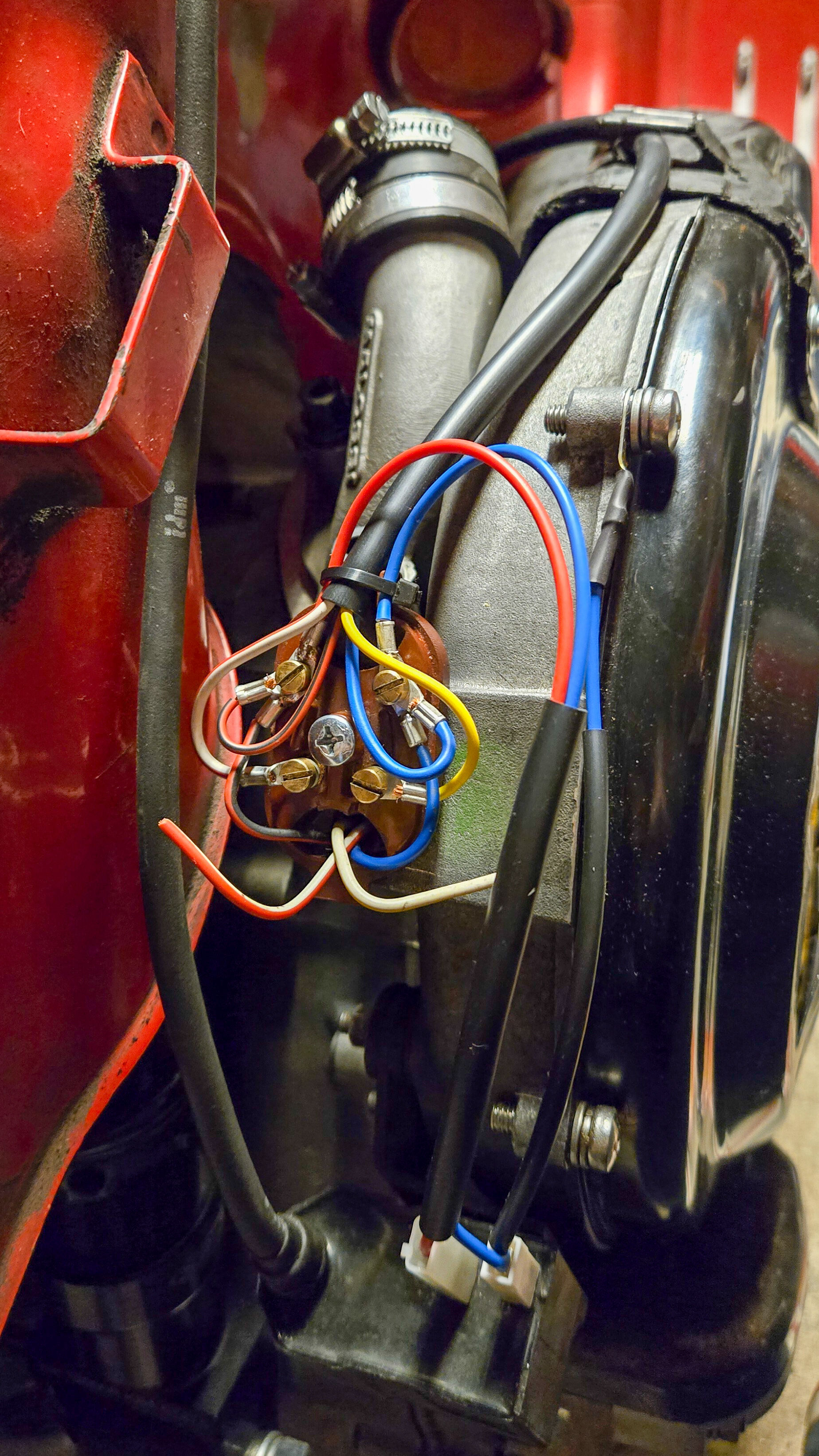

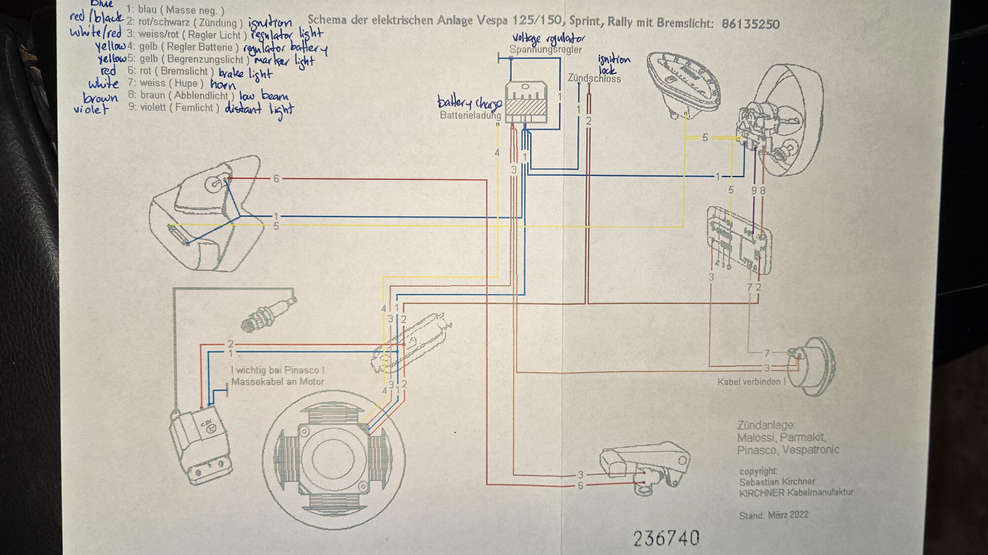

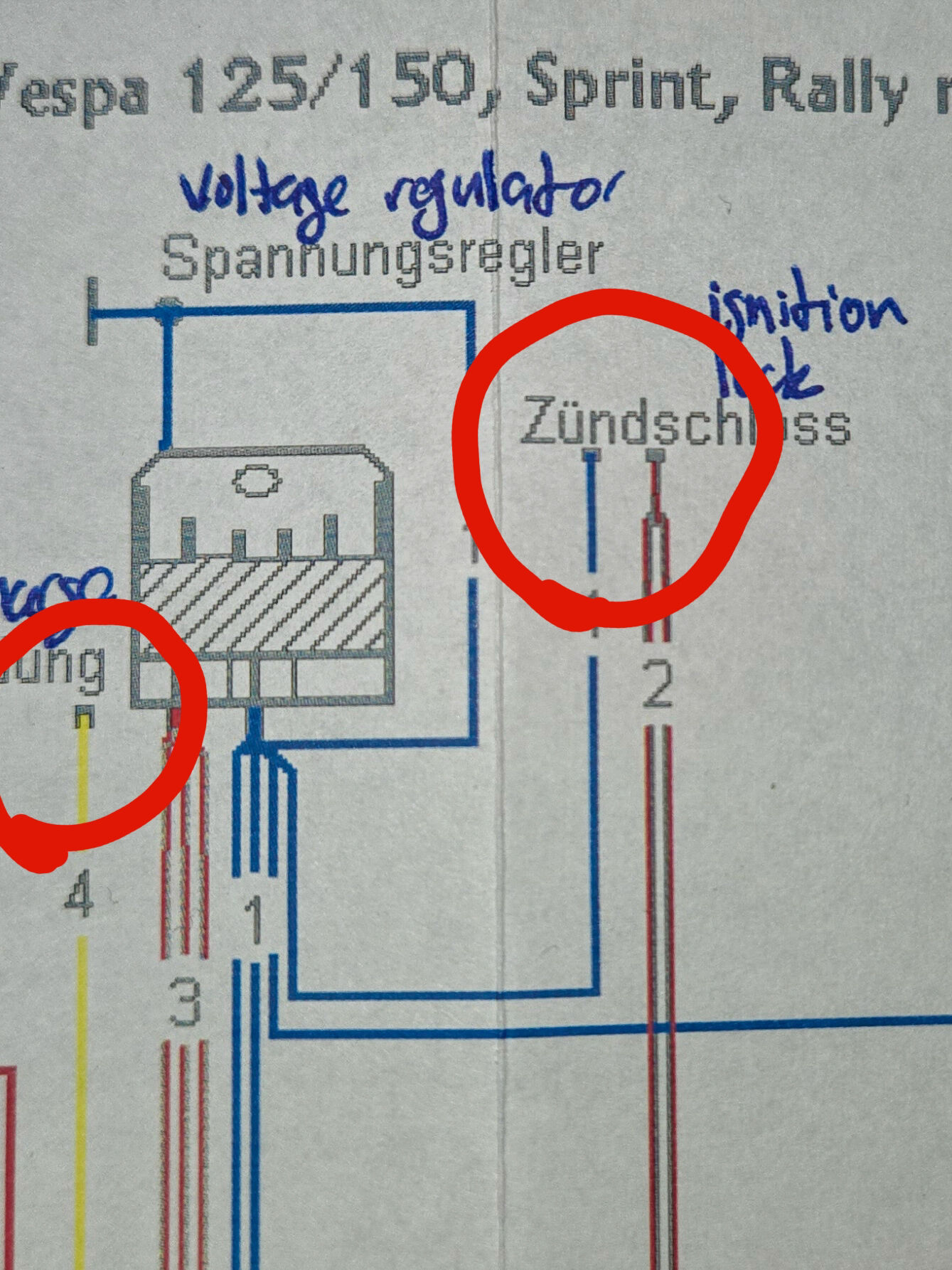

Need to know what to do with a couple loose ends. Wiring up a SIP harness and have a charging wire and two ignition switch wires that aren't used on my model. What do I need to do with them, if anything?
Parmakit ignition kit on a VNB.

You can just leave them be or add a switch. It's just another part of the kill circuit.
Ok, cool. Ignition lock translation makes more sense being a kill switch. Thanks

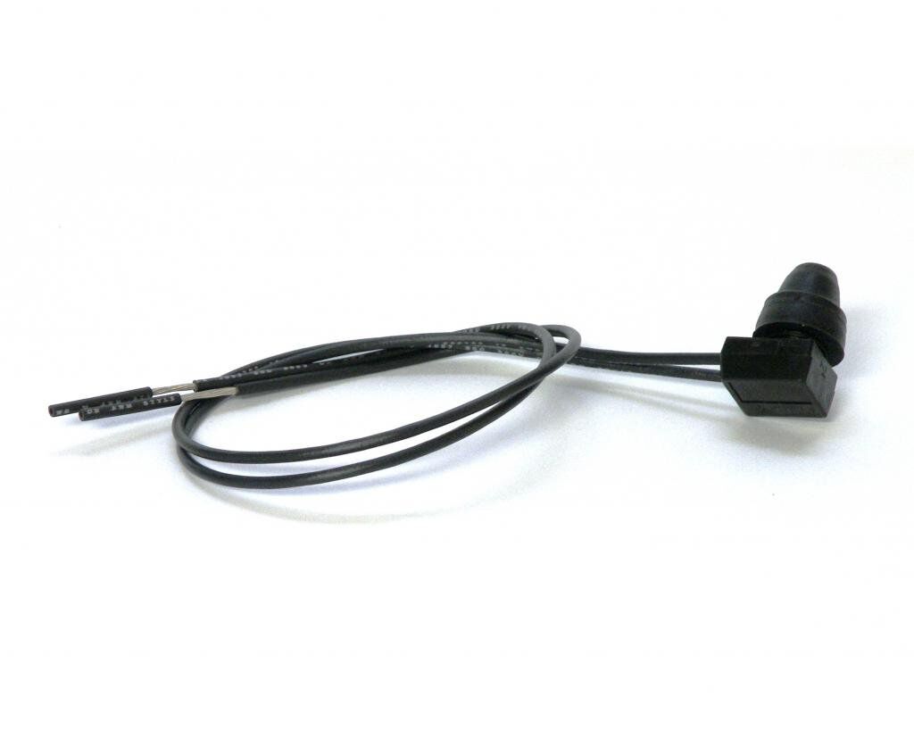

gomotogo wrote:
That's a good idea. I've never wanted to leave it out of my sight knowing how easy it is to make off with. That would add a layer of security. Thanks
If you have a lock cylinder on the side cowl door, you can put the kill switch inside the cowl so that it can be behind lock and key. The switch can be either a toggle, rocker, or push button. I have this style on one of my scooters.

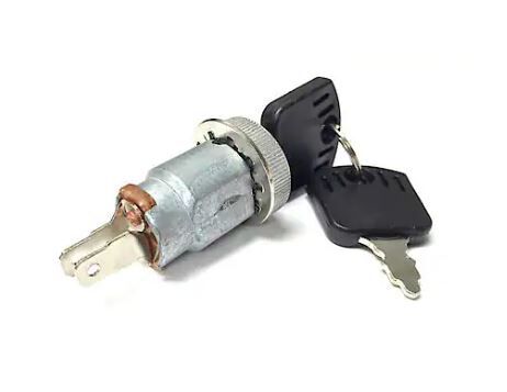

whodatschrome wrote:
wire in a hidden kill switch somewhere on the scooter. Maybe inside a glovebox or cowl? Get creative, but put it in a spot that you can easily access.
Found this. Like the idea of a keyed switch and I could also mount it externally. Thinking of somewhere semi hidden like under seat. Depends if key can be removed after turning tho.

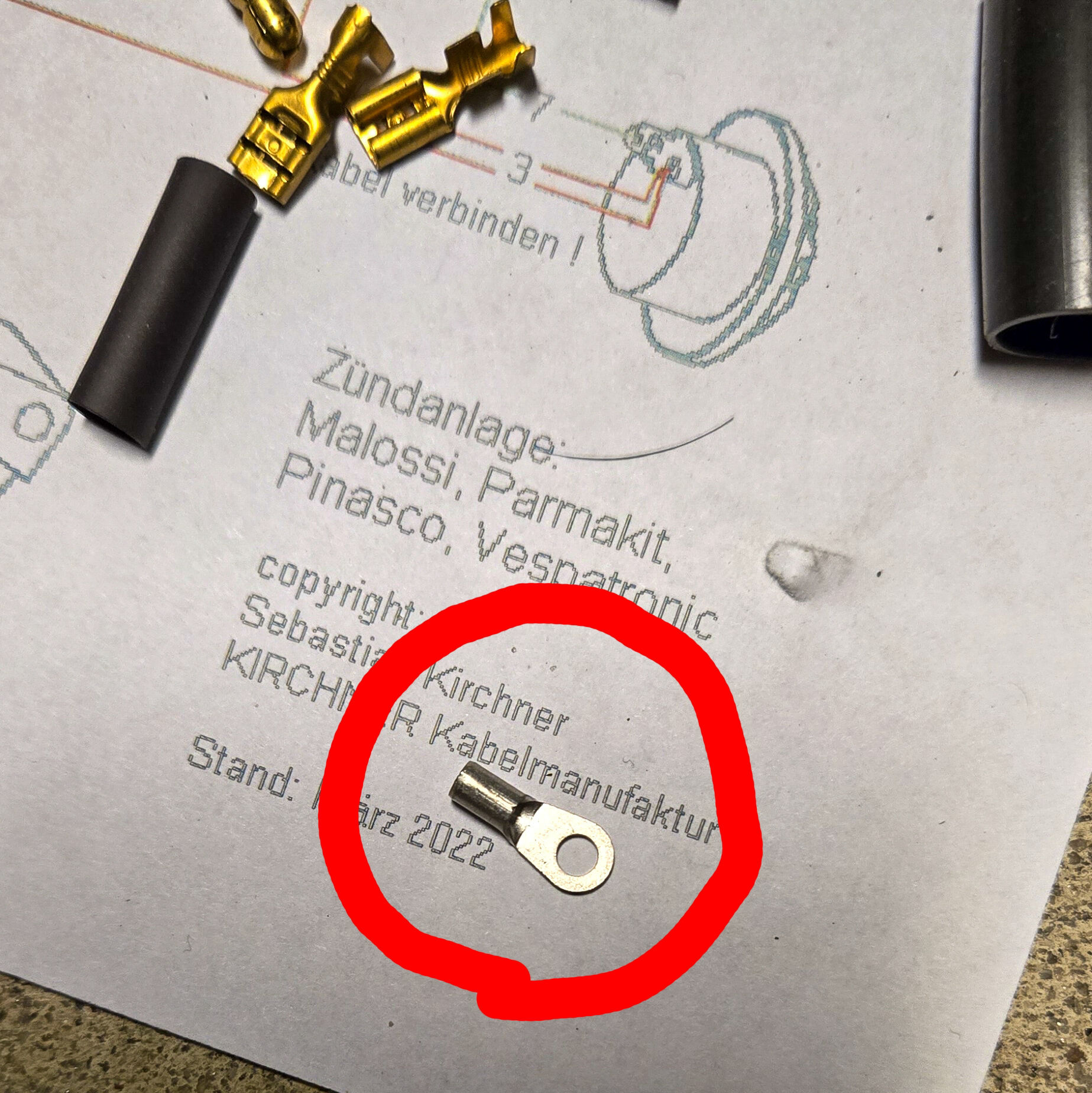

I'm short one of these connectors. Need to know where I can get one online.
Not sure what they're called and didn't have any luck finding info online.
It's a ring terminal. You can get them on Amazon, but you're going to wind up with a whole bunch of spares you never use.
Excellent! Thanks! Clap emoticon
Ring terminal... logical name 🤔

Got it wired up but no spark. Lotta troubleshooting to do. Anyone aware of Parmakit ohm stats for coil and stator?
ETA: Had a hunch it was kill switch wiring and it was. Now has spark and kill switch functions as it should.
