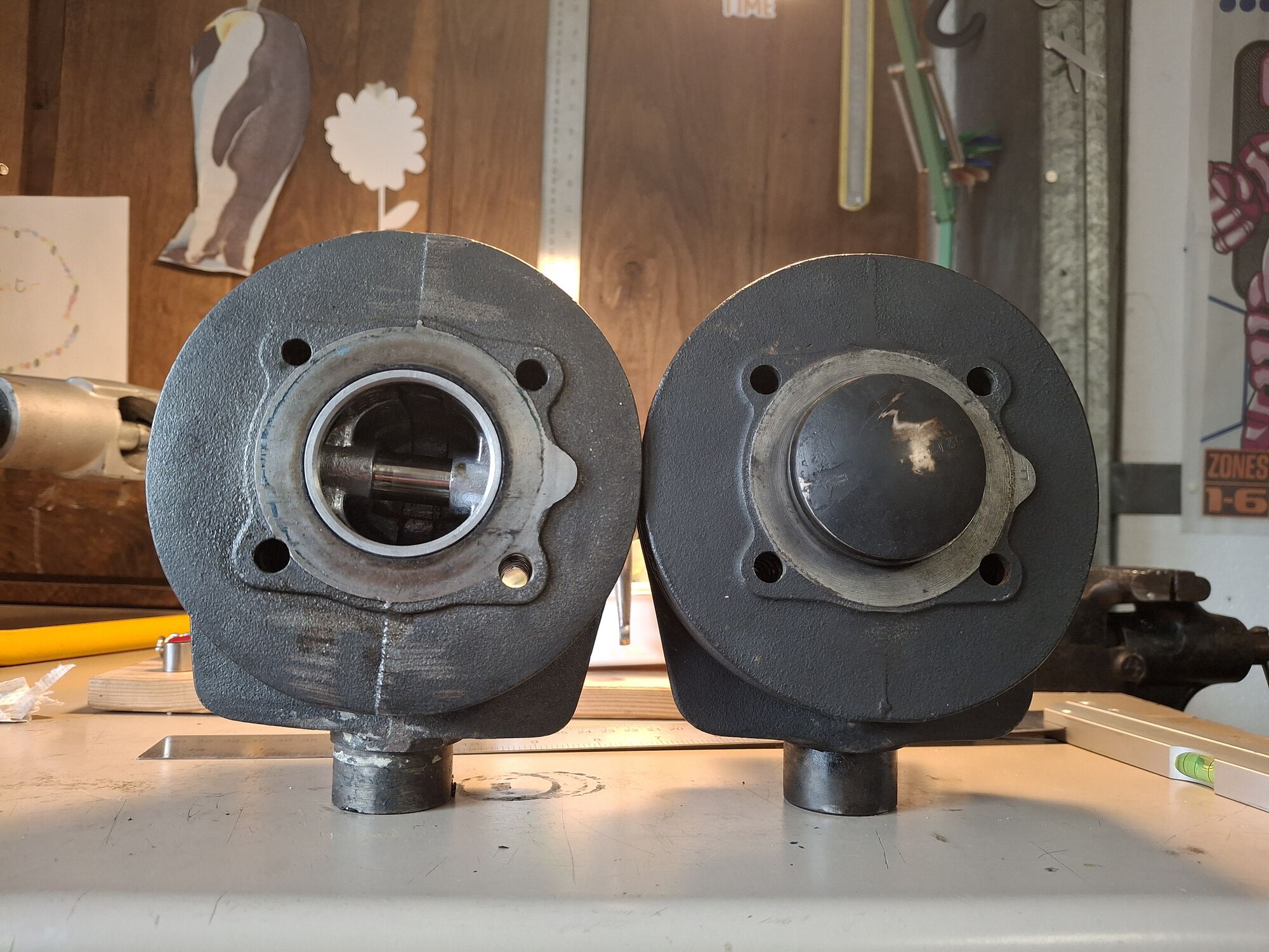

Over winter I pulled out the engine. I took off the cylinder and found that the exhaust port was misaligned (photo below). I should have spotted it before installing, but I just assumed it would have already been done by the supplier. Anyway, no matter - glad i found it as it explained my exhaust sealing problems.
New piston:
So, i took an old cylinder and used that. It had a sloppy piston, so I put a new one in. Ring gap is text book, and I could put a 0.2 feeler down the side of the piston.
Case leak test was ok:
I made I leak test on the case and it passed. I thought this would have been an issue with the carb tuning, but looks fine.
Exhaust port buggering -1mm higher.

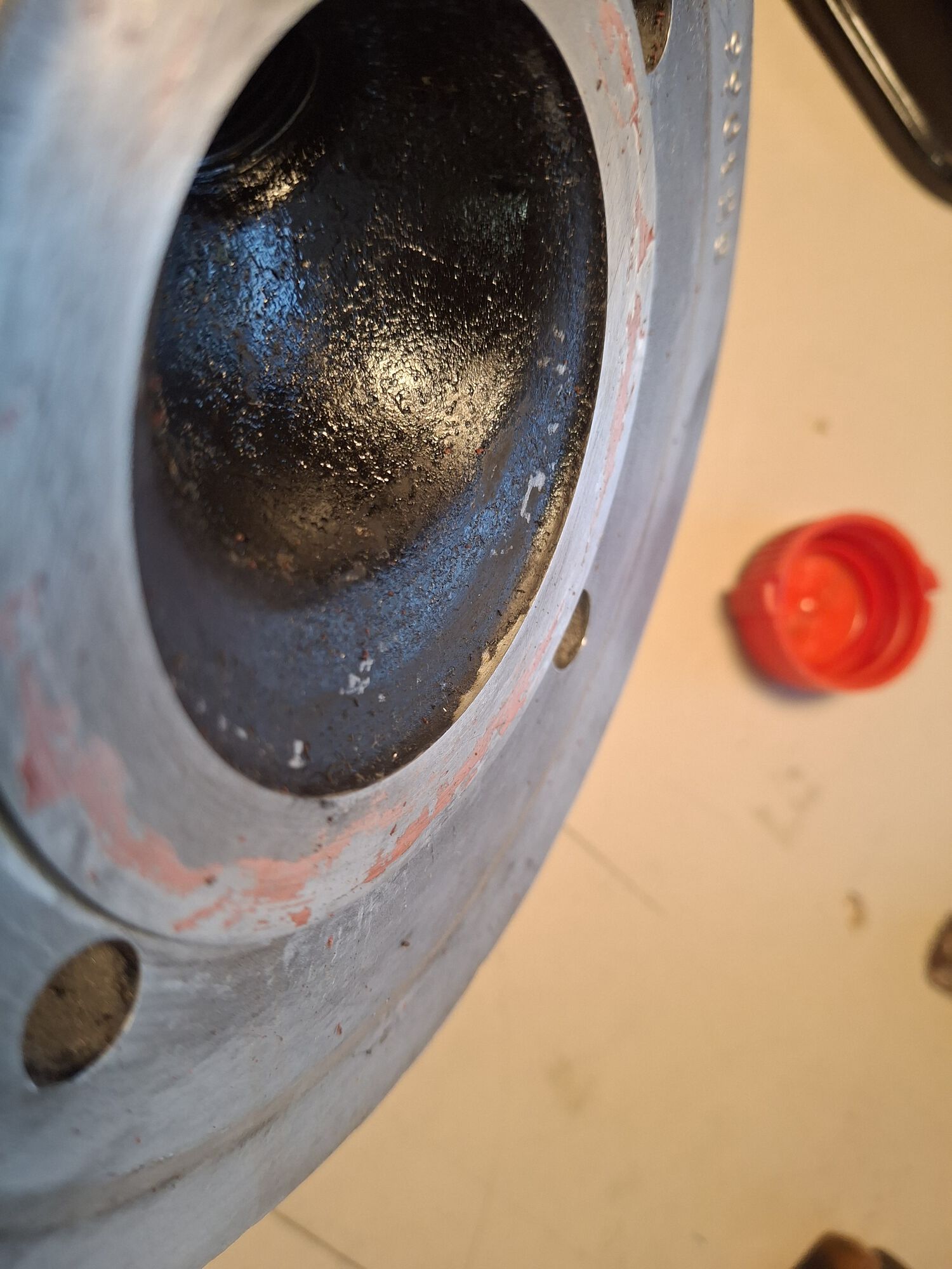

So the piston appears to be the correct orientation.
but it's quite wet. so I guess I'm too rich?
Would an electrical issue cause such a thing? I also had the dashboard off and had to reconnect a wire or two. Could it be that incorrect wiring might not affect idling, but could come into effect when pulling on the throttle?
Well the piston is ok, great. If it runs at all, its nothing to do with the wiring.

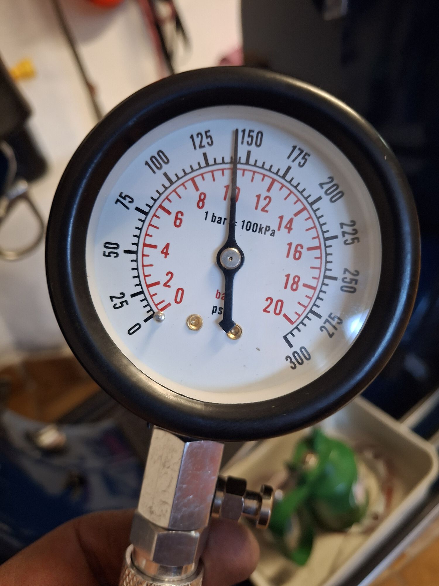

Short update,
this morning changed the piston for an older one, which was with the cylinder when I was given it. I've put everything back together.
I did a pressure test and cold I got 150 or there abouts.
This is like 60 more than before and more than I ever achieved with this scoot.
hopefully it will not explode. I suspect that my neighbours are still sleeping, but once I see evidence of movement I will go for the start up and see how things go.

Hello all and thanks again to all who have taken the time to read and comment.
I thought I would update. So in between the crappy weather I did some tests. I tested with and with the 1mm spacer and also with old piston and a newer piston.
I found that with the spacer, it was difficult to get things running smoothly with all sorts of carb adjustment etc.
without the spacer, it was easier. I think the higher compression is probably helping. So I think I'm at a reasonable good place for the moment.
my exhause appears to keep developing leaks, but when it's tight things feel OK. So I think we are good for now. especially helpful we're the jetting suggestions.
thanks again
