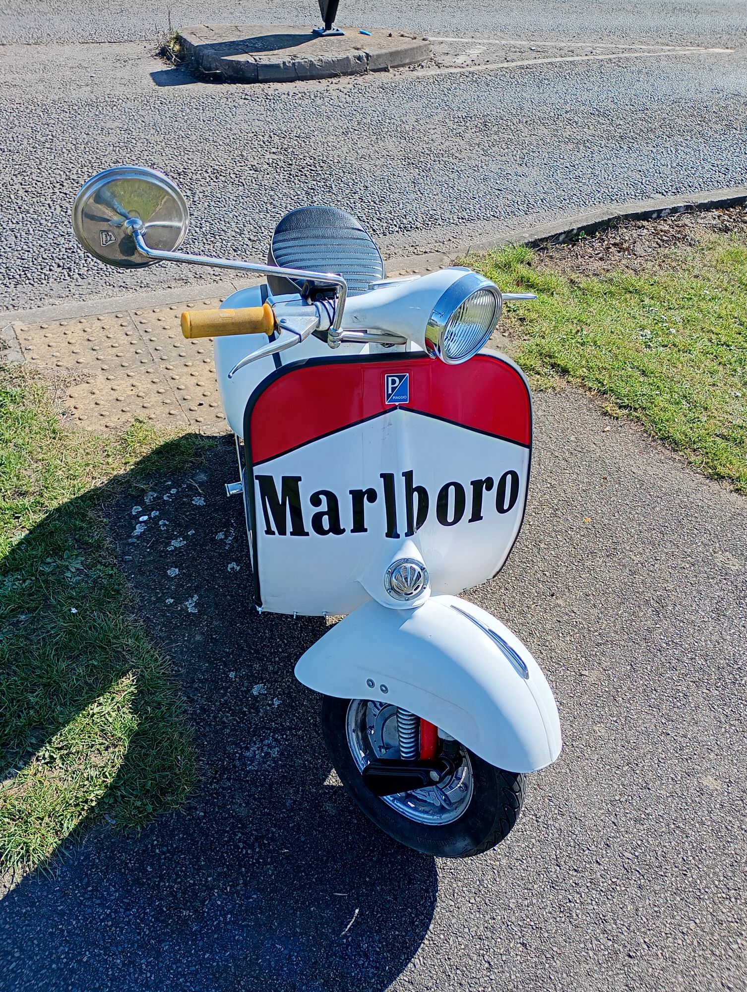

First of all a quick introduction, I've only previously been a lurker on the forum. I have an Indian built Vespa that I've been restoring on and off over the last few years (not perfect cosmetically, with a rattle can paint job). With plenty of hick ups just when I thought it was ready (dried crank seals, leaking fuel tank, clutch bushings etc.) Although it is now just about ready for summer, and I've completed probably around 40 miles running in the new piston.
I was out yesterday, and the bike cut out and had no spark, checked the obvious and it looks like the CDI/Stator might be at fault. Upon further research it looks like the CDI (Ducati) isn't suitable for the stator (External pick up), The stator was always on my list to replace anyways, as the wires look a little brittle, and I'm not skilled enough to re wire and standard stators are fairly cheap.
The question is, can I replace the stator with a non external pick up type? or is anything else needed (flywheel etc?) I already have the mounts on the engine for the Ducati CDI, and I no longer have the original CDI that came on the bike. So it would be easier to replace both to the non external pick up type if possible.
Many thanks in advanced
