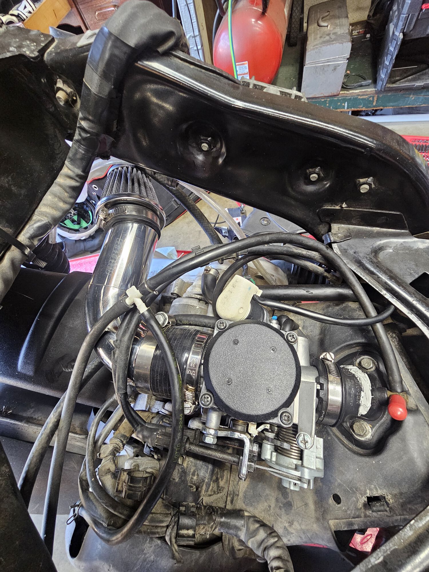

Do you have the original airbox? I see the k&n type filter and it's off--I wonder if it's getting too much air, or it was messed with (jets-wise) to make that filter work. If you can't get it started, I'd revert to standard config, airbox/filter/jets/etc, for troubleshooting. And check compression after that.

Thanks for the reply, ok I def didn't use those specs, so I will redo valves. Airbox was connected (there was no filter element), I disconnected the airbox hose because I cleaned the carburetor, and left the carb intake open because I figured to initially start it, I'd use fluid /carb cleaner... why? do you think having it open is creating a problem? never has been an issue with other scooters I've done that to (to initially fire them up only).

I think it was YouTube or some online articles somewhere. So because I'm missing the airbox cover, I'm gonna jury-rig a cone, and see what happens. If I somehow can't make that work, I'll spring for one on ebay and get a whole new (to me) airbox.

So did my mod...stock intake hose and cone filter (mainly because as I had mentioned, it didn't come w a complete airbox). Cold start is an issue, once I introduce carb fluid or gas down the intake, no problem... so I'm thinking the choke plug may be bad??? I can also try to restrict the cone filter and see if that helps, but my initial feeling is that maybe that choke electric plug isn't working...thoughts? My buddy, big dirtbike guy, suggested I go with bigger jets, because I am now introducing more air... a possibility, have to see if I have jets from other keihins that may fit.

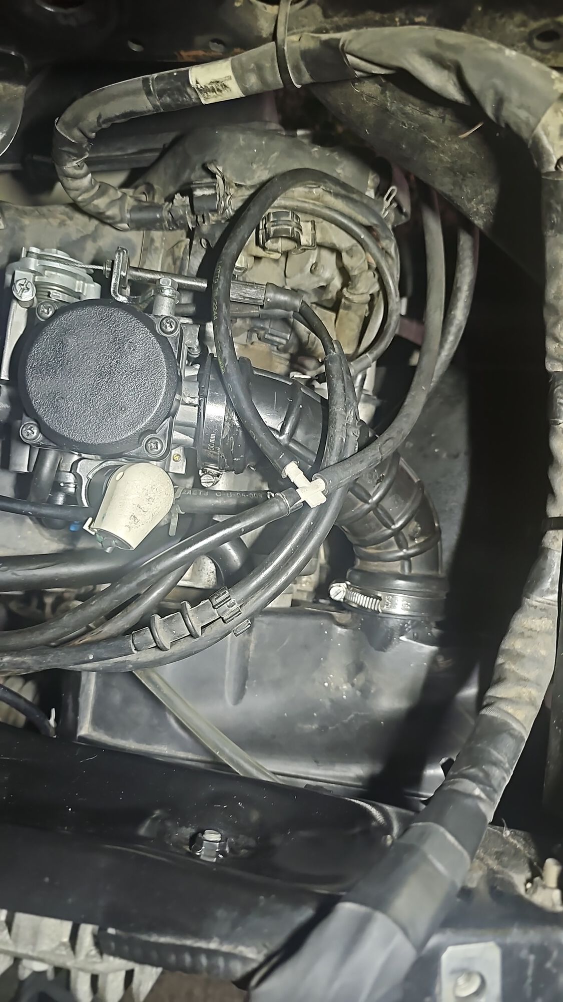

What I would do:
Before anything else, replace the intake manifold. It's in bad condition and is almost certainly allowing in air, causing a lean condition. [edit: airbox hose is also looking pretty shabby.]
Secondly, get a stock airbox. You got the scooter cheap, spend a few bucks here. These were designed with certain parameters and you're way outside. How far? No way to tell. Chasing the imbalance with bigger jets is a needle in a haystack, and even if you get the mix right, it's still too much juice for what the scooter was designed to do.
If these two don't fix it, remove and rebuild the carburetor. There are videos that show how to do this, in real time, and it only takes an hour. Twice that for pausing and getting out the stuck screws. Simple carb, and tbh, replacing anything in there is optional if not tatered. Just take it all apart, clean it really well, and put it back together. Keep the idle screw in the same position and document the position of the mix screw and it should be close enough to go when it's back in.

Sorry been away for a bit on travel. So I removed the carb again and cleaned thoroughly. Ordered the stock airbox (not here yet). So once again as you can see I have my skunkWerks intake Razz emoticon
Cold atart still an issue, but with a lil carb cleaner sprayed, it starts fine, idles good and revs no problem. Here's the 100k dollar question: which I um failed to mention before but now that I think of it I should. I used a much weaker battery for all this, since the original (bigger battery) was dead on arrival. I have a cheap china 50cc scooter battery. Could it be that it doesn't have enough cold crank amps to get the scooter going when it cools down, but enough when it's already warm? But then again, when I introduced fuel spray (when cold) the cheapo battery does the trick... I dunno, thoughts? Anyway. I should have the airbox installed mid week, and will report. BTW, there were no cracks going through on that header, just some superficial stuff which I filled as you can see from the pics.
