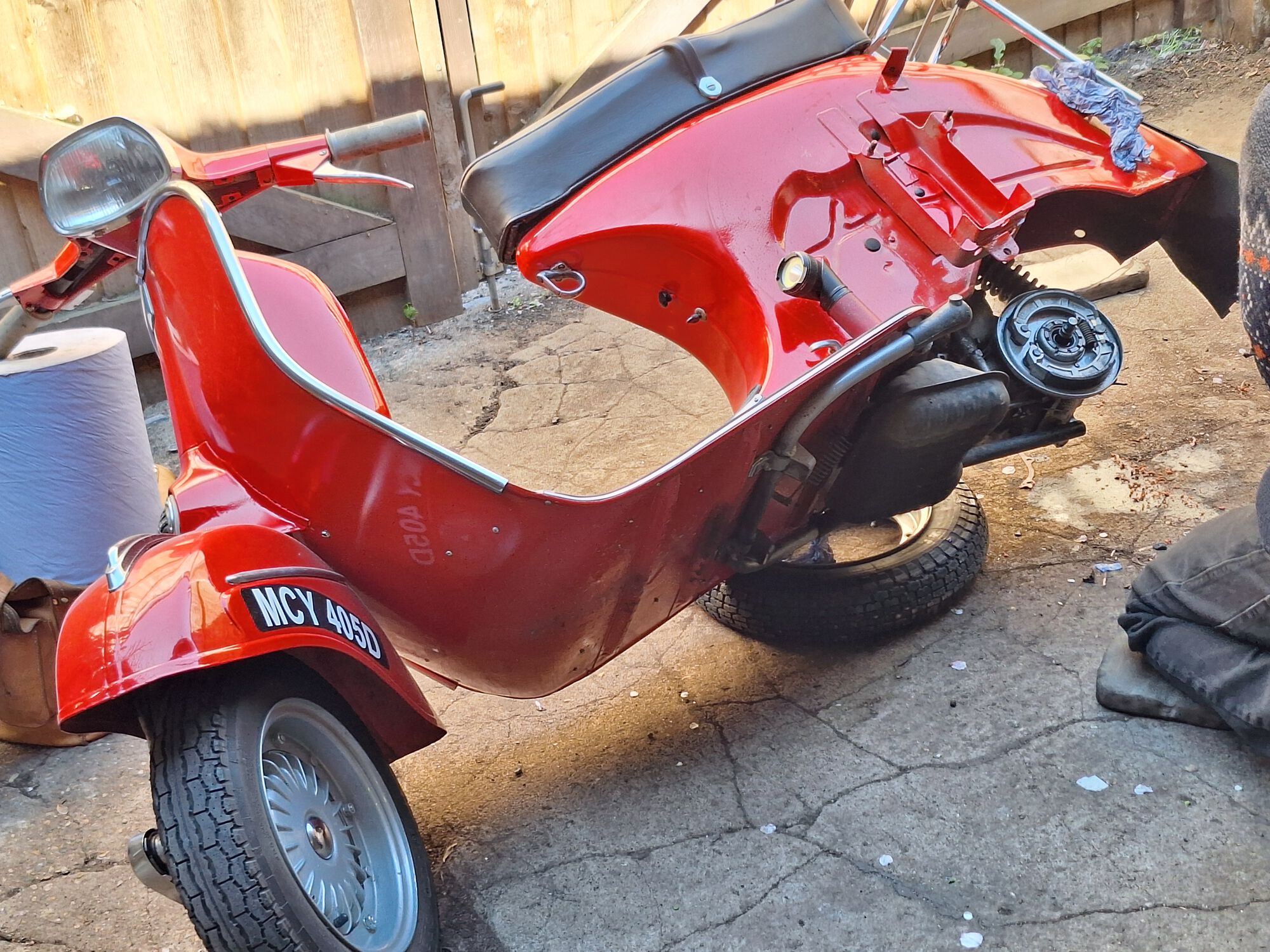

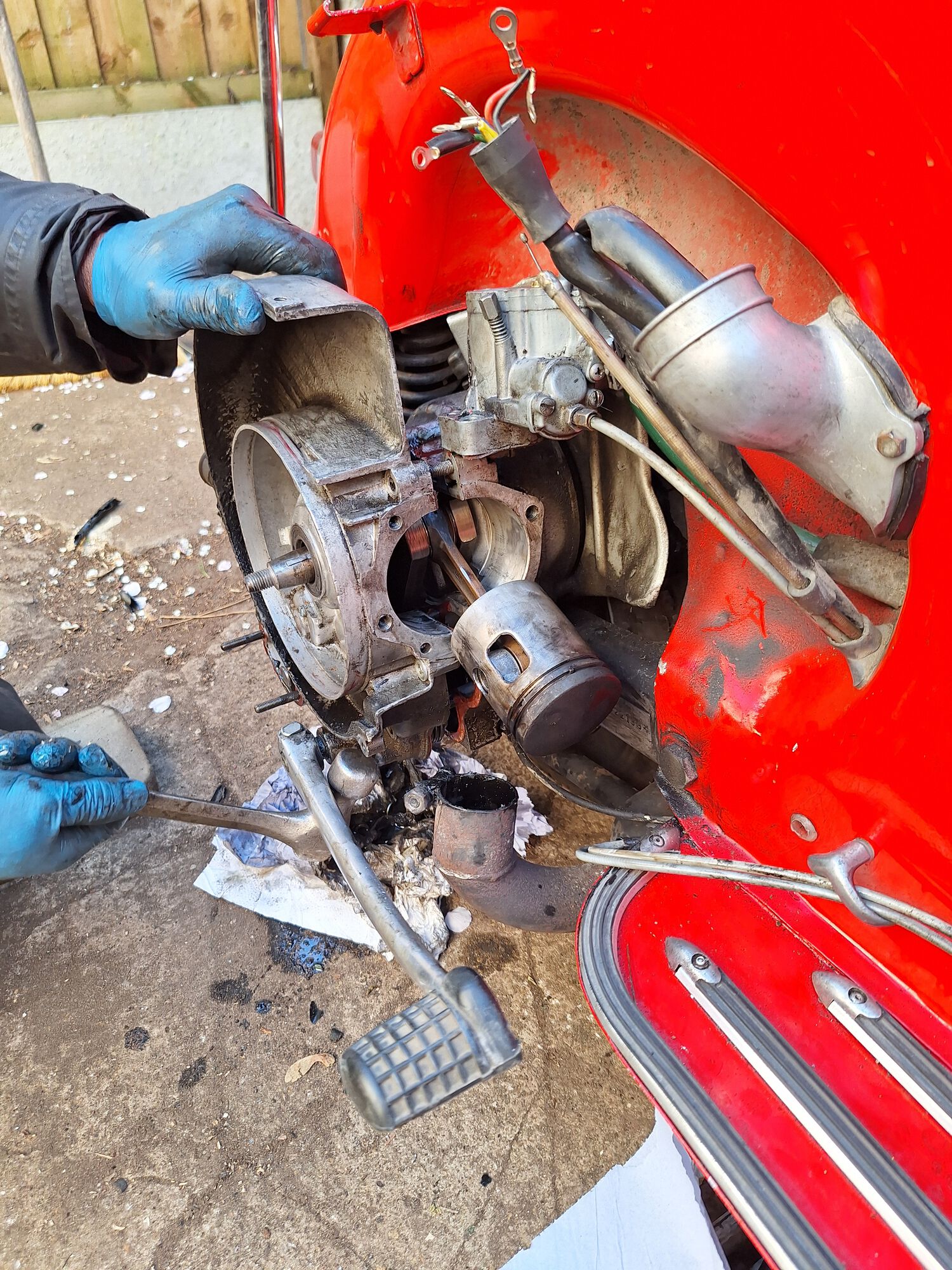

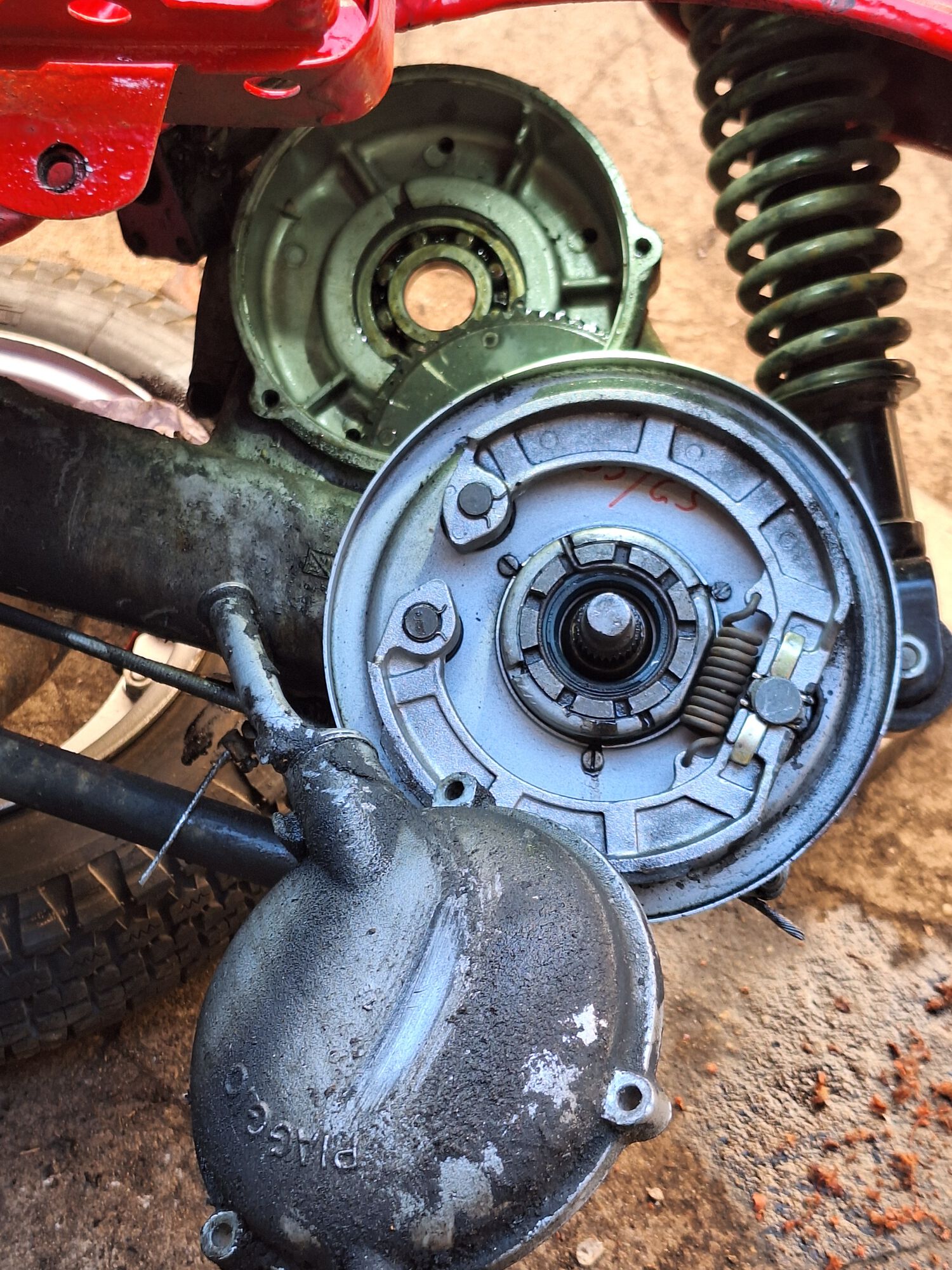

Engine split.
[/img]
Posts: 9946
Posts: 9946
In situ.
Color me impressed

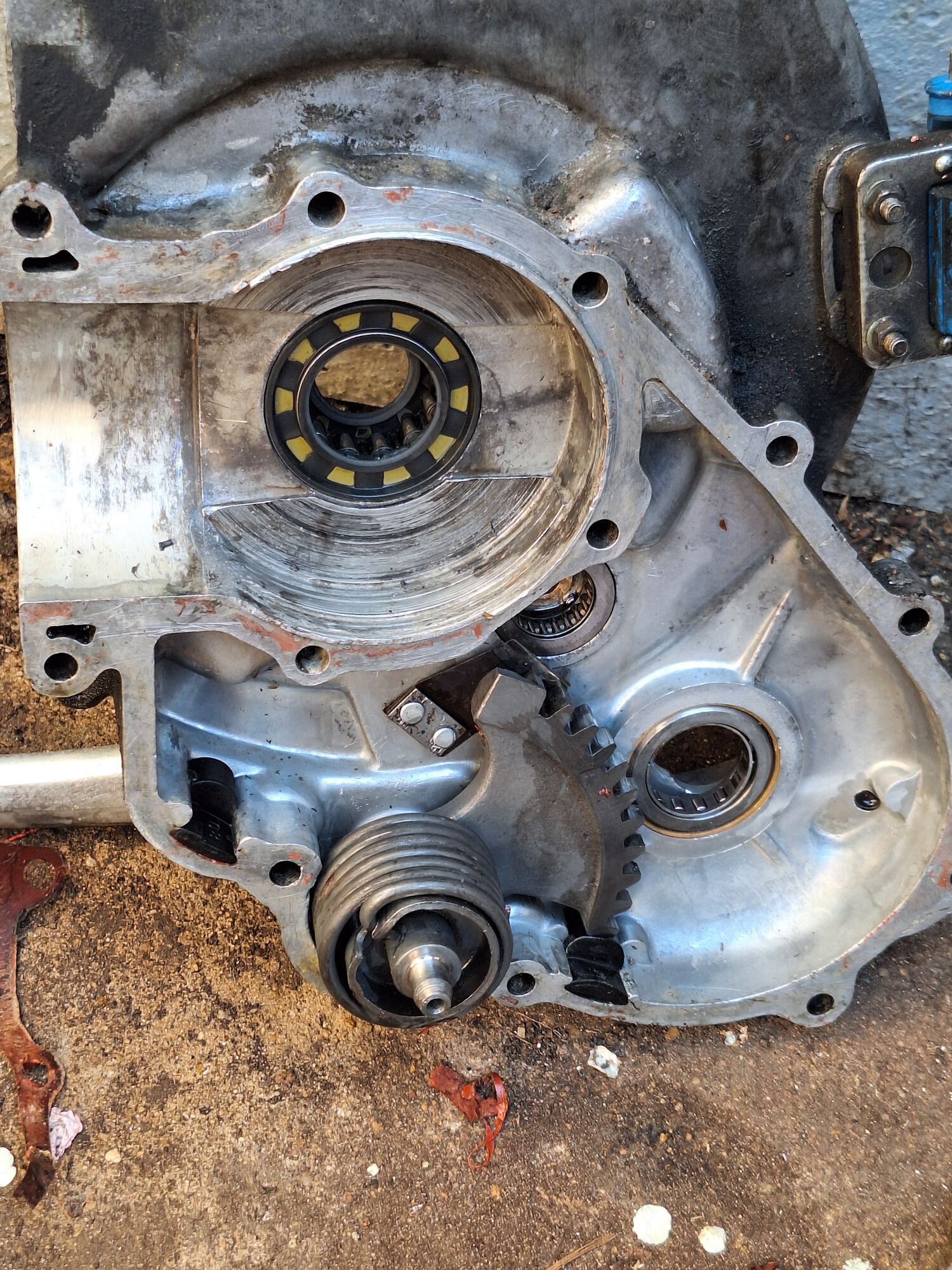

Seals in one side. Bike flipped old school. Now onto the next...

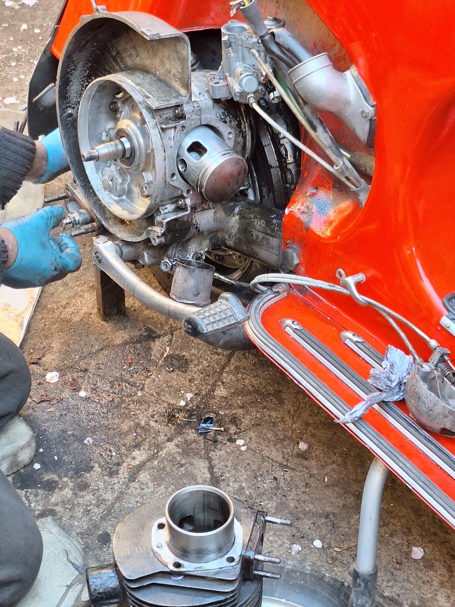

Going back together...

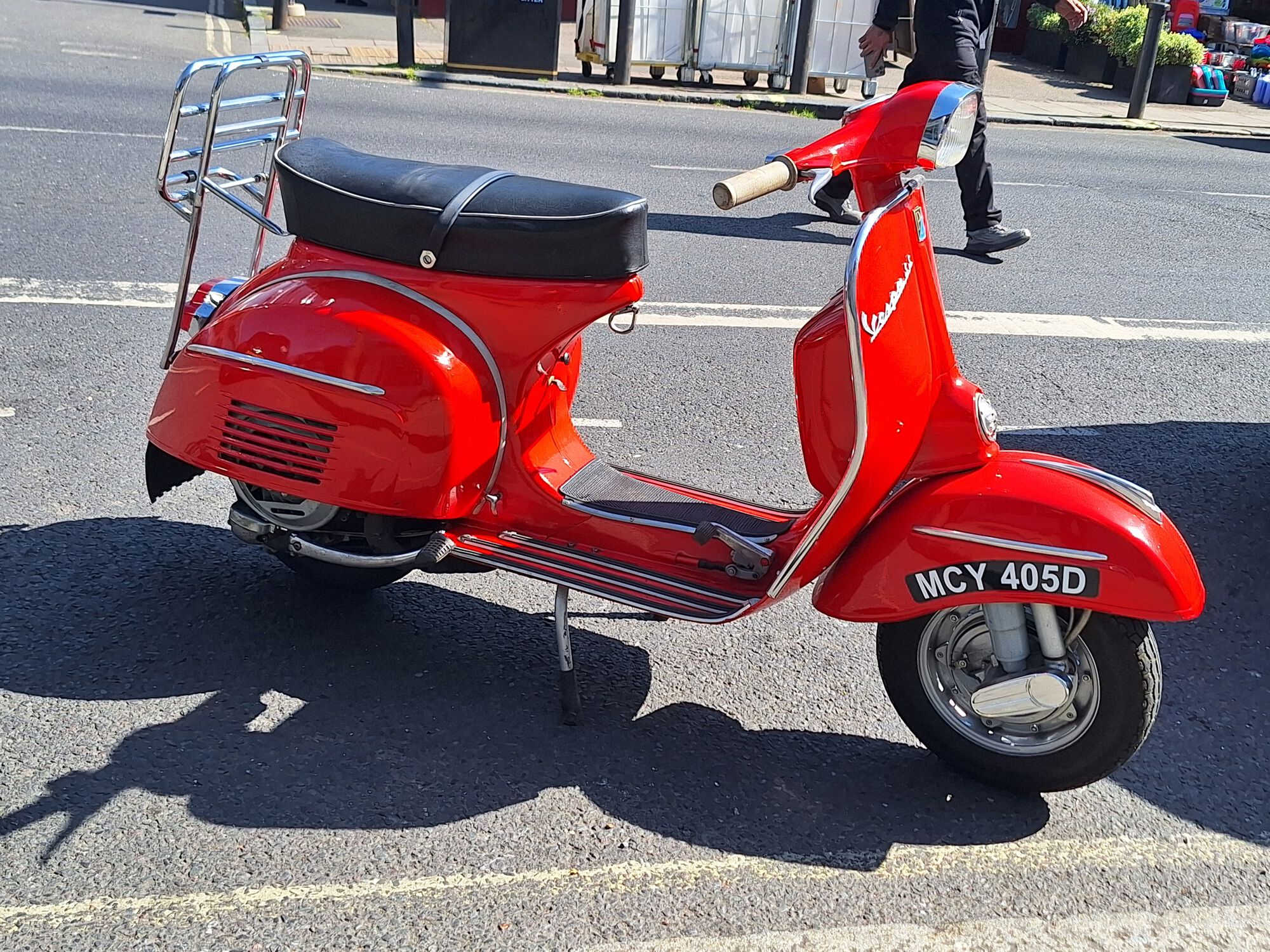

It lives. Lots of gunk in various parts of the carb cleaned out. New seals and gaskets, stator wiring replaced, points adjusted. Now running properly and not spewing oil.
Posts: 9946
Posts: 9946
Right on!
...and damn it is a looker!
SS180, GS150, GS160, GTS
Posts: 84
Posts: 84
Thanks. It looks cute but may be the devil incarnate. After this photo was taken it completely refused to start and is now back in the garage. Grrr. More fettling to be done.

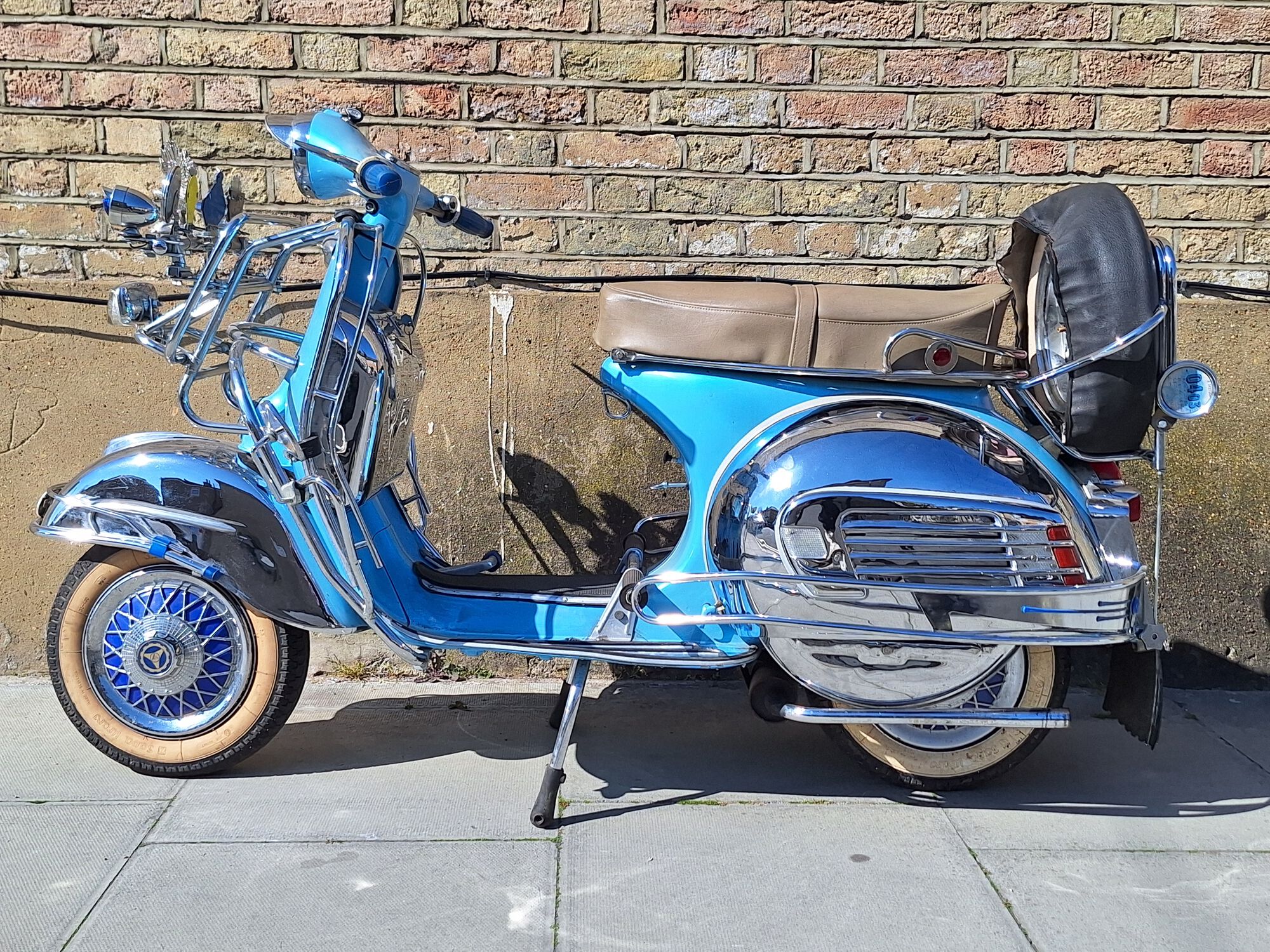

This GS160 works though (put your sunglasses on and hold back on the comments please - I didn't do it):
@metadaddy avatar
Posts: 322
Location: San Jose, CA
@metadaddy avatar
Posts: 322
I dunno about anyone else, but I like it!
Posts: 84
Posts: 84
Thanks! Not sure it's my cup of tea but it fits a certain British mod style.
Also what happened to the original front mudguard, cowls, engine shroud, etc etc. Why do people do these things to an original Vespa?!?
Anyway, up and running and on Ebay: https://www.ebay.co.uk/itm/135688938540
