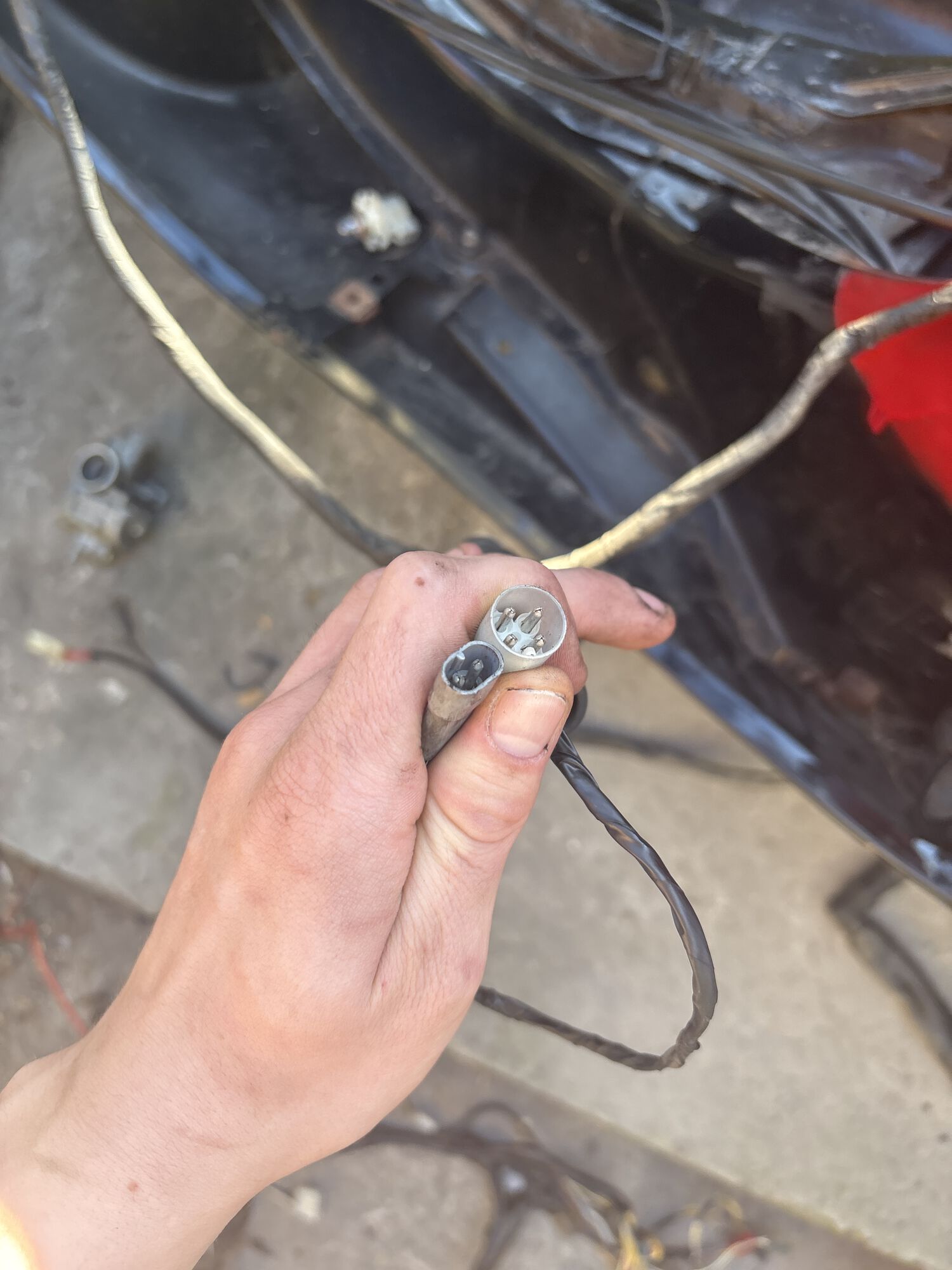

I'm installing a new wiring loom and the one I bought is a 2002 et50 Pago but doesn't seem to have the right connector can anyone give me a hand please

The 4 PIN connector is from ET 4 125, the light has 3 bulbs, ET of 50 will have a light with 2 bulbs. You can make a cable bundle and connect it to the old connectors.
