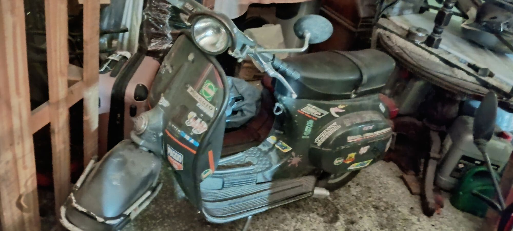

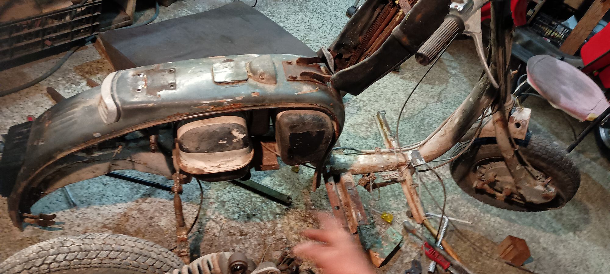

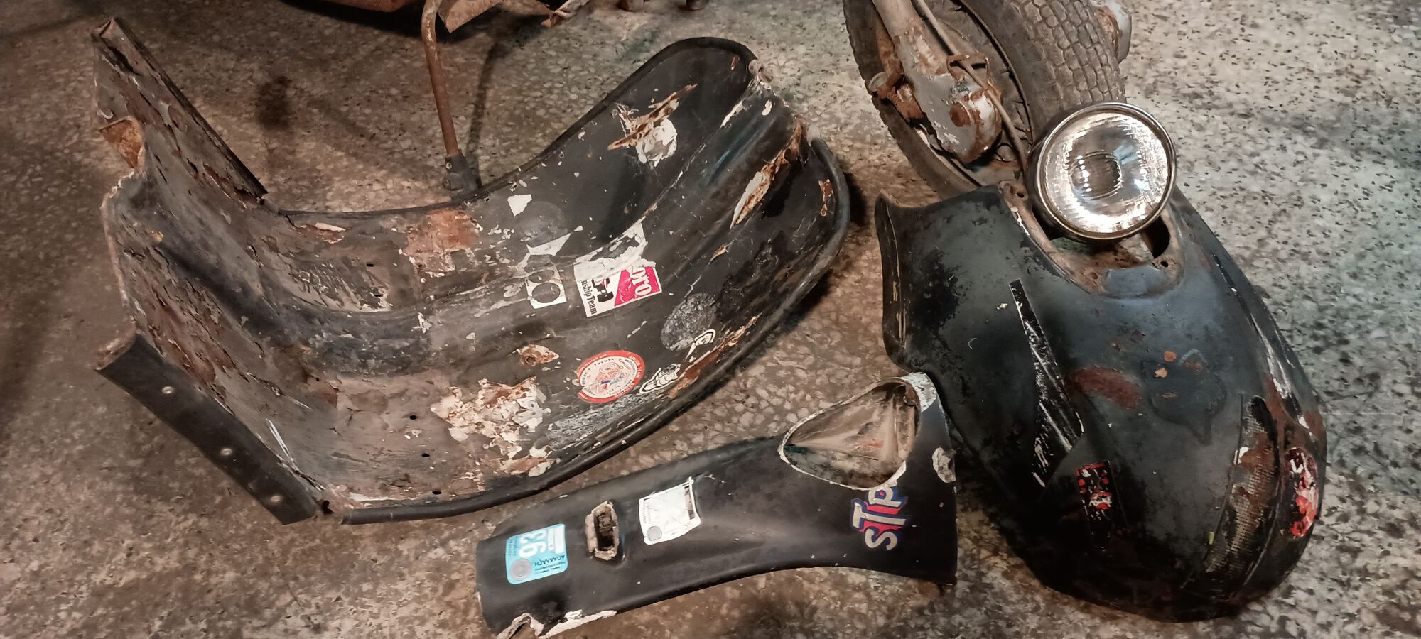

Here's all the stuff we removed. Yanni got frustrated with the M6 bolts holding the floor section on, He snapped two off after trying to ease the nuts off from underneath, so he used the angle grinder w/ cutoff wheel and said " OFF WITH THEIR HEADS!"
Half naked frame:

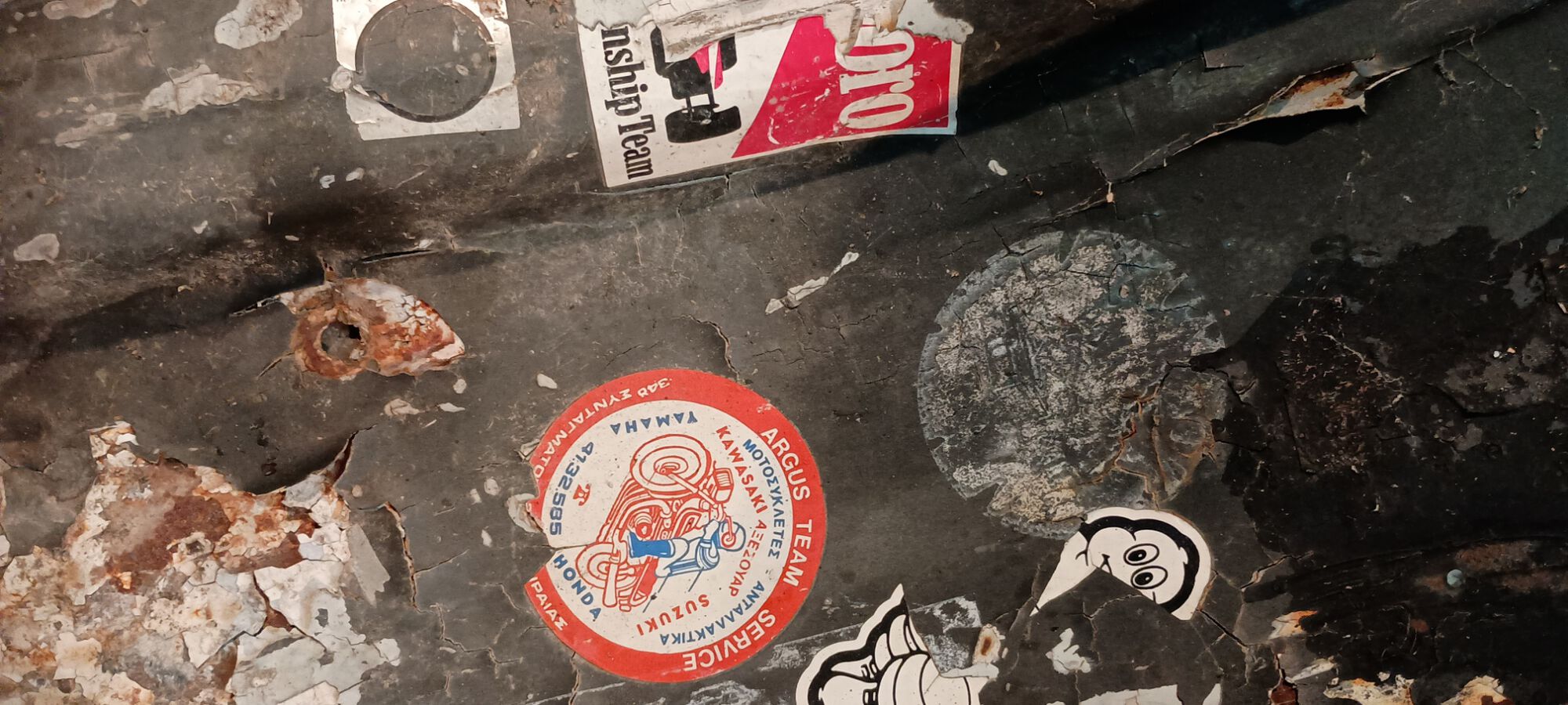

Old dad put some interesting stickers here & there, reminds me of my second Vespa here that came with even more.
This is the one. It was in worse shape than this Lammy in some ways, the floor & mudguard rotted out but was mostly complete. I literally rescued it from the garbage 16 years ago.

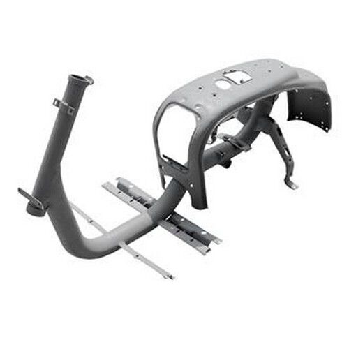

BTW, can somebody please tell me where to find the VIN?
Looks like we are headed here eventually.

That's called the frame loop. It's not detachable unless you cut it off. The frame numbers are on the tube frame kickstart side of engine area
V oodoo wrote:
Yeah, I'm realizing that it's not so easy, and how much simpler Vespas are. I was hoping that big curved panel on top of the frame would come off but looks like that's a big NO. Crying or Very sad emoticon

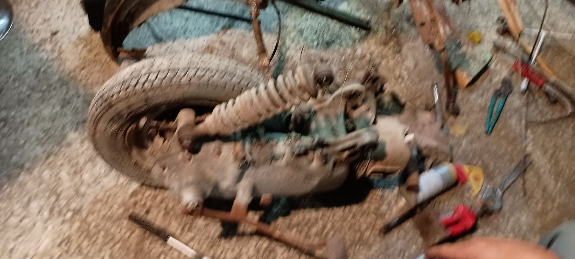

We got the motor out w/ the help of one of the previous vids, but not so easy - we cut some stubborn cables that will be replaced anyway, the muffler was a bitch to get off the header pipe and the worst was the frozen main engine mount bolt which slid out so nicely in the vid. 100+ blows w/ small sledge hammer on a drift before it finally started to move. YAY!
The motor will be sent to an experienced Lammy mechanic a who can go thru it and properly deal with all the fiddling needed and has done it before. Hopefully I'll be back in the fall, everything is ready and we can put it all back together again.

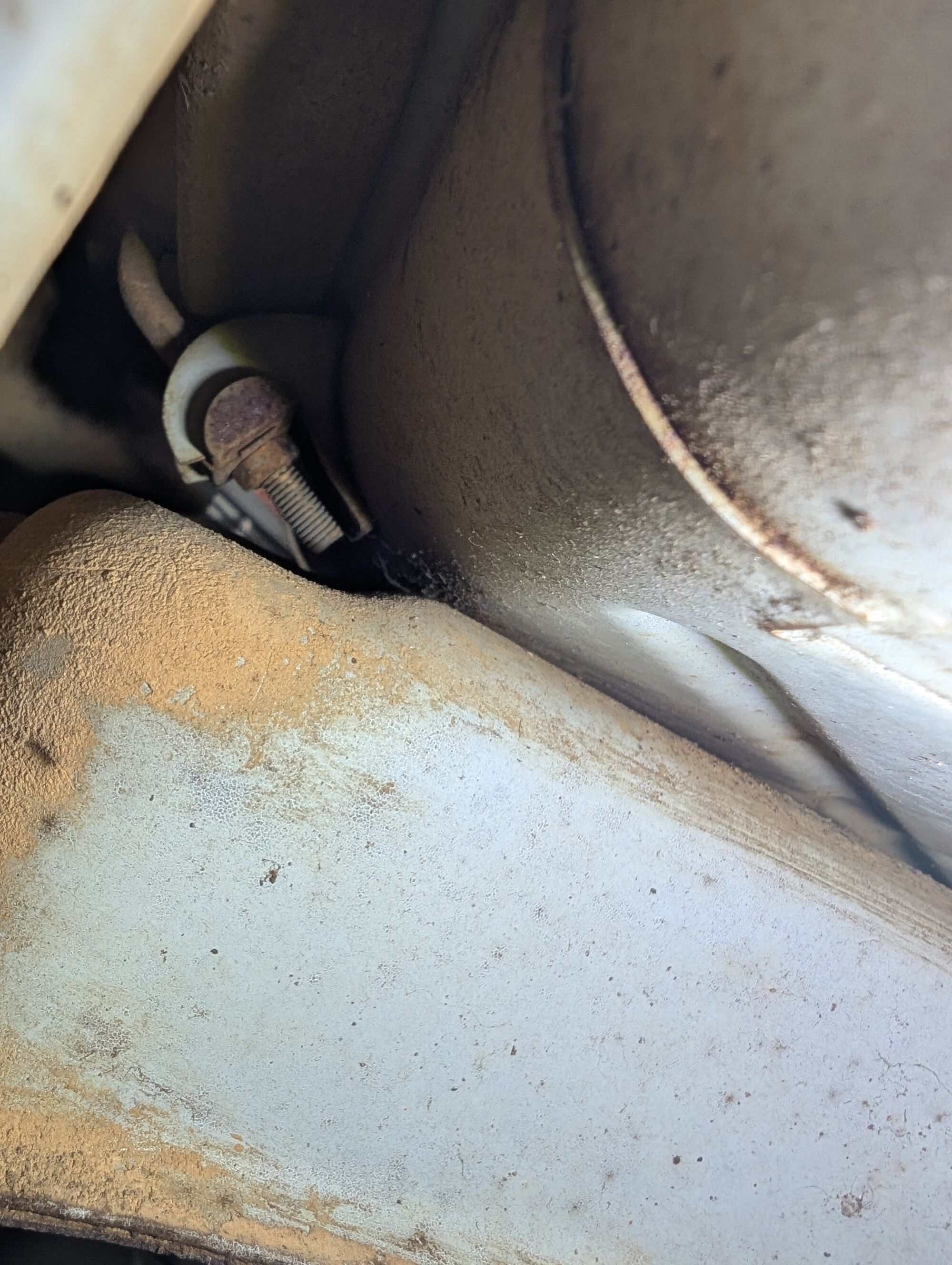

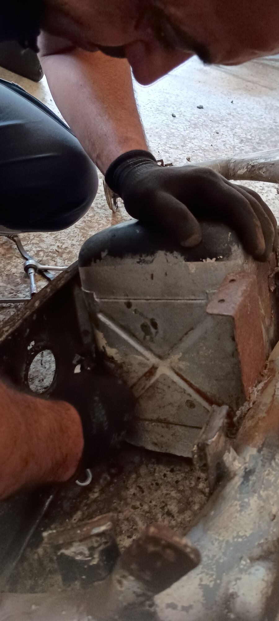

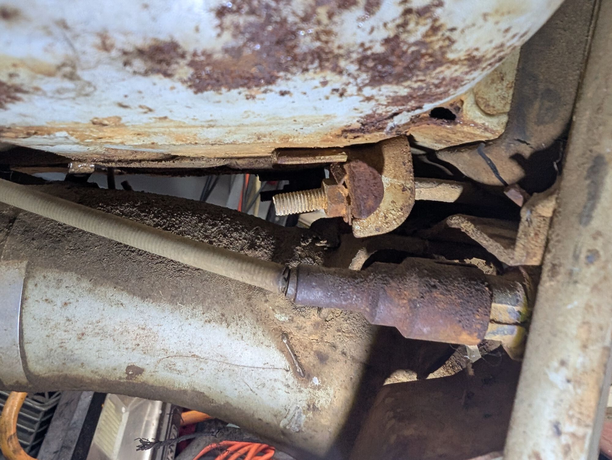

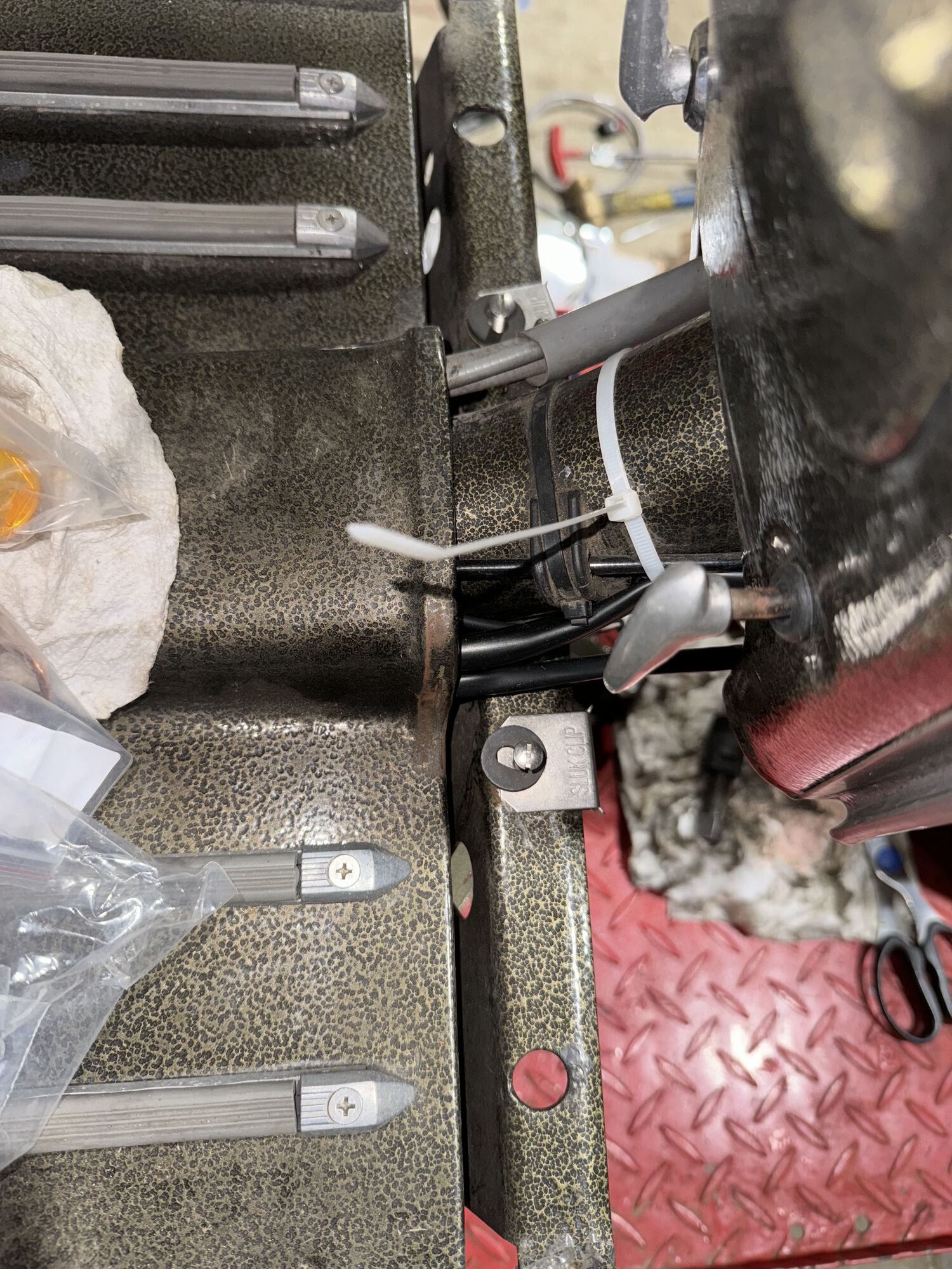

Terry, per your question, here are the locations of the toolbox holding bolts.
Once those are removed, you can work the toolbox loose from the rubber gasket that's probably gluing it in place.
Since you're going to do it anyway, removing the air scoop and airbox first will make the job a lot easier.

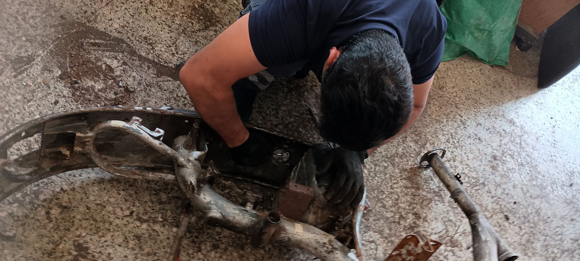

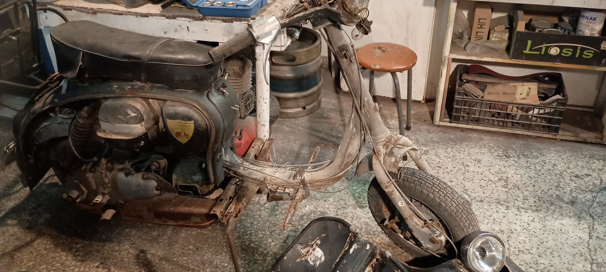

Great Success! We have finally reached naked frame status, but it was a helluva battle with so many not easily accessible rusty 8mm fasteners and Facepalm emoticon
Goal
Goal
and finally achieved!
HARD work
HARD work
Going in deep
Going in deep

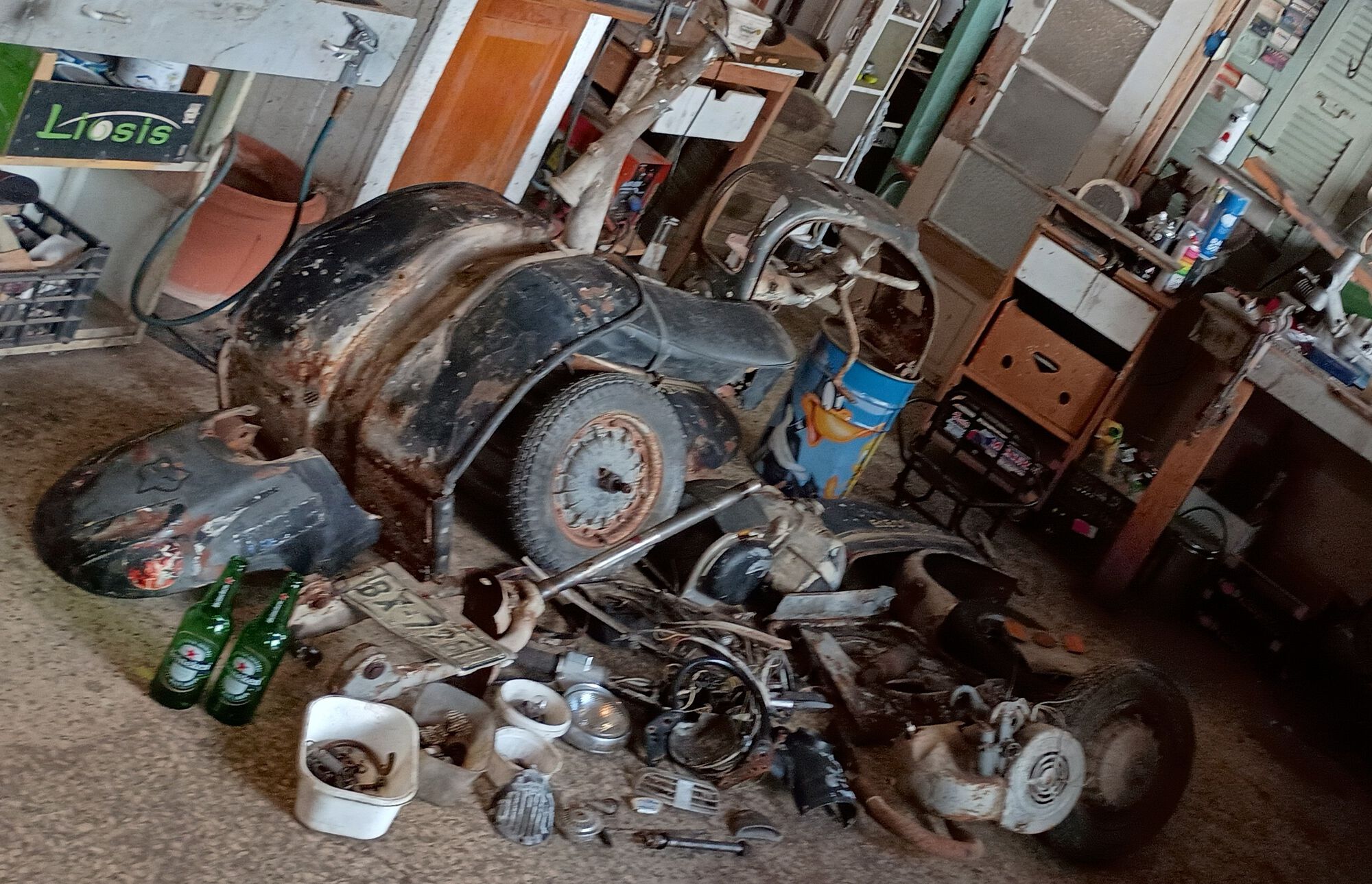

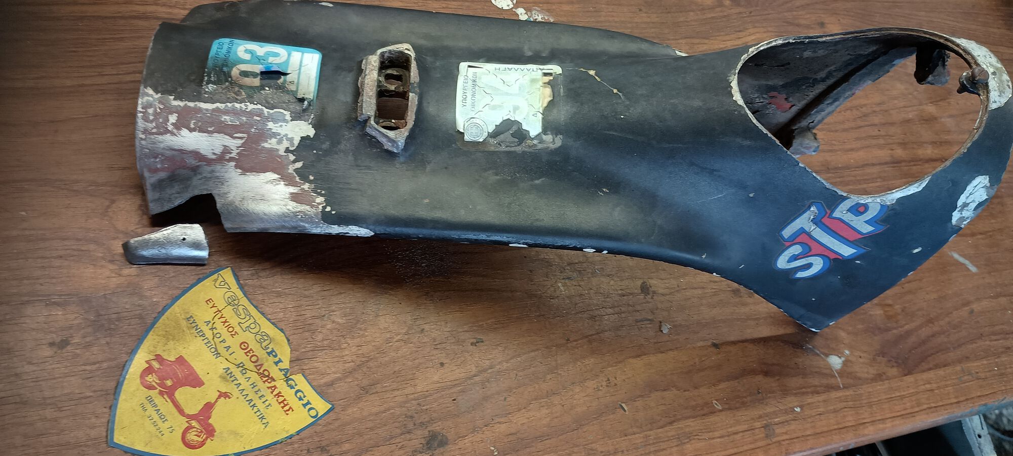

A few more pics of what we wound up with. Or early Lambretta kit, mostly all there, 2nd hand and some assembly required.
So many PIECES
So many PIECES
INNOCENT(I)?  Gimme a break!

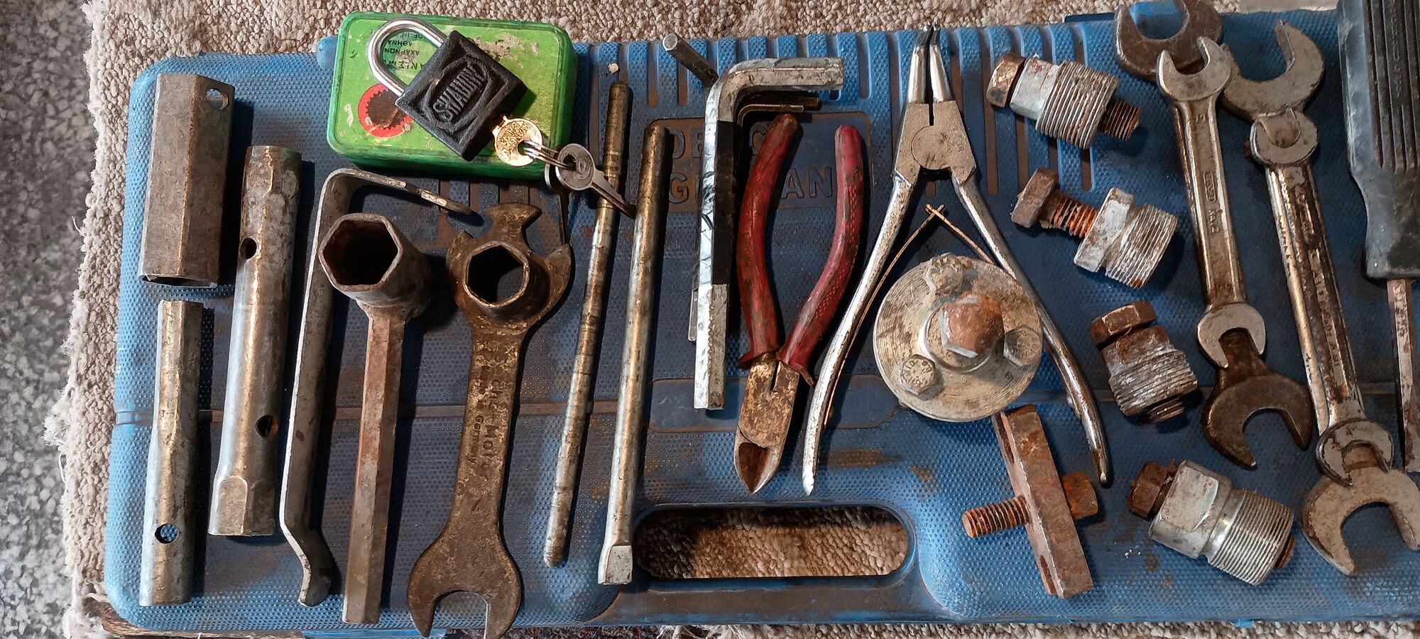

What was all that rattling when flipped over? We finally open tool box and see that Dad had a fair collection of tools.

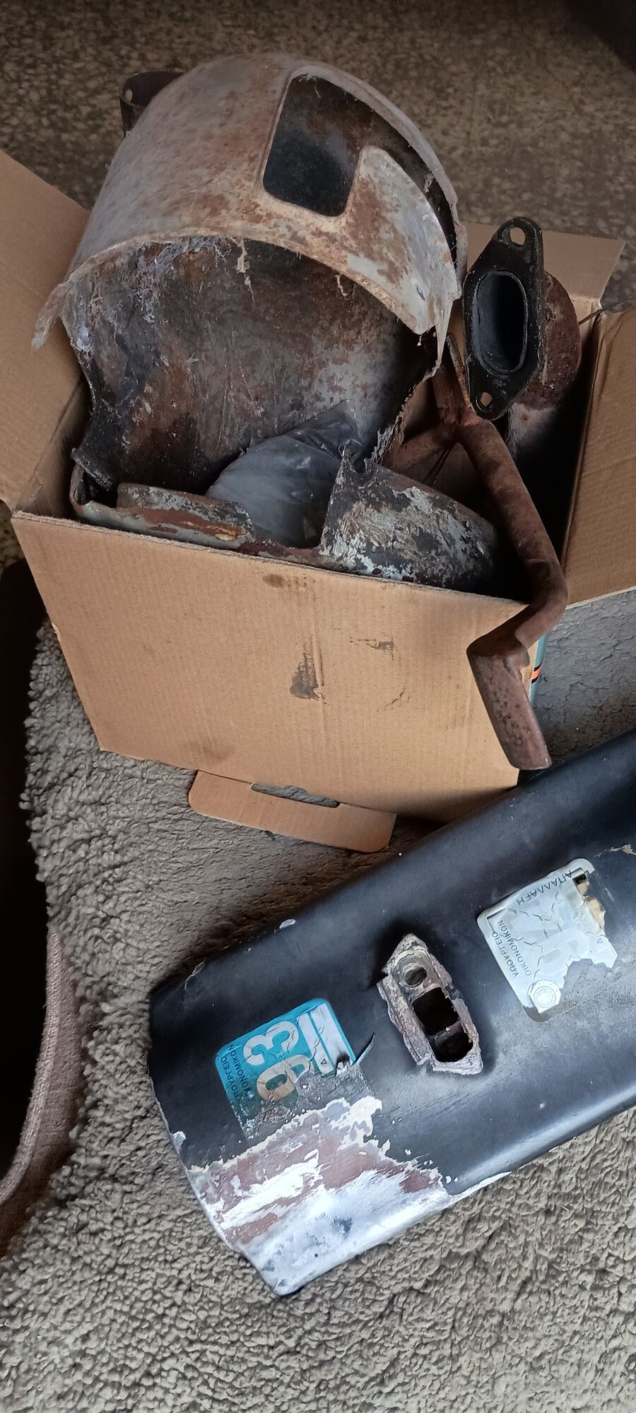

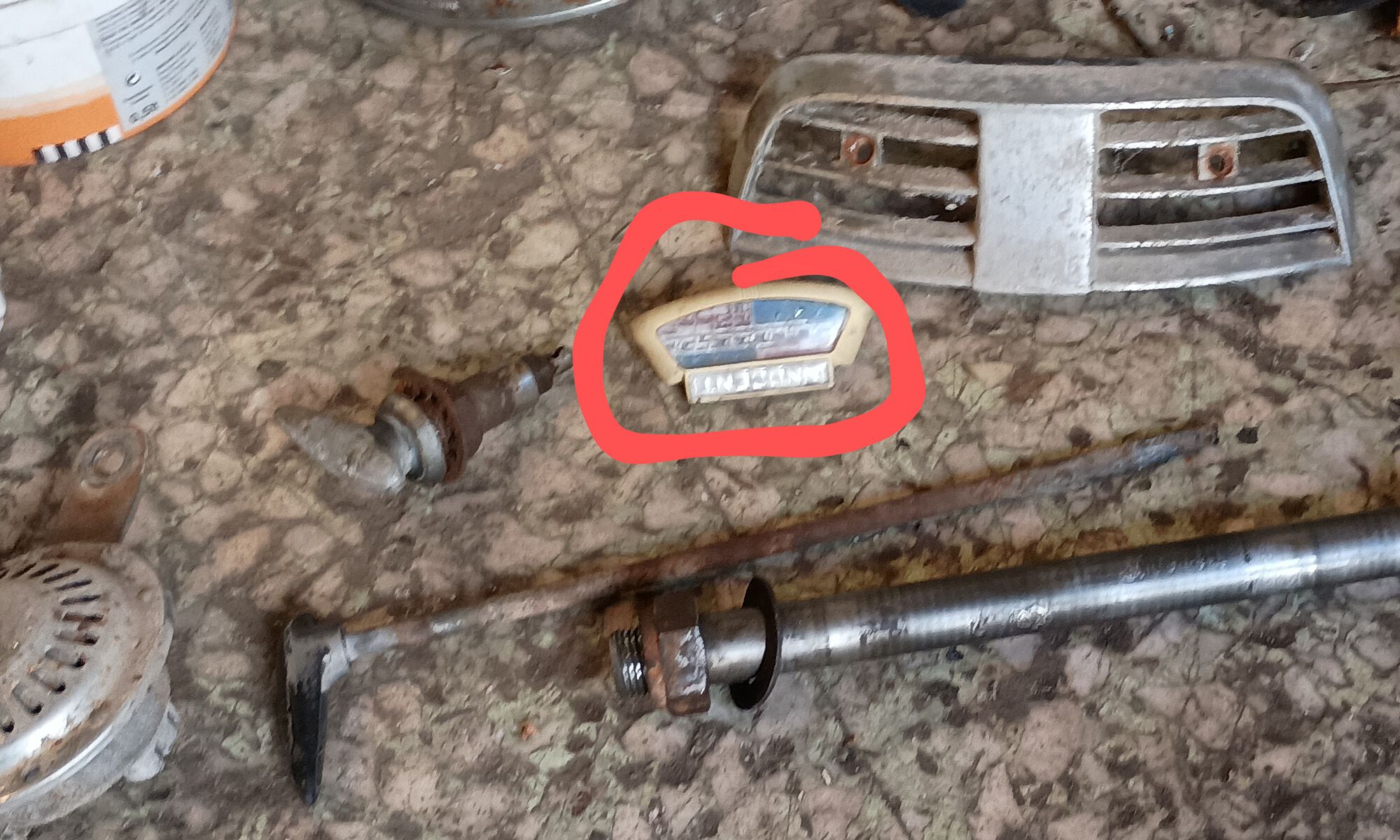

Those of you w/ sharp eyes may wonder where the horn cast is.
It's on its way to Sir Kostas Boutos who has bailed me out more times than I can count. He'll TIG weld it good as new. The old Vespa Service sticker is staying w/ ME!

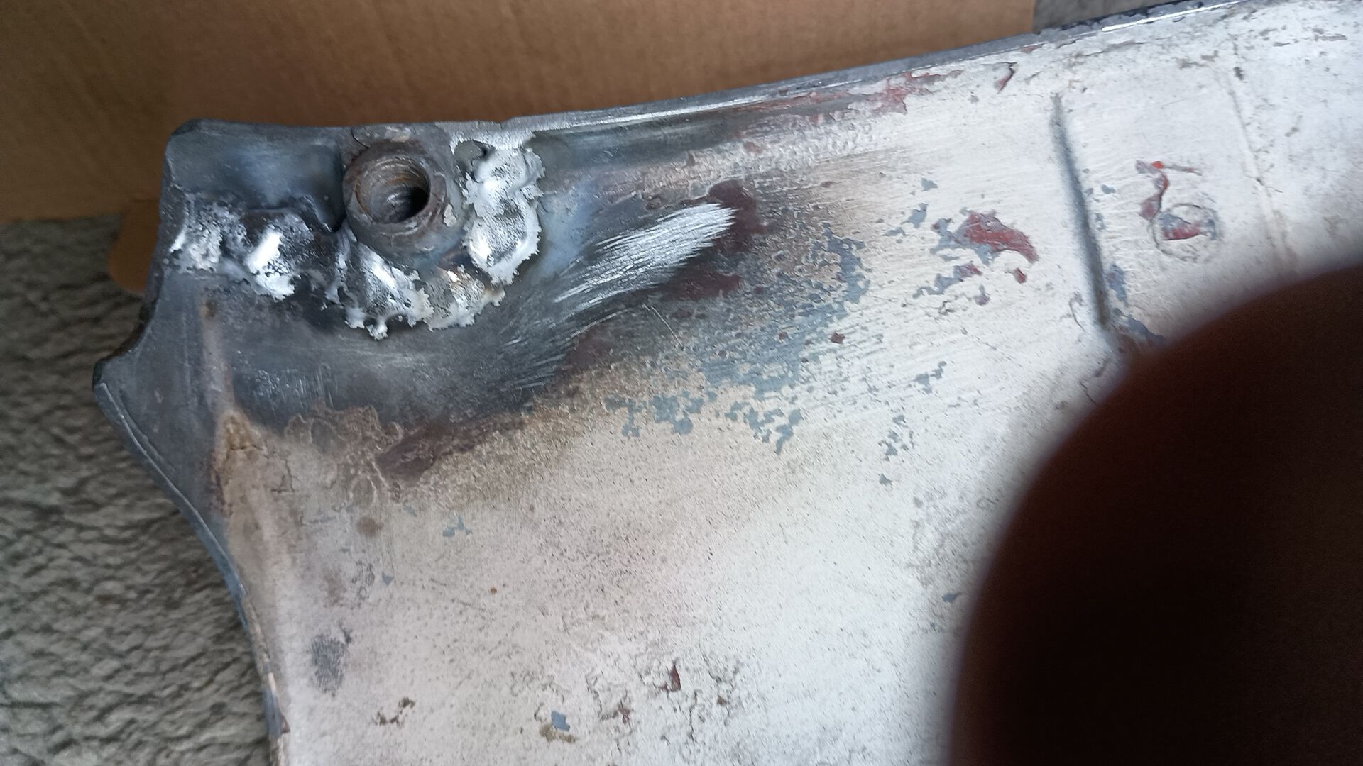

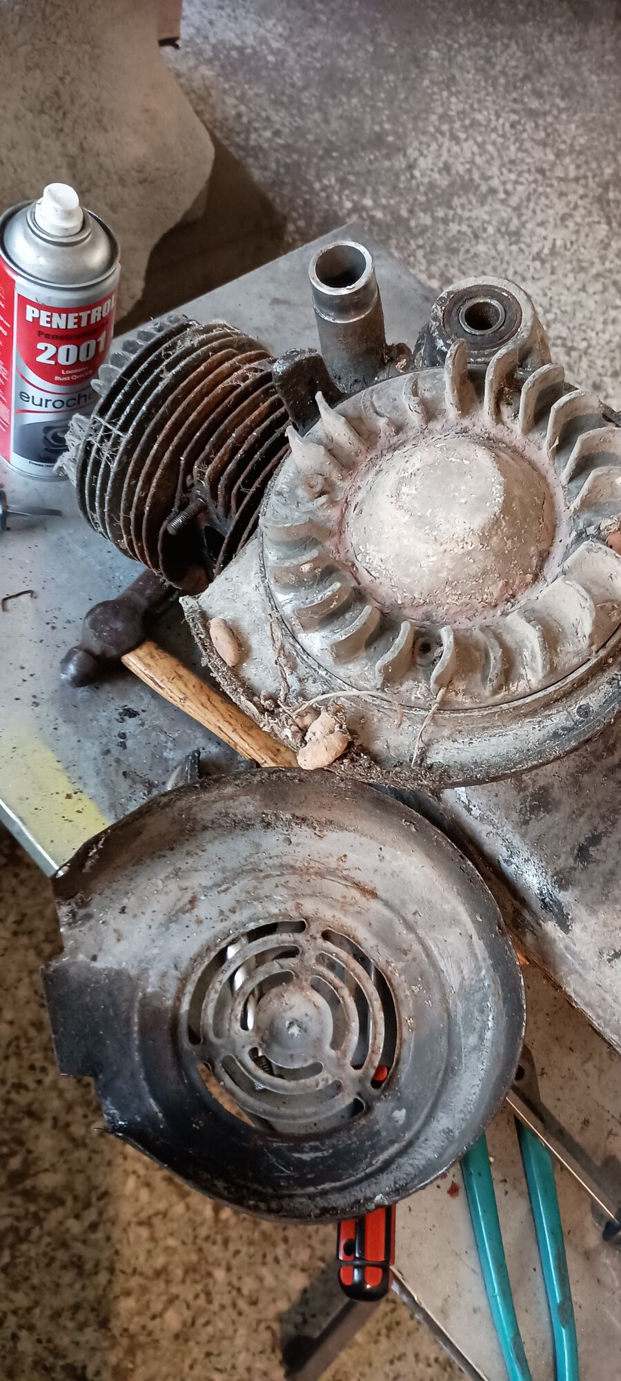

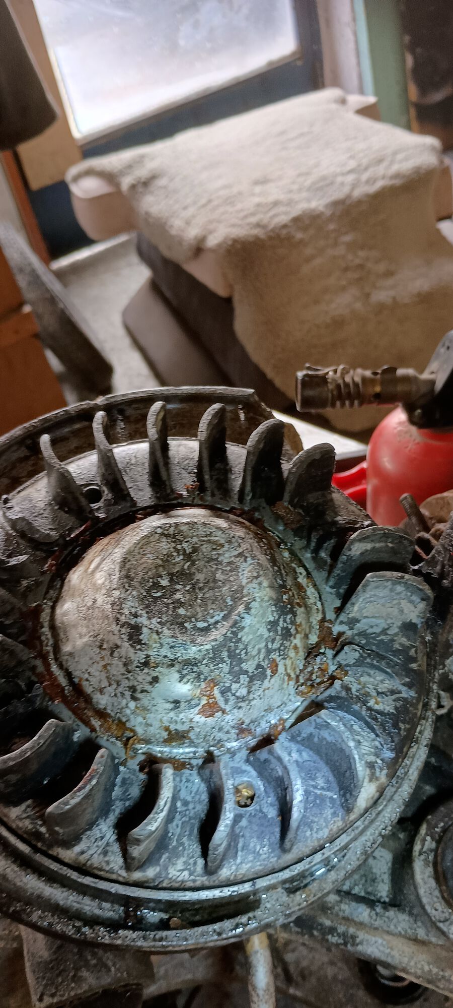

I've got the cylinder cover off, and fan cover & carb. Now I want the fan/flywheel off and have removed to 4 Allen screws but I am stumped by the conical done in the center that looks held down by the fan OR the red glue where they meet.
I am still waiting for Sticky's manual, but my time left here is running short. Can somebody please give me a clue how this should come apart?
Three busted fins I think,  then balanced by busting off three on the opposite side
Allen screws out and nothing budges. I've started scraping out the red glue and may try some heat
@chandlerman avatar
Innovator
Posts: 12950
Location: Nashville
277 Days Since Last Explosion
Innovator
@chandlerman avatar
Posts: 12950
Location: Nashville
There's a wire circlip that's holding that cover on, probably lost in all the grime.
And when you finally get to it, the flywheel nut is REVERSE THREADED, so don't accidentally tighten it by mistake.
@gravelrash2004 avatar
P Series / LML / Motovespa
Posts: 1627
Location: UK
Posts: 1627
Location: UK
Not forgetting that you will need to twist that aluminium "dome" also to remove it
Posts: 10121
Posts: 10121
Thanks, Chandler. Said circlip likely broken or lost along the way. I got the nut off without much trouble and found a random circlip behind it. Now awaiting some of Dad's tools, pretty sure there's a FW puller or two there.
No circlip so why not some red glue? Scraped it off and gently pried cover up.
On the good side horncast all welded nicely, smooth on the front
Welded strong on the backside
⚠️ Last edited by V oodoo on UTC; edited 1 time
Yeah, there were multiple pullers in that picture you shared. Naturally, it's not the same size as any of the Vespas.

Well, with broken flywheel fins, it's now the perfect time to update the old points to 12v electronic ignition.

I'm back in Greece and this Lambretta is back on the menu. Yanni is getting the frame & sheet metal blasted & primed while I get the motor back to build a test stand and begin disassembly. Fortunately we have a copy of Sticky's manual.on the way.
