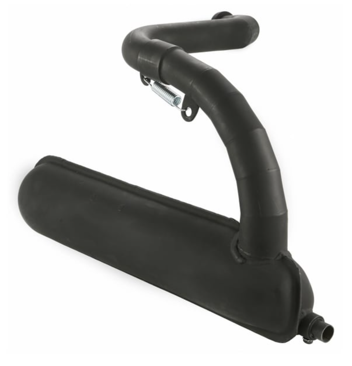

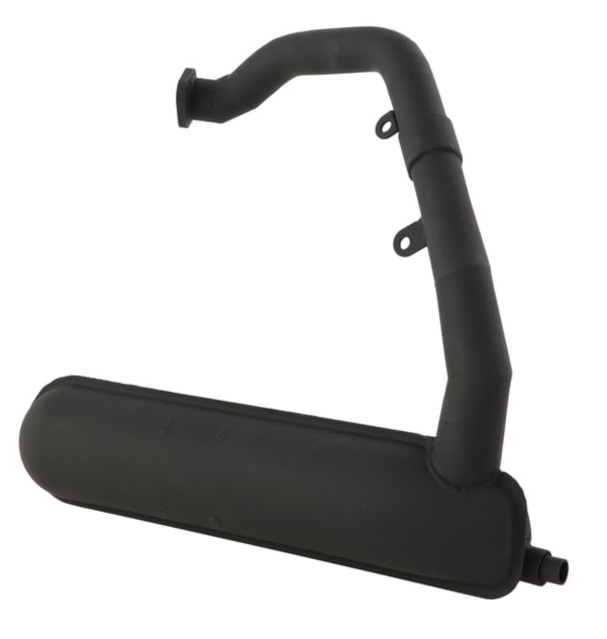

You can't mount V-range exhaust into PK without cutting chassis. No matter what engine is inside.

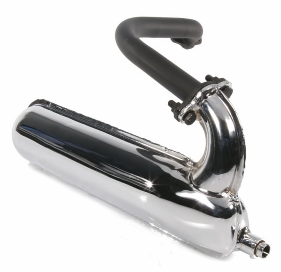

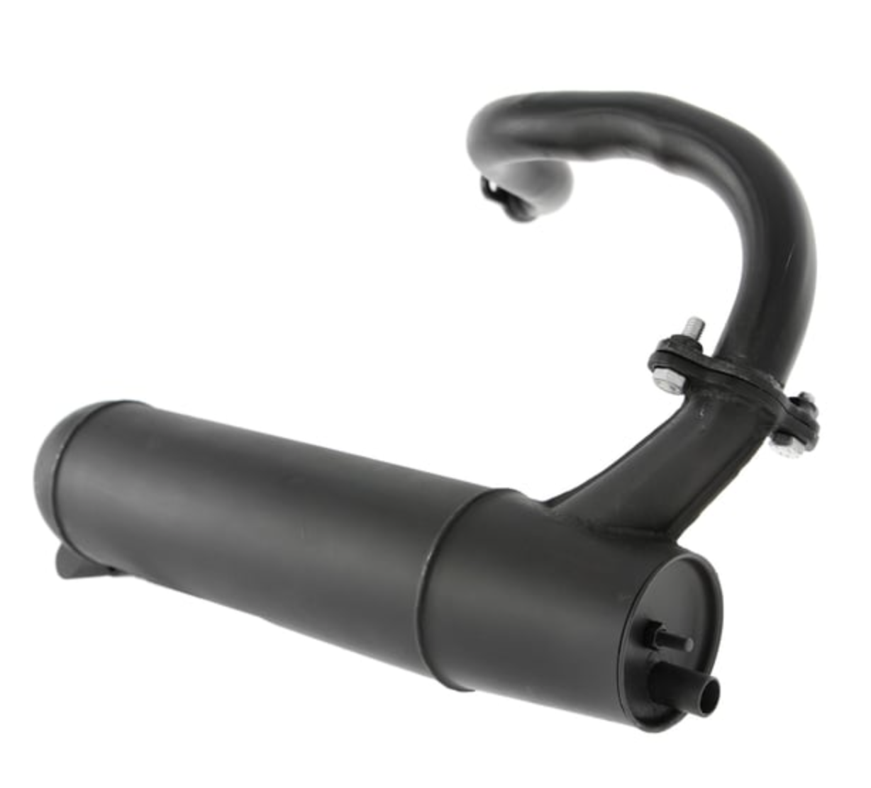

100% that PK and V exhausts have different geometry. Even SIP states that about fitting exhausts.
BTW it is worth to put in SIP banana - much better than Faco.
PK / ETS banana

V-range banana
V-range banana
SIP PK banana
SIP PK banana
SIP V-range banana
SIP V-range banana
