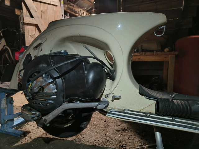

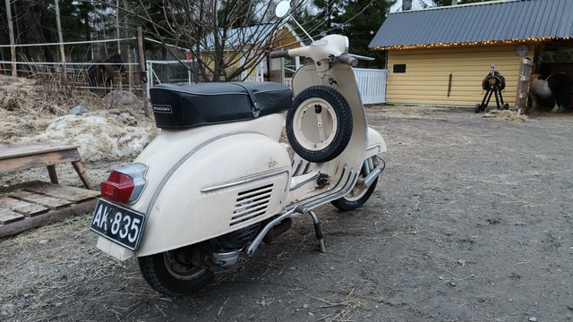

Starting to document the journey of this cream colored scoot over here. Bought along two other scoots just yesterday.
The story of the scoot was that it had broken down with horrible noise while the previous owner was commuting. Indeed cranking the kickstarter sounds like the flywheel is touching the fan shroud. And indeed it was Laughing emoticon
Don't ask me what happened here but I found this kinda funny

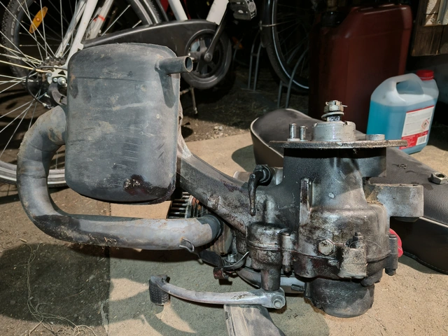

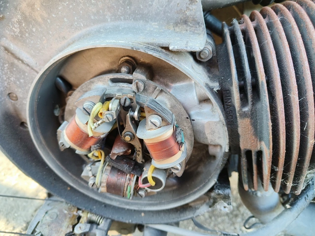

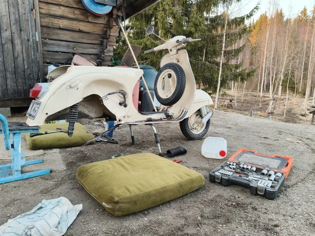

Took out the engine since it will require some major bench work before being operational again
The engine turned out to be not as innocent as the body. It has been kitted with SIP Road (?) exhaust, Pinasco top end and Si 24.24 carb.
I hope I'm not making too big of a sacrilege here by dropping in a left over 200 engine to get the scoot rideable again.

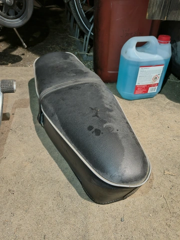

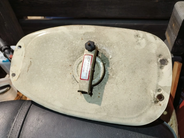

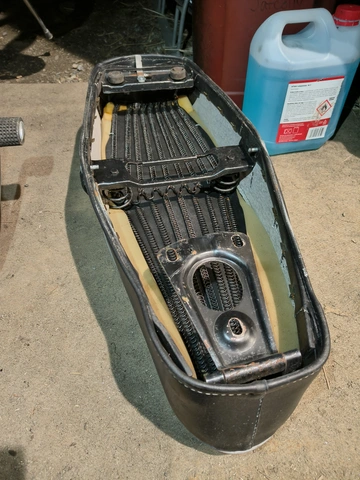

Seat is a tad dirty but overall in good condition. Just one small pinhole on the side. Could this also be OG? If I recall correctly, that seat latch mechanism is correct for GL.

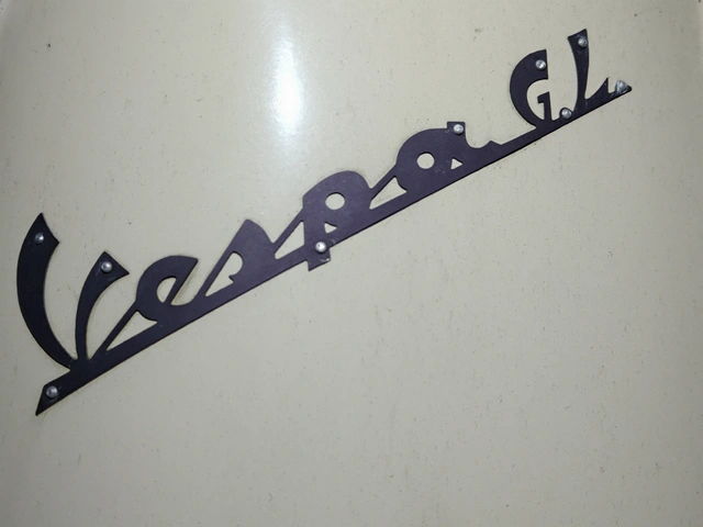

Rivets on the badge look beautifully done and round

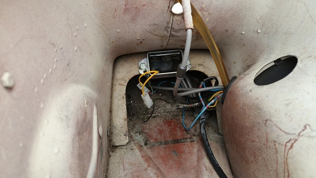

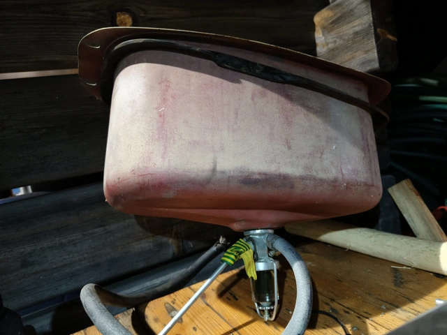

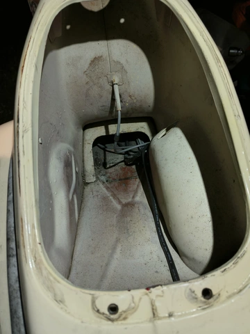

Under the tank is rustless and I think the red color is just primer paint
Same red paint on the underside of the fuel tank
Fuel tank even has it's sticker
Seat latch post was one thing that I thought was a tell-tale sign about re-spray.

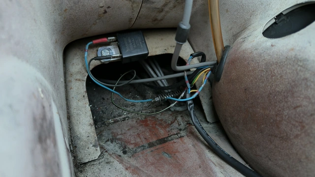

Got the engine swap forward a good deal today. Cables ran, new fuel hose and electrics modified for Vape regulated. Still missing the brake switch though.
Repurposed one of the two blue wires from junction box and ground for brake light switch for hooking up regulator hidden under the fuel tank.
Clever !

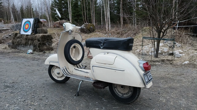

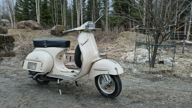

Ditched the Bajaj regulator, drilled another hole and fitted a Vape AC regulator along 12V bulbs.
She works again!
Next thing is to wash her thoroughly.
