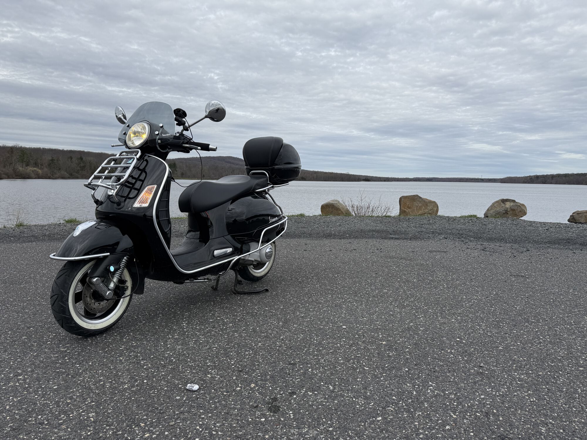

Hi All
I can't tell you how much I'm enjoying riding my GTS! I've put over 750 miles on it since last weekend!
It now drips a few drops of coolant under the left side floorboard when parked. There are some "gills" on the underside and after sitting for a few hours, it drips from there.
I haven't taken anything apart yet. Any tips or tricks? Thanks in advance!
