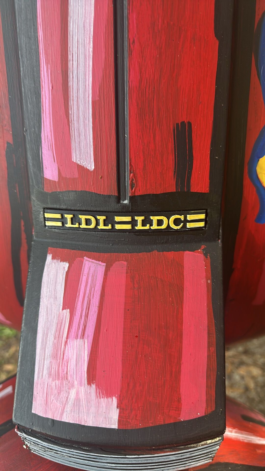

Here's the stella badge printed.Not sure how to finish it. It has a texture on the surface.
@thomashsb avatar
1964 v90, Piaggio Ciao, Motobecane 50L, Stella Fireball, Italjet Velocifero, Gilera GSA 50, Bajaj Tri Truck, 150 Super, all in various stages of disarray at the moment
Posts: 381
Location: savannh, ga
@thomashsb avatar
Posts: 381
I'd print it again with concentric pattern on the top (bottom?) layer. What filament? If ABS the you can vapor polish with acetone.
I've recently started resin coating things I want to look super smooth. We have a resin printer also so I'll just dip my parts in the resin then take them out in the sun to cure.
I'd say if you haven't tried ironing, this is a perfect opportunity. Just make sure to turn it on for all top surfaces, for the badge to come out perfect

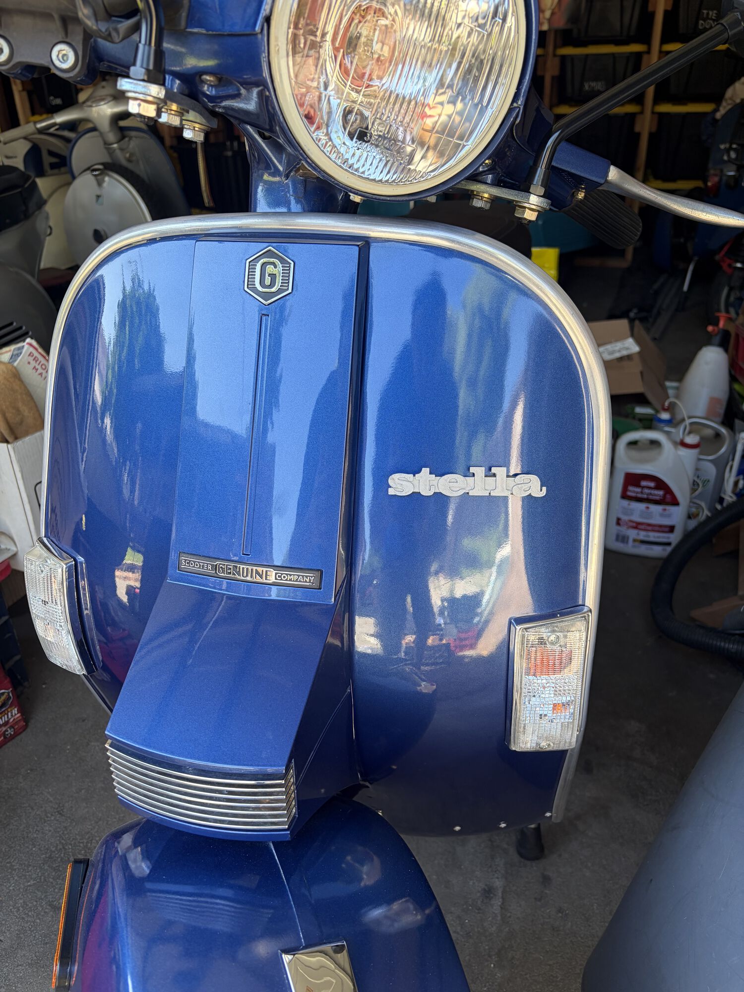

Oooo, if you wanna get really hard core after you get your print spot on you could silver leaf it then clear coat to really get a factory look.
I just made this for my Stella. Obviously wasn't as concerned about finish as I've got the comic book thing going on. Since the badge is curved to fit the horn cast I printed it standing up. Printed in black, wiped over it with a white paint marker.
I have found though that often lettering looks better if printed standing instead of flat.

ThomasHSB wrote:
...I have found though that often lettering looks better if printed standing instead of flat.
Agreed 👍🏻
I would print that the other way, letters facing down, on a slick plate (or even glass, works well for ABS, with glue or hair spray).
I haven't tried ABS in my new machine but in the past I could never get it to stick on glass except by using an ABS/acetone slurry.
